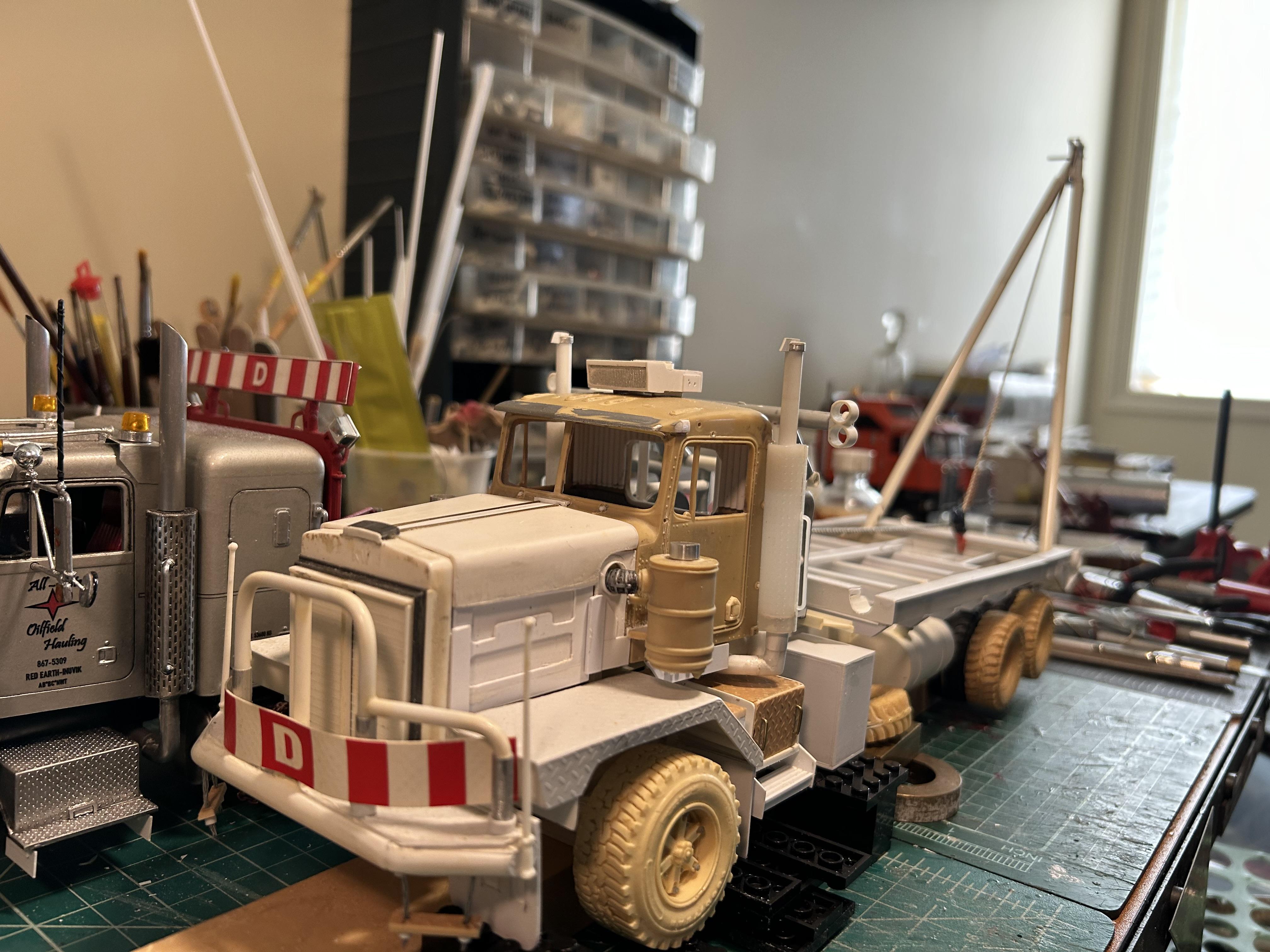

It is loosely based on a National 400ish, lots of modelers freedom. Trying have it somewhat functional for display. Thanks for looking. -

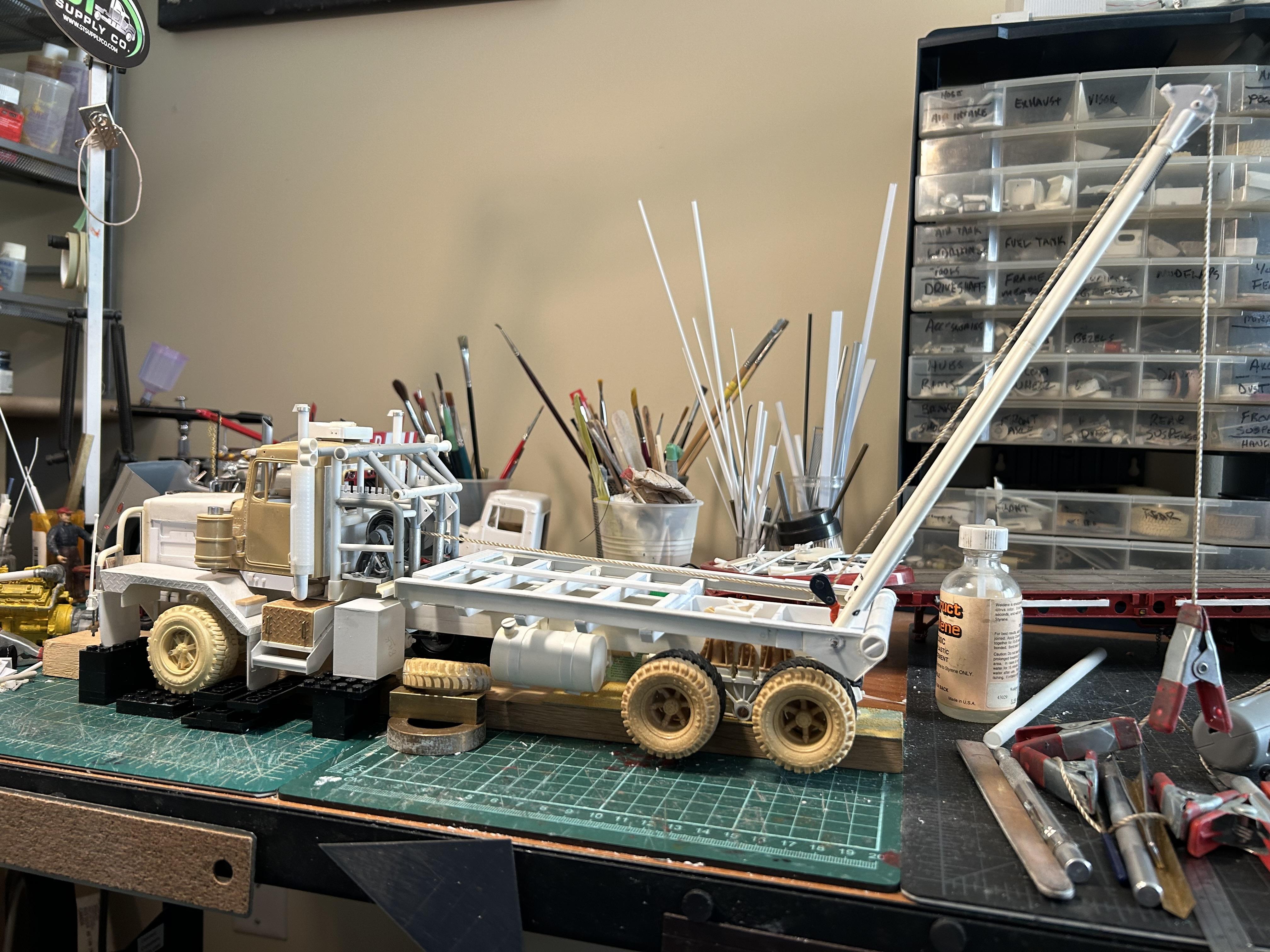

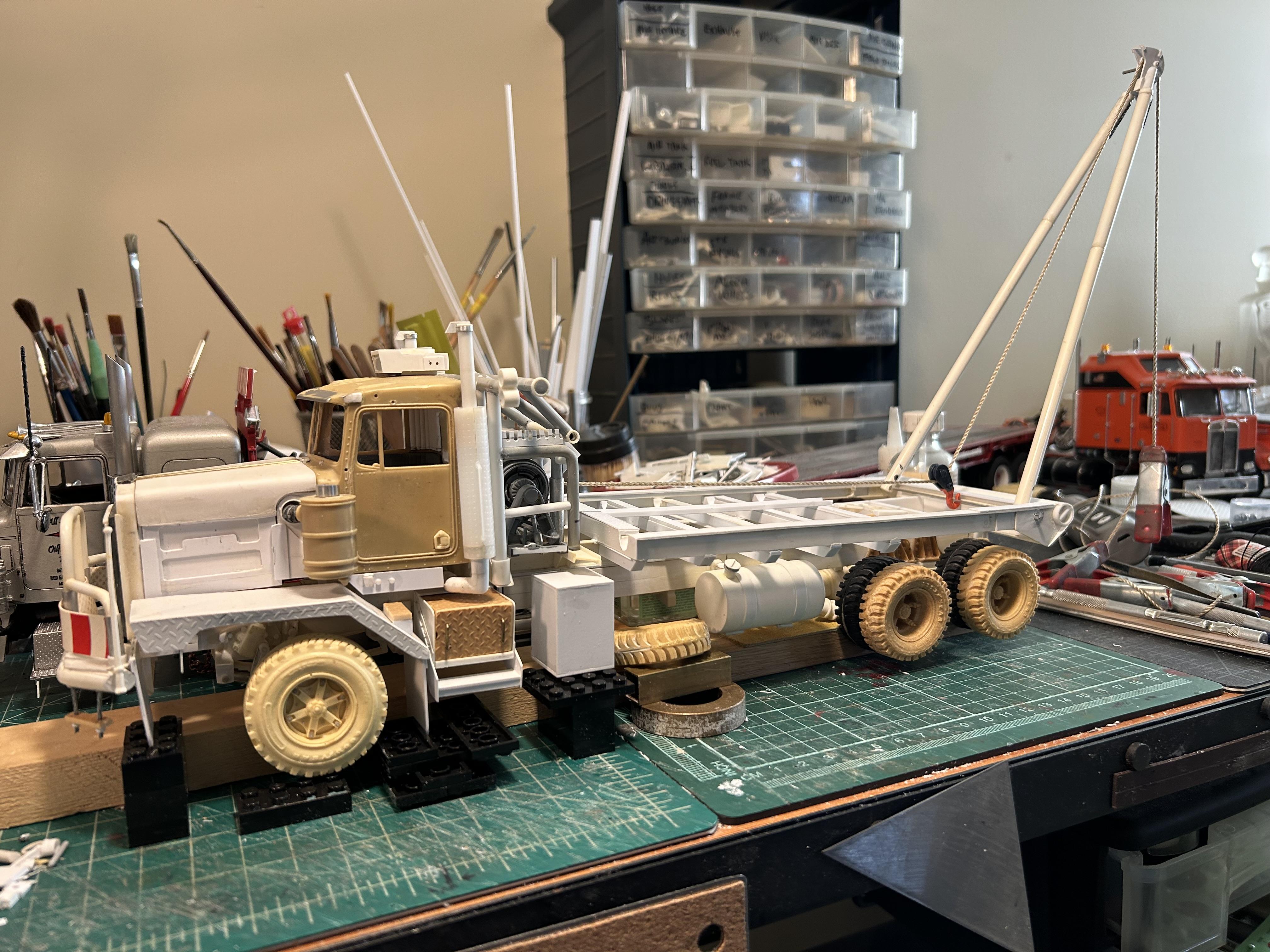

After a long break I am back fiddling with this unit. Building some rigging for picker and bed truck. Winters are long however might be able to spray some paint soon. -

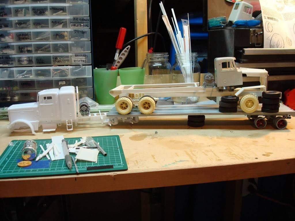

Thank you everyone for the kind comments. A few more progress pics. Changed direction on this, being my first attempt at a diorama. -

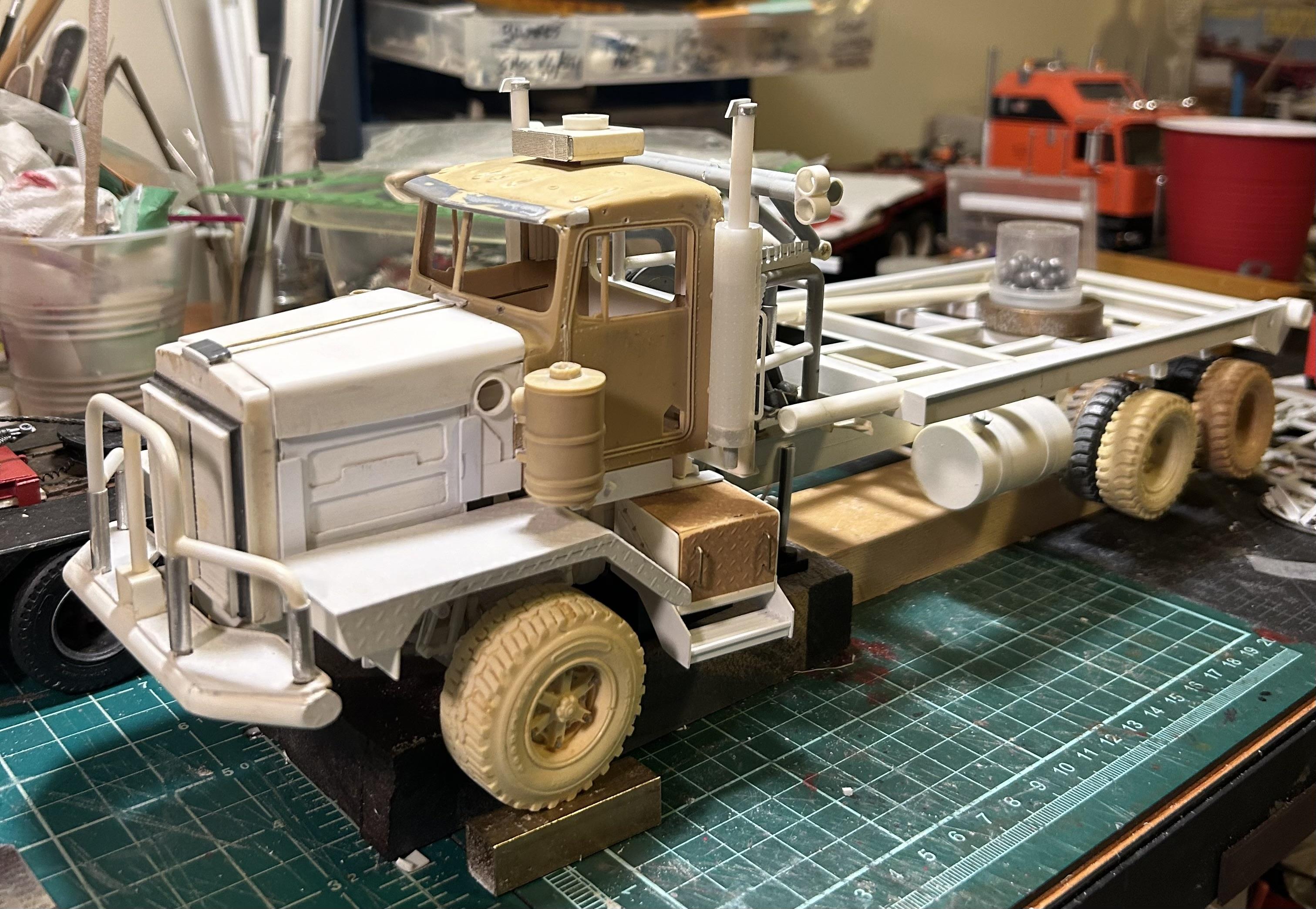

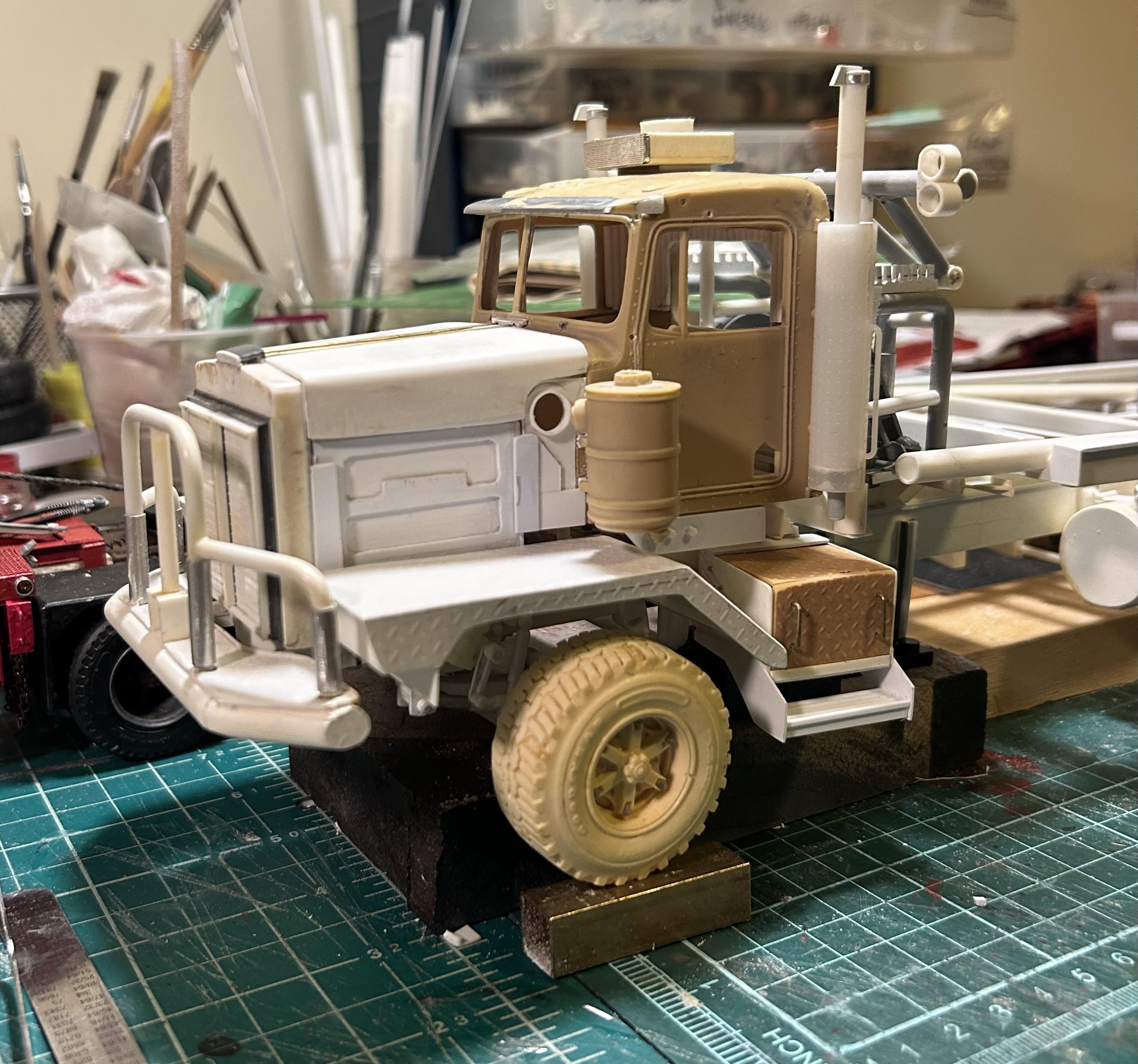

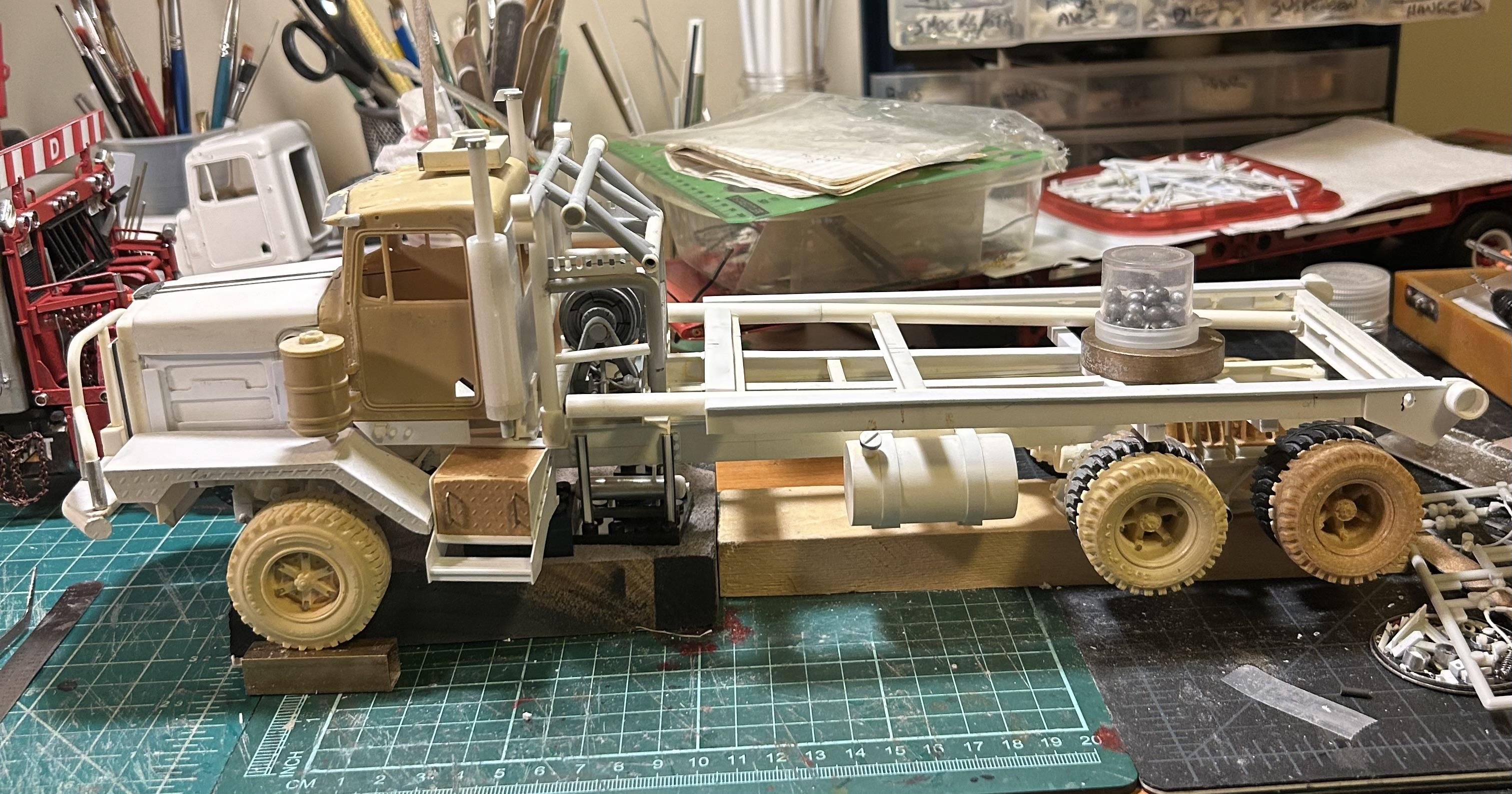

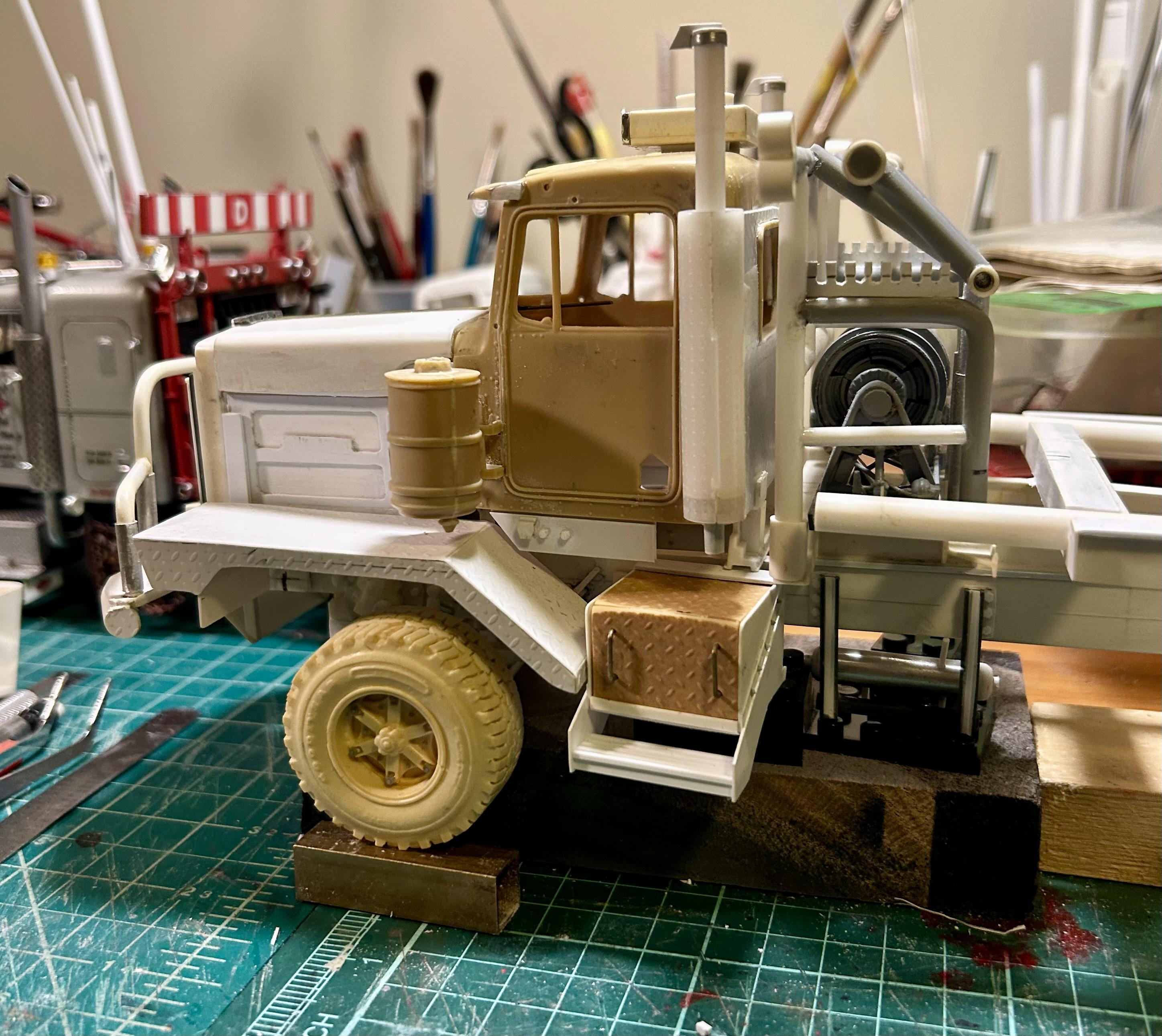

Thanks for looking, Turned the lids using my dremel and used evergreen tube and a pair of Kootney 3D elbows cut down to 45. I will say this, the poly used in 3D printing in this case is very brittle and not very machinable at all. Now to figure out the mirrors. -

Thanks everyone for the kind comments, I switched gears on this and added the cold climate air intakes. A friend RC Mark suggested it and I’m glad I did. Cab, engine and other sub assemblies are just sitting on frame for mock-up nothing glued. Started some painting and hoping to finish soon. -

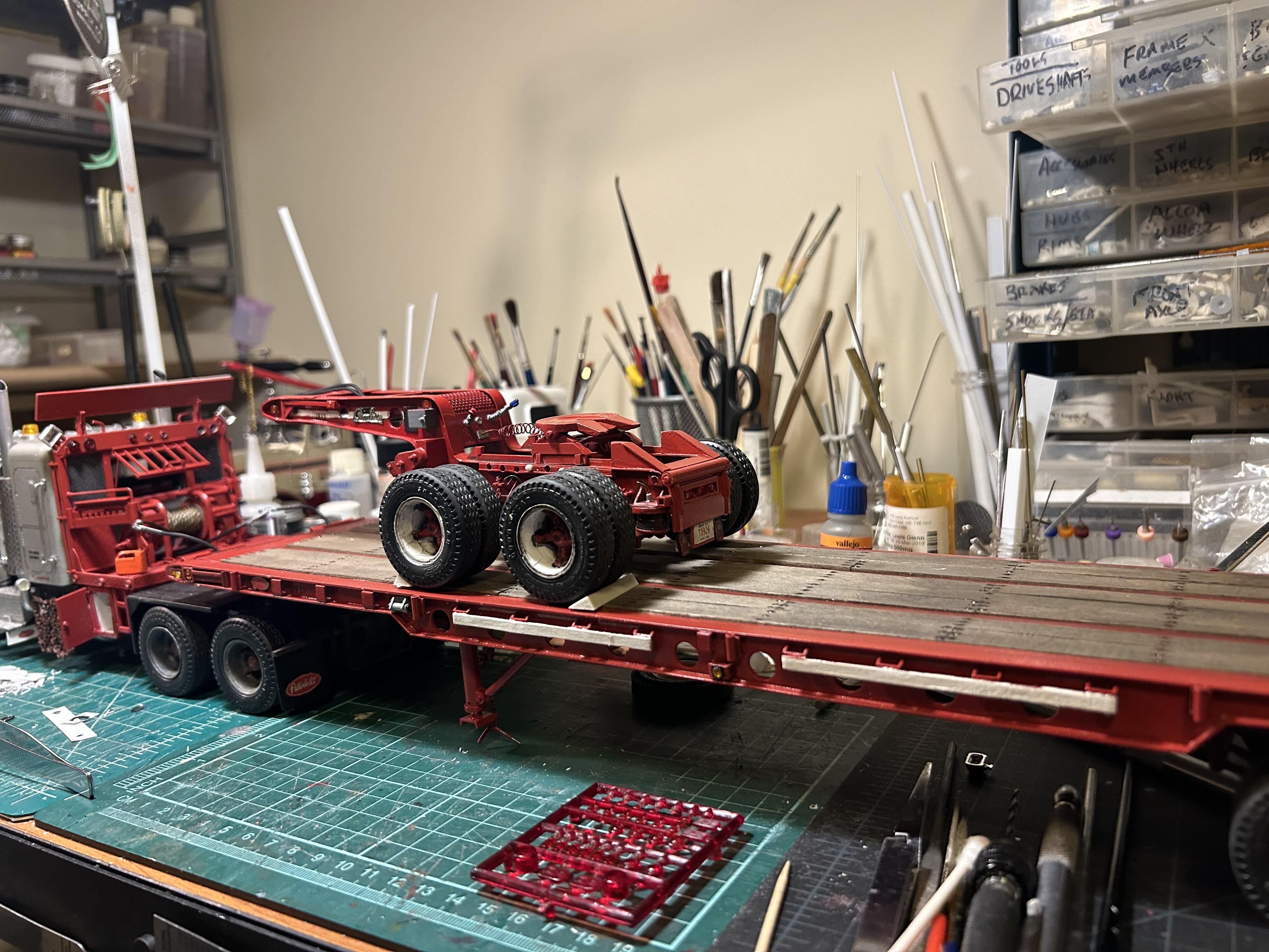

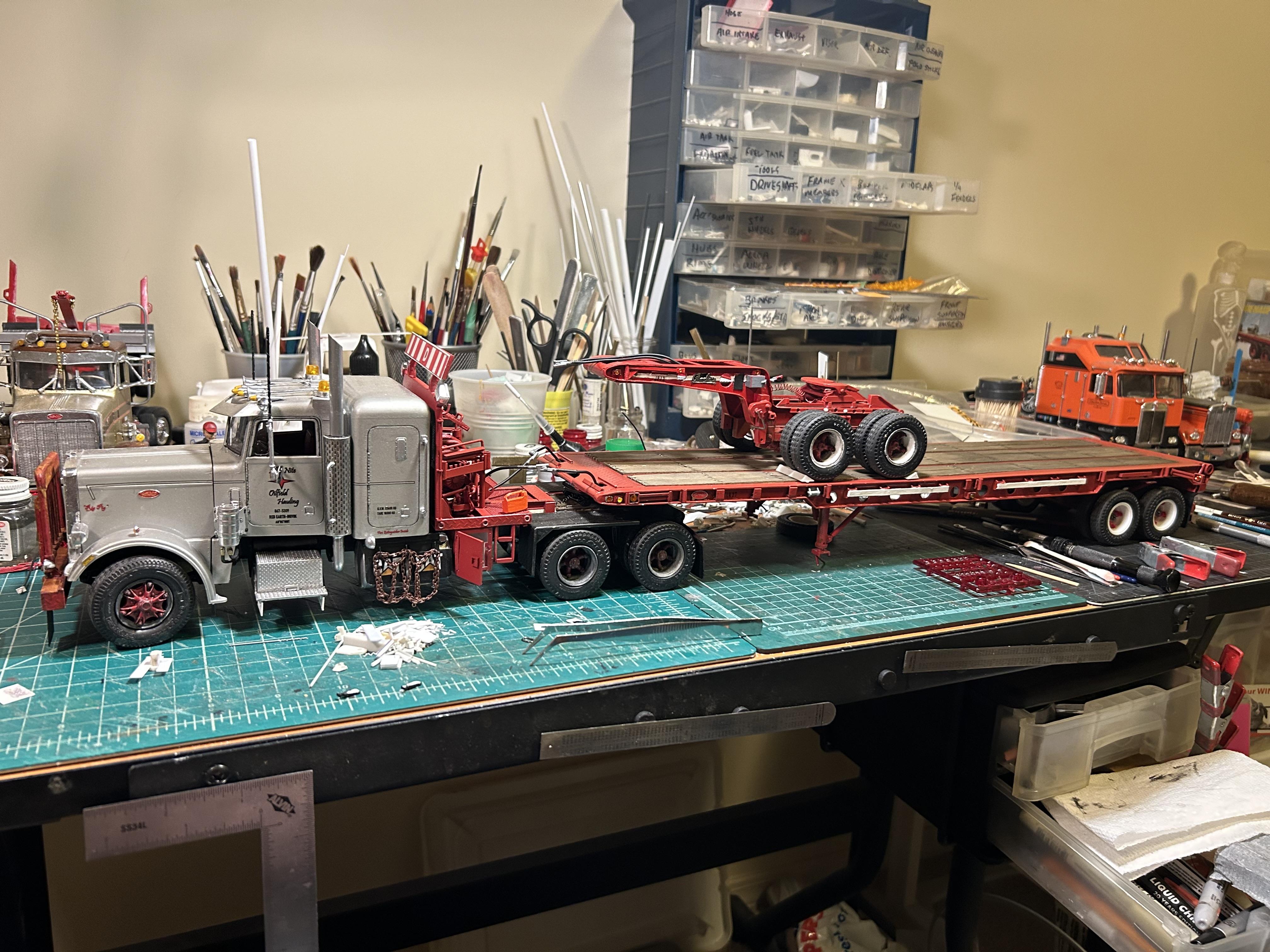

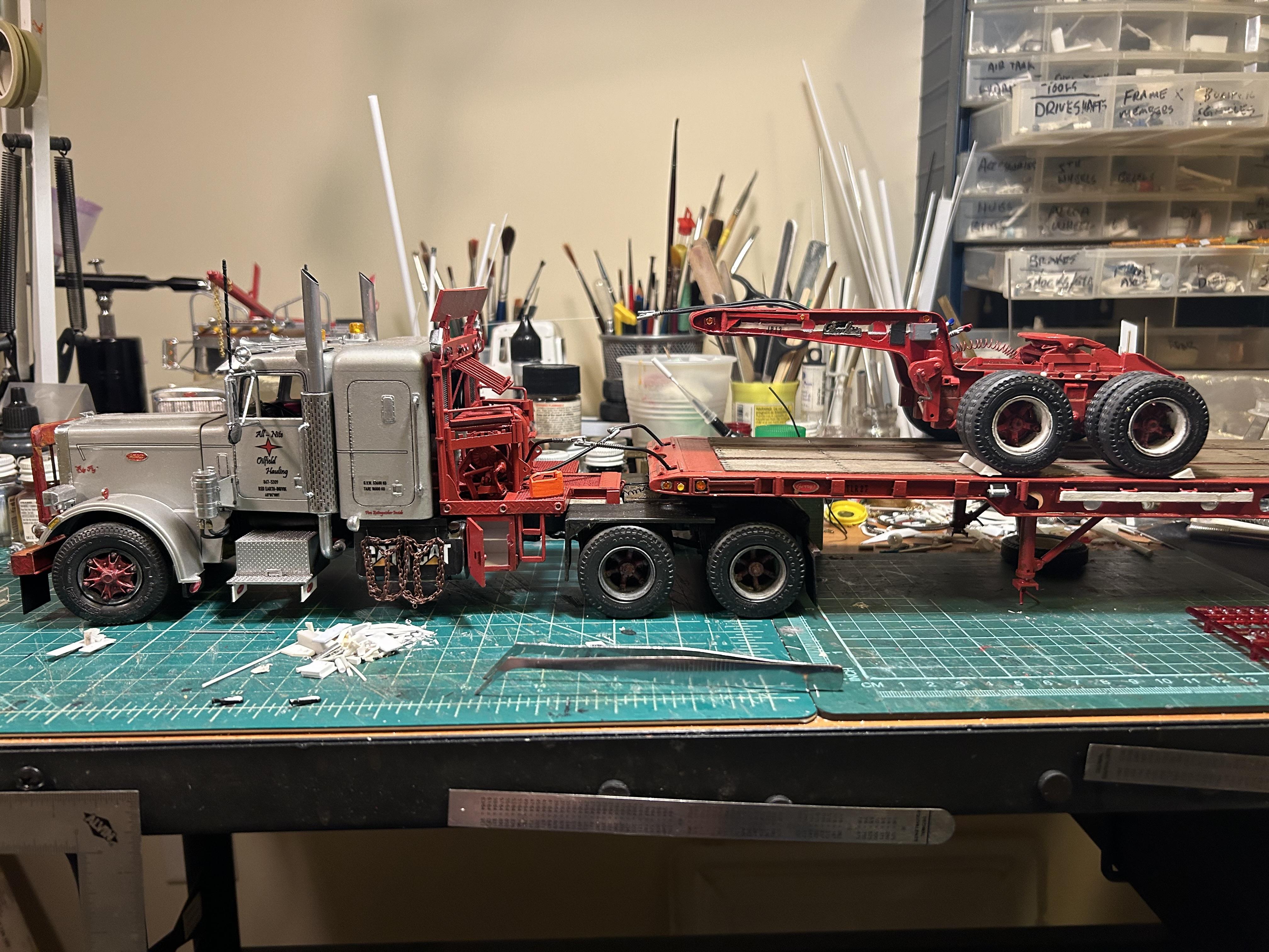

Few more progress shots, poles and flip fifth wheel work. Have a few things to finish on the float, glad it fits the bed truck. -

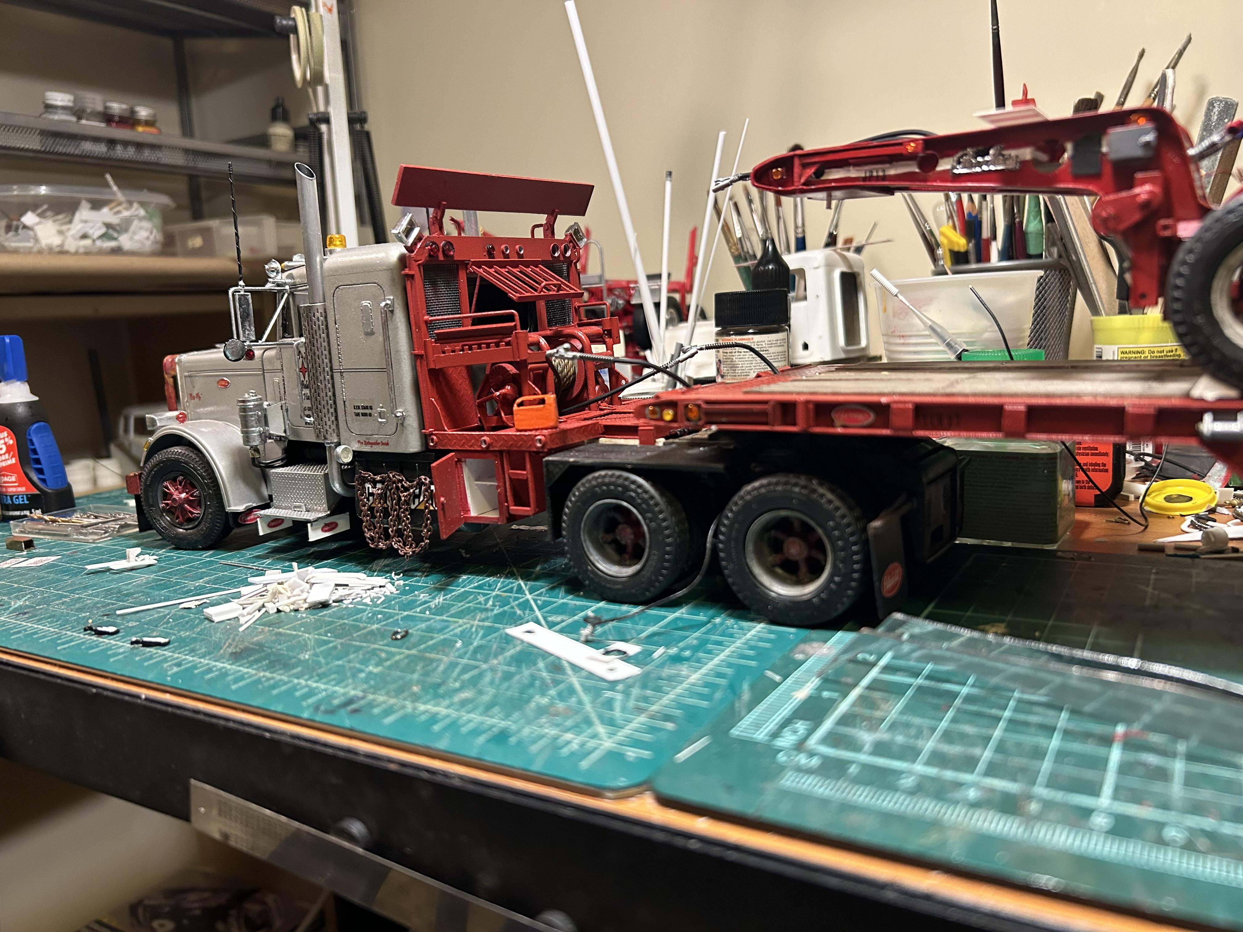

With the Pete out of the way for now I’m focused on continuing with the bed truck, I decided to rebuild some prior work and trying to put a nose on it. Thanks for looking. -

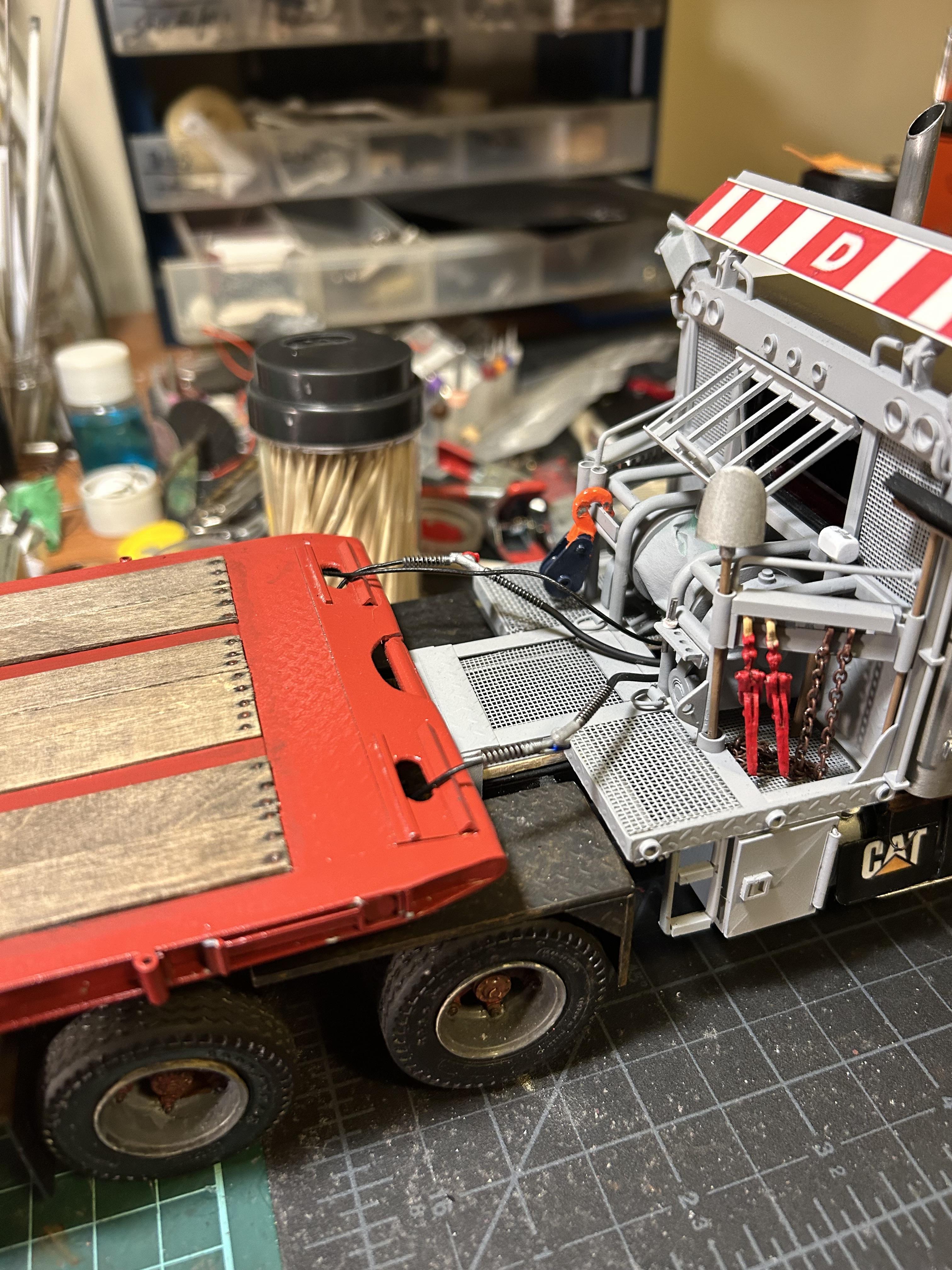

Thanks, it been a project. A rigsaver is a gate valve type device that will when activated, prevent air from entering the engine intake air system. This prevents a engine runaway situation. Mine is mounted on the air inlet piping before entering the turbo compressor. -

With almost no more bare plastic or primer, it’s starting to take shape. The jeep got some rework again, it was built a number of years ago. Mocking up and installing some plumbing, numerous lights, reflectors and details. weathering to finish -
