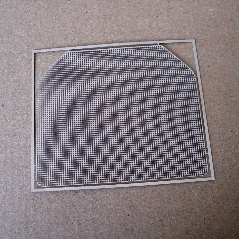

  20. Photo of PE Stone Guard from Germany..................
