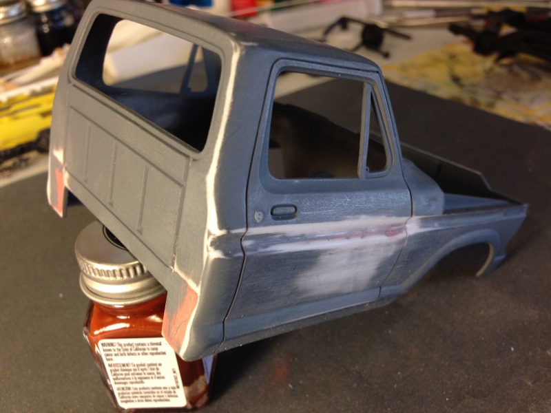

Thanks Chris! I used these two bits in a Dremel tool and then varying grits of sandpaper wrapped around the end of a paintbrush. It's maddening trying to keep a steady hand with the metal round cutting bit though, I went a bit out of the groove on the passenger side door and straightening it back up is proving challenging to say the least. Don't sneeze and take some breaks!

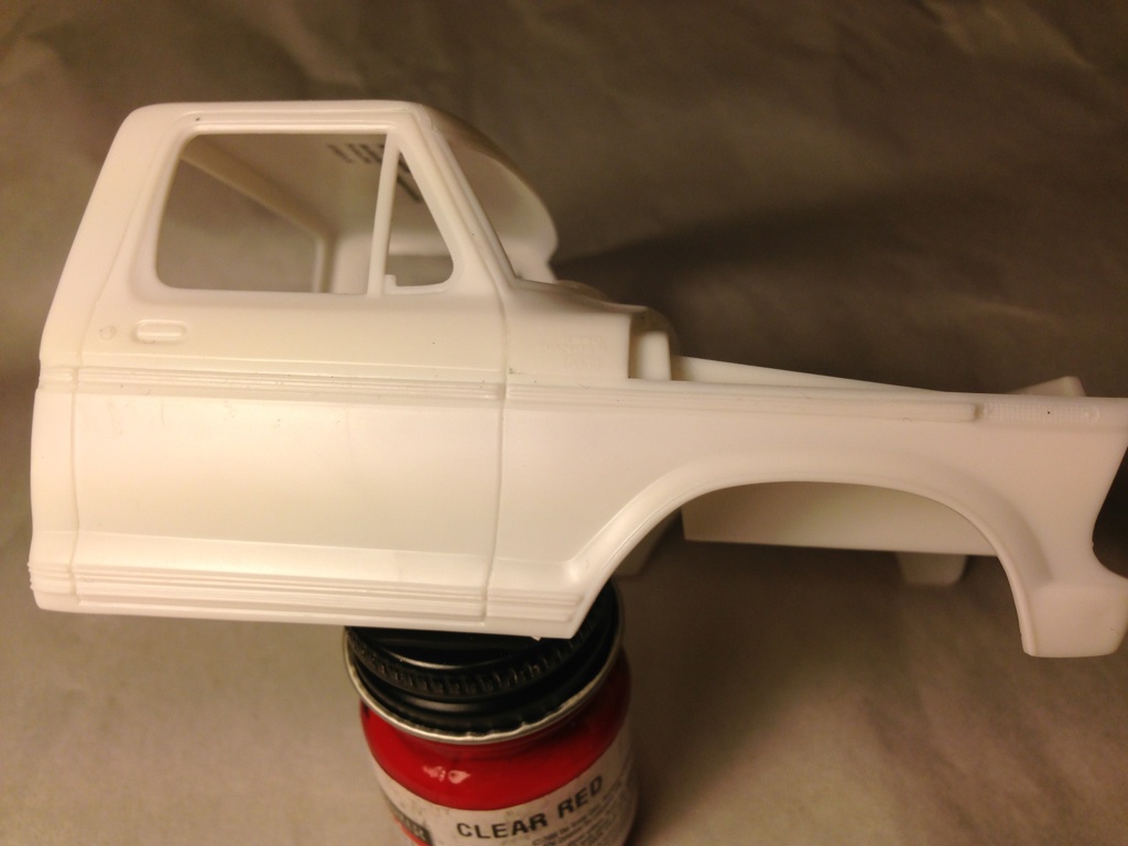

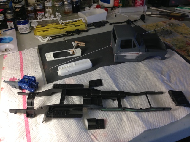

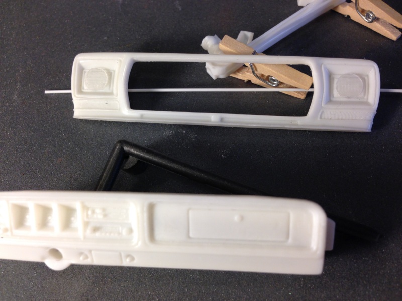

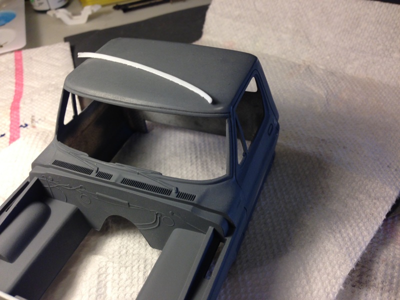

Hi folks, haven't posted much, been mostly lurking and admiring. But I thought I'd put some pics up to hopefully get some tips, advice and maybe a TAD bit of critique(tongue-in-cheek) Anywho, awhile back in the welcome forum, I posted I'd been away from the hobby for 20+ years. Now I wanted to share a few EARLY pics of a model I've been building in my head for the same amount of time. I bought 2 of the AMT reissue "Super Stones" kits(one for a "just in case/future build") and I scored the Monogram F350 dually pick-up on e-bay to use in this, possibly over my head, kitbash. I've been doing a lot of modifying to the largely disappointing AMT kit. Since the 1:1 truck I'm modeling after was a '79 F350 CUSTOM, I've had to remove all the body trim and molding along the bottom, fender and along the "groove" down the side. I also re-positioned the top of the windshield and filled the backside of the cab corners. On the Monogram kit, I cut down the under side of the extended cab floor to match the single cab of the AMT kit, removed the rear fuel tank and filled some low spots/pits in the frame. I de-chromed the grill and cut out the center to allow for a tube type grill made from styrene rod. I'm a bit perplexed by the headlights though as the '79 custom version had round headlights. I used a hole punch and temporarily white glued a piece of clear plastic over the existing headlights and may just fill the area around them with putty. From the dash, I removed the vents and glovebox lettering. Be patient, I'm incredibly slow and meticulous, my next update may take quite some time. But please have a look!

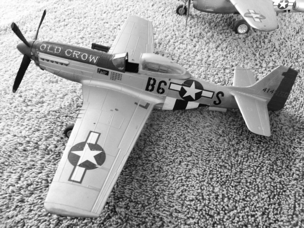

Have been away from the hobby for about 20 years and have recently been collecting supplies and kits to start again. Slapped together various kits as a kid and more seriously when i joined the Navy (still as a kid at 17, hah!) My interests have gone back and forth from cars/trucks to military aircraft. But one project i've had on my mind for a long time was recreating a '79 Ford one ton with a flat/utility bed my dad had used in his business (which i drove quite a bit as i worked for him when i got out of the Navy in '90). I've been reading and gathering a wealth of info both here and elsewhere about the hobby. Also, i hope to vastly improve my skill now that i'm better equipped to buy things like a real airbrush system (i currently only own the basic cheap testors propellant style airbrush i bought when I built the aircraft in the pics below) I dusted off these old models I built 20+ years ago, I was quite the novice in those days(and i still am!)
