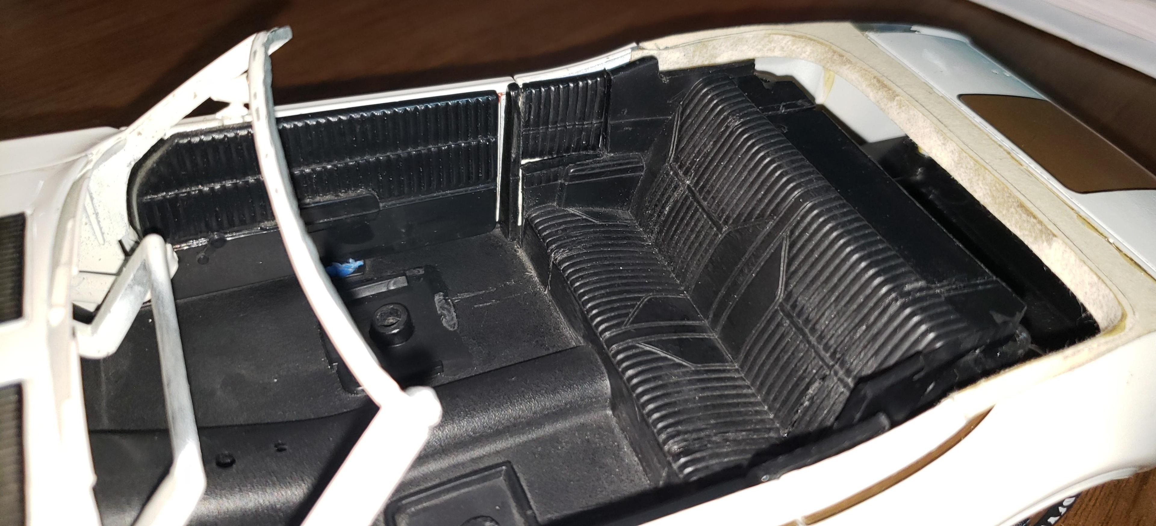

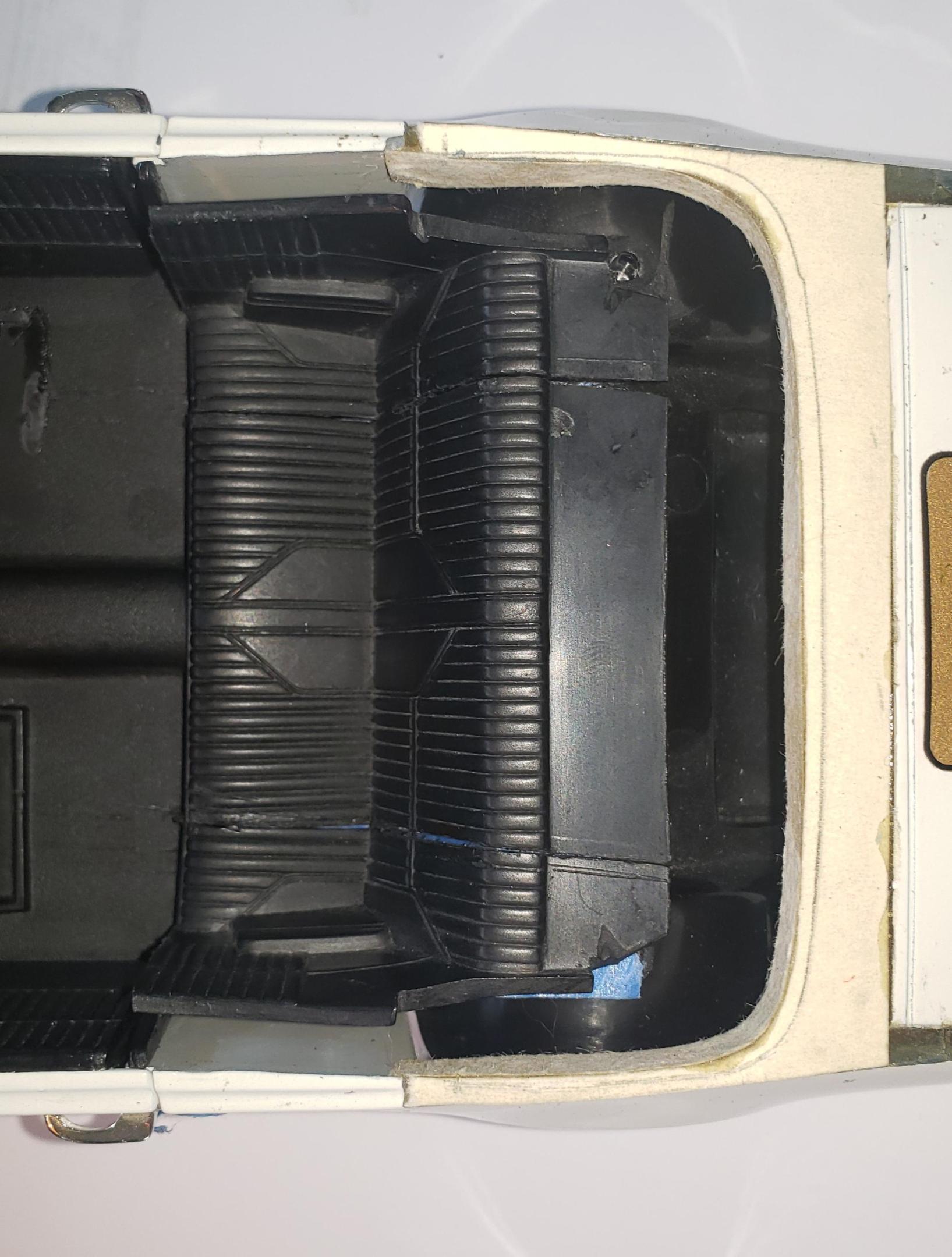

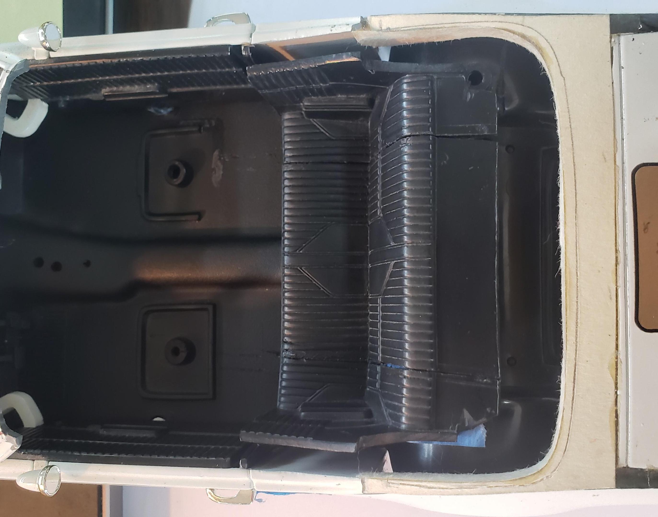

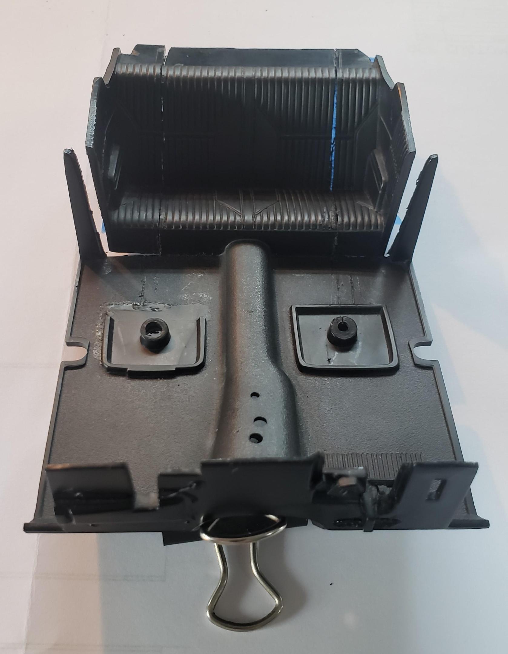

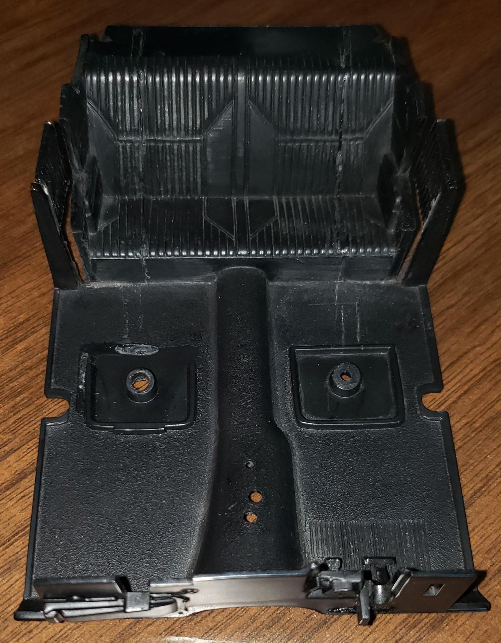

	  1/18 scale '69 Hurst/Olds convertible buildJ007KLEIN replied to J007KLEIN's topic in Diecast Corner A bit of progress to report on the HO convertible build. Glued the seat sections together and started smoothing out some of the super glue that squeezed out of the joints.... Next task will be creating the rear seat side panels that wrap around the top frame cavity and the rear seat armrest....

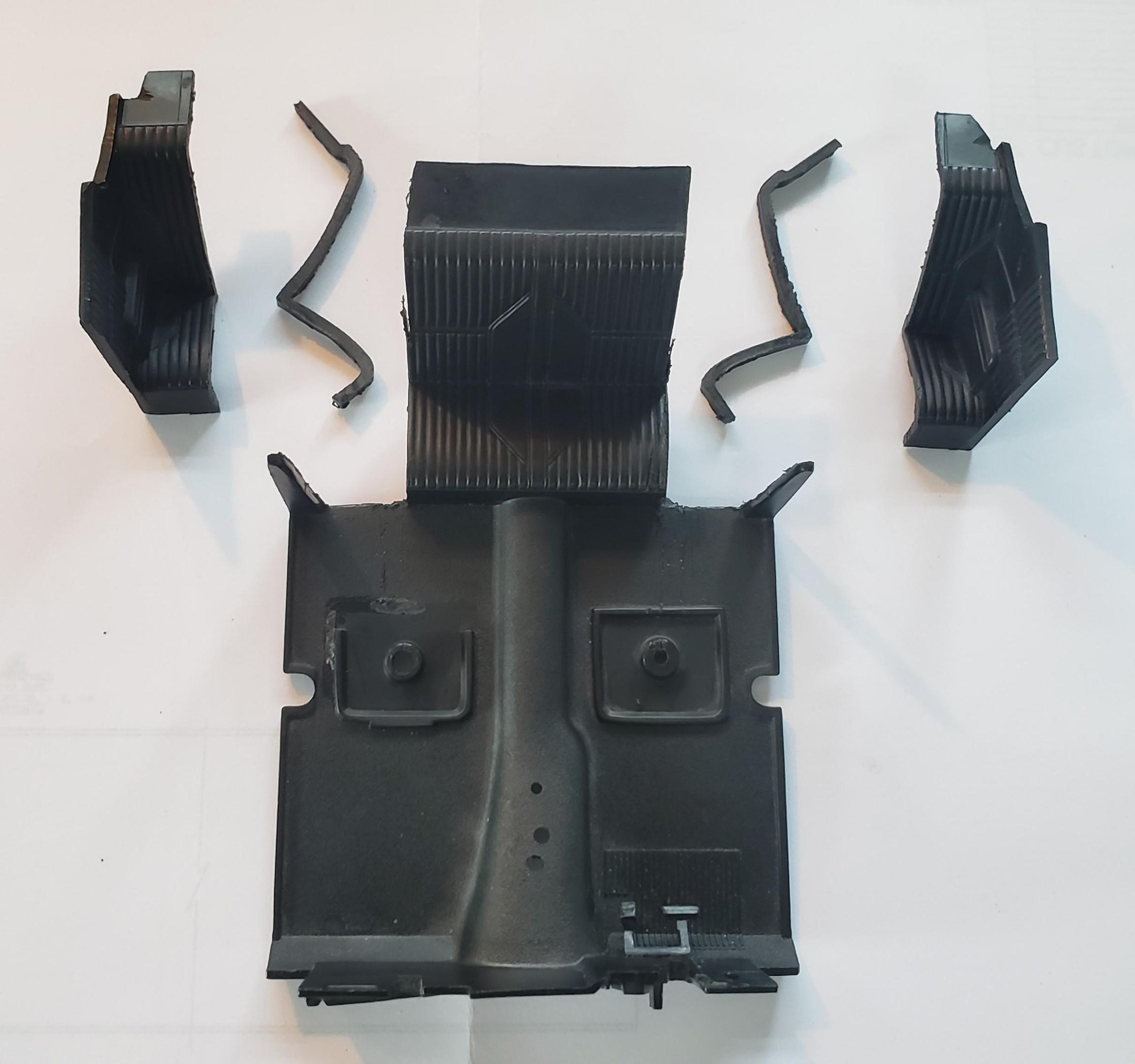

	  1/18 scale '69 Hurst/Olds convertible buildJ007KLEIN replied to J007KLEIN's topic in Diecast Corner I thought before I glued the side panels back onto the seat portion it might be easier to cut the side panels to create the trim panel offset for the top hinge mechanism.... Next steps will be to form the hinge mechanism surround and arm rest platforms before gluing everything together. Guess I'll need to run to the local hobby shop to pickup some sheet styrene. Until next installment....

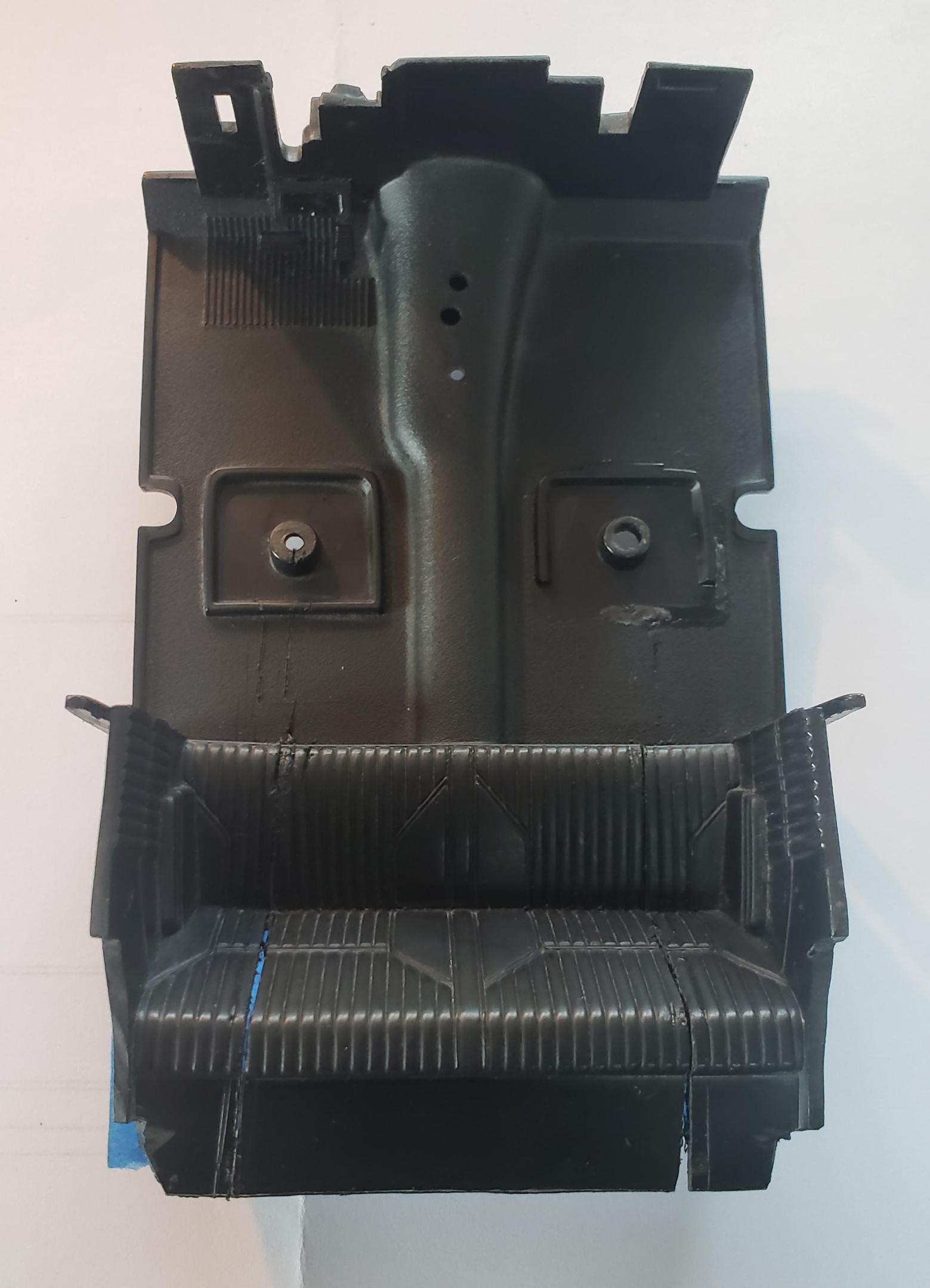

	  1/18 scale '69 Hurst/Olds convertible buildJ007KLEIN replied to J007KLEIN's topic in Diecast Corner Well had some time this morning so I pulled the H/O project and made the second sets of cuts on the rear seat. Didn't cut as true as the first set put close enough that I can (hopefully) make them work and have an invisible seam.... Taped the pieces together to get an idea how well they fit together as well as setting in the car.... Next step will be to sand the edges of the cuts smooth and then slightly bevel the back side of the edges so I can get a nice heavy seam of superglue on the back of the joint. Stay tuned....
	  1/18 scale '69 Hurst/Olds convertible buildJ007KLEIN replied to J007KLEIN's topic in Diecast Corner DAMN.... been a couple minutes!!? Well I pulled out the H/O convertible project this morning and dusted it off a bit to see where I left her. Seems it now time to address the rear seat area to narrow the seat cushion and back up enough to allow for the folding top mechanism on either side. I determined two pleats from each side should be about right for the mechanism cavity, so I applied a strip of masking tape to each side of the back seat and cushion and then trimmed it to be two pleats wide. I'll be coming in two pleats from the outside diagonal panel of the seat back and making my joint there to try and hide the seam at the seat pleat. With the tape trimmed to size, I first remove material from the underside of the seat at the floor level so I could easily make my cut along the floor line with my razor knife. I next took my hobby saw and made the vertical cut along the door edges and then proceeded to make the cuts on the rear seat. I used the center seam between the two pleats I was removing as my cut line and then slowly made the cuts thru the seat using my razor saw and my razor knife to finish the cut once my saw bottomed out on the blade top edge. With the seat corners removed, I'll next sand the cut edges up to the pleat seam that I'll be using as my finished edge and then figure out the top mechanism well and arm rest offset. Hopefully it won't be so long until my next installment......

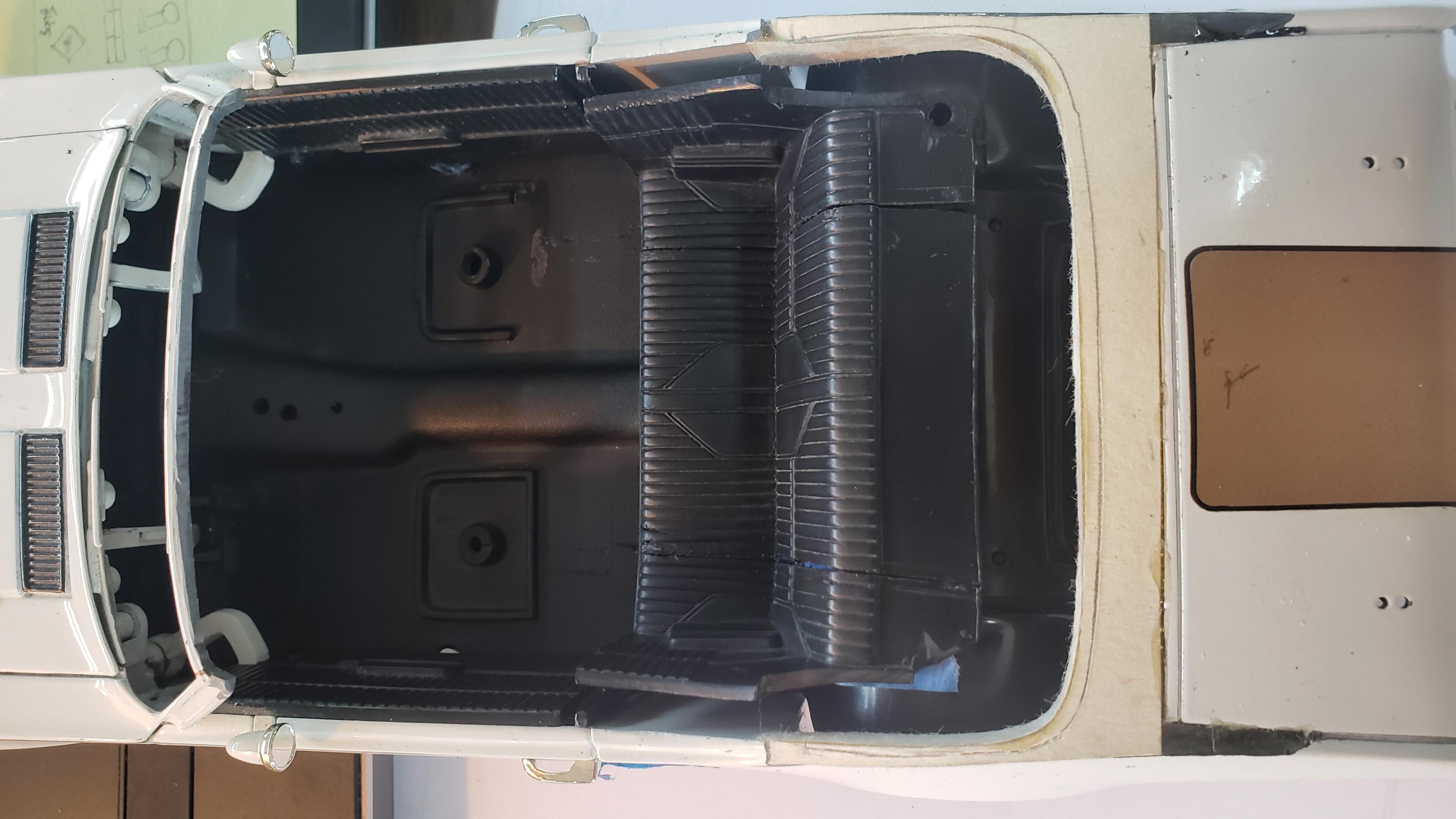

	  1/18 scale '69 Hurst/Olds convertible buildJ007KLEIN replied to J007KLEIN's topic in Diecast Corner WOW, can't believe it's been almost two years since my last update! I decided I best get back after it because my buddy's 55th birthday is the end of October... So today I formed the body opening for the top well and the filler panel between the well and the deck lid. I used an old manila folder to act as my form for the two part Epoxy I'm using as my body material. I plan on soaking the body in water once I've got the shape nailed and then slowly peel away the paper down to the Epoxy. So I trimmed the folder into shape and taped it all together and on the body... then I mixed three packages of the two part epoxy and drizzled it into place... once the epoxy had set up, I pulled away as much of the folder as I could to see how it did... and then put the interior and chassis with the body to see how the convertible top fit. The top is a bit too blunt on the back, so once I have the body tweeked into shape, I'll see about flaring the trailing edge of the top a bit to make it blend a little better.
	  1/18 scale '69 Hurst/Olds convertible buildJ007KLEIN replied to J007KLEIN's topic in Diecast Corner With all the major trimming and cutting complete, I decided to put it all together to get a feel for how it was progressing.... Looks like she's moving in the right direction! Next up on the agenda will be to construct a bridge between the quarters to positively locate the rear of the convertible top not only from side to side but the depth into the body to allow me to form the deck lid filler panel to sweep more gracefully into the back edge of the top to more closely mimic the real H/O convertibles.... I'll also need to recontour the body transition into the rear quarter windows a bit so it blends more smoothly into the quarter panel top return.... I'll also need to narrow up the windshield header to match the with of the convertible top...... then trim down the width of the windshield to match the header as well as trimming away the clear material around the sun visors and forming an opening between them for the top locating tab it fit into. Once the all the top up mods have been made I will turn my attention to the interior modification to replicate the Olds interior. Stay tuned!
