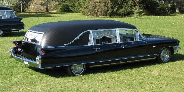

  6. greetings, boils and ghouls. its time for my next adventure. this one features my FIRST custom build. ive always loved the creepy and the unwelcome, so here we go again! im building a 1960 hearse! i started it all off with the AMT Ghostbusters ECTO1 model. and decided to make a hearse! some have told me it was a hearse, and though they did pull double duty and use it to carry caskets, it isnt a hearse as I see them. i pulled the model body out and got to work. now, the glass on this kit is one huge wrap around piece, the front windows are up. so i scribed the rear quarter glasses and broke them free. i then added a non shrink BONDO filler to the windows to fill it in smooth. i also sanded down and filled in gaps on the roof and one side panel. i left the fron light bar mount because i am going to paint it to have the traditional purple hearse lighting. heres where im at so far. as you can see i have some more filling and sanding to do, but you get the idea so far. heres what im hoping to replicate. what do you guys think so far? remember, its my first custom.

  9. thats a lot more involved than im used to. ive got some truck parts from my last build that ill practice on first. after i fill the windows it will get a vinyl top. is the masking tape technique still a thing? put it down, brush the edges with glue and then flat black. heres what im going for...
