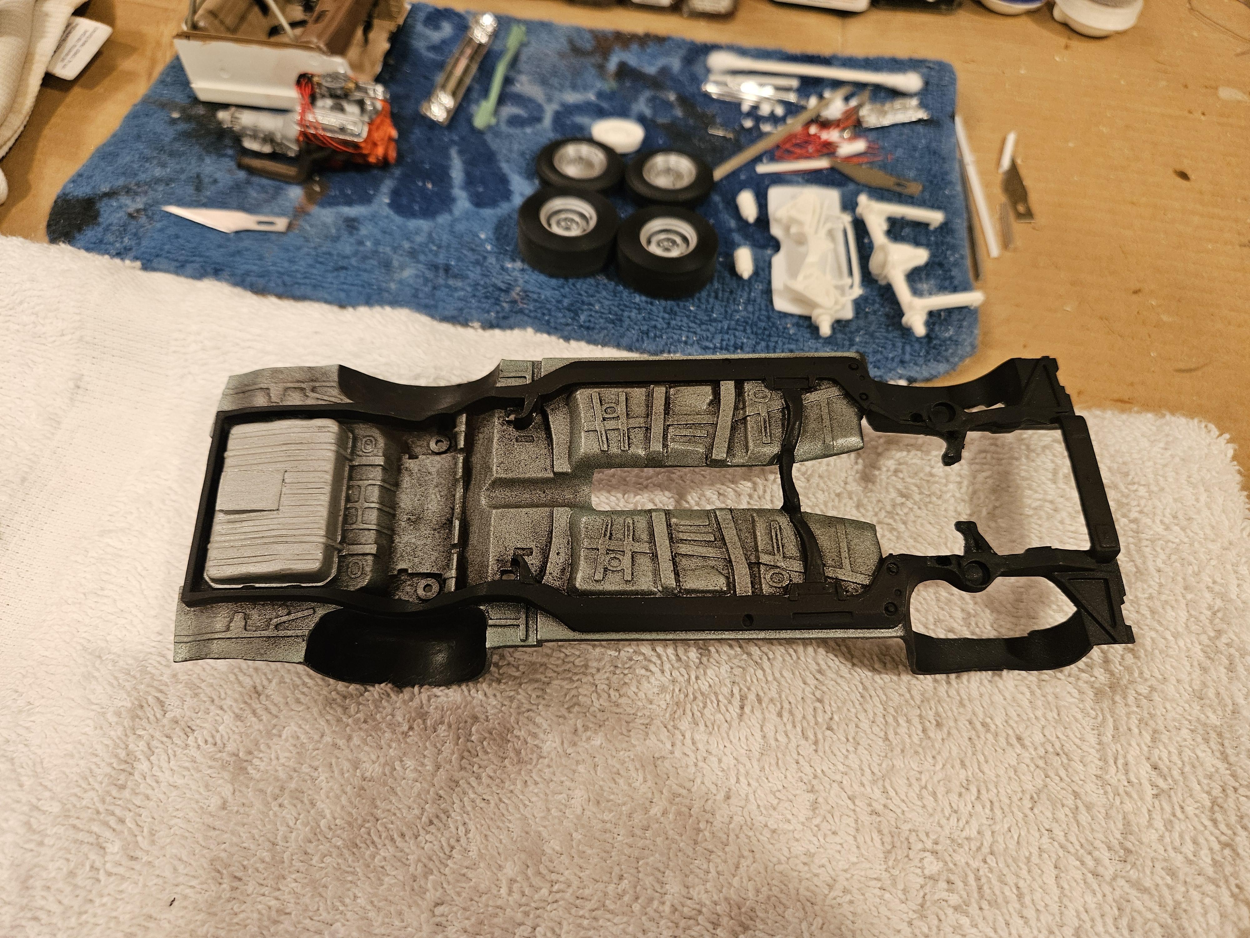

Progress is a little slow, still have to figure out the order of what to paint/assemble first in terms of the chassis/interior/engine. Have to cut out the shock towers for fenderwell headers to pass through but have to put engine together first to see where they will sit. Need to buy a resin scatter shield/lakewood style bell housing since I plan on leaving it as a 4 speed. I do have a couple 1:24th scatter shields from a few monogram kits, but they are just way too big. In the mean time I finished up the hood for the most part. Just a tad more sanding around the edges of the scoop and it'll all be ready for paint.

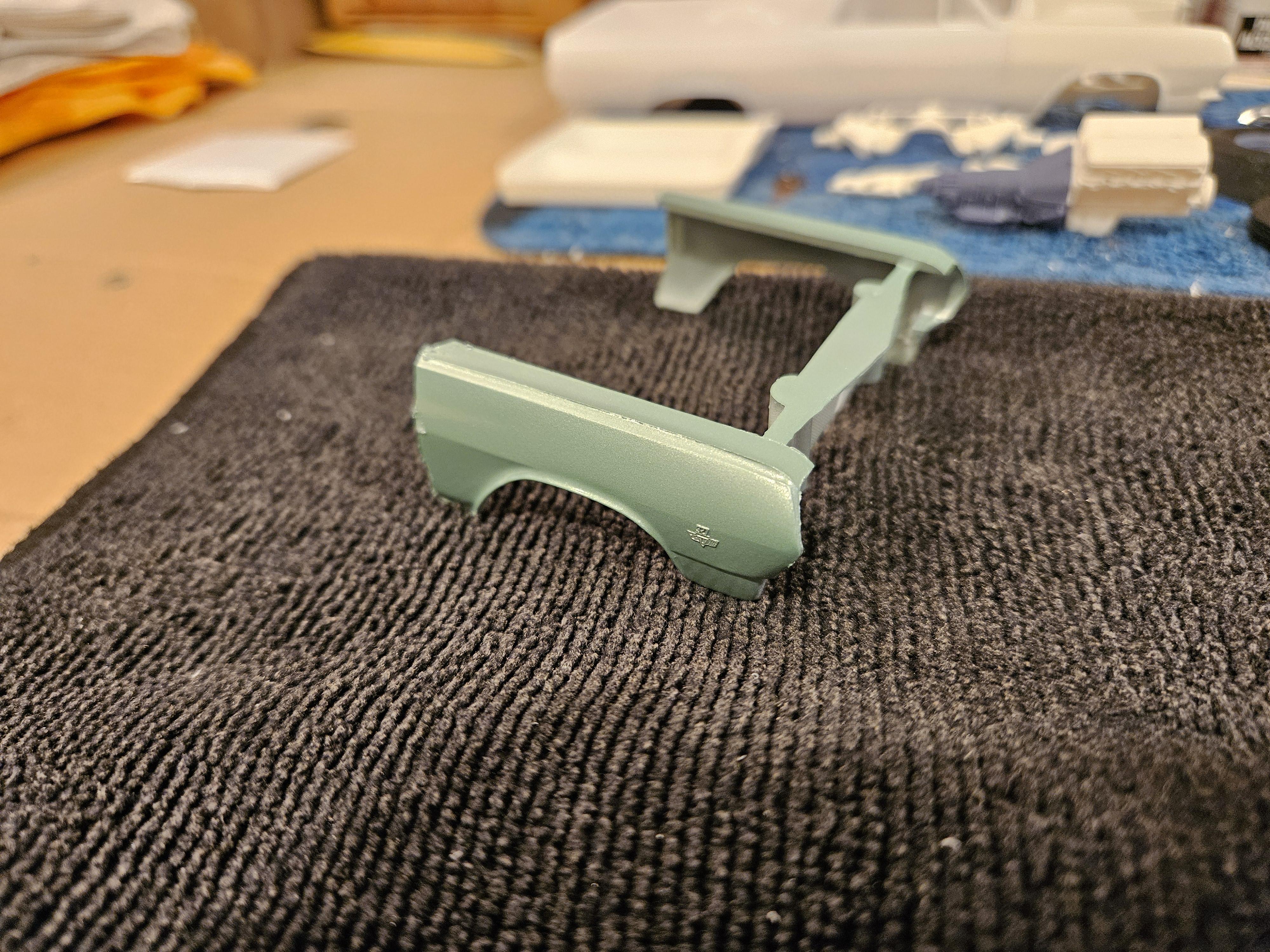

You could do what I did and swap a front clip from a Revell 65 malibu on..lines up pretty well, and looks way more accurate, and has a better engine compartment. -

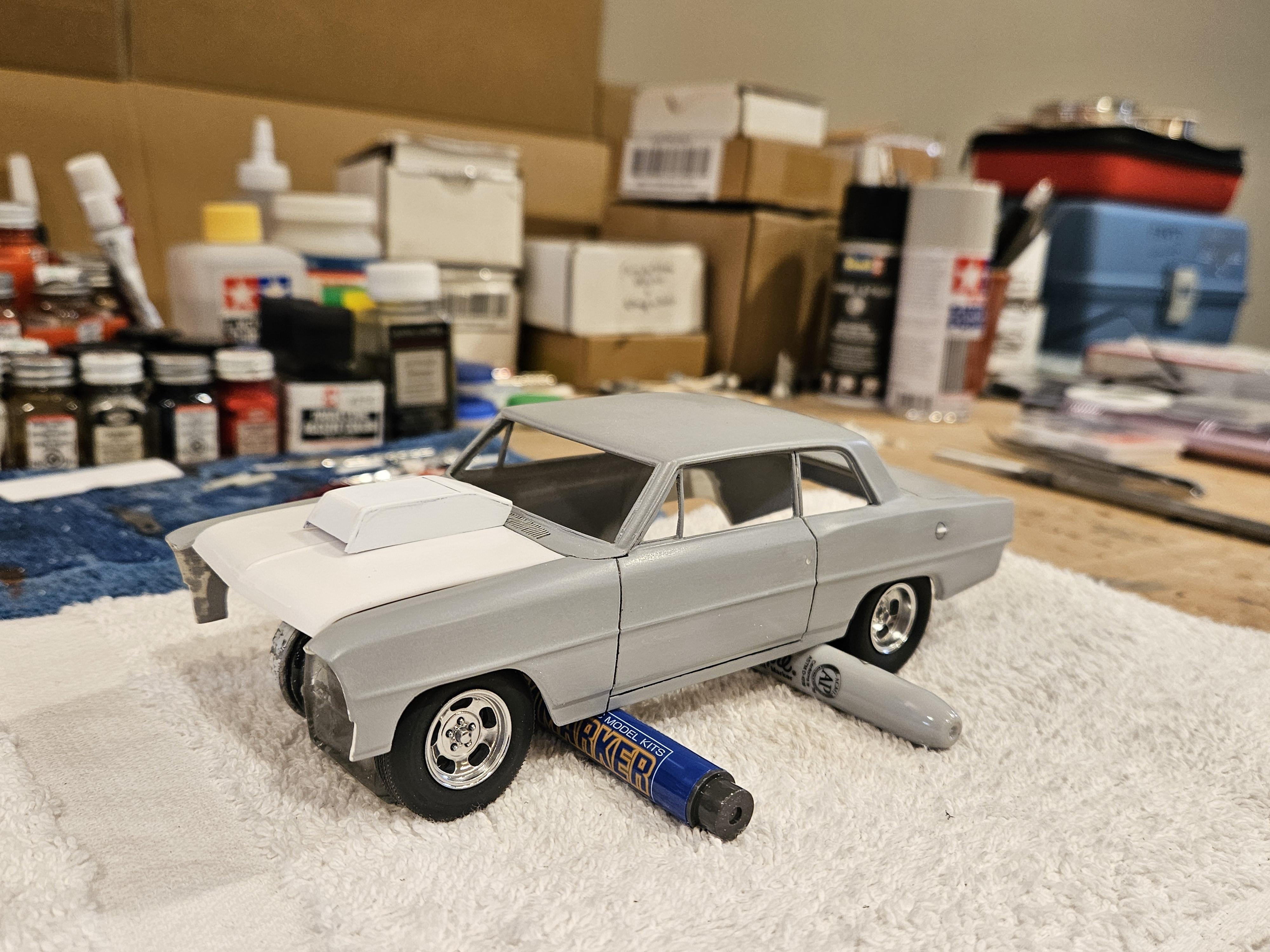

I think I figured out which wheels to use. Got these from fireball, painted them with revell chrome and drilled out the center caps in the rear. Smoothed out some front skinny bias ply kit tires to get rid of the firestone script and texture. Also scratch built a grump lump scoop out of styrene for a hood scoop.
Thanks! Took a bit of work to get it to this point. Now on to the chassis and engine.

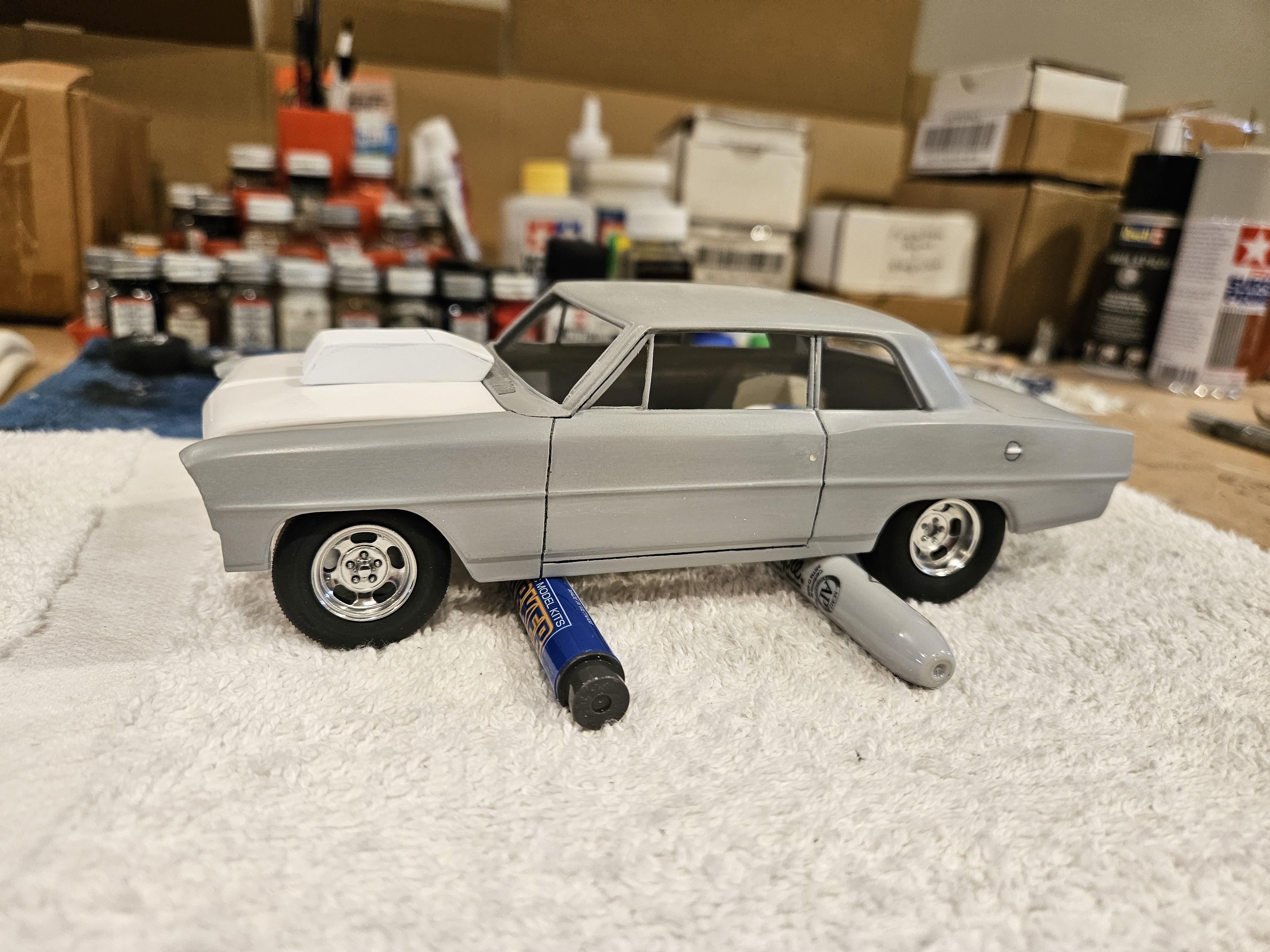

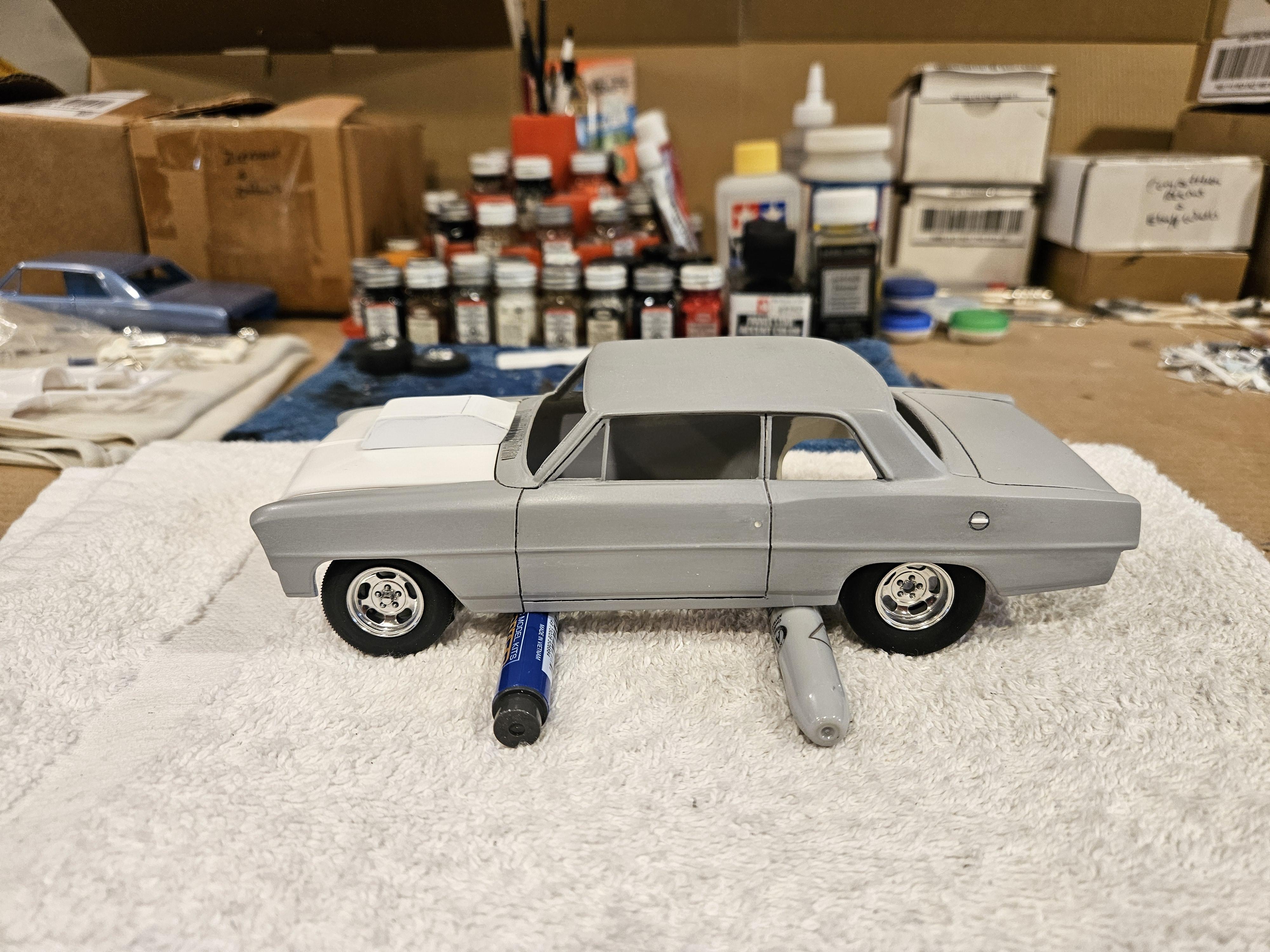

I've been wanting to build a 2 door post car for some time now and stumbled on a couple resin bodies in the aftermarket. One is from MCW which I ordered..its a really nice casting but just isnt quite right. The shape of the 1/4 windows are off and overall the roof line isnt tall enough to match the 1:1..looks like they used the meobius 65 nova sedan roof for the conversion..which is not the same as the 66/67. So I then stumbled on another 2 door post body on ebay from southern motorsports hobbies which looks much more accurate. When that showed up in the mail I was a little disappointed in how rough the casting was along with being warped pretty badly. I've spent quite a bit of time cleaning it up and sanding, grinding, filling and priming to get it to where its at now. At this point I'm pretty satisfied with how it looks to continue on with building it. Along with all the cleanup and un-warping it, I had to grind out the rear of the trunk lid for the recess area which is normally hidden by trim on the SS and hard top cars. Also drilled a small recess for the trunk lock that was absent. Plans are to build just a generic 70s small tire, stock suspension drag car, tunnel ram, fenderwell headers etc. Been playing around with wheels and tires to get a vision of what I want, sort of leaning toward the fenton gyro slot mags from the old Johan maverick kit. As far as paint goes I wanted something factory looking, was between a light blue, champagne or the factory Aztec bronze. I think I can replicate the Aztec bronze pretty close with a combination of paints. Here's what I have so far.
