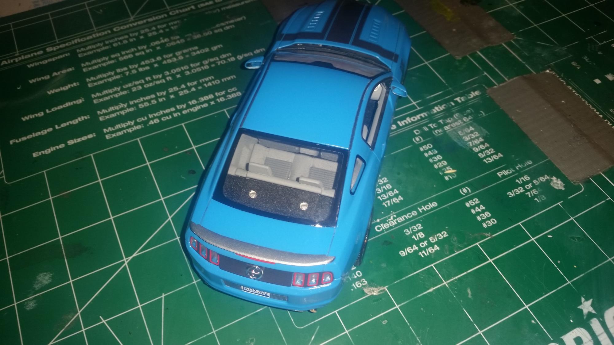

Here is a 2013 Mustang Boss 302 I just finished from the Revell kit. It is box stock with interior flocking done. This was the first time I used Gravity Colors paint and I must say they are superb. Color is Ford Grabber Blue. Primer is Plastikote grey and clear coat is Rustoleum 2x gloss clear. I also used the Gravity Colors polishing system for the first time. Had a bit of a fitting issue during final assembly getting the body mated to the interior and chassis but overall it's a great kit.
