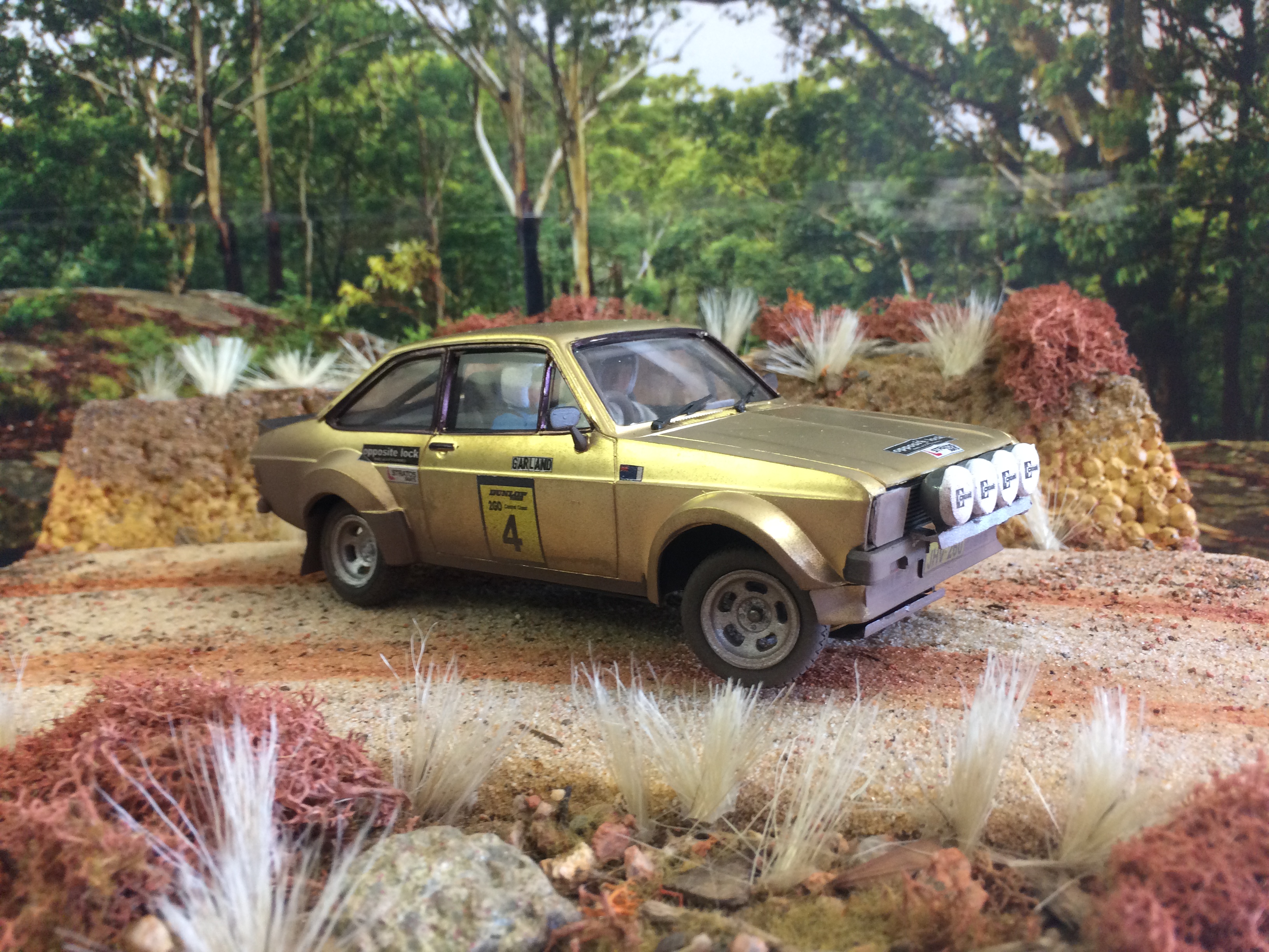

  5. OK, now the hard part. I need the Model car to have the same "stance" as the original car. BDA Escorts are known for there rear squat and tendency to lift an inside front wheel during hard cornering:
    As mentioned previously the kit is of a tarmac spec car with very low suspension while gravel spec cars sit 4-5 inches higher (e.g.4-5 scale millimeters).
    This how the parts look standard although I have lengthened the silly axle pin things to widen the track to suit the new wheels.
    These things work against aligning the wheels correctly, so I used a jig to square them up:
    You can see here that I have filed of the lowering blocks from the rear leaf springs. I have also added a sleeve to the front strut tops so I can raise the front.
    The front ride height was a greater problem. I wanted the wheels turned for opposite lock but the model is only a model and has no Lower Control Arms and the stub axle length is way too long. The result is that as the wheel is turned it moves massively forward or backward in the wheel arch, looking very wrong. I needed to space the crossmember a few millimeters away from the body as well to set the ride height. I was therefore forced to commit the crime of twisting the crossmember to position the wheels correctly. Fortunately the sumpguard covers up the dastardly deed. But for the Court's consideration, here is the evidence:
    And this is what I ended up with:

  9. Hi,
    This is a diorama showing a well known Australian car and Driver from the early 1980's. The Driver - Bruce Garland - is an Australian Motorsport icon and I have built this replica as a belated 60th birthday gift.
      dd113.jpg.b477583d47d7fcadff892ec608ccd51a.jpgdd118.jpg.395b65fd1b547b90c6cc7e62ebbf4c34.jpg   dd120.jpg.c033f620ad2a43d187c349fdfc7e1ebd.jpg
    I ordered the new Italeri kit knowing that I would have to change the wheels from the Minilites to the "Kidney Bean" design, but I did not realise how much additional work there would prove to be. I was a bit disappointed when the kit arrived and I found that it was Left Hand Drive and set with very low suspension height and that there were no Driving Light covers despite being shown on the box art. I then sourced and ordered wheels and lights from the US, tyres from Spain, harness belts from somewhere else and used some figures from my stock.

  10. Really nice work, Pat.
    I have just finished the same kit as a replica of a  famous Australian car from the early 80's. I converted it to RHD, reset the suspension stance (raised and extra castor - quite difficult for me), used the correct wheels and tyres and driving lights, then added figures, belts and homemade decals and sat it on a typical Australian Forest Stage.
