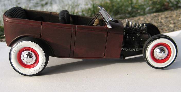

  20. Here are the pastel colours that I used on my Phaeton. Any earth tones would work. The darker ones are the ones I used the most, but the lighter ones come in handy too. Just grind them up into a fine dust and brush it on using any paint brush. I find that a stiffer paint brush lays it down a little "messier", so there are streaks, and a softer brush blends it really nicely. If you apply too much you can also blend it a little with your clean fingers. I applied it everywhere except for the tires. Make sure you weather the lines as well (fuel lines, ignition wire, etc.) I read somewhere that you can use dullcote over the pastel to seal it in, but I've never tried it.

    Here is my latest completed build. It's AMT's '32 Ford Phaeton. The engine is a 389 Pontiac with 6 strombergs, an aluminum magneto that I machined, solder headers and machined pulleys. I scratchbuilt the floor and interior panels out of wood. It is still waiting for a grille that is on order and I have a moon style tank with a brass cap that I made for it. Thanks for looking. I hope this works...kinda new at the photo thing. Here is a wheel that I am working on for my next build. I machined the hub cap and the trim ring on my lathe. Not really sure how the pictures got all pixelated....I'll try to post some better ones later
