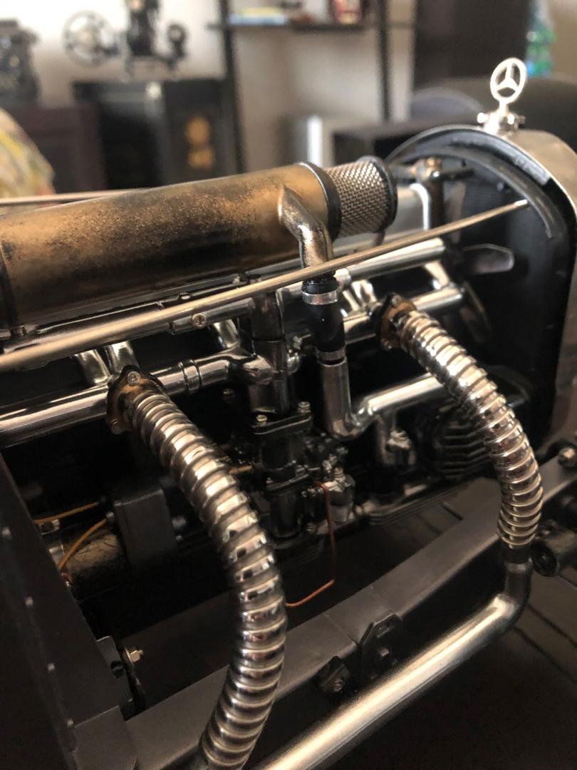

  3. replace the original exhaust pipe from the Pocher kit who are not very nice by metallic straw founded in DAYSO .. Cheap , the exact same size and looking way better . finish my spoon testing paint .. this blue will be the one, a pearl blue .. and the rims are done with the Mercedes logo .. this project is getting closer to the end . next step is the real deal with the paint of all the part ...

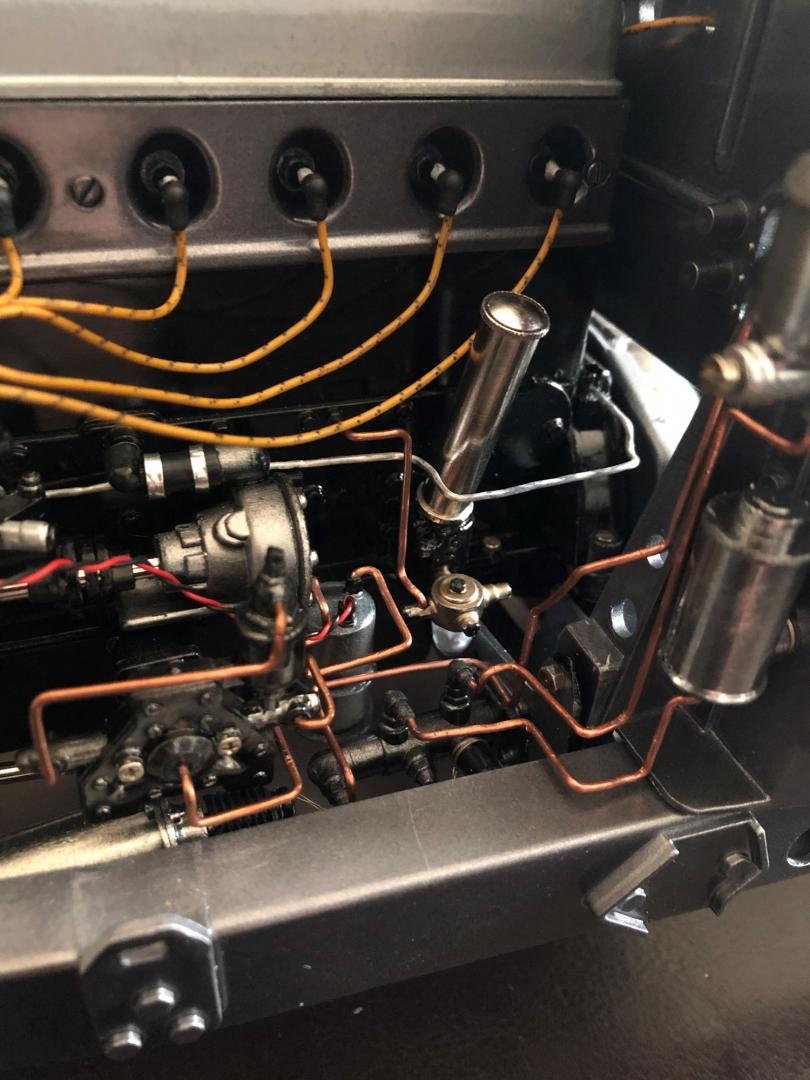

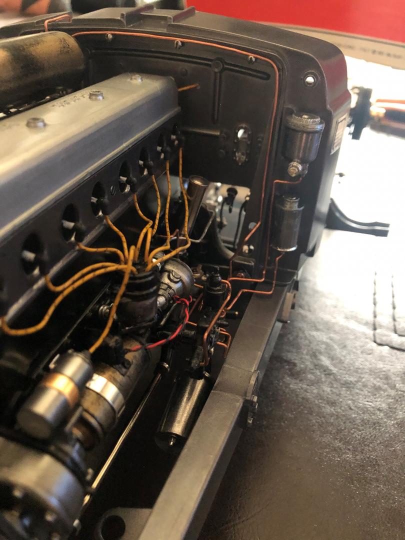

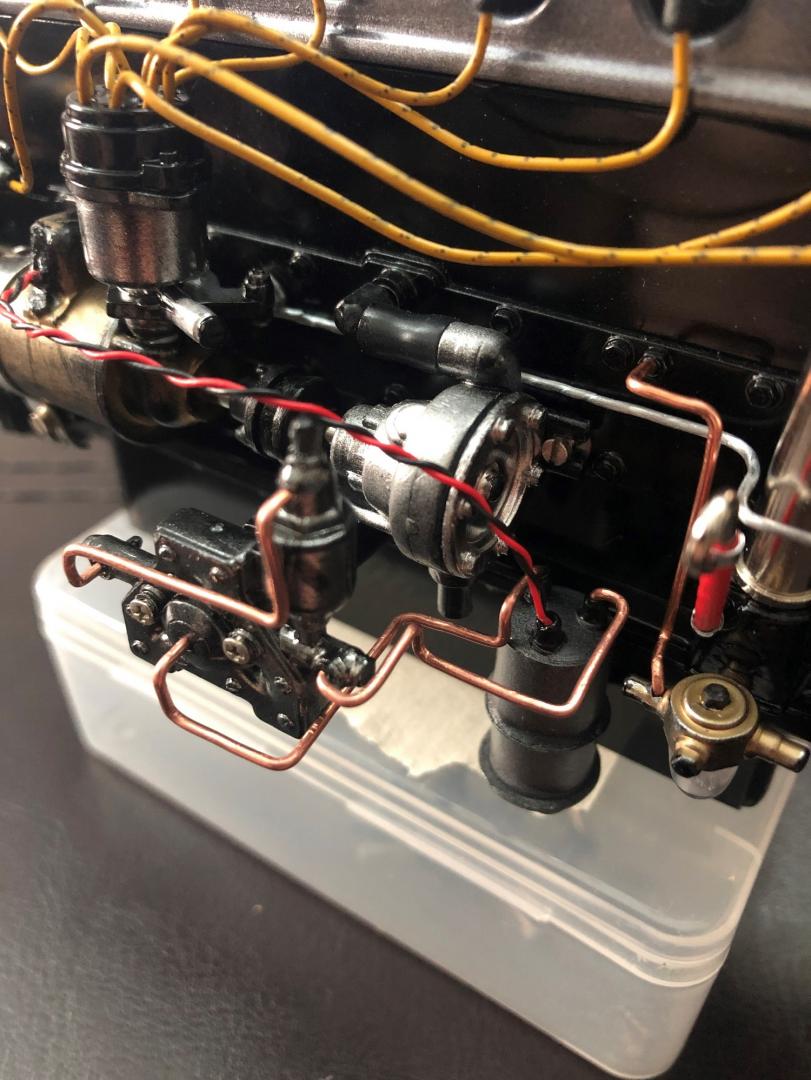

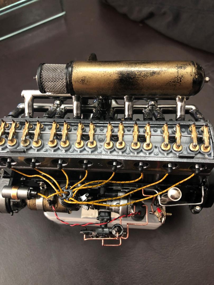

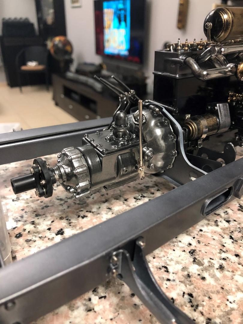

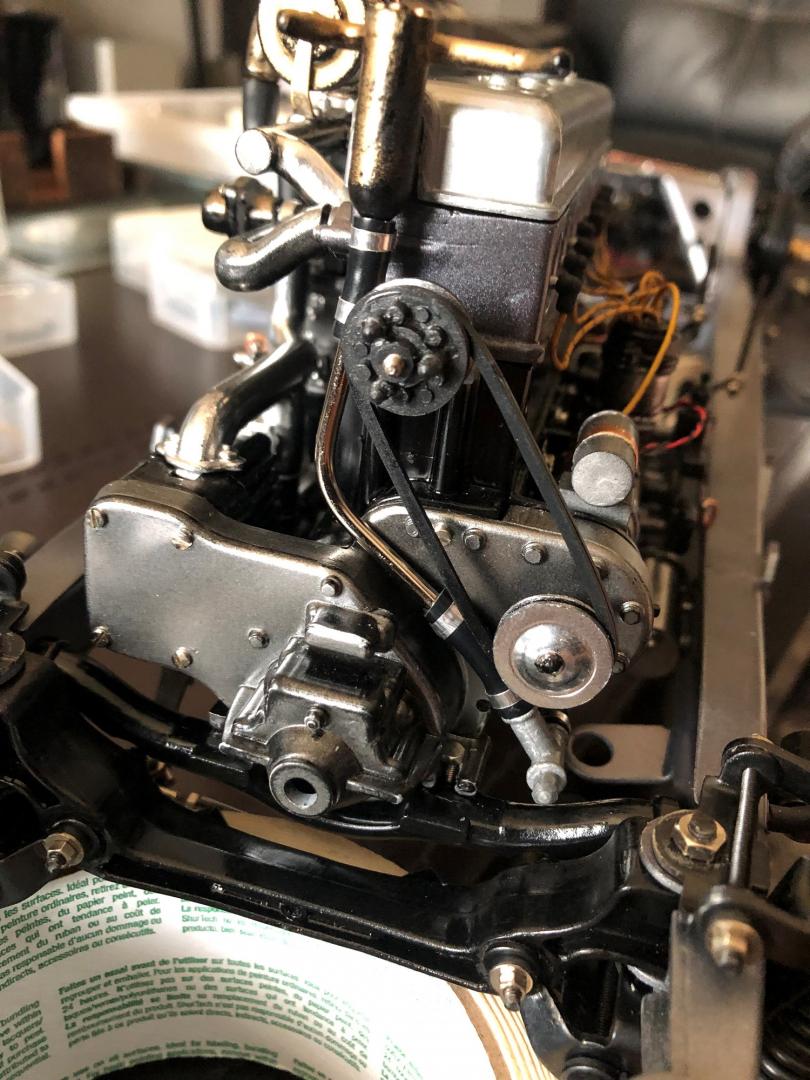

  14. thank you , the yellow wires are from the Pocher website of Marvin https://www.modelmotorcars.com/ There is a shop section with all upgrade parts available depending on your model you are building . the black ( head) part connecting are the original one from the kit ( you cut and remove the original black wire , drill a small hole in the head and connect the yellow one inside .) then for the red and black one , taken from an old digital camera that I open apart , and took small screws that I added to the engine part for more realism , the red & black wire were thin enough and adding some different colors, for more detailing final impression. ( improvisation is Pocher philosophy.) !!!!!

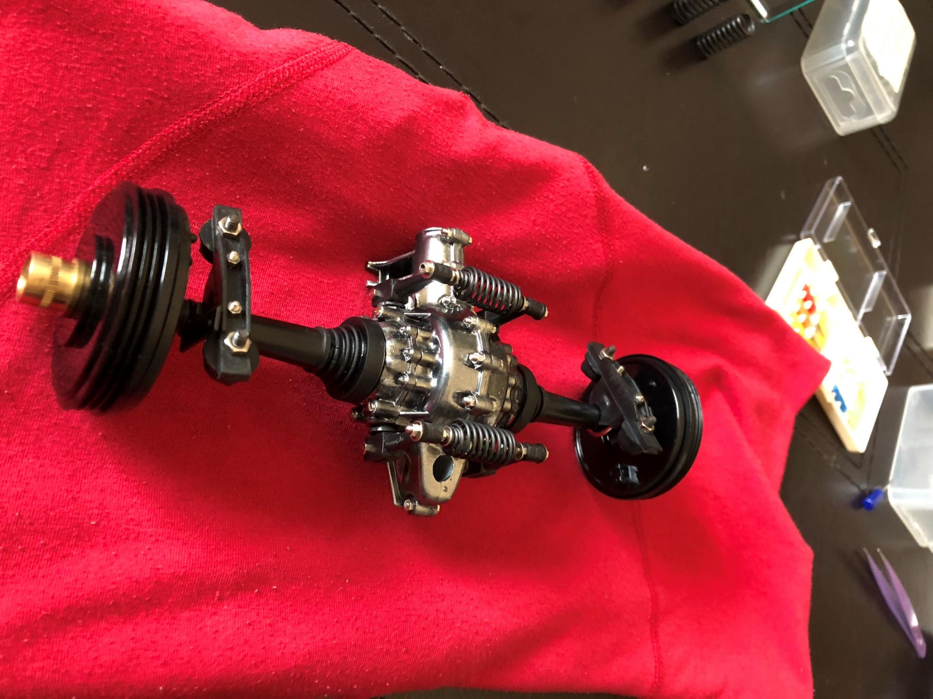

  15. detail of the engine and all pipes , wires connection . my stage 2 of the completion is done , stage 1 was the fitting , stage 2 the painting and re assembly , stage 3 will be the body frame fitting, then painting , leather seat upgrade dashboard aluminium and mother of pearl , and all finals details . painting should be a blue .. still searching the one that will be matching the light beige or white leather seat ...

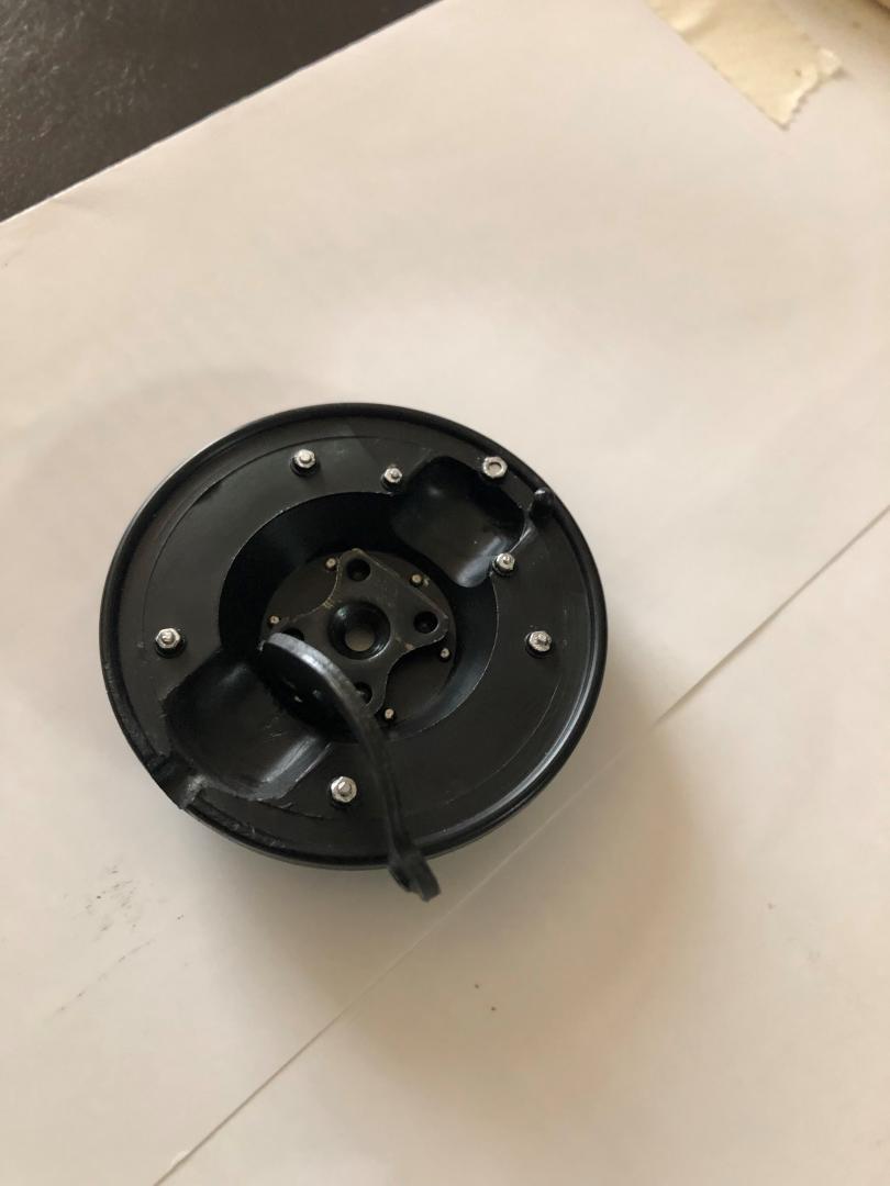

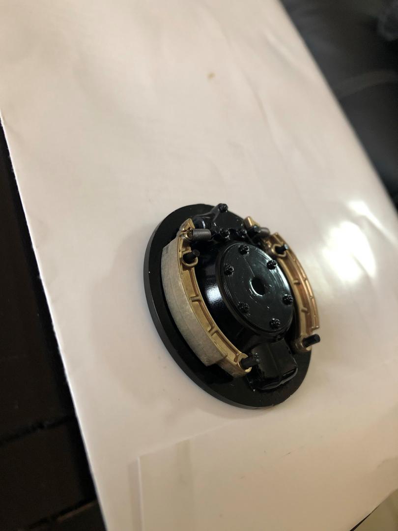

  16. Brake pad painted Alclad II polished brass

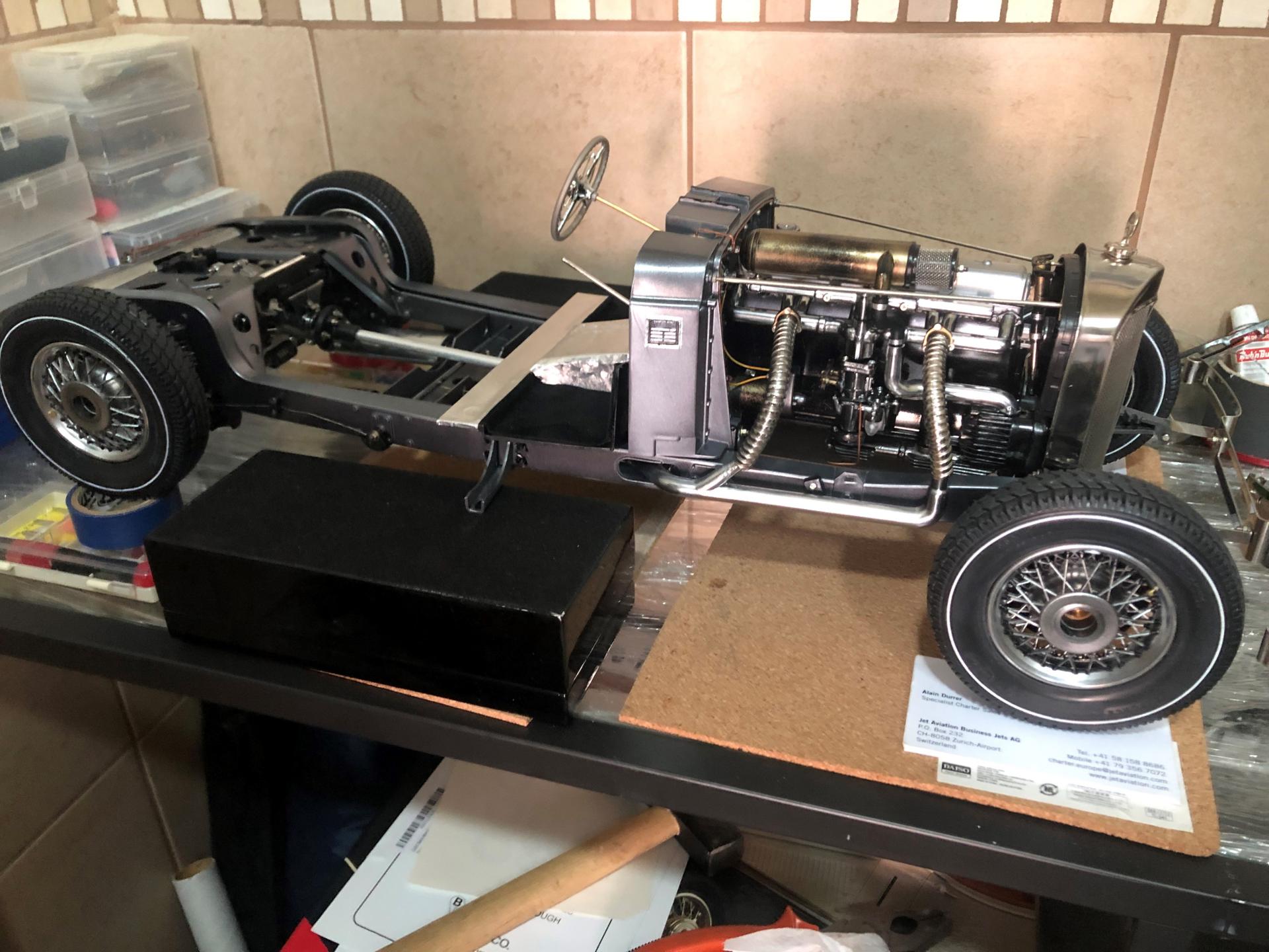

  17. Very nice model . Do you still have it ? My goal was entire white wall , but was not sure at the result on the border edge close to the rims . That why on the rim you can see a black lane n case the tire doesn’t fit perfectly .. , then the plan was to put the writing details in white as well , on the tires number 6 that I will not put . (Only 1 spare at the back ) . Impossible to get a clean work . So then I back up on a single small line .. finally am happy with the ending result .. and was scare with hot water and the white to melt or make a mess .. not sure yet what I will do with the trim and the upgrade metal logo I have ..

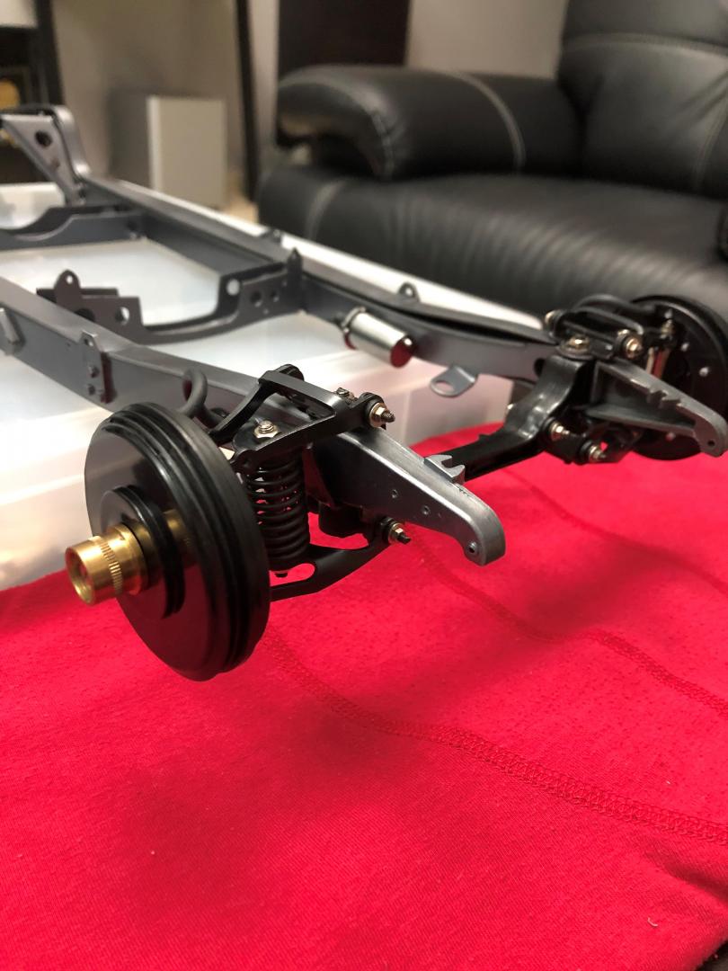

  18. wheels and rims .... hard to decide how to paint those rims and then insert them as the original tires are very hard and lack of flexion . I decided to paint the rims then trying without damage to fit them inside . it was a risk . i did a thin white line on the tires , the rims have been paint in gloss back first then Alclad chrome , then end of the spoke have been re paint in black manually with a brush , a brass bolt have been added to simulate a valve that doesn't exist ... the Pocher wheels use to be amazingly done , but the K91 model was a disgrace on that part . try my best to upgrade the final looking. I unfortunately loose the mirror effect of the Aclad paint during the assembly as I had to put Vaseline as it was nearly impossible . will have to to do the trim . this will be later on .
  19. engine partially done , will continue the wires connection and fitting when it will be connected on to the frame ... just missing the top cover with the MERCEDES Benz inscription , need to re do it as I was not happy with the result ... and by trying to much I damage it , Marvin from modelmotorcars.com save me as he had an extra one . I got it , and will do it later on . next step : frame body assembly / wheels and rims / triangle suspension front and rear / gas tank exhaust line and muffler .
