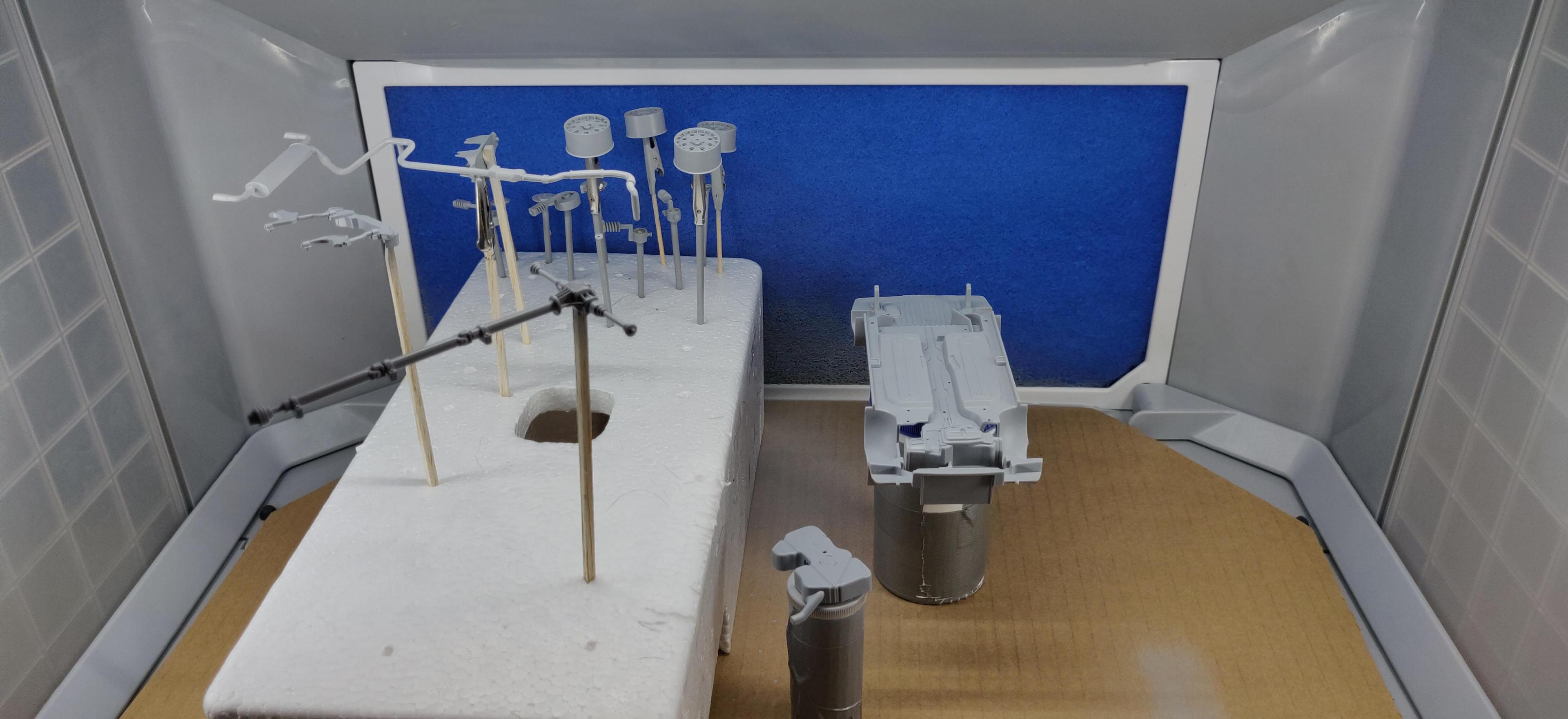

I put the first coat of primer on some parts (chassis, rims, etc..) Primer : Zero Paint light grey Airbrush : Harder & Steenbeck @15psi There is still some work on the motor and the body. If you're interested, I made a first vidéo for this model building, step by step:
