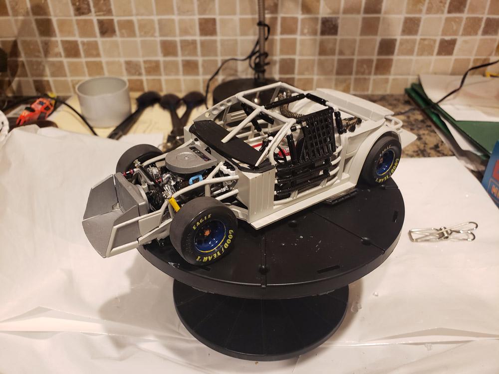

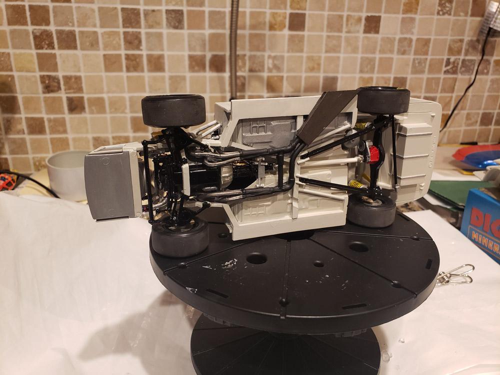

  3. Chassis is done! First attempt at creating my own window nets - cut and layered strips of painters tape to make the effect.

  5. Chassis update - only a few more pieces to go. I ended up adding a 'Ford' rear parcel shelf to this build as well because the Chevy ones included with the kits from this time period look horribly inaccurate when looking through the rear windows of the real cars.

  7. Pushing forward and trying a few more interior modifications than I had done with Andretti's Pontiac. I had a pretty decent in-car image of Jeff Gordon from 1999 sometime that I was going to try and base the look off of. I knew the driver seat that came with the model wasn't quite going to cut it. So I dug into my junkyard and found one of the newer driver seats after Revell made the after change over.... so like >2003ish? I had to clip the driver side 'wings' off of the seat as they prevented the seat from sitting straight inside the chassis. But I'm going to attempt that little secondary triangular window net that was used during this time period so they weren't needed. Cut the plastic window net out as well - going to try and create my own! I also clipped the ignition modules off of a newer brace bar and relocated the fire extinguisher to a more accurate spot. Fabbed up my own leg protector for the side of the seat using some layered painters tape and glued that in place as well. Gauge dials were painted with my ever trusty toothpick! I'm leaving the steering wheel off because I have an idea to put a driver figure standing outside of the car. I think it is coming together nicely!

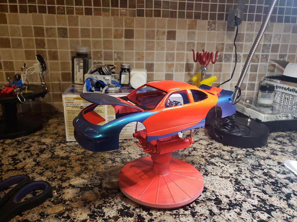

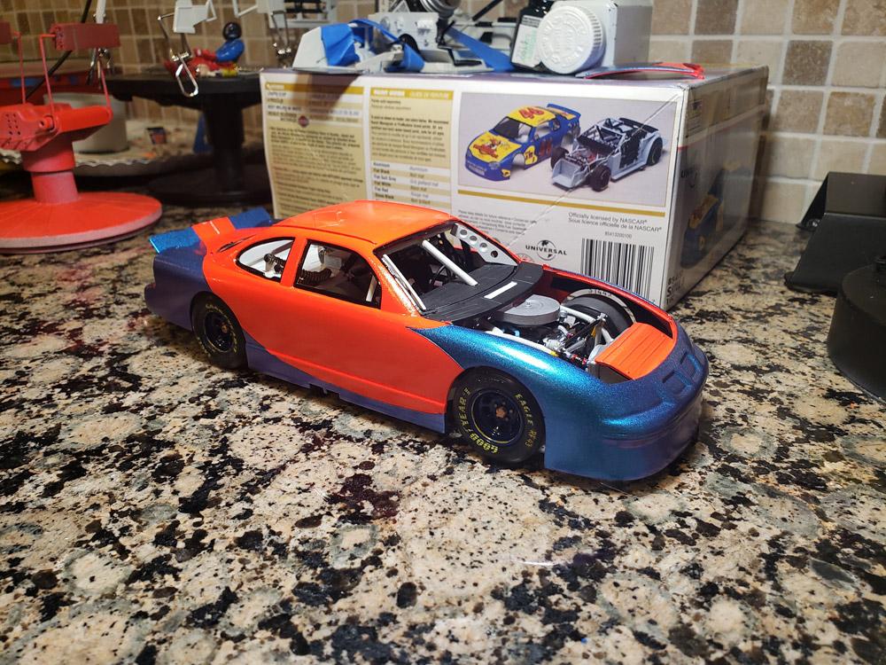

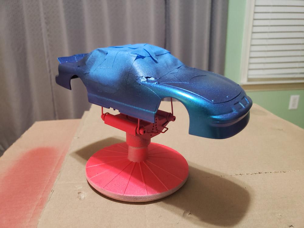

  10. Borrowed an airbrush from my Father-in-Law (a huuuuuuge scale train nut!) to lay down this colorshift and I gotta say..... I think I need to go buy my own. So much more control over the flow and finish than a rattlecan! Seeing how this turned out gives me goosebumps - only a tiny bit of residue from the painters tape that needs to be addressed. I can't wait to get started on decals!

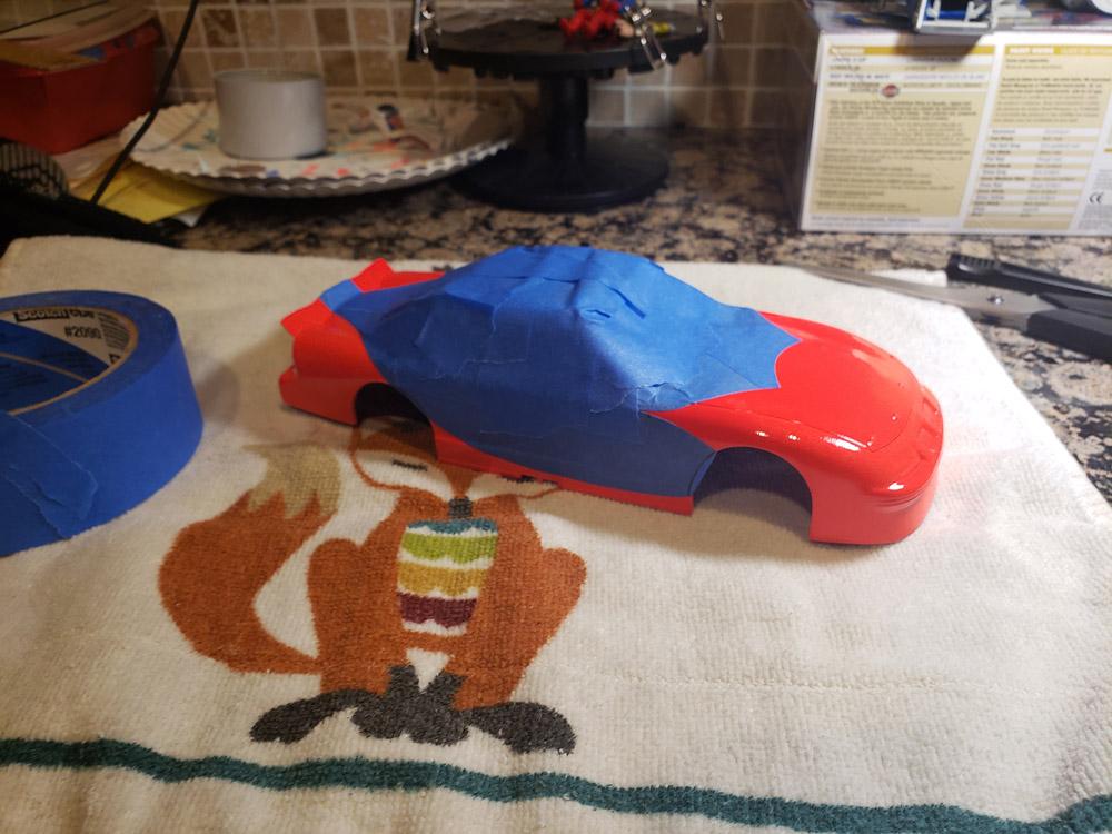

  11. Tried my hand at creating a masking template using a super spiffy technique I saw a modeler use on a YouTube video. The basic gist is that you find a pane of glass (like from a photo frame) and place the decal sheet below it. Then you cover the top of the glass with painters tape and use a hobby knife to trace the design you need off of the decal sheet. You can then easily peel the tape up from the glass and transfer it to the car body. Rather than freehanding the side swoops with 2mm tape on this one - the above method is what I went for. Made sure to burnish the edges to press them down good. Only had one small instance of spray leakage on the trunk so I consider that a huge win! Laid down a base coat of black before 3 coats of the Celestial Azure colorshift.

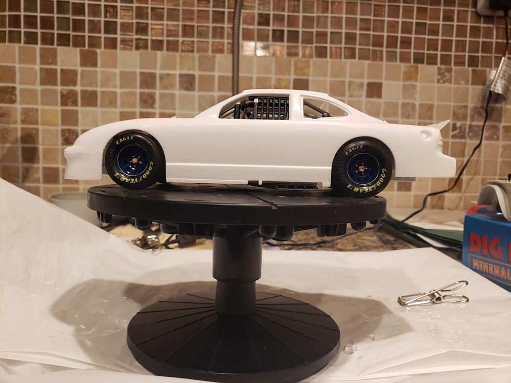

  12. Moving on to the paint booth....... Primered and then shot the whole body with TS-36. Wet sanded between a few coats. (IGNORE THE OTHER SPICY BIT TO THE RIGHT IN THE PHOTO..... we'll discuss that one in due time ?)
  13. On the outside I did my best to putty and sand the the seam between body and front bumper and make it disappear, as well as completely smooth out the lower grilles so a later decal lays flat. Then, because I am making this one a single side exhaust, I cut out a chunk of the driver's side-skirt to leave room for the larger pipe and then puttied in the gap on the passenger side.

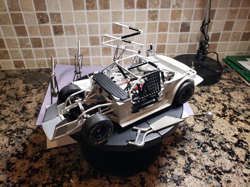

  14. On the chassis I scuffed the rolling surface of the tires, borrowed a single side exhaust pipe from my scrapyard to make this build race accurate, chopped the rear springs a little bit to get a completely level stance and cut a little extra piece of parts tree to create an 'Earnhardt Bar'. Also from the scrapyard, the larger more period correct engine air cleaner.

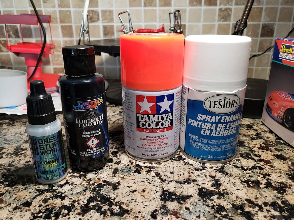

  16. This is my first deep dive into a modelling project after being absent from the hobby for a loooooooong while. So of course I wasn't going to go easy on myself! ? The special reverse & chameleon colored STP / Glasurit Paints scheme that Andretti drove in two races at the tail end of 1998 (the Pepsi 400 'Thank You Firefighters' version specifically) I've wanted to build this paint scheme for since the early 2000s but never really felt I had the skills and know-how to do it properly. But this new urge is spurred on partially by seeing the Testors line of colorshift spray paints available in my local craft stores. I bought a few colors, played around with them on some test bodies and decided the effect wasn't exactly what I was looking for...... but then I went on a search to find one that did match the real car as close as possible. The original paints that the actual car was painted with have long since been discontinued - but I landed on GreenStuffWorld.com and sampled a handful of their airbrush colorshift paints. All I can say is, WOW. Color, quality, ease of application - these guys have it covered! Their 'Celestial Azure' (a teal to purple shift) was my final choice for this build. Paint chosen - I bought 2 sheets of the old Slixx decals for this car from Mike's, a Revell 96-2000 Pontiac donor kit and set to work!
