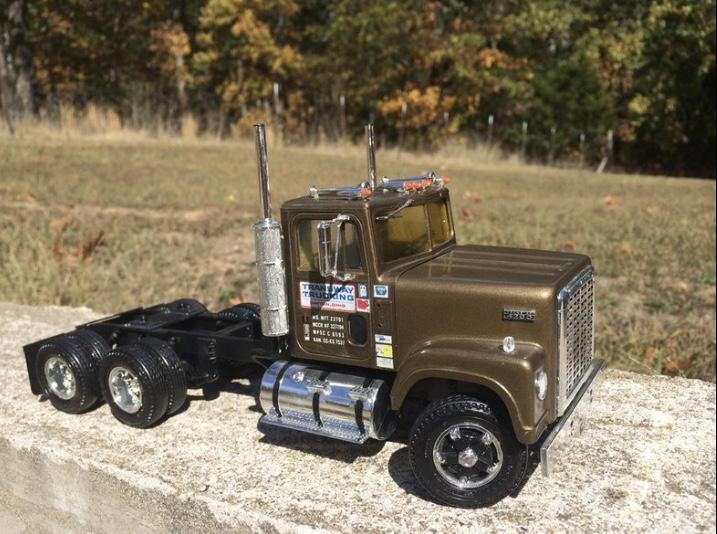

  14. I was debating holding off revealing the color I chose, but in good conscience I couldn't. The reaction from the gang here has been far too positive to keep it from you folks, so its time to unveil the paint for the F-4270. Tamiya TS-15 Blue, rubbed out with Meguiar's Compound, followed up with Meguiar's Polish. Stripes are decals courtesy of Modeltruckin'. I have mixed feelings about them, which we'll get to in a moment.
    As I mentioned, I'm having mixed feelings about the decals. As far as quality goes, they're excellent. Thin enough to do most of the conforming on their own with only a small bit of Micro Sol needed for some of the harder contours. But, here's issue number 1. Minor, but I'm nitpicky when it comes to stuff like this. It's slightly difficult to see but the lower blue stripe (clear decal) on the cab decal is narrower than the hood. Don't let the cowl intake throw you off, that's an extra scrap of the hood decal, since these are made to fit the 4300 as well. I trimmed approximately 5/16" off the hood side decal and it was perfect for the cowl vent. The cowl vent reinforces my stance on the fact these are quality decals, as I was able to conform around it with one relief cut and Micro Sol.
    Which brings me to my next conundrum. On the decal sheet it was impossible to tell how thin the decals were as the backing was that light blue that we're all accustomed to. However upon application, the decals are quite grainy and have a flat finish. The latter could be remedied with clear coat, but I'm not planning on clearing the paint since it polished out so well, and it has that '70s single stage look I was after like the real trucks had. I have an area on the cowl vent that overlapped the decal and boom, bright white. That doesn't solve the lack of gloss, but it means I could layer these decals and they'd be fine...but it means I'd have to order another set. I'm not averse to layering decals, but as opinionated as it sounds, I don't feel like I should have to. I've reached out to Mr. Reeter at Modeltruckin' to see if maybe I got a bad set or if there's something he's willing to do before I just go buying more. I haven't gotten a response yet. Make no mistake, I am not bashing the man, the business, or the product, I am personally just not completely satisfied. We'll see how this pans out, and I will keep you posted.
    Aside from all that, I'm 100% satisfied with my paint and decal choice. I love the look, and I've started to trim out the cab with painting the window trim and things of that nature. There's still a few details to pick out, the door jambs need a black wash and the decals need some secondary trimming and touch ups (regardless of what happens next) I'm going to pause for a bit until I decide what the fate of the stripes are, so it might be a couple more weeks before I update, or I might hold out until it's ready to move under glass.

  16. Just a quick update for today. Not a lot of progress to report, but as usual, the last 5% takes the most time. The chassis is up on its wheels, and most of its accessories are on. Fuel tanks are painted up to look like raw, unpolished aluminum with gloss black straps. My research showed that this is how aluminum tanks from International were finished as standard. I debated painting them black to look like steel, which were chassis color by default. Again, I've been sticking to the plan that various brands, sheens and shades of the same colors will bring out the details. I also have the cab and hood taped to get a little warp out of the latter. I was able to work one out of the battery box in a similar fashion so I hope a couple days taped together does the trick. My decals from Modeltruckin' arrived last week, and they look fantastic. I'm still up in the air on what the base color is going to be, despite my original desire to go for a box art look. So for now I'm going to leave it primered and figure it out one of these days. We had a couple nice days here in PA over the weekend, but I was too busy to paint. Now that I've got some free time, the high for today is 51...
  17. Back again with what seems to be a weekly Monday update, not that I'm complaining. I got to make a little progress Friday and yesterday. I attended the wedding of two very good friends of mine Saturday, so that was a worthwhile interruption.
    The grille had some odd discoloration, and a run in the original chrome. I cleaned it up and foiled it with some aluminum BMF, which I feel more represents the anodized grille on the real trucks. My work on the other hand, I'm unsure of. Might peel this off and redo it if I decide I can't live with it. I've polished BMF before, so I might do that and brighten this up just a touch. Emblem is washed with Tamiya black panel line, many times, then gloss coated since that dries flat. I'm completely satisfied with that part.
    Chassis is Duplicolor universal gloss black. I never got a decent black paint job with this stuff on a body, but it looks about perfect on a chassis. Go figure. Engine is Tamiya black, trans is Duplicolor semi-gloss engine enamel. Exhaust is Rust  Oleum Canyon black, manifolds are gunmetal metalizer with some rust shading. I'm trying to represent a brand new truck that's either sitting at the factory for transport or sitting on a dealer lot. It's been started and lot driven, so a little flash rust is beginning to set in. Airbags and mud flaps are a mix of various black shades. My local hobby shop was out of Tamiya rubber black, so this had to stand in. I hand painted the IH Man on a Tractor, and despite my best efforts it looks blurry as all get out. In person, it looks virtually flawless. Cameras are so cruel, aren't they?
    And last but certainly not least, the wheels. These were stripped of their chrome, base color is Rust Oleum Aluminum, spokes are good old Testors black to get that enamel deep shine. Wheel wedges are flat silver, lugs are metalizer, front hub caps are flat aluminum. Keeping with the MO that different shades of the same color bring some variety.
    And a couple of parting shots. The 903 is nestled home with the radiator. The fan was dechromed and it was this neat bronze colored plastic, so I left it. I usually paint my fans off white, as it seemed like most of the real ones I encountered were some sort of fiberglass or other composite and were that color. I'm going with the same idea for this. Plus it breaks up an all-black powertrain. Front steering is hooked up and functional too.
    That'll be all for now. I've placed my order with Modeltruckin to get some box-art style decals. I ordered a white set, as well as another color as I'm contemplating changing up my original idea of box art colors. I'm going to keep that under wraps until I decide what I'm doing, but I wanted to keep my options open. I'm going to get the cab and hood prepped for body and paint this week hopefully, and hopefully have a color picked out before my stripes arrive. This thing is practically building itself, a testament to Ertl's excellent development of this kit nearly 50 years ago. The only issue I'm having is the manifolds. I've got a feeling I'm going to have to fight them a bit, but I'm ready for it. It's also nice to build something straight from the box for once, it takes a whole lot less time than the stuff I decide to do a bunch of kit bashing or fabricating on. I'm already gearing up for another variation on the Cornbinder theme here, since I've got a few laying around now.
    Thanks again for looking!
