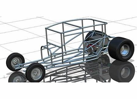

A 1:1 20" wheel (just as an example) will be 3.33 " in diameter in 1/6th scale. That is just the wheel, no tire. Very expensive to 3D print. Do you have a style in mind? A simple salt flat style disc would be easy enough to hand form out of aluminum sheet over a bowling ball or other large diameter object. If you have any woodworker friends with a lathe they may be able to turn some rims out of hardwood. Fill and prime to get a smooth surface for paint. Same thing for tires, turn out of hardwood or black Delrin plastic. For the engine you can scratch build anything you want. Use a kit engine and photos as reference. Mark

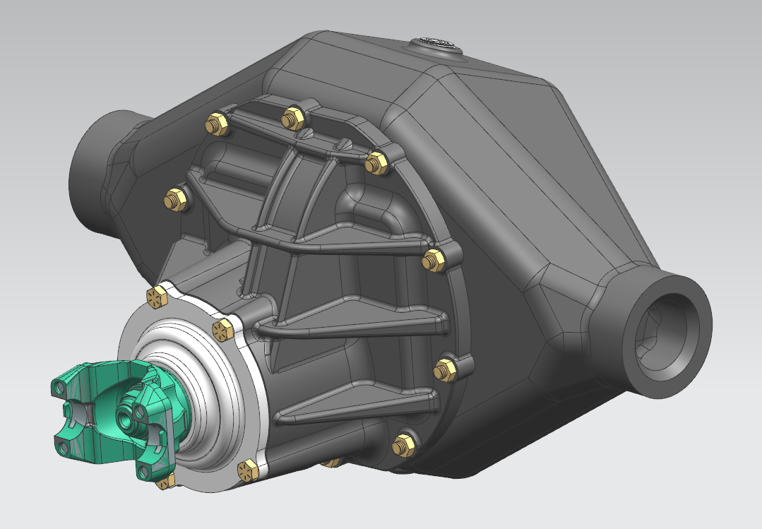

Just a tease for some more stuff I have been working on... I modeled the rear end up and sent it to Shapeways Monday. It will take a week or so to get it back but I'll get pics when it comes in…. The housing is modeled along the lines of Curries Fab 9 fabricated sheet metal housing. I also included some drive shaft yokes to build a shaft. I will make the drive shaft and axle tubes out of aluminum tubing. The first pic is of the housing assembled. the last two are as I sent them to Shapeways for printing.

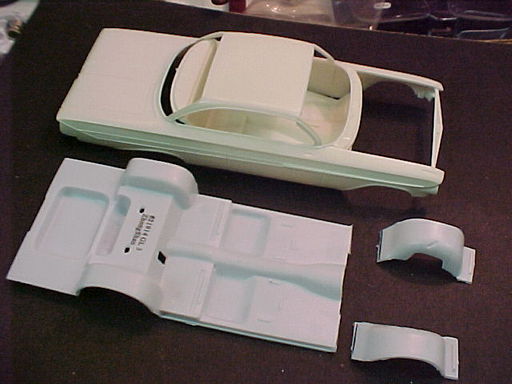

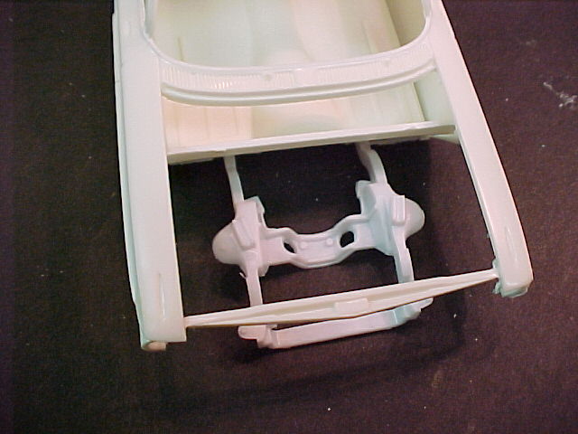

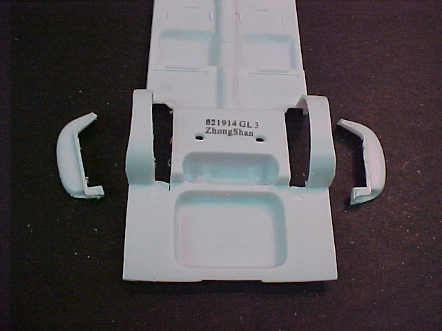

I took some time to do some chassis prep on the Pro Touring build. I am starting with a Lindeberg '61 Impala. I am kit bashing the chassis out of Revell's '64 Impala to get the separate chassis/pan. I trimmed out the Lindeberg front inner wheel wells from the body and cut off the inners from the '64 chassis pan. This will give me plenty of room to route turbos and plumbing. I will replace the missing panels with aluminum pieces. I also made some mods to the rear inner wheel wells so I can get some bigger tires in there. Doing a "Mini-Tub" using the stock inners, cut out, trimmed and then glued back in. The gap will be filled with sheet plastic. Thanks for looking Mark

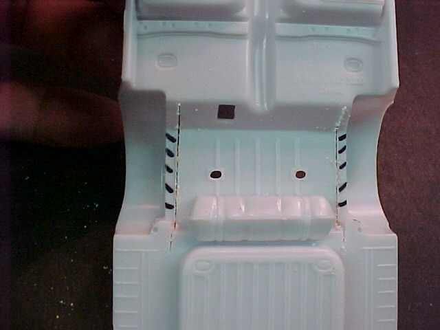

Wow! No comments at all? That's surprising... Anyway, I took some time to do some chassis prep on the Pro Touring build. I am starting with a Lindeberg '61 Impala. I am kit bashing the chassis out of Revell's '64 Impala to get the separate chassis/pan. I trimmed out the Lindeberg front inner wheel wells from the body and cut off the inners from the '64 chassis pan. This will give me plenty of room to route turbos and plumbing. I will replace the missing panels with aluminum pieces. I also made some mods to the rear inner wheel wells so I can get some bigger tires in there. Doing a "Mini-Tub" using the stock inners, cut out, trimmed and then glued back in. The gap will be filled with sheet plastic. Thanks for looking Mark -

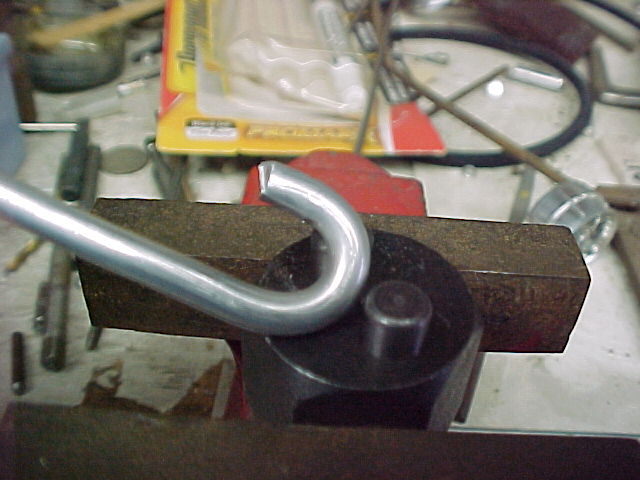

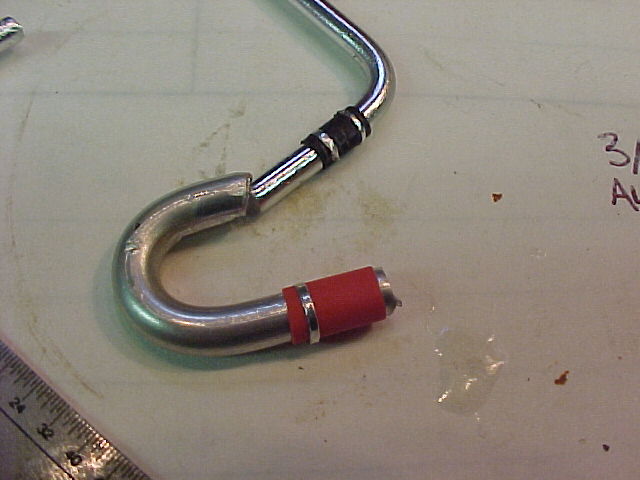

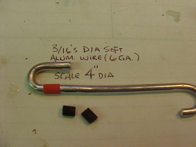

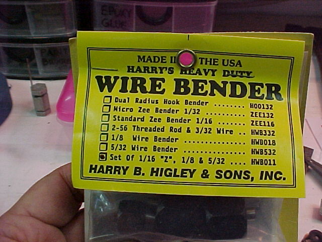

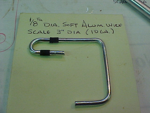

Did a little experimenting today. Working up some piping with soft aluminum wire, heat shrink tubing and some aluminum furnace tape. These are pretty rough as I did a quick and dirty proof of concept on what I though would look pretty good to model the pipes and couplers in scale. What do you think? With a little time and more careful building I think these will look great. Mark -
