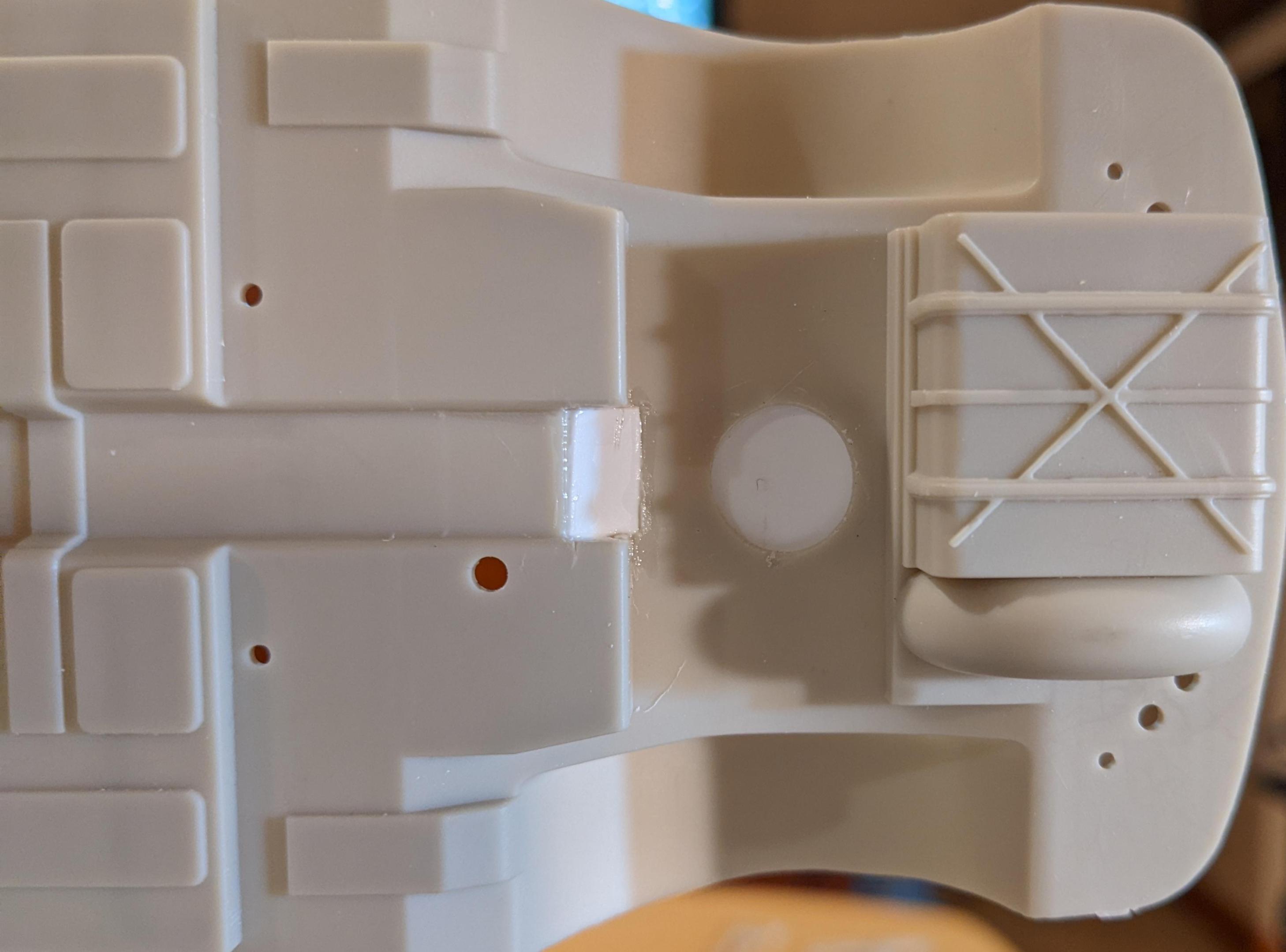

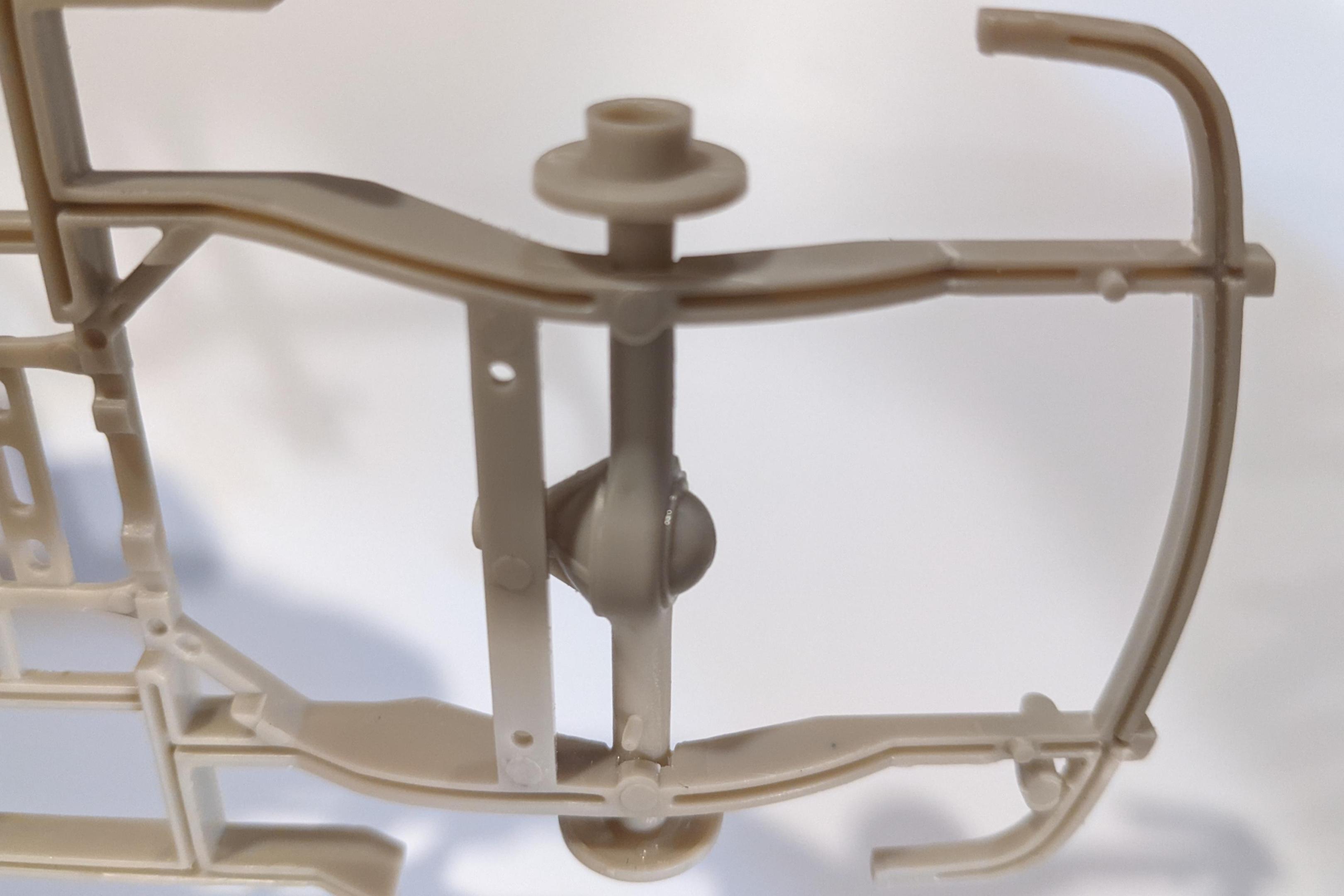

  1. I've built models off & on since I was a kid, but now I'm retired, I can put effort into modifying them. Here is how I'm lowering a Moebius 1952 Hudson Hornet coupe. The technique should work on any of their kits that share this chassis. I'm lowering the rear 3mm & the front 5mm, to also achieve some rake. I plan to use the chrome steelies from the convertible kit, which I also have. I'll show the rear, which is as far as I've gotten, then add the front later. Hope this post is useful to folks & comments are welcome. First, I notched 3mm from the frame rails to raise the rear axle relative to the body. Then, I cut out a portion of the floor to clear the driveshaft, and another to provide clearance for the differential. I added styrene sheet to fill in the holes. Finally, I added 3mm tall blocks to the leaf springs, made from square styrene tube. This mod provides an eventual connection to the axle, & allows the shocks ti remain unmodified. More to follow...
