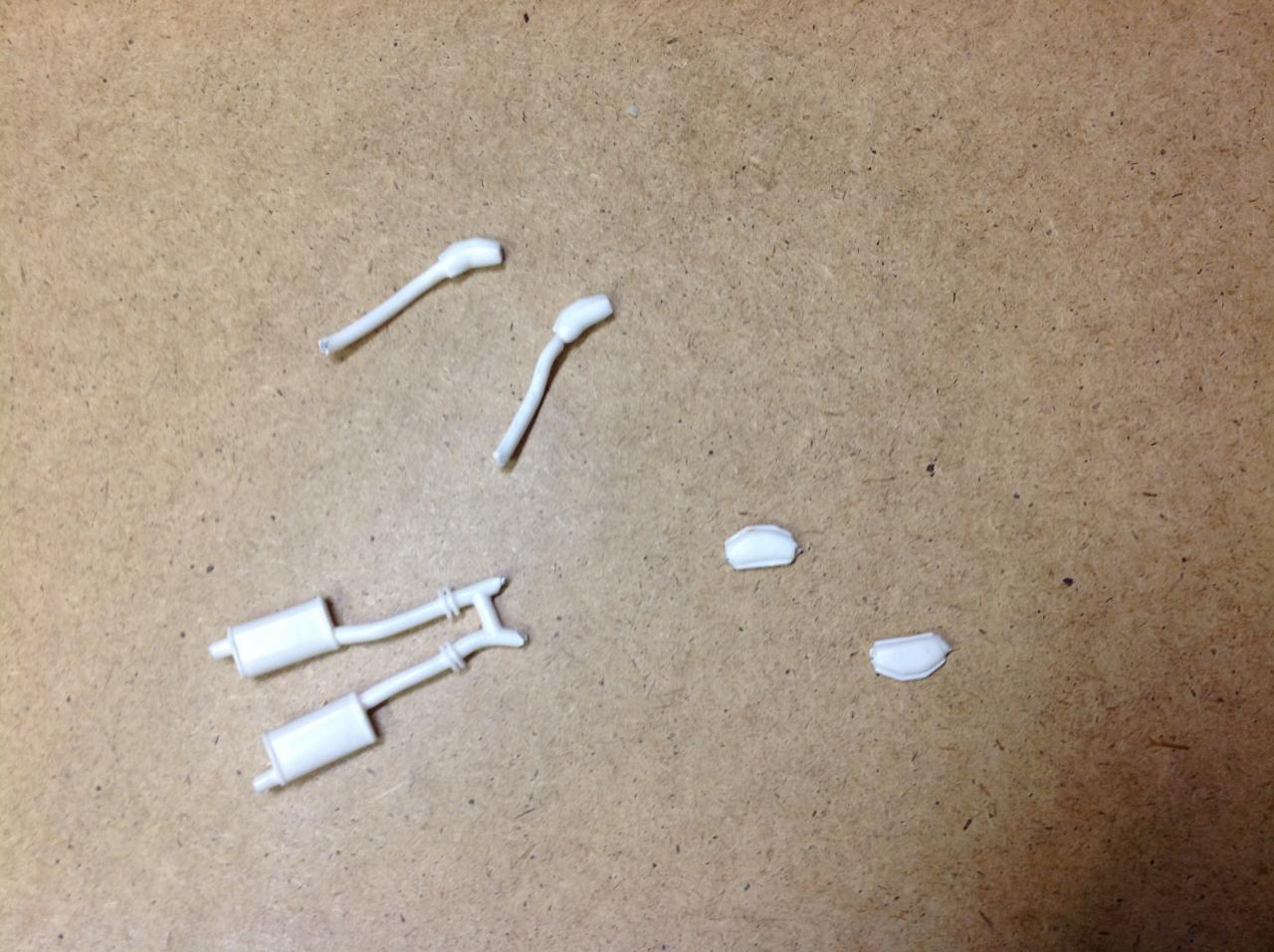

  2. I recently made these mufflers and thought I would share the process. First I glued two pieces of .156” tube together and filled the crotch with some half-round and CA. Then I sanded the ends square and capped them with some thin styrene sheet. Sand the end caps flush and drill the holes for the .100” exhaust pipes....simple!? The tubing allows the exhaust pipes to “float” in and out a bit until everything is in place so it can be glued solid. The exhaust pipe can be solid styrene, solder, or in this case I used .100” tube with some soft wire shoved inside.

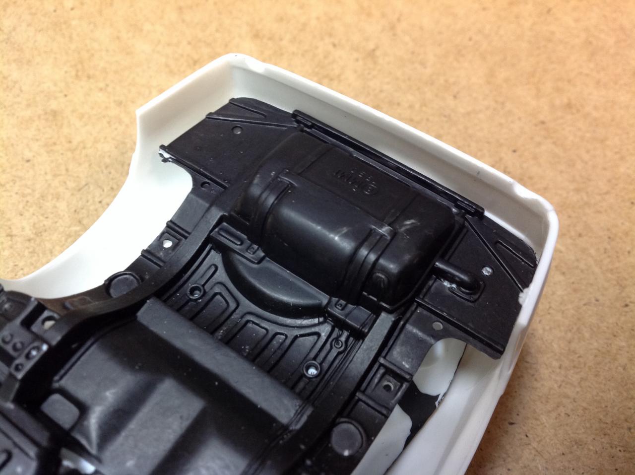

  3. HEEEELLLLLPPP my custom exhaust is not Turing out so well trying to build a flowmaster style system but it seems that there's a huge space from the exhaust ports on the rear bumper to the mounting point
