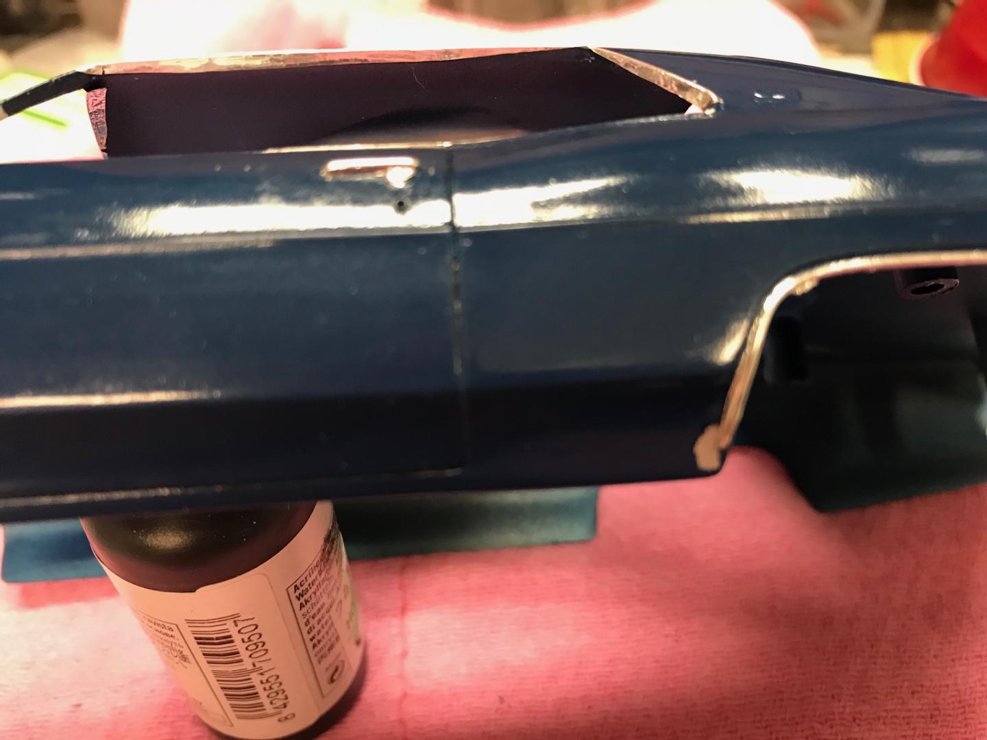

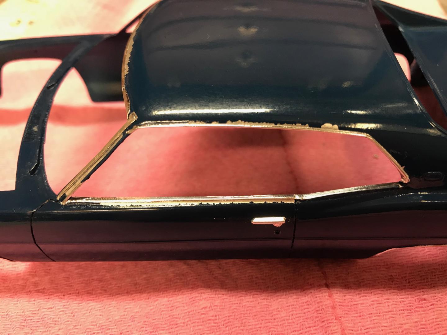

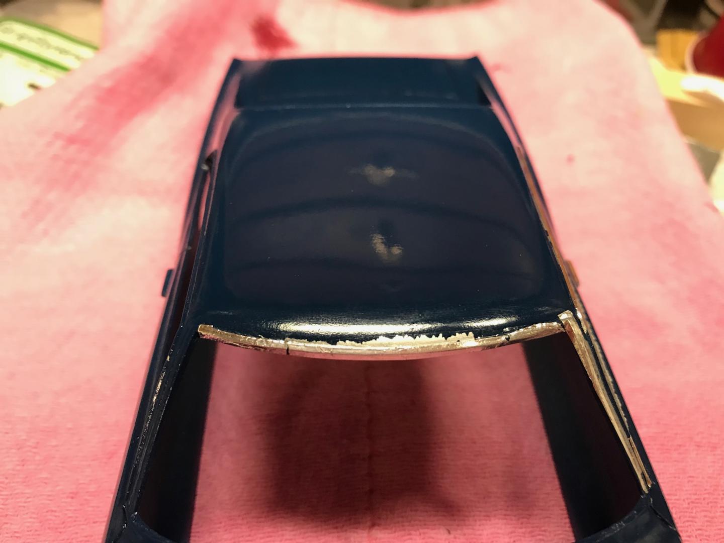

  6. I am using the Donn Yost practice of using Testors Metallizer spray as a primer. When I go to foil the trim, the foil often lifts off the paint around the trim. This has happened to me when using rattle cans (Testors Lacquer as well as Krylon) and airbrushing. I have tried various things to combat this, including throughly buffing the Metallizer as well as scrubbing with soapy water. Can’t seem to eliminate it. Here are some pictures of the issue: Any help would be appreciated.

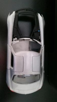

  9. Hi everyone, I'm new here. Working on my fourth car model and am trying to hone my skills. Currently trying to finish my Revell Germany Mercedes-Benz SLS AMG 1:24 model. I've been doing pretty well thus far. The only problem I have is that my body color: Chrome silver does not match my doors. I had a crappy airbrush (Master that I got cheaply on Amazon when I first started building car models) that has been getting worse and worse. I guess I didn't get enough paint on the doors and now the paint is lighter than on the doors and looks awfully strange. I was thinking of sanding down the doors and re-airbrushing them. Just bought an Iwata Revolution. Any tips on what I should do? I already assembled the doors to the body of the car and didn't realize the horrible contrast in color until they were on. Should I try to take them off of the body of the car, sand them down and repaint them, or is there a way that I can mask the body of the car without taking it apart to sand and repaint. Let me know if you have any suggestion. Thanks!

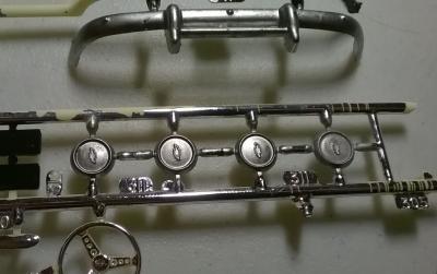

  10. Morning everyone, OK...what am I doing wrong? I've got the AMT '51 Chevy kit and I sprung for the expensive Spaz paint (including the gloss black sealer). However, my chrome looks just plain old silver. Was it because I brushed it on? (don't have airbrush yet....) ?????
