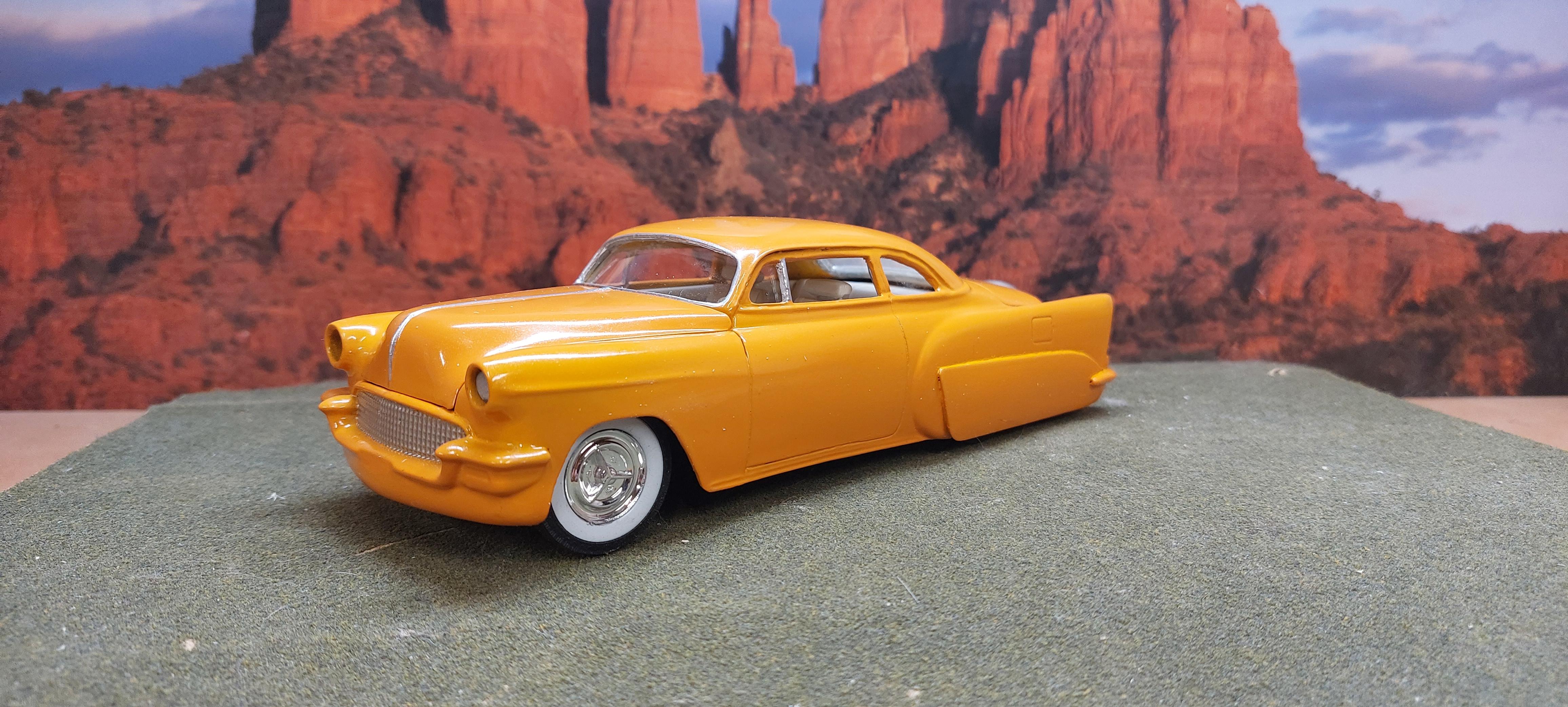

  5. my master build of my 53 ford custom fastback. used a built 53 ford parts kit and body, made bigger deck shelf was all. thanx

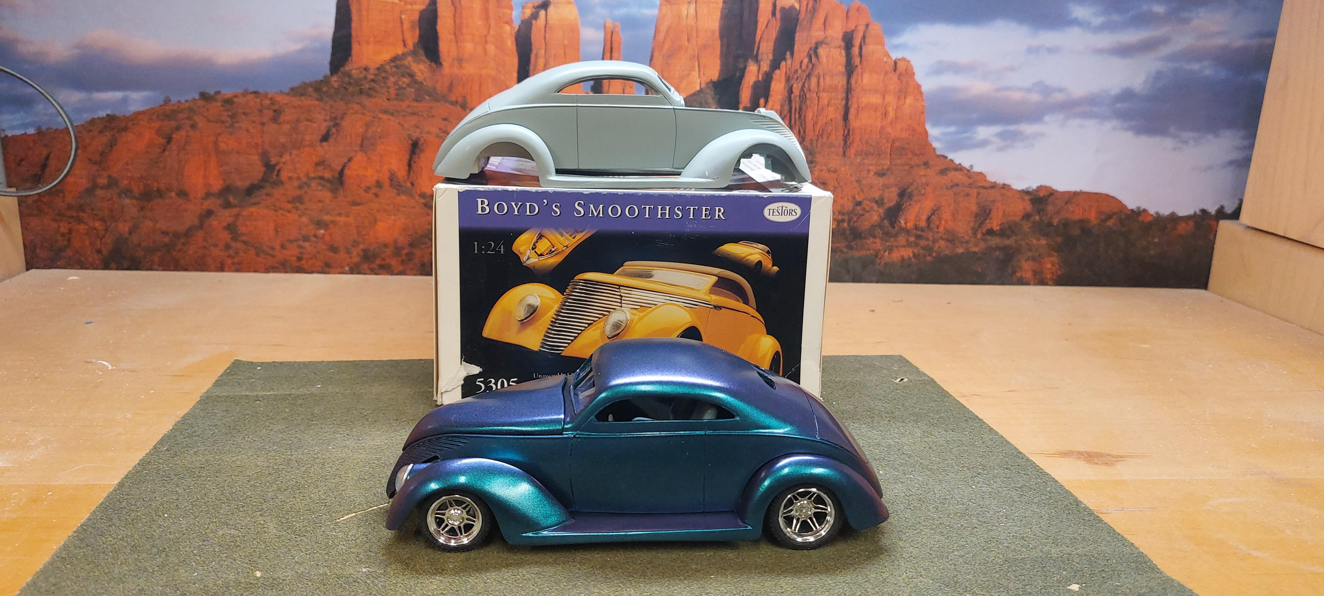

  7. built my created 39 ford standard custom coupe. used the interior from the amt 40 ford coupe kit to build this one. i used a testers 38 smoothster chassie i moved rear forward on it to fit tires into the wells. used the smoothsters motor, but needed to move it forward some. found a gas tank section in my parts drawer that fit great. still needed driveshaft when underside pic was taken. thanx for looking built 9/12/25

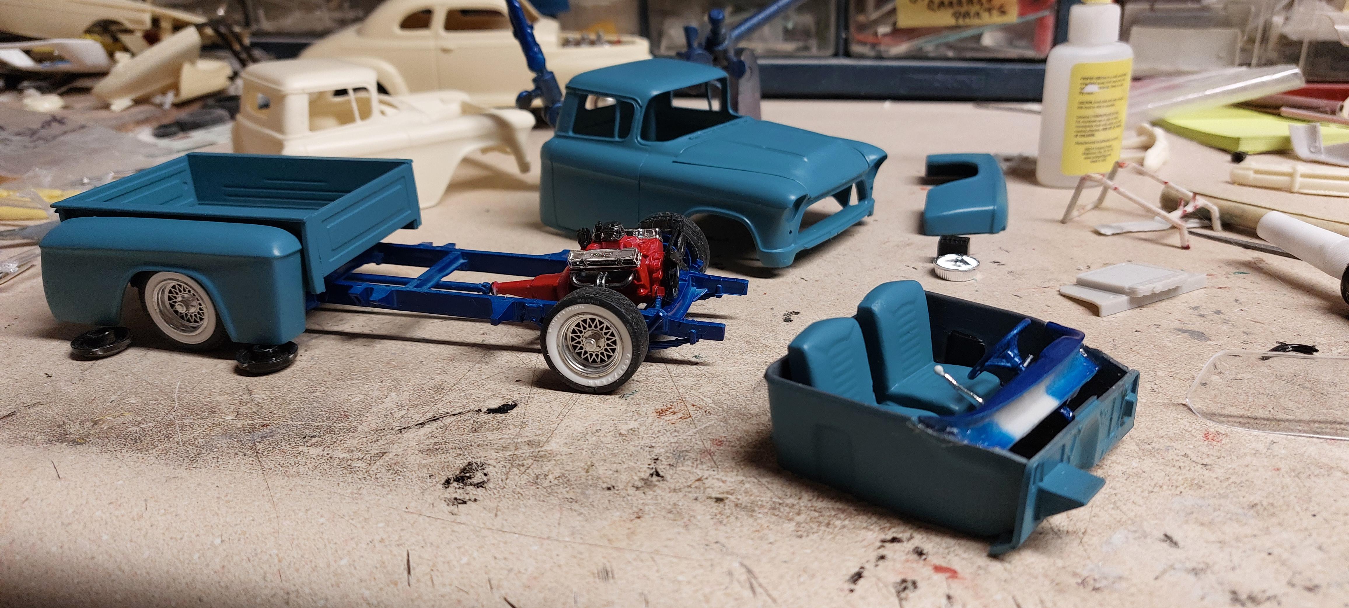

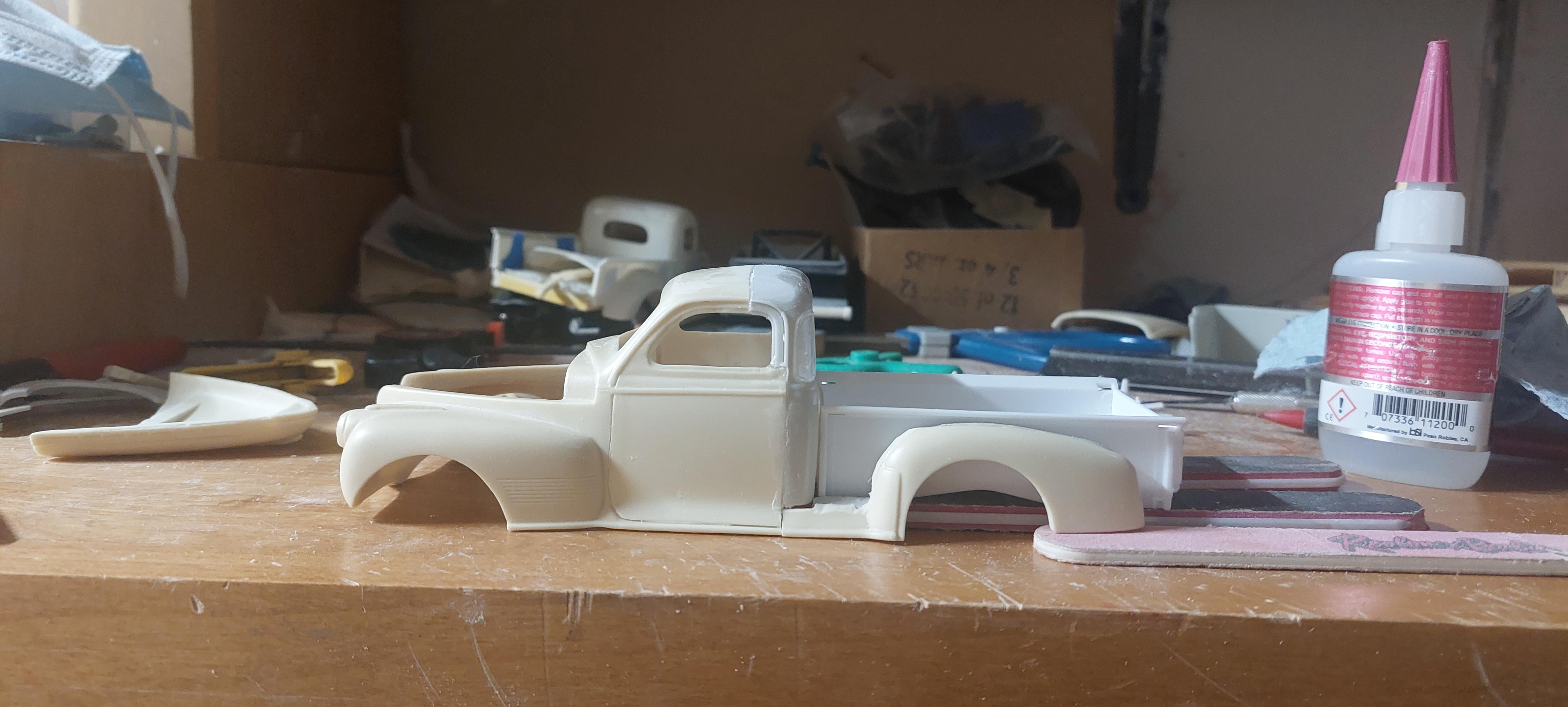

  10. this is a kit bash of my chopped version of my 41 chevy coupe with a 37 ford bed i believe. the entire chassis and engine is from the 39 wagon rod. interior tub was 50 chevy with a hump in floor and 59 chevy dash. 50 chevy was the back of the new cab also. i carried the side profile of the coupe through the rear widened fenders to the narrower 37 ford bed. i wanted to use the wagon rod with its wider rear tires also. i wanted a closed cab pickup like a pic of a orange real one i had saved. built 7/8/25 thanx

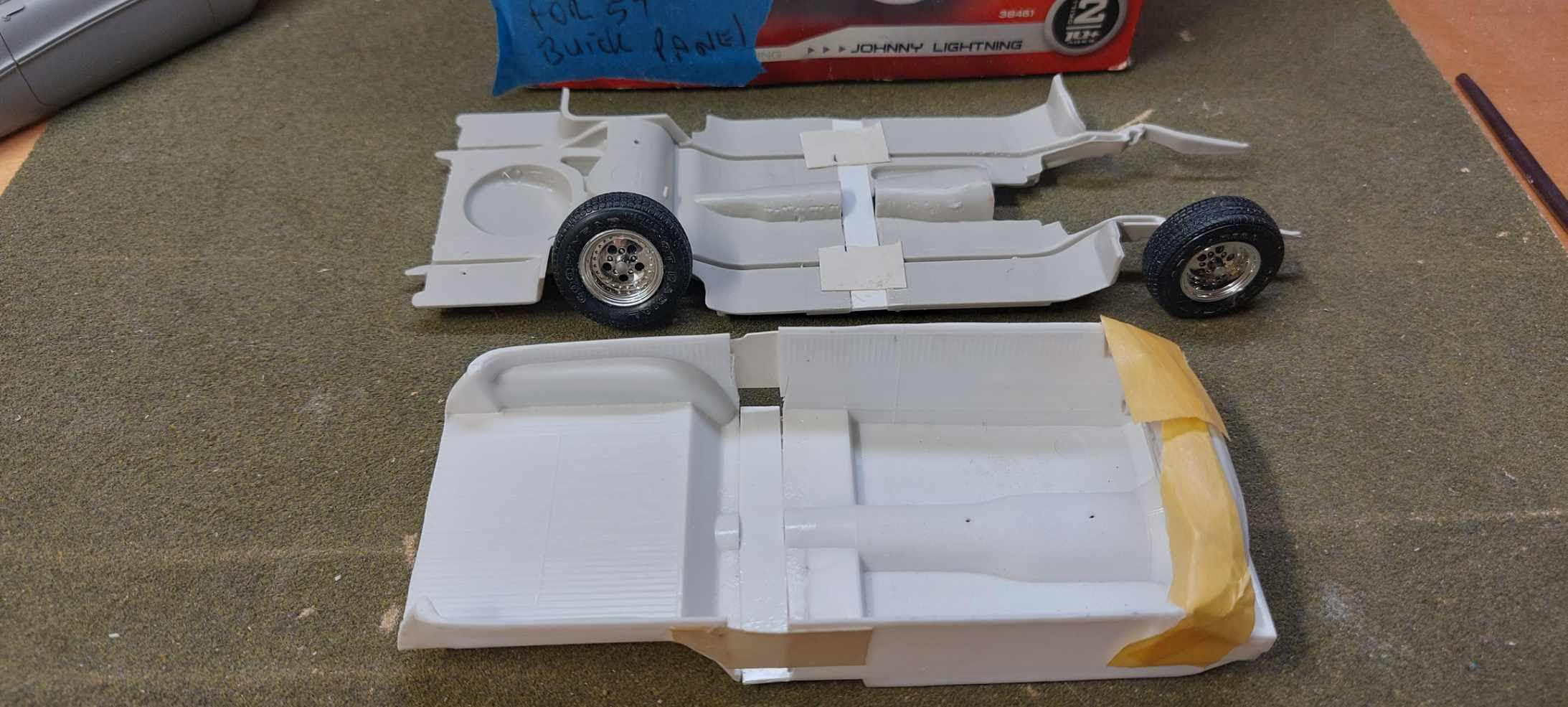

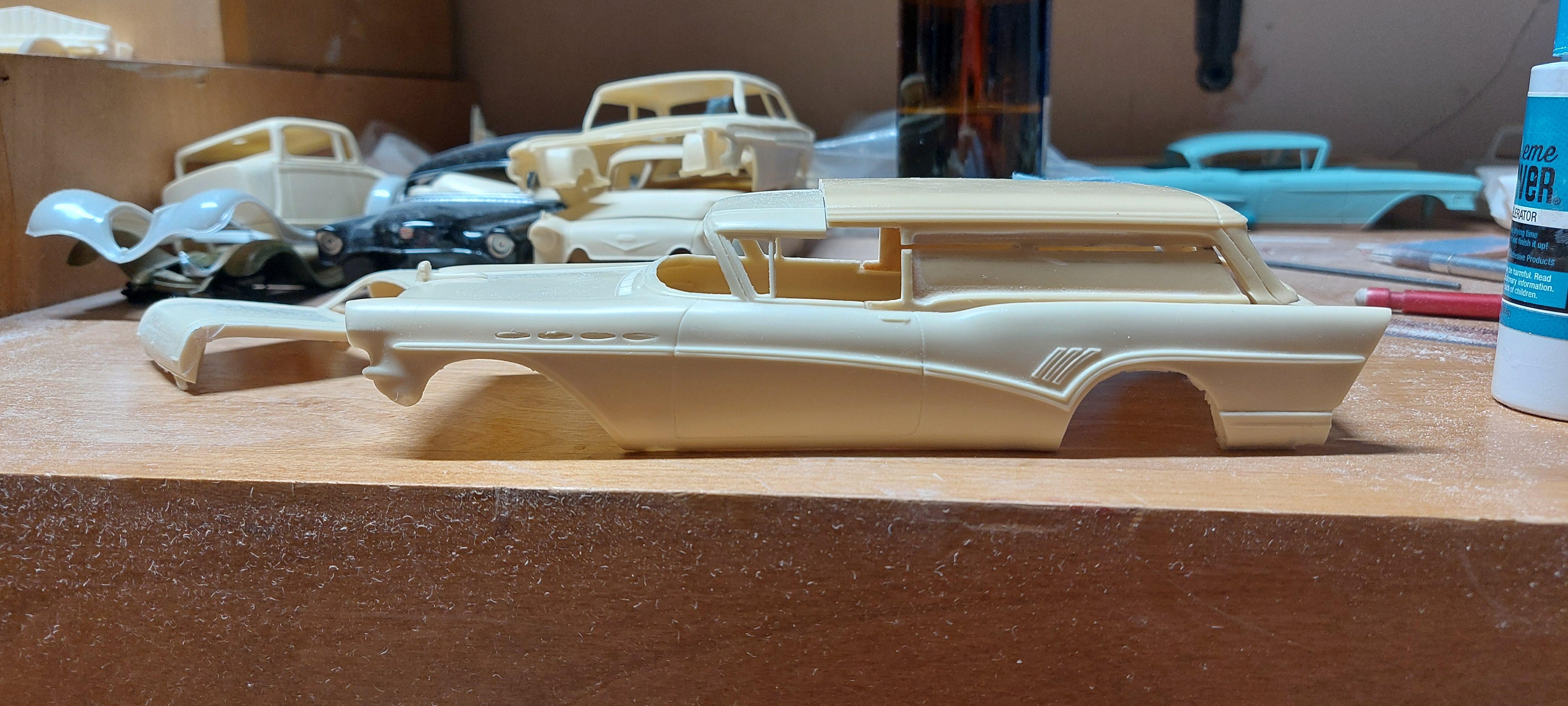

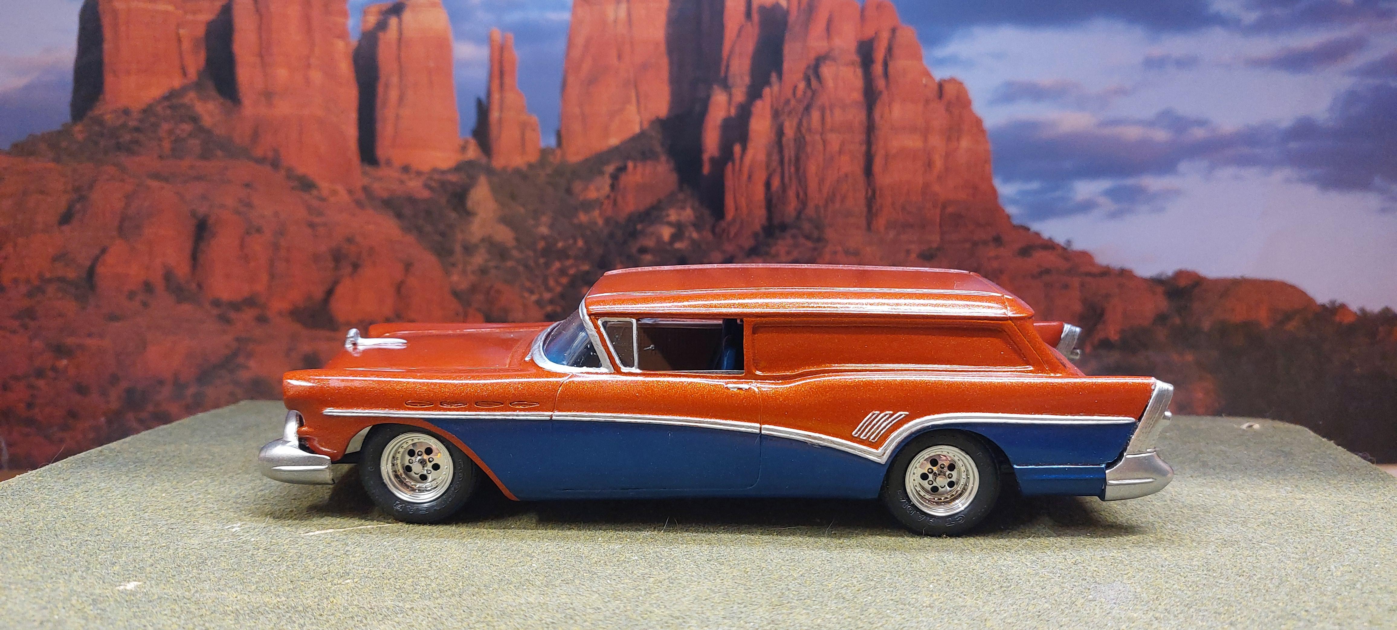

  14. built my 57 buick panel wagon, used a 55 chevy nomad as donor kit. made interior tub and chassis 1/2 longer. when i went to finish up and put the chassis under the body, SURPRISE! ended up being alot of cutting on top of chassis plate to get the back down for an even stance. (top of tunnel and top of shock floor) it looked like some of our cars in the 70s with the rear ready to shooting off for space. i ended up putting heavy duty springs on front to bring my 73 comino up even with the (stock air shocks raised for my 60s) rear, i liked the just enough raise for tires and front up to even out. oh ya 57 buick, i decided slight wider tire all around black walls on this one. enjoy built 5/15/25 thanx glen damodelguy

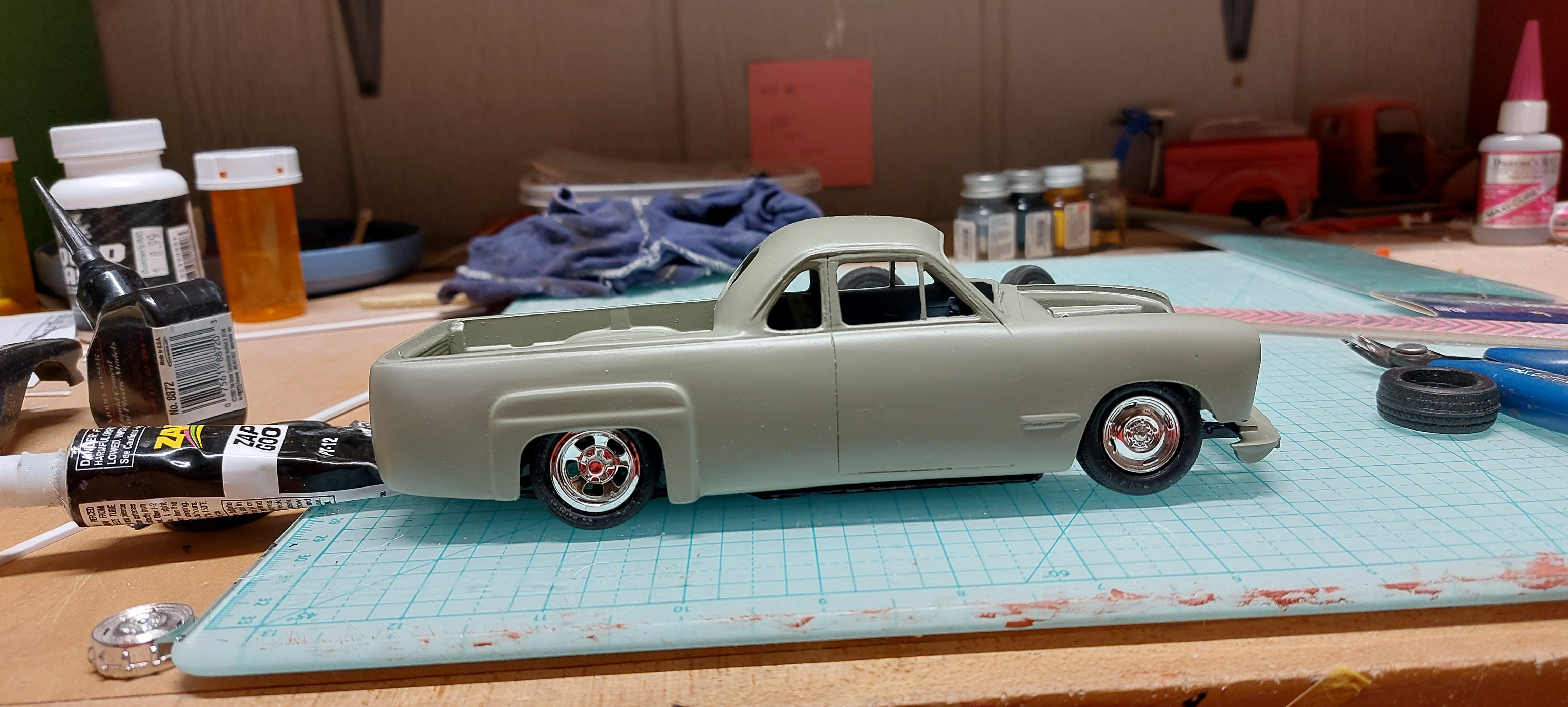

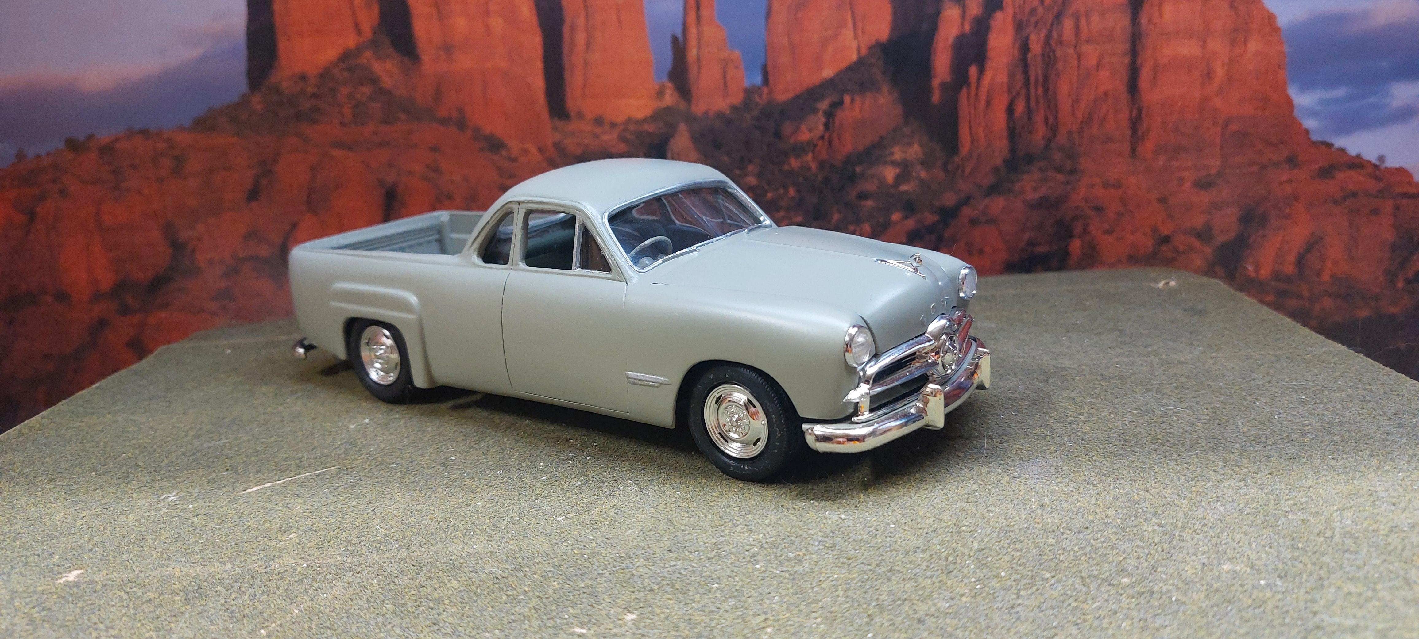

  15. well i finished building another of my own castings yesterday. 49 ford ute. i did a lot to make this one happen since it was originally a fiberglass body and front of it was brittle. i also found out that i couldnt superglue fiberglass to a plastic body. ended up coating it all with smear of resin to make halfs stay together. then i put a ranger bed inside. i used the 49 for kit under it. build #621 got body 5/9/24 10.00 built 4/24/25 thanx glen damodelguy

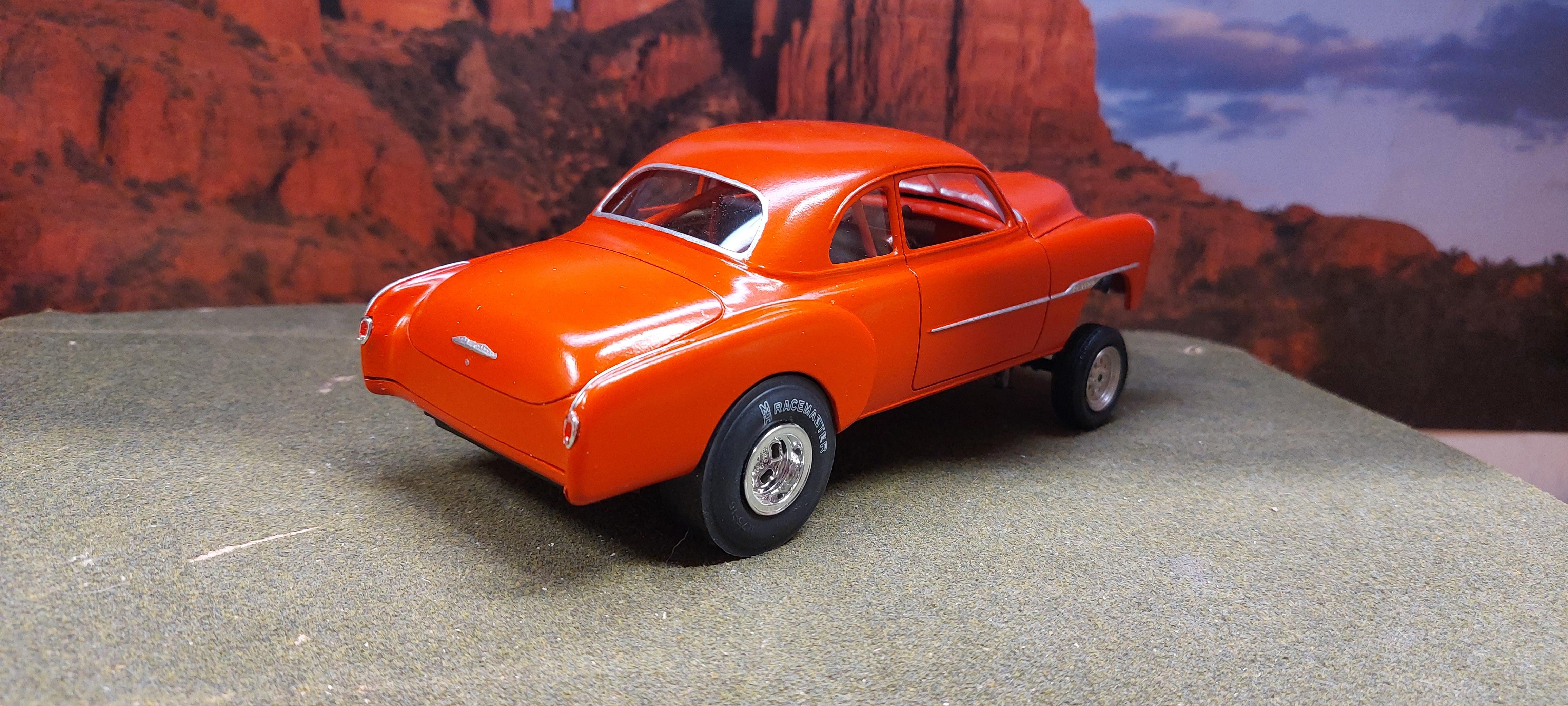

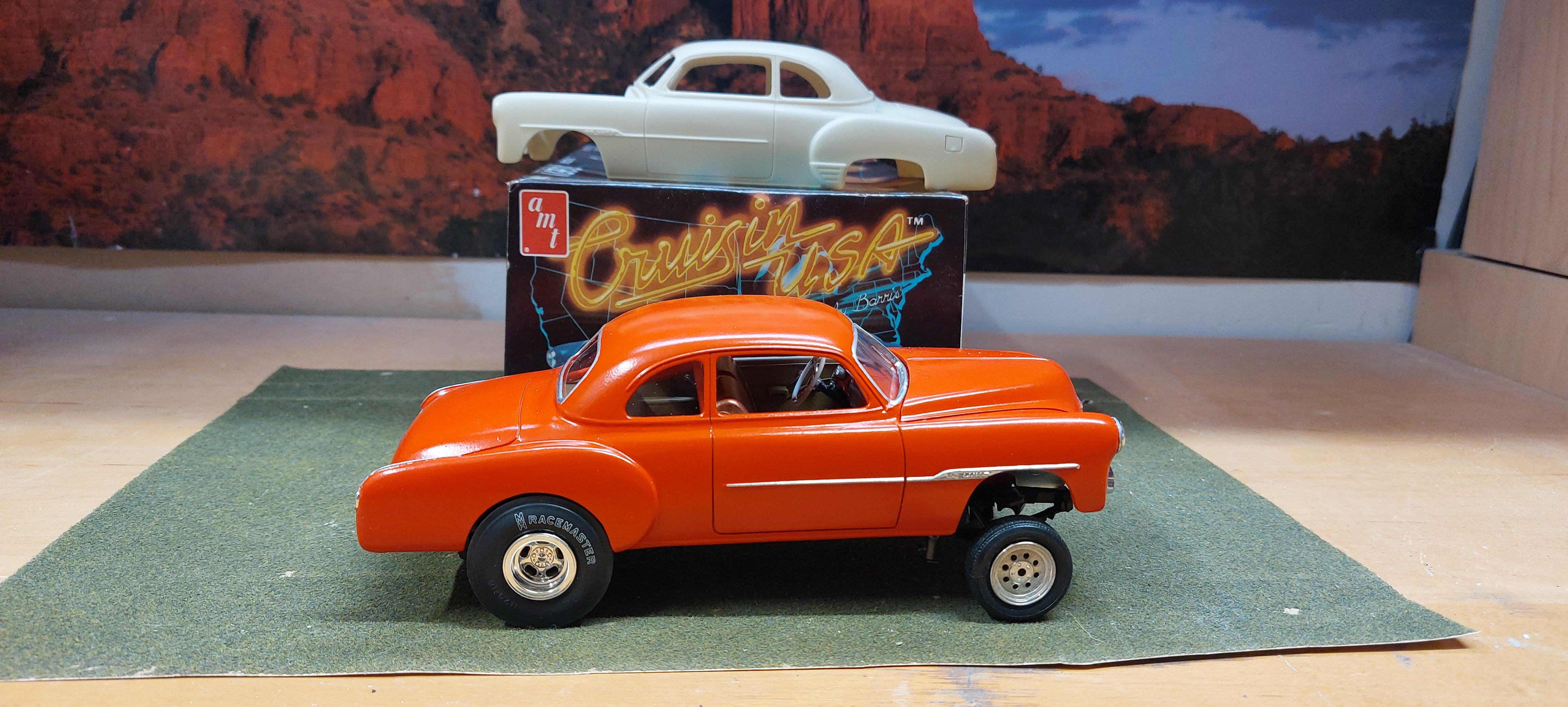

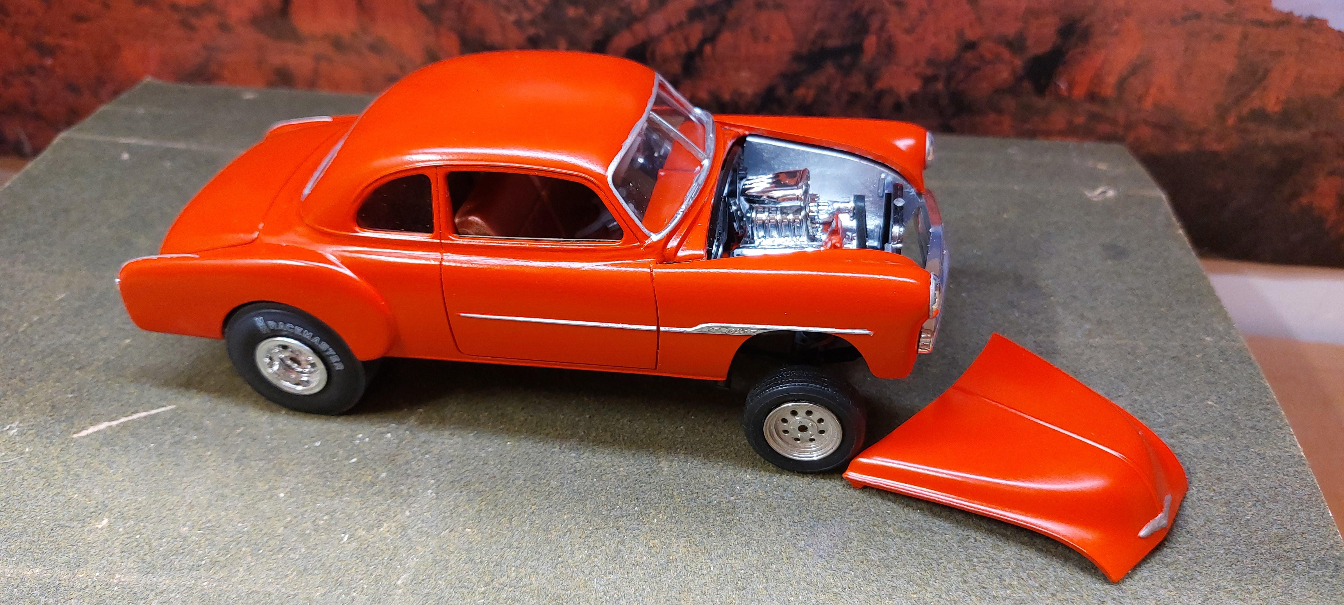

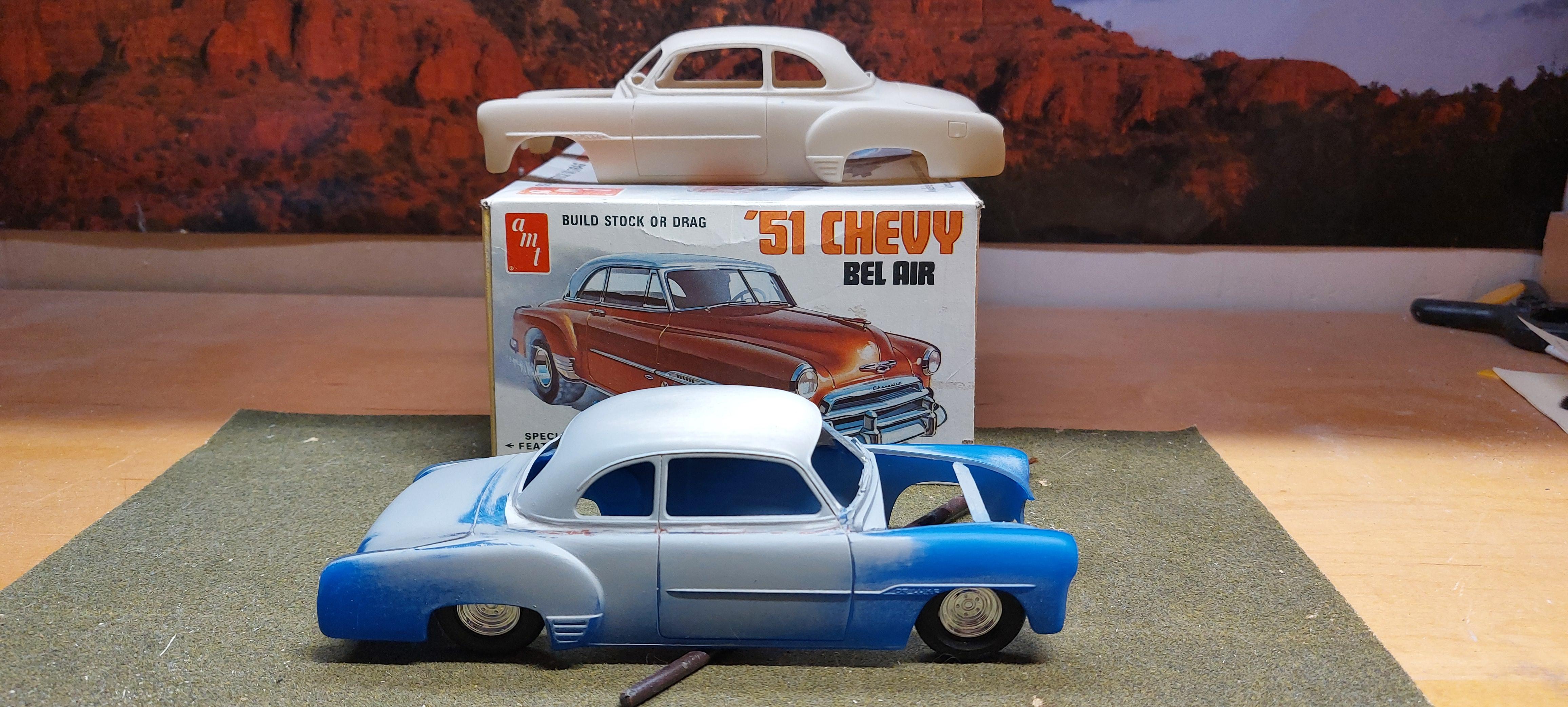

  16. so i finally built and finished my 51 chevy coupe finally , decided to go gasser from the get go. motor and rear tires from a garlits dragster kit. i made good use of that kit tommy, thanx. guess sometimes i feel high, but some times, low. thanx for lookin, glen damodelguy 5/3/25 build #622

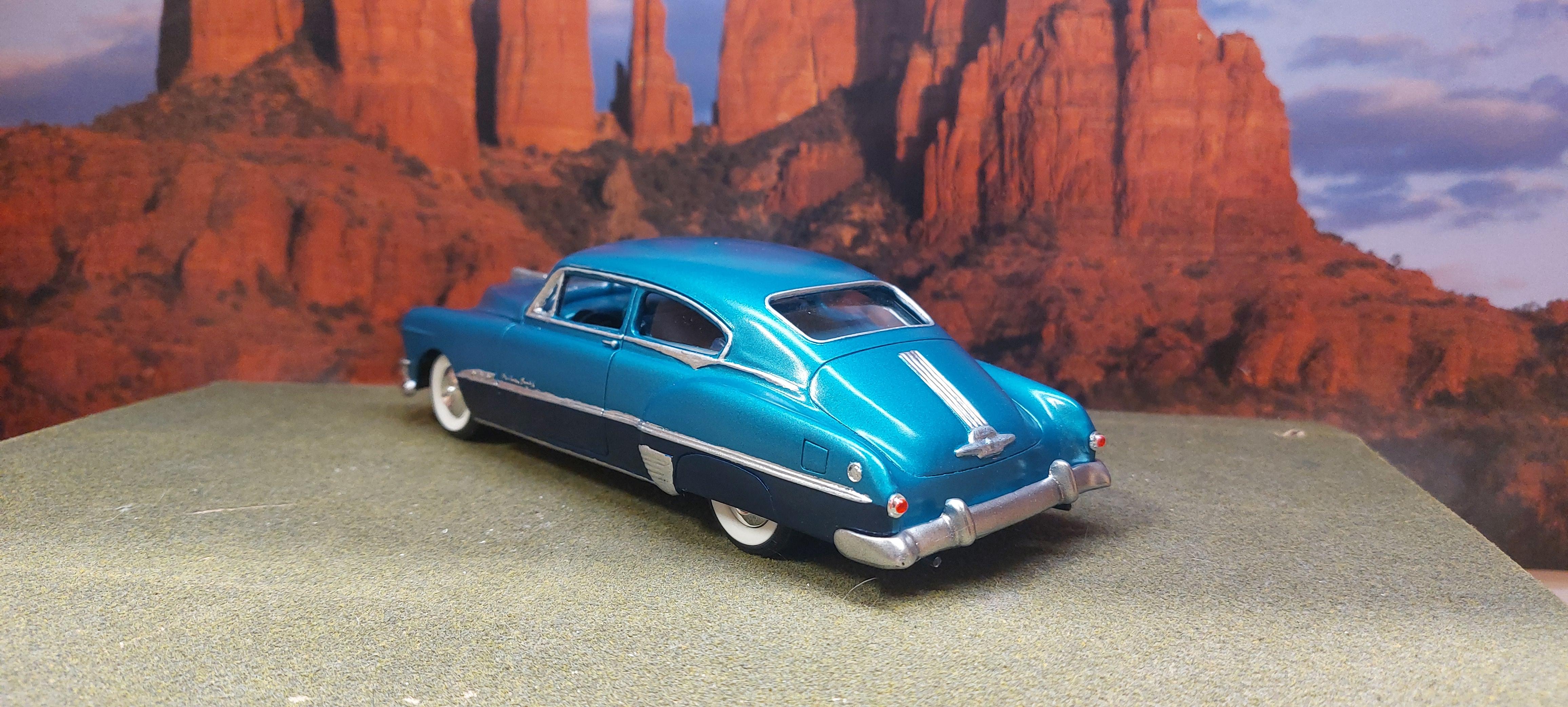

  17. built my 51 pontiac fastback chopped, used 51 chevy fleetline for donor kit. had to do some mods here and there, frame longer. i know some use 50 olds, hear it little longer, but we use what we have if we can. built 5/11/25 thanx glen damodelguy

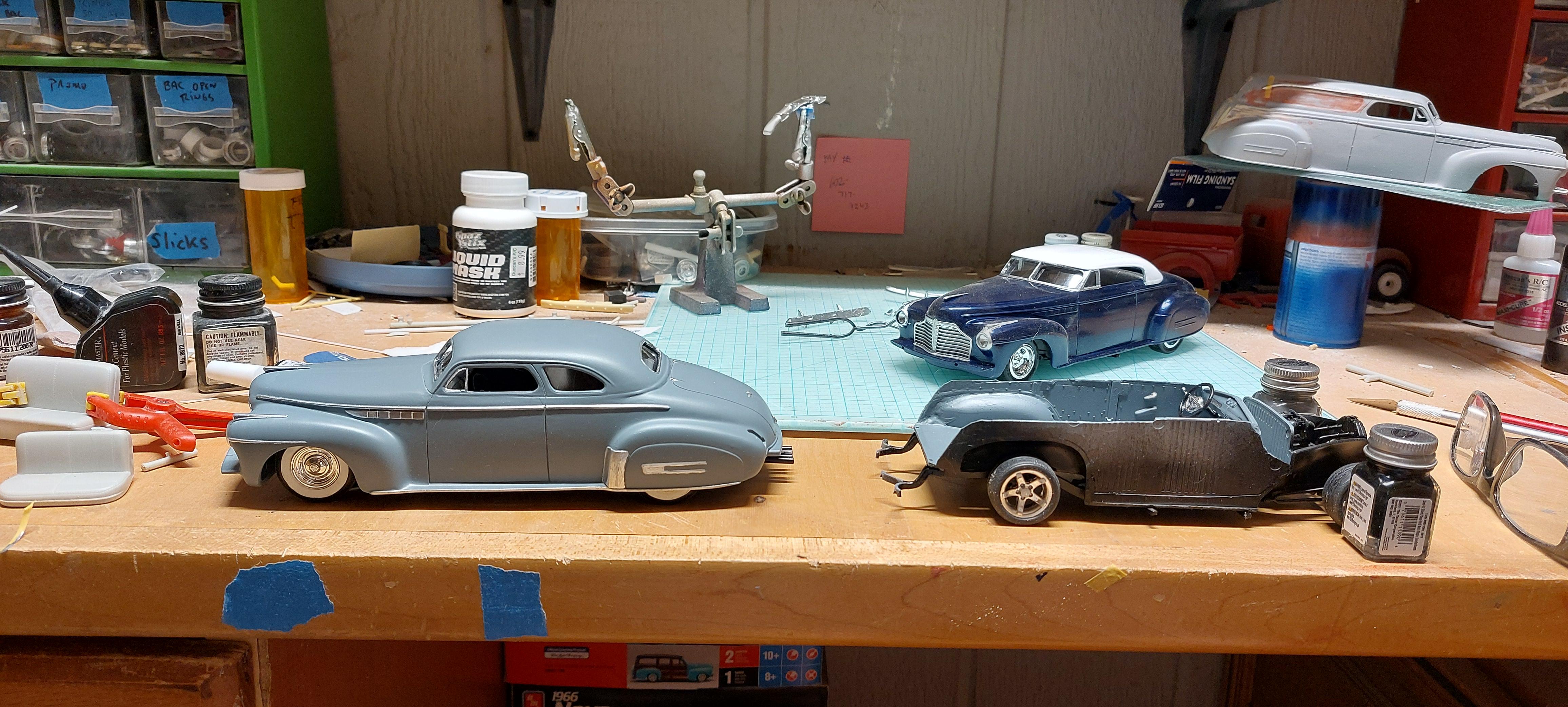

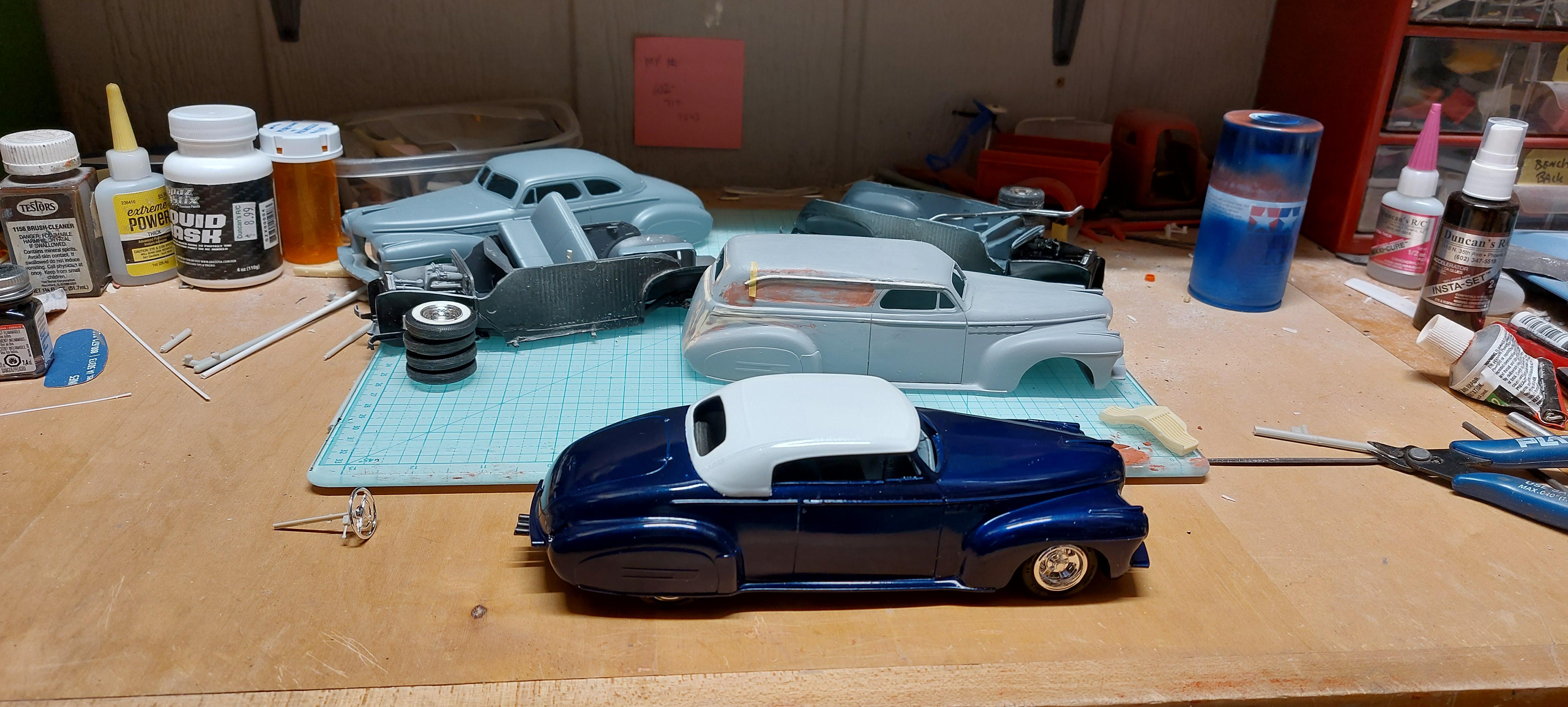

  18. this is my 2nd 41 buick finished next day, carson topped. all under body is 41 ford woody kit donor made to fit. thanx again glen see other listing for more building info.

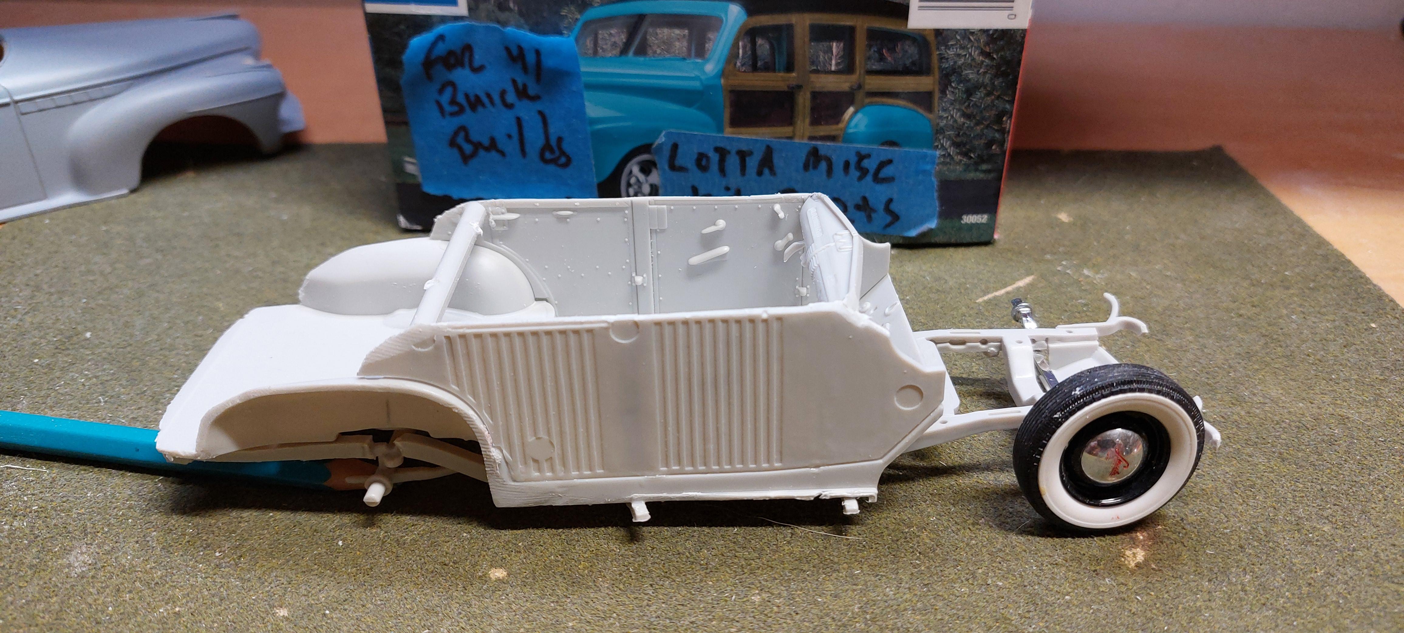

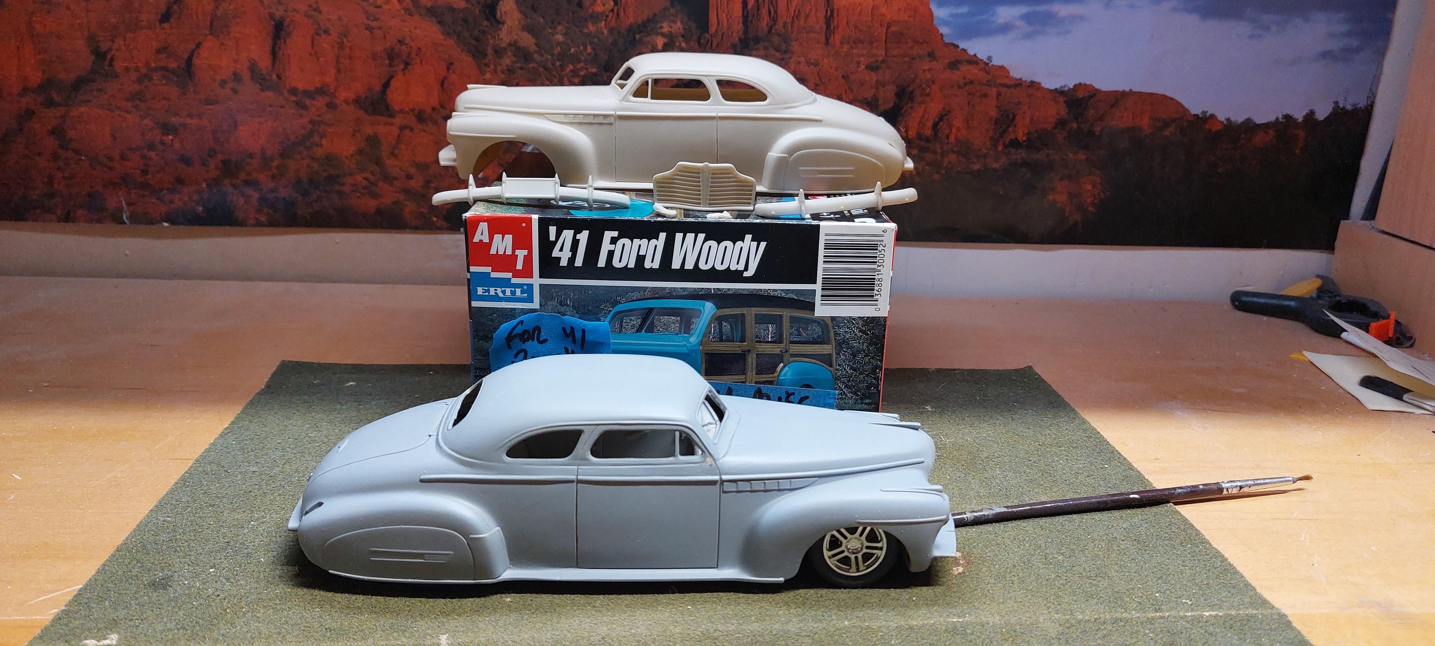

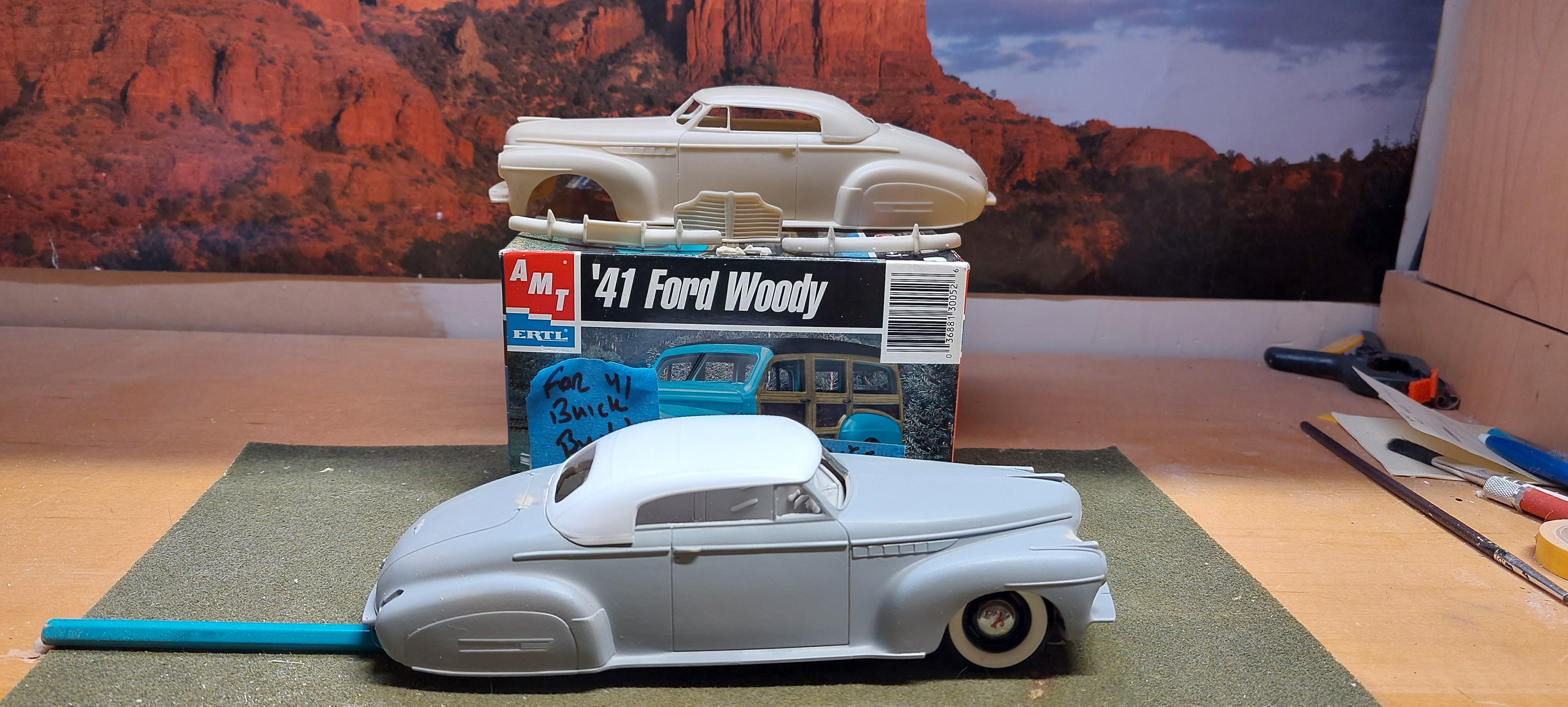

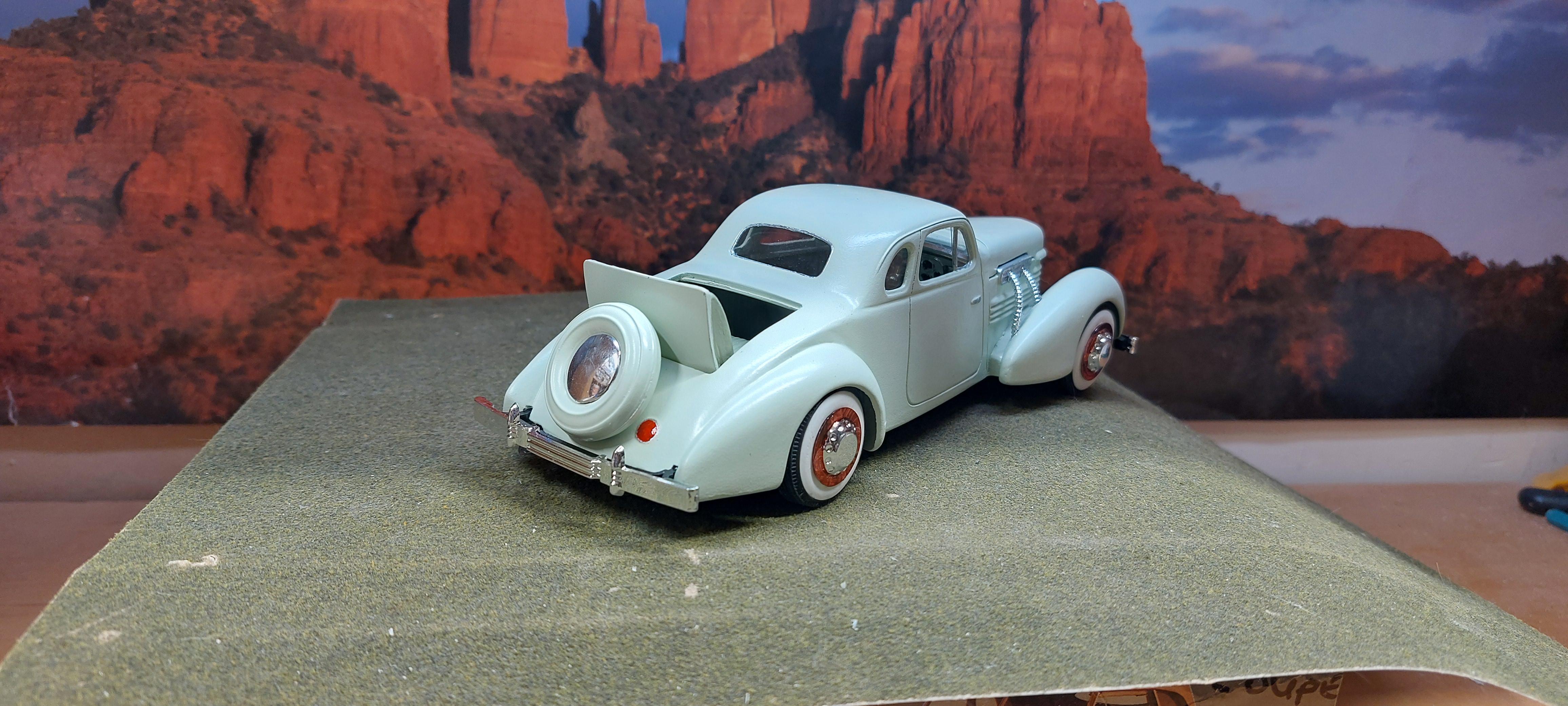

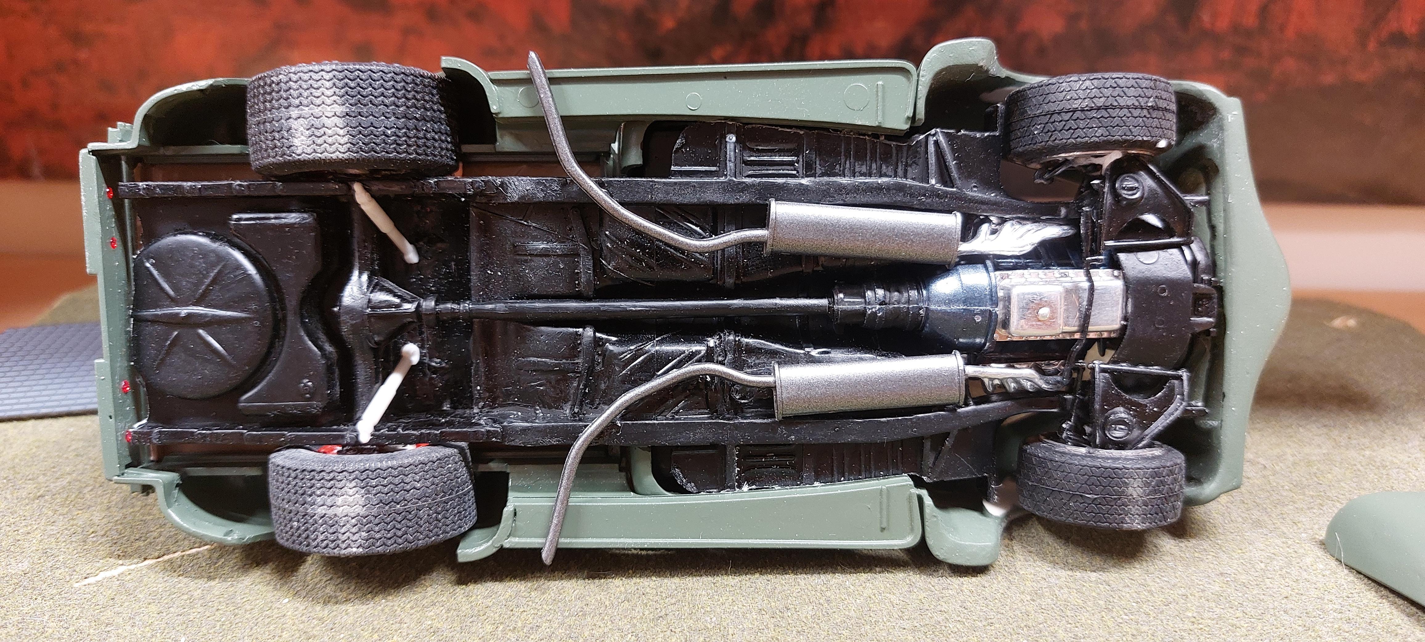

  19. my 41 buick body recreation, into a chopped coupe. my resin bodies involve your creativity also in finding chassis, interiors, oh and dont forget, fitting windows. i built my 41 buick with a 41 ford woody donor kit. (you my think of a different donor) chassis was lengthened 1/4 back at the rear end area of the frame. it has a second piece of the x frame so it can be used for strength. i also moved the rear back a little to sit in the skirt area a little nicer, and also to lower its stance. i also cut the front axle to move it forward a little, also to lower it. i used the kit pipes but changed the mufflers to make up the added frame lenght. used kit interior, with side panels trimed to fit. hood is solid so i put the kits motor in it. im not as much of a detail person as many are. i built for collection shelf presentation, try to get the parts in place, but not wired, tubed, or even colored up. cant be seen, and wont be judged. im about different, and helping to show you can work outside the box, BOXES i say. tidbit, fellow model buddy, tom w, suggested grinding out from back to put the grille in this body. it worked very well. thanx Tom, im building 3 of these bodies, 1 is a 3rd reconstruction not yet finished to mold yet. so i was working on 3 complete chassis at same time, for the 3 builds and thanx for lookin glen

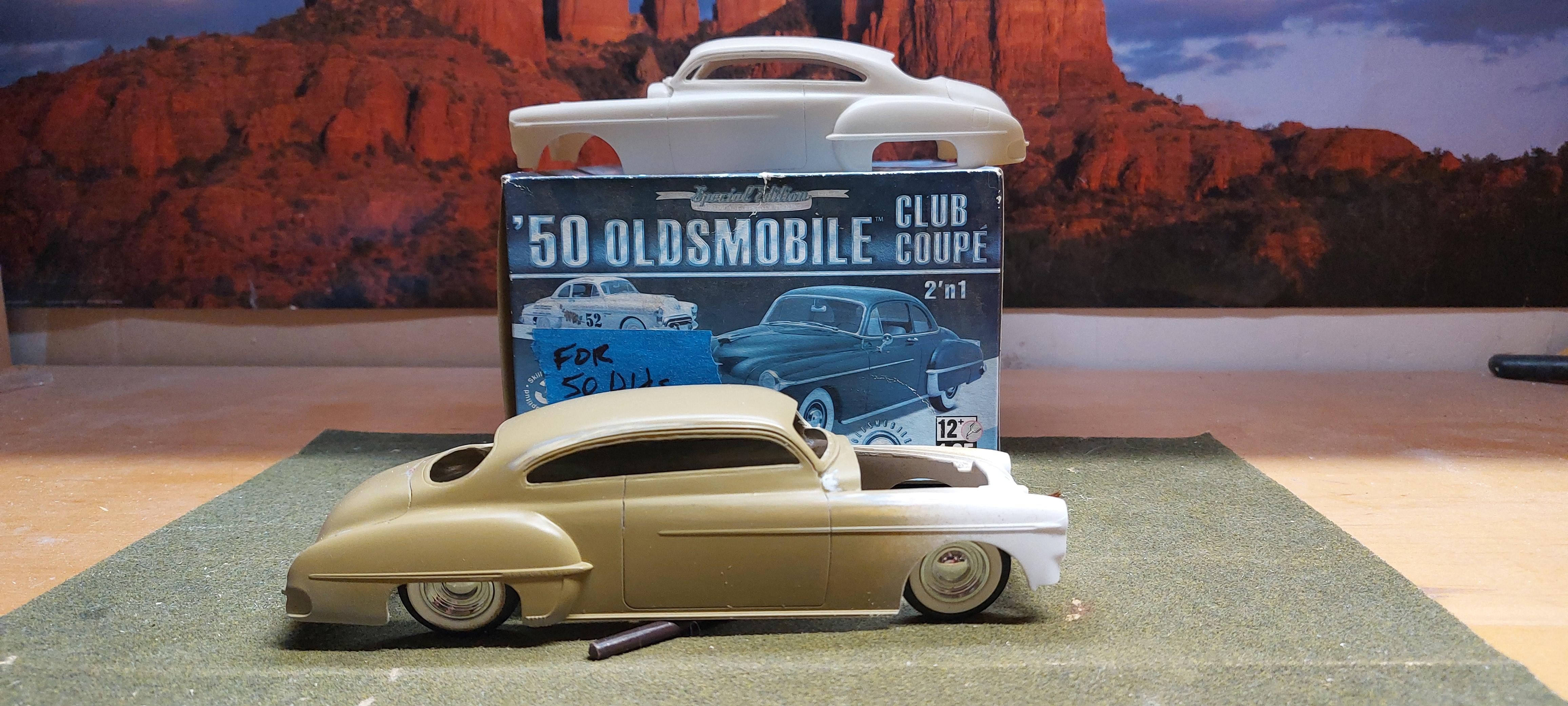

  20. this is my body, 50 olds custom sedan, more of an ole bone feel and look. has the custom merc roof on it. thanx for lookin, damodelguy

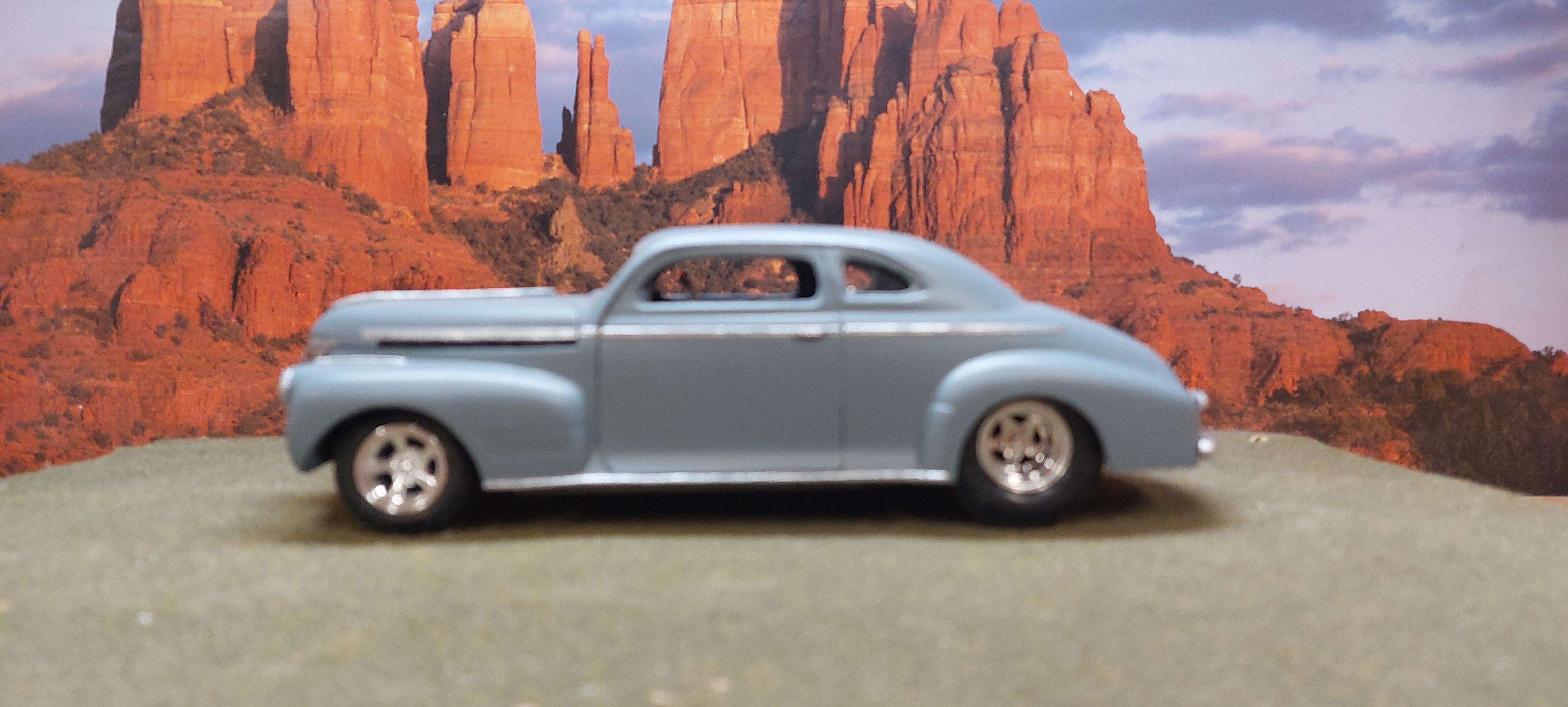

  21. i finished building my created body of my look, 41 ford chopped. i was trying to maintain the original roof line and back window. i chopped the A B pilars, but dropped the trunk line t about even with the rear fenders. this body i used the 48 ford kit and lowered suspension some th get tires into the wells. i also used the lovered hood from 48 and altered back corners to meet the cowl correctly. built 2/5/25 thanx

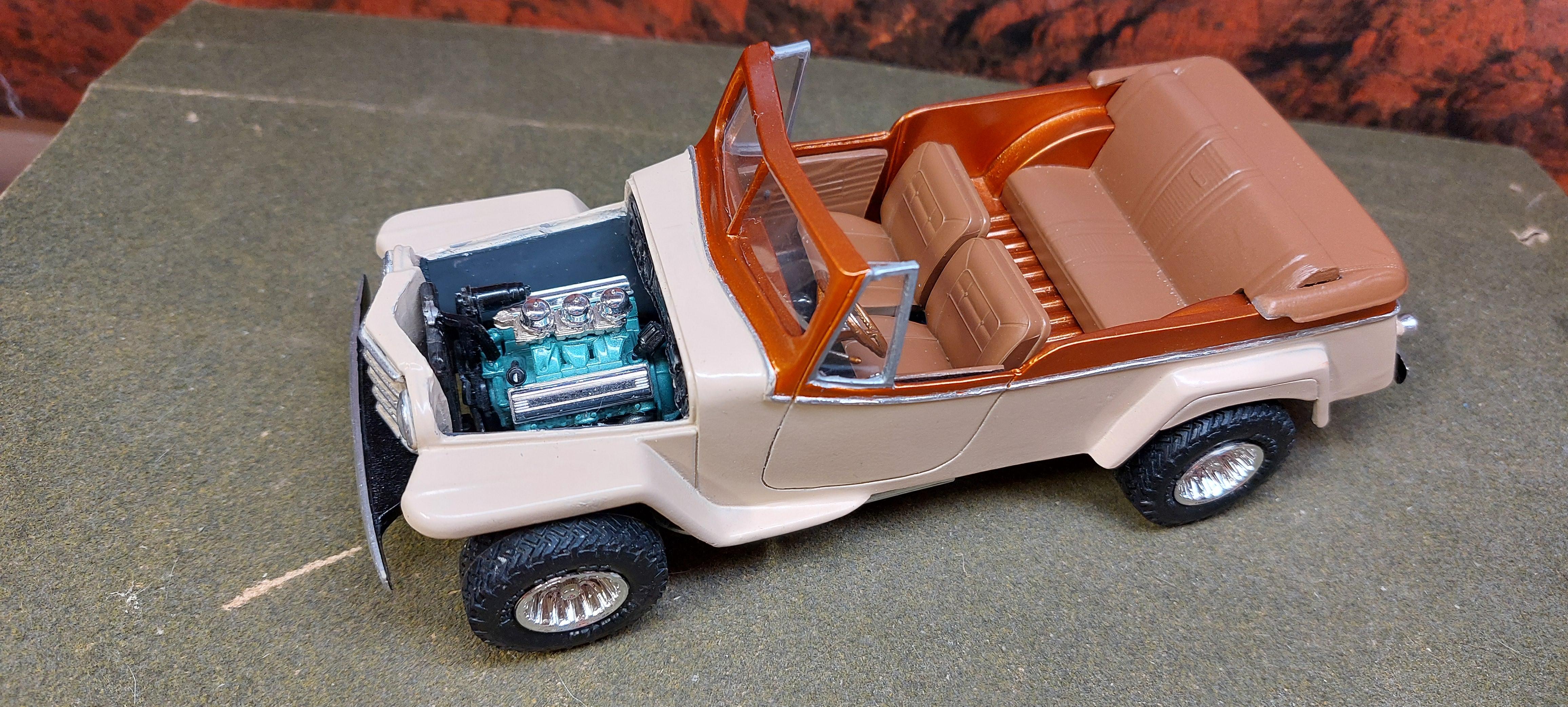

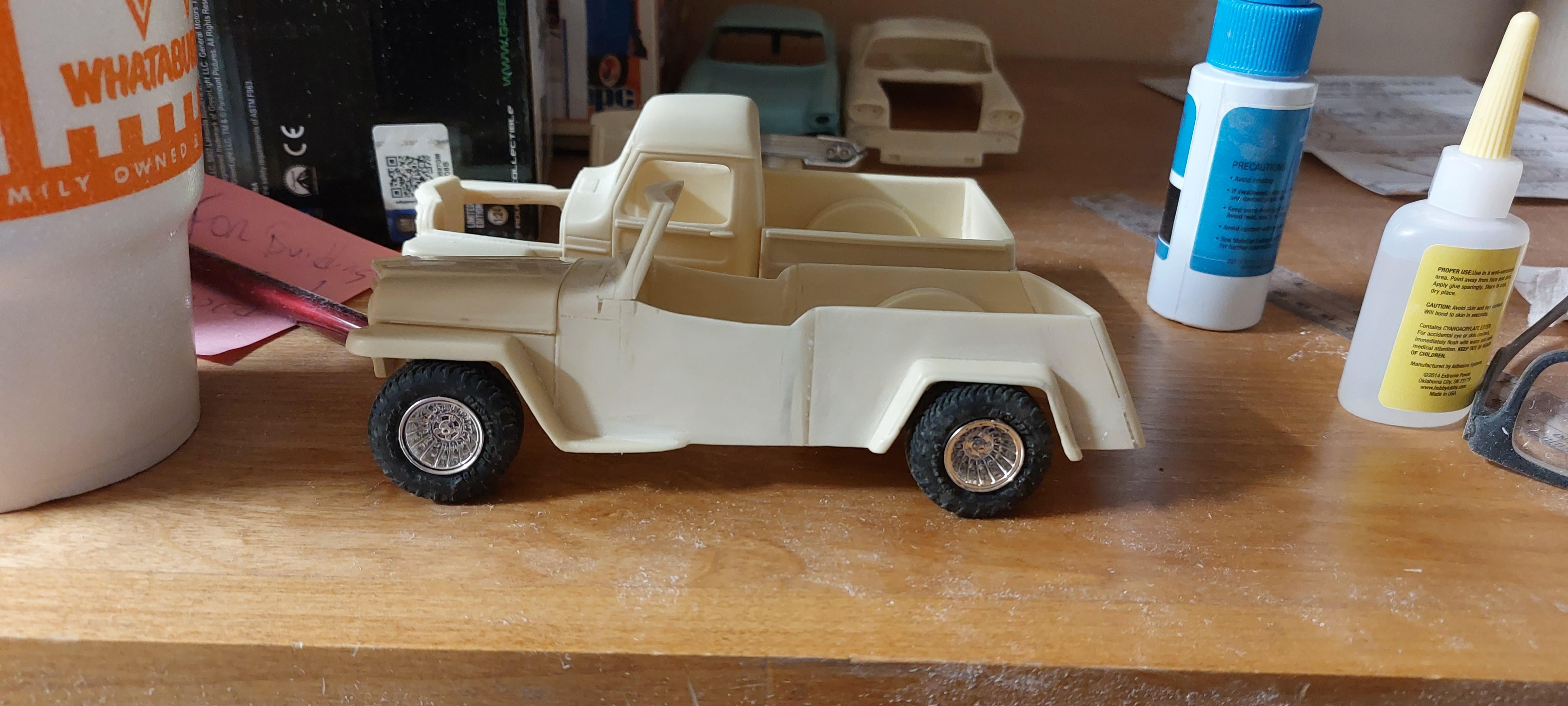

  23. first build for 2025 is my 51 jeepster body. this was made from my 53 jeep custom pickup. i used a 60 chevy truck chasssis i had built in parts box (altered of course), parts box seats in a 66 nova interior (also altered). tires from the mount n goat kit. parts box built motor, and boot (i had wrote 61 chevy under it}. always liked these at the car shows, finally could see one in my jeep custom truck body. created and casted jeepster 2/24/24. thanx for looking, glen built 1/22/25

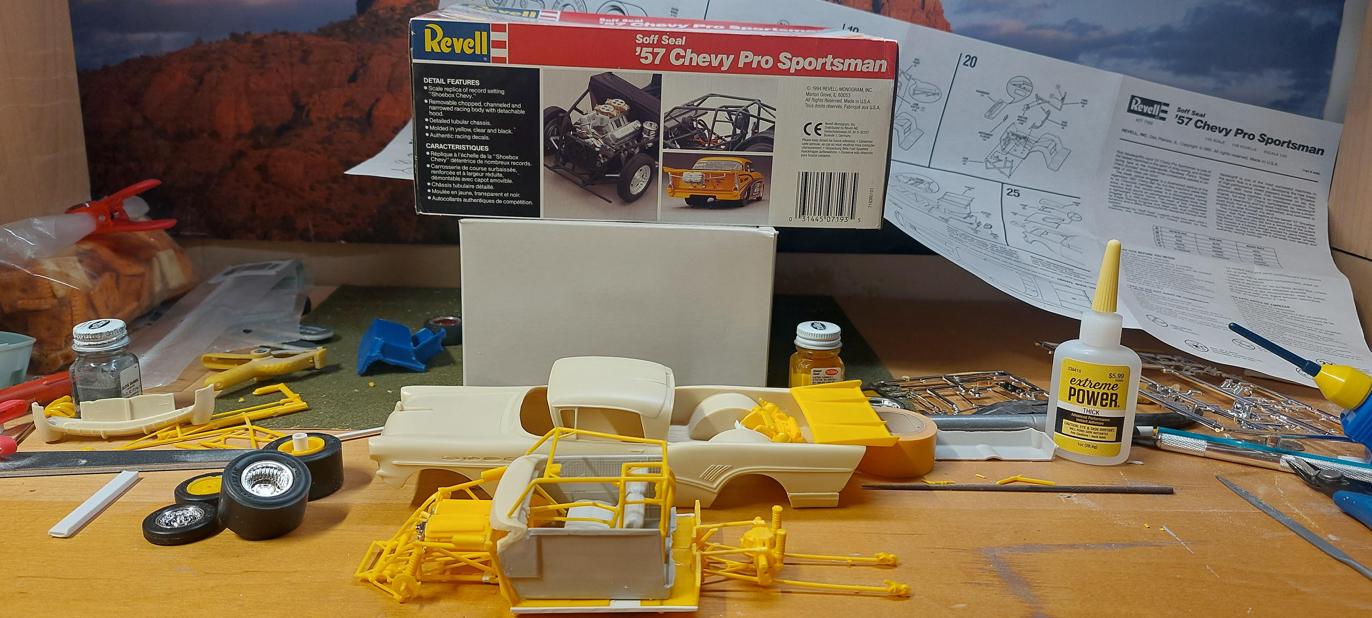

  25. so i finally made some time to start building on some of my creations. i always liked this hardtop ready for the track, so i designed it with some tubs for the possible. bashing my body with 55 chevy nomad interior tub and the 57 chevy pro sportsman kit. i thought i had the tires lined in the wells, but had to adjust with spacer at firewall to. i might be getting a little carried away, but we see what we see and head for the finish line. well see! glen damodelguy thanx for lookin
