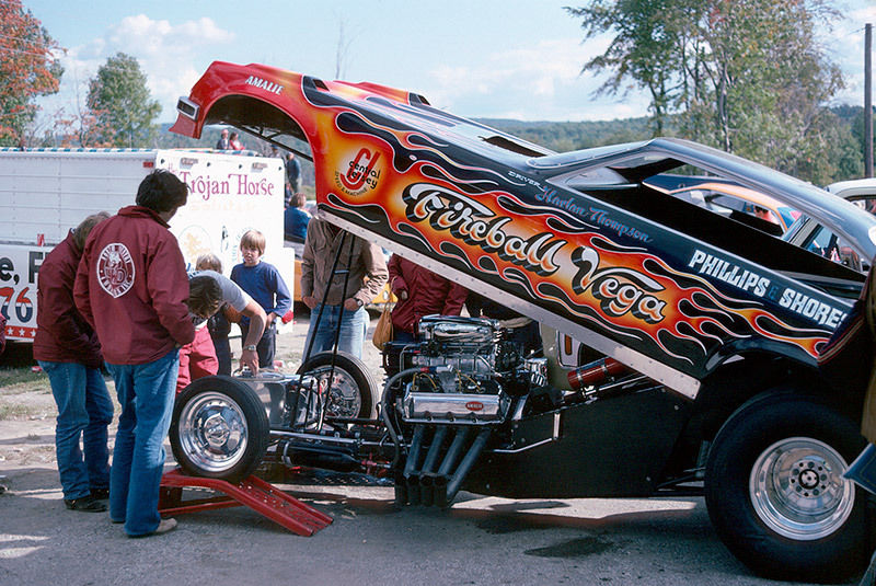

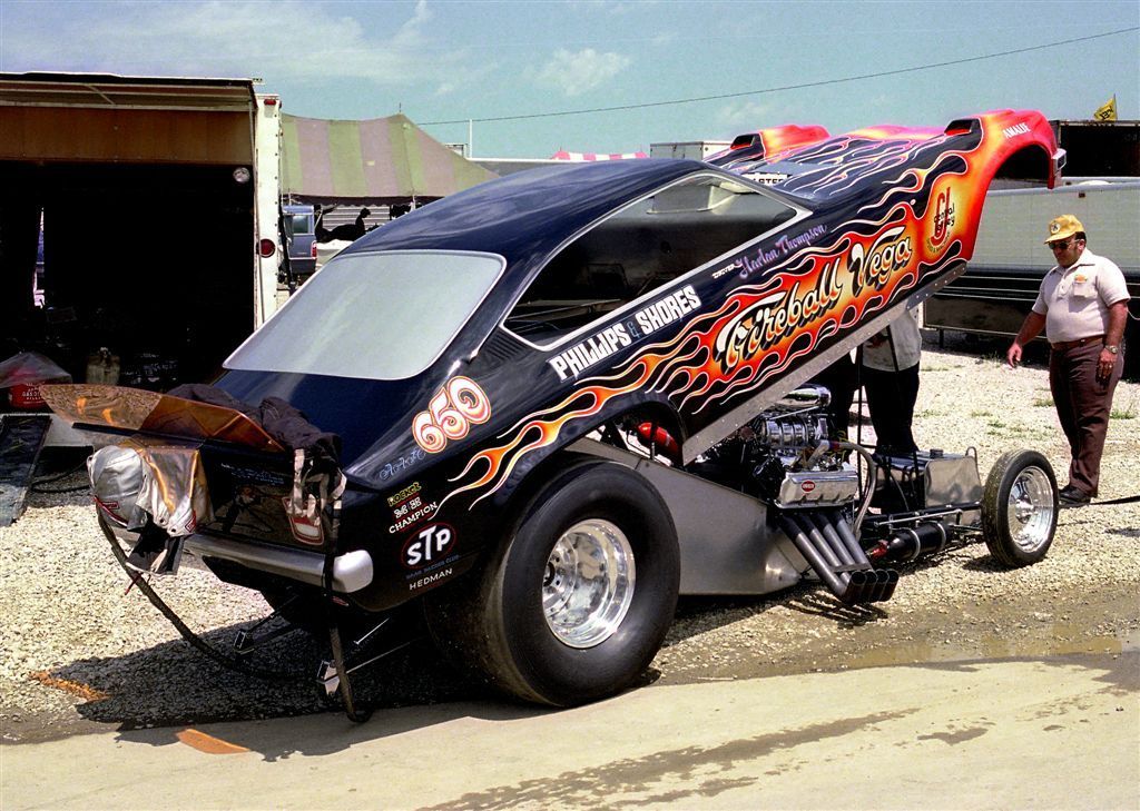

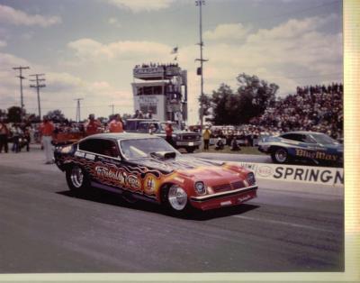

F/CNUT Posted March 29, 2015 Posted March 29, 2015 (edited) Hi, I have bought Chuck's 1/16 74 Fireball Vega decals. I have a body in primer ready for paint. I have done some testing and the problem I'am having is matching the paint to the decals and also what steps I should take in painting the car. Do I paint the car Gloss black, apply the decals, then clear the body to seal everything in? Then try to match up the paint to the decals? Hope somebody can help, cause I don't want to mess this project up. Here is some pictures of the real car. Steve Edited March 29, 2015 by F/CNUT
