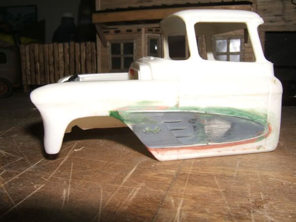

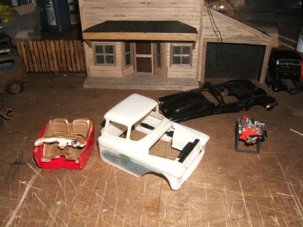

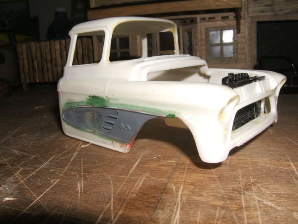

outlaw035 Posted February 18, 2008 Posted February 18, 2008 (edited) after seeing raul's 57 Z06 pickup i just had to try it....also my 1st real attempt at major body work not my strong suit....here are some pic's of the cab and the donor car 58 vette fuelie.... raul...clay...evil1...grafting the vette hood on to the 55...please tell me what u think....the interior is not working out spent hrs trying to make it fit the dash is a go but the seats dont look like they are gonna make it... Edited February 21, 2008 by outlaw035

outlaw035 Posted February 19, 2008 Author Posted February 19, 2008 raul...the interior is gonna be a challenge for sure...got the dash pretty much worked out have to fill the outer edges somehow....the seats is another problem that i really havent spent much time on...but i may have to go with different seats...(bummer)....i wanted to chop the the 55 but i have a few spares laying around i took about 1/4 inch out but the post dont line up and im not sure i want to mess with adding a peice to the middle of the roof which i guess u would have to do....im also having a bit of a problem smoothing out the vette inset is there any thing i can use to get this better other then body filer???....thanks...neal

Raul_Perez Posted February 19, 2008 Posted February 19, 2008 raul...the interior is gonna be a challenge for sure...got the dash pretty much worked out have to fill the outer edges somehow....the seats is another problem that i really havent spent much time on...but i may have to go with different seats...(bummer)....i wanted to chop the the 55 but i have a few spares laying around i took about 1/4 inch out but the post dont line up and im not sure i want to mess with adding a peice to the middle of the roof which i guess u would have to do....im also having a bit of a problem smoothing out the vette inset is there any thing i can use to get this better other then body filer???....thanks...neal I just use super glue and plastic strips for major shaping and fills, then I use body putty and primer for the minor stuff. It looks like you cut the body to match the oval shape of the inserts, then glued them in. I took a slightly different approach when I built mine. I cut a rectangular section out of the truck body, at the bottom of the door, just above the rocker panel, then 0.150" below the belt line and then even with the back edge of the door. Then I cut a matching piece from the Vette 0.75" tall by 2.775" wide. That way the curvature from the Vette side blended in well with the truck door because all of the bodywork was done away from the actual insert. The picture below shows roughly where the truck body was cut. The bottom of the 0.75" line actually starts at the bottom edge of the door. I drew it higher on the model so it would show up in the picture. You can also see in the picture where the door line from the Vette fits relative to the truck door. Though still a little rough, what you have looks like it's coming along nicely. I'd probably give it a light coat of primer to see how it looks and finish off the rest of the bodywork with putty and primer. Feel free to send me a PM if you need more help. Regards,
outlaw035 Posted February 21, 2008 Author Posted February 21, 2008 raul....clay....evil...check out the hood let me know what u think
Raul_Perez Posted February 21, 2008 Posted February 21, 2008 Neal, The hood scoop looks fine. If you have a spare hood to work with, you might try rounding off the lower front peak a little bit. That might tone down the "stepped" look of the hood a bit. I have a few spare hoods if you need something to try it on. With that many Vette mods to the front of the truck, you're going to need to do something to the bed to balance it out. I've seen a couple of guys use the taillights from the 58 vintage Vette on the Cameo bed. They looked pretty cool. If you have the December '07 issue of Scale Auto, there's a picture in there of a pretty wild Cameo Vette under the picture of mine. I've also done a Vette-like mod to a stepside bed with a single Vette taillight on each fender (I wanted to put two on each fender, but there just wasn't enough room): Keep going!! You're on a roll!!

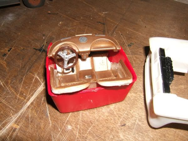

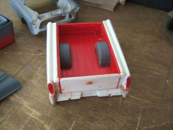

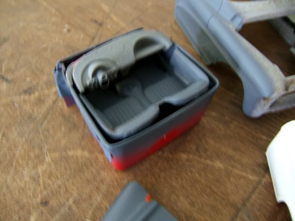

outlaw035 Posted March 11, 2008 Author Posted March 11, 2008 well still struggling with some body work but moving along slow but steady......below i hope...lol are pix's of the interior with the vette dash and seats...and the bed with the vette tail lites and tubs added....
Raul_Perez Posted March 11, 2008 Posted March 11, 2008 Neal, The tubs look good! It also looks from the picture that you pulled the sides of the bed in at the front to close that HUGE gap between the bed and the cab. I know that you don't want to "clone" my truck, but you might want to add a small strip of plastic to fill in the top edge of the bed where the sides are attached. That really cleans up that whole part of the bed, making the sides look more integrated instead of "bolted on" as they were. If you're still considering using the early Vette waterfall interior, I'd give serious thought to making this one a roadster pickup. That way you could easily resolve the issues with fitting the Vette seats into the truck interior tub...and then carry the waterfall shape back into a stylized bed cover. As a roadster pickup, the waterfall interior would be really well seen...and you wouldn't have to deal with the fact that the windshield in the kit is too small for the opening. You might even try to see if the custom roadster windshield from the Vette kit will fit onto the truck. I think that it has a pretty interesting shape with the driver's side being slightly higher than the passenger's side. Yes, customizing models can really be a pain in the a**, but it's really rewarding when it works well. Good luck and don't give up, my friend. You'll get there. Regards,

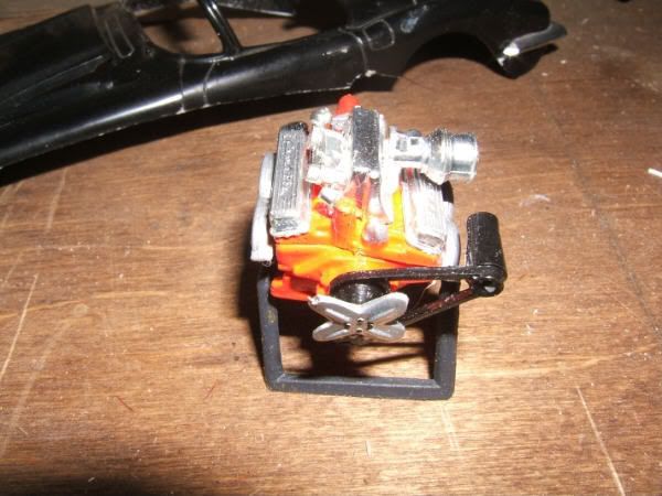

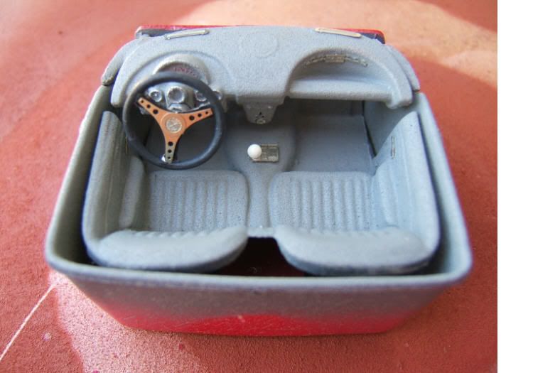

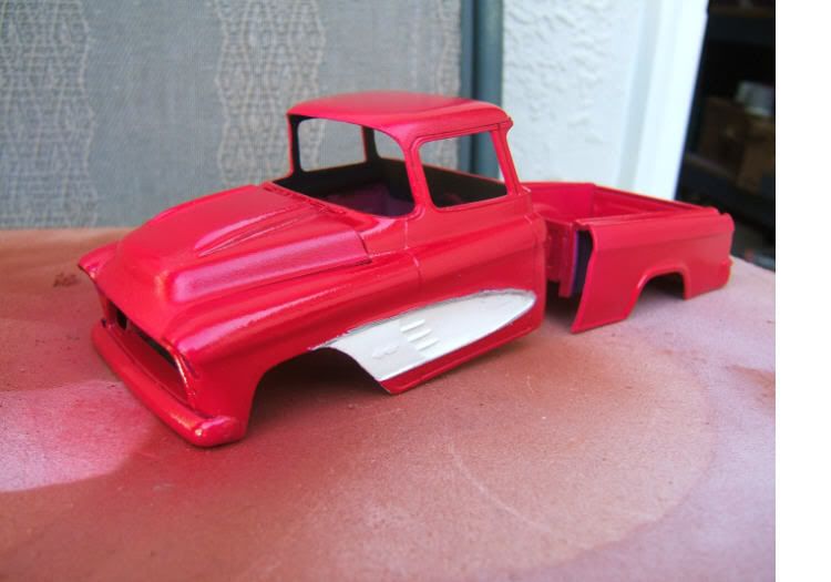

outlaw035 Posted June 7, 2008 Author Posted June 7, 2008 (edited) hi every1...its been slow going but things are looking better now...the paint job is not as nice as i would have liked...i sprayed the white then used micro marks masking and shot the red nail polish...thought all was well...peeled the mask of took most of the white gloss paint with it...i taped it off and shot it again so it offical....its a 4 footer...lol...here are the pic of the paint....engine....interior....hope fully it will be under glass some time next week.... Edited June 7, 2008 by outlaw035
Raul_Perez Posted June 7, 2008 Posted June 7, 2008 You're getting there, Neal!! I really like the white insert against the bright red!! That fuelie motor os looking good, too!!
