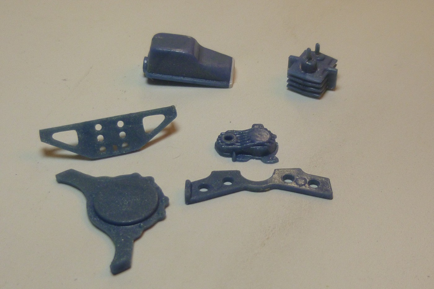

Here's where it starts getting serious. I gathered all the parts that are specific to the old 392, and started getting them prepped for the new 392. Since it's a boat, there are some specific parts that have to be used on the new engine, so I have to make them all fit. I found at this point that the new 392 is about 1/16th of an inch longer than the original 392...here's where it's gonna be a challenge!
I'm hoping I can shift the mounts just enough in the boat to make it work, we'll see what happens when I get to that point....t's gonna fit, one way or another!
Here's all the parts (Minus the headers) that have to be made to play nice with the new engine.
I have no clue what this part is, but it takes the place of the fan out front, so it's gotta be made all nice and pretty. I plan to strip all the old chrome and go with some Metalizer Stainless Steel...a bit more accurate for something that is used around the water!
There was a very nasty seam between the cooling fins on this thing, lots of fun to get it looking like it does now! This may be sprayed with Aluminum, we'll see!
And of course, since the block is slightly longer on the new 392, the old oil pan needs to get a bit bigger, so I grabbed a piece of plastic that made the oil pan just the right size, and glued it in place.
The newly extended oil pan was test-fit on the new 392, and it fits perfectly!
Next step was cleaning up the extended section to make it look like it belongs there...
Nice and pretty, Mikey likes it! :P:
The last bit of work I did last night was to attach the mount for the rear engine mount to the oil pan. I mocked it up on the new engine and rear mount to insure it was in the proper location, then glued it to the oil pan.
