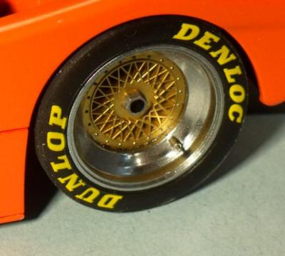

935k3 Posted May 16, 2015 Posted May 16, 2015 (edited) The base coat color does effect it. I usually put a base coat of Alclad White Aluminum down first. This is perfect for the gold on BBS style wheels. Edited May 16, 2015 by 935k3
