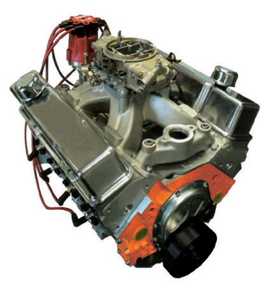

Here is a blueprint of the SBC basic engine, clearly showing the 4.4" bore spacing, and the offset between cylinder banks, as discussed, to accommodate connecting rod fitment on shared rod-journals of the crankshaft.
Edited by Ace-Garageguy
