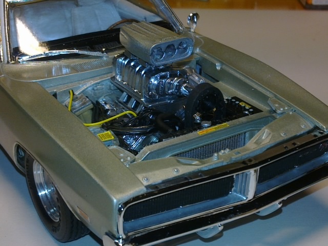

fseva Posted June 8, 2015 Posted June 8, 2015 On 6/8/2015 at 12:07 AM, Harry P. said: I've had good results with Spaz Stix. All the chrome on this model is done with it. Very nice, Harry! Any tips to pass along on using SS?
Harry P. Posted June 8, 2015 Posted June 8, 2015 On 6/8/2015 at 2:36 AM, fseva said: Very nice, Harry! Any tips to pass along on using SS? Not really. Maybe I'm just lucky, but I spray it on like any other paint... maybe a touch less, though. I seem to get the best "chrome" effect using less of it... seems like if you lay it on too thick the "chrome" effect isn't as strong. Here's that same model earlier in the building process... '
fseva Posted June 8, 2015 Posted June 8, 2015 On 6/8/2015 at 2:40 AM, Harry P. said: Not really. Maybe I'm just lucky, but I spray it on like any other paint... maybe a touch less, though. I seem to get the best "chrome" effect using less of it... seems like if you lay it on too thick the "chrome" effect isn't as strong. Here's that same model earlier in the building process... ' Looks even better, here! It's funny you should mention that you perhaps use less paint... I believe the instructions say that you should lay it on pretty heavy - to the point where there's "paint dust" visible! Then, after allowing some cure time, you go back and gently buff the powder away...
Harry P. Posted June 8, 2015 Posted June 8, 2015 On 6/8/2015 at 2:46 AM, fseva said: Looks even better, here! It's funny you should mention that you perhaps use less paint... I believe the instructions say that you should lay it on pretty heavy - to the point where there's "paint dust" visible! Then, after allowing some cure time, you go back and gently buff the powder away... I've never tried it that way. Maybe I should, just to see which way gives better results. But either way I'm a big fan of the stuff. It may not be the equal of kit plating, but I'd say it's 90-95%. If I didn't say otherwise, I'd bet nobody would suspect that the "chrome" on my Rolls is actually spray paint!

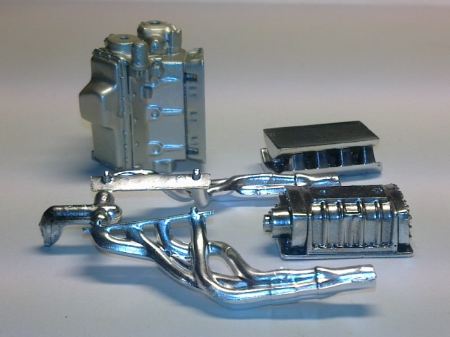

Pavel A. Posted June 8, 2015 Posted June 8, 2015 (edited) On 6/8/2015 at 12:06 AM, fseva said: I'm not sure what you mean by 2K Clearcoat... I don't think it's available in the states... Would any lacquer clear work the same way, or have you only tried it with the 2K Clear? After you're completely done, does it withstand handling any better than the way Spaz Stix recommends? Hmm, So. For good results for the aplication of Spaz Stix (so as Alclad) you need black, gloss and dust free surface. The first I apply black colour (doesn´t matter which sort - best is for example flat black from Tamiya), than I apply 2k clearcoat (you can buy it at each color or painthouse, it is clearcoat for real cars). 2K clarcoat is the because you can apply it on each sort (type) of colors. Its going harder on base of chemical reaction. I can say simple, 2k is not aggresive to colors, so as decals. Why I apply 2k over black? Because it makes real "black mirror", what is necessary before Spaz or Alclad apply. Here are some photos, how I make it... I use 2k Ivat, it is Italian products used by Ferrari. ...And if it is prepared surface like this, than I apply Spaz (surface is not polished on the photo) And here it is apply on real car colors. Red and black are nitrocolor, blue is waterbased color (pure water for thinnig! no stink!), and chrom is Spaz. Red and blue were matt after aplication, The high gloss makes 2k... Edited June 8, 2015 by Pavel A.
