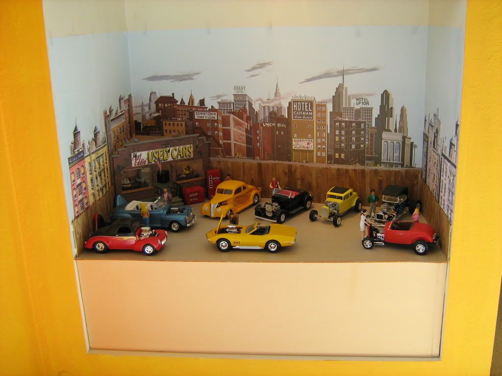

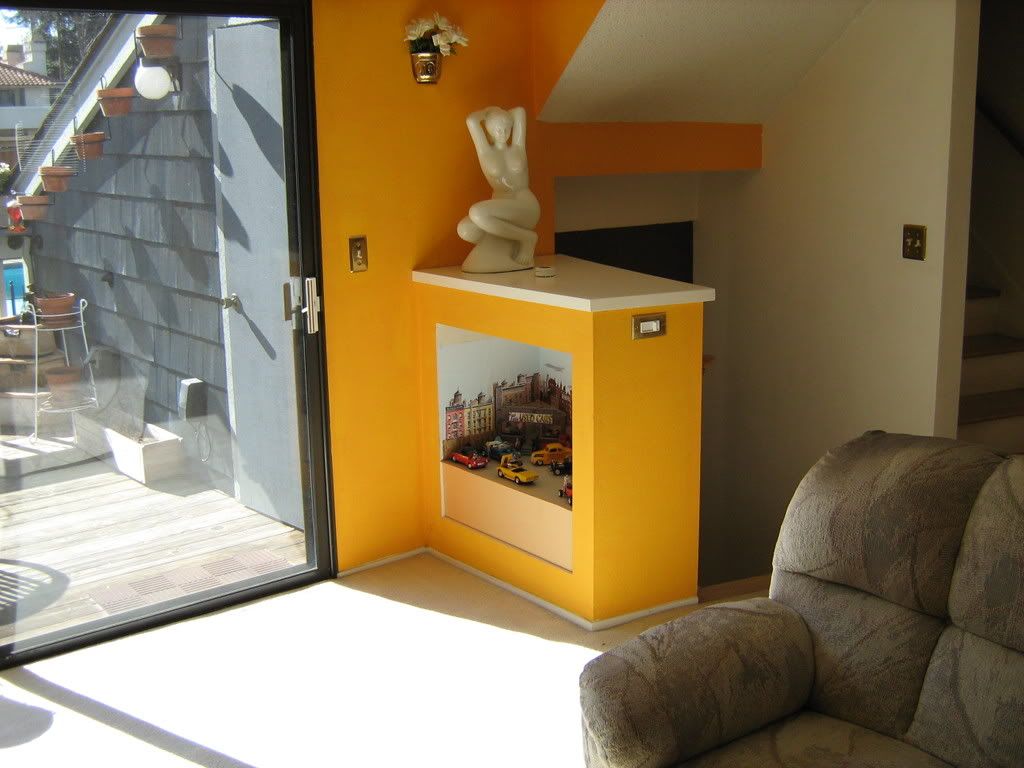

Some time ago, I posted that I was running out of room on my shelves for my models. I had an area in my living room that was used for wine storage. Got rid of the wine and made it into "Fast Eddy's used car lot". With a whole lot of help, tips, and ideas from you all, it got done. Got a camera, kind of learned how to use it, and with some more help, got some pics posted, I think. Still don't know how to do individual captions or comments, so will try to post them all. I'm sure that you can figure them out. Comments will be appreciated, good or bad, since I am a real newbie at this.

Nw you gotta love that diorama and location, really good job on it.
Thanks my friend. You showed me how to get the pics up. :D

The height of the area was way to big so I made a base to raise it out of poster board. Nothing fancy, just some hunks about 6" high held in place with masking tape. I knew that the surface would be exposed to morning sun so I opptied for a gray base to fade over time.

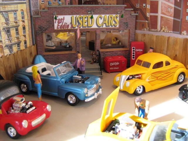

The far background buildings are HO scale from an on line railroad model source. The side buildings are G scale, a little larger, to try to give some depth to the overall scene, same source. The fence is squared off popsickle sticks trimmed and stained.., and secured to the walls with 1/8 thick double back tape, again to add a little depth. Figures are held in place by "pinning" them. A short pin inserted into feet and about 1/8" into the surface. They can be moved without much obvious damage.
Figures are available from a bunch of places, painted or not. Cat, dog, and pidgins, along with the scale models in the office, are from the LHS.

It looks great, lots of good detail!
Have one question, is the blonde in the blue pants TOPLESS! :D
Bet that gets a few double takes!

Nope, bikini top, but it sure got "Irv's" attention.
WOW! That looks like it was a lot of fun Milt. Great use of an area that isn't used any more. Neat idea and great use of HO and 1/2" scales together. Looks great!
It was great fun Mike. Very different methods from car building. Everyone should do at least one. Will give you a greater appreciation for some of the dioramas posted here.

Hope that it worked. Comments appreciated, my first try at a diorama. B)
Great job! B) I really like how you integrated it into an otherwise useless section of wall. The cars look well built as well. I like the two Deuce roadsters you got there, too. :P
Great job! :D I really like how you integrated it into an otherwise useless section of wall. The cars look well built as well. I like the two Deuce roadsters you got there, too. :o

Very nicely done! Nice use of space! You must have a very understanding wife!! I know I do!
Thanks Tony. No wife. I am king of my castle. :P
