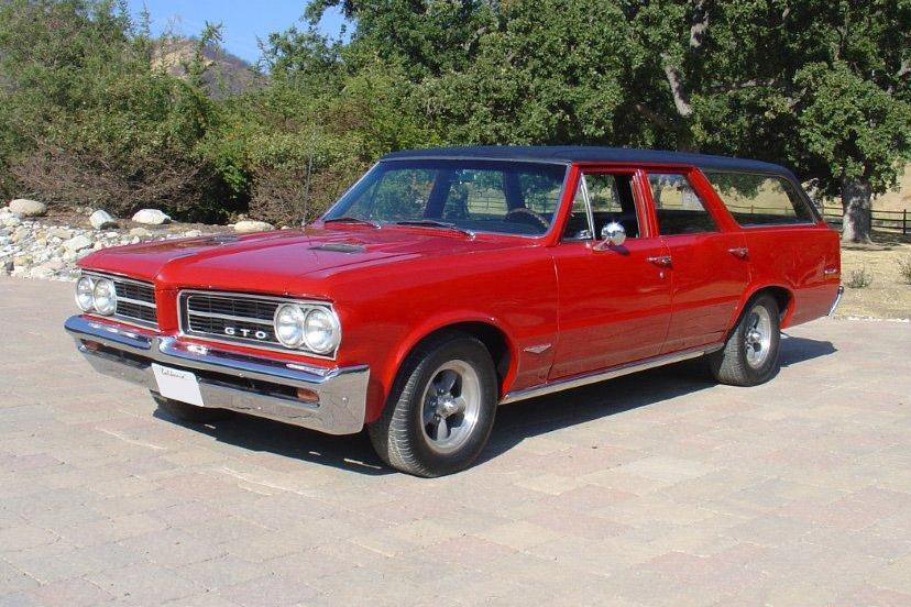

Atmobil Posted October 2, 2015 Posted October 2, 2015 So i'm sitting here with Polar Ligths 64 Pontiac GTo snap kit and AMT 65 Chevelle wagon. I got this idea of makin a 64 Pontiac wagon by taking the roof from the Chevelle kit over on the Pontiac body.I'm looking at pictures and from what I can see there is little differece between the 64 and 65 Chevelle wagons and the roofline on a 64 Tempest looks similar aswell but is it?Anyone here know these cars good?Am I all on a lost track with this or is a realistic thing to do?
Sledsel Posted October 2, 2015 Posted October 2, 2015 How is the size difference? Do it!!!! It would be cool.
Crazy Ed Posted October 2, 2015 Posted October 2, 2015 They're both A-Body Wagons and except for the IDing parts like Grills and Rear Ends (different tail lights) share many parts and body panels. The Chassis's are the same.
Deano Posted October 2, 2015 Posted October 2, 2015 Oh, I like that red 64, especially the vinyl top treatment; so cool!
Atmobil Posted October 2, 2015 Author Posted October 2, 2015 That red one there is just the thing I'm thinking of. The Polar Lights GTO and AMT Chevelle don't seem to have teh same wheelbases but I think that I could possibly transfer the roof from the chevelle over to the gto body. Will probably have to use the Chevy rear end with taillights and such.It just feels more exlusive than the standard Chevelle wagon and a a bit more special than a GTO convertible that I got (and why on earth did they pre-paint it yellow??)

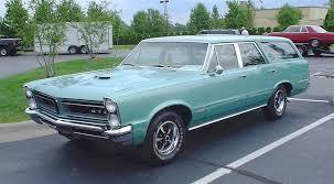

Edsel-Dan Posted October 2, 2015 Posted October 2, 2015 I want to do the same thing, but prefer to start with the GTO ConvertibleWith the Polar Lights hardtop being issued twice molded in whitewhy have they not offered the convertible since the original "American Muscle" Pre-painted issue???I believe they were offered in 4 colors eachI passed on the red as it looked like a VERY Faded color and Not a New Bright color My plan was to not only do this with the 65 I started, and the 64, but 66 & 67's tooI Have shown the 65 Project, It will Keep the GTO emblems as I do not have Tempest or Le Mansscript to replace them!! Heck, it will have the GTO Hood, so why not leave the Badges?? One bit of info here, you can use either AMT's 65, Or Revell's 66 Malibu Wagon kitfor the Long-Roof transplant!!!
