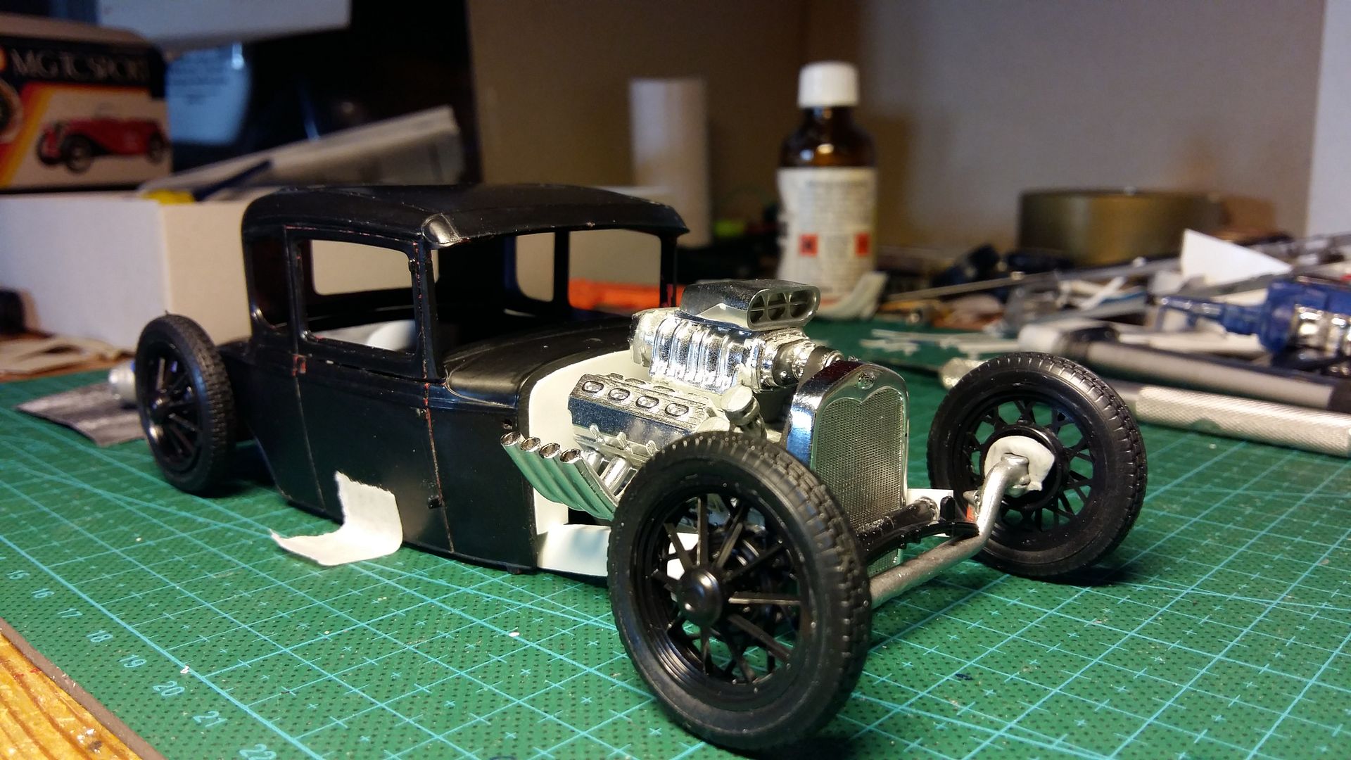

something like this

3) I've got one in progress using the actual Monogram shell you have, but chopped. It's on a 1/25 '32 frame, and you see the scale difference is quite acceptable.
