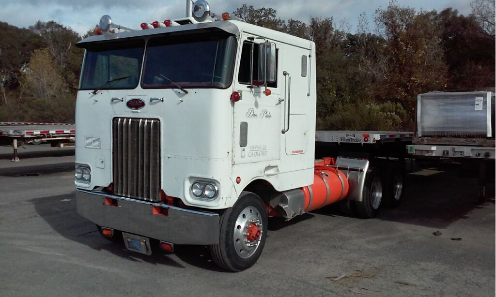

Going off topic for a second. My buddies boss just bought this toy. It has a small cam cummins, center point steering and straight cut 13 speed.
Man, how I miss the whine a straight cut 13.
