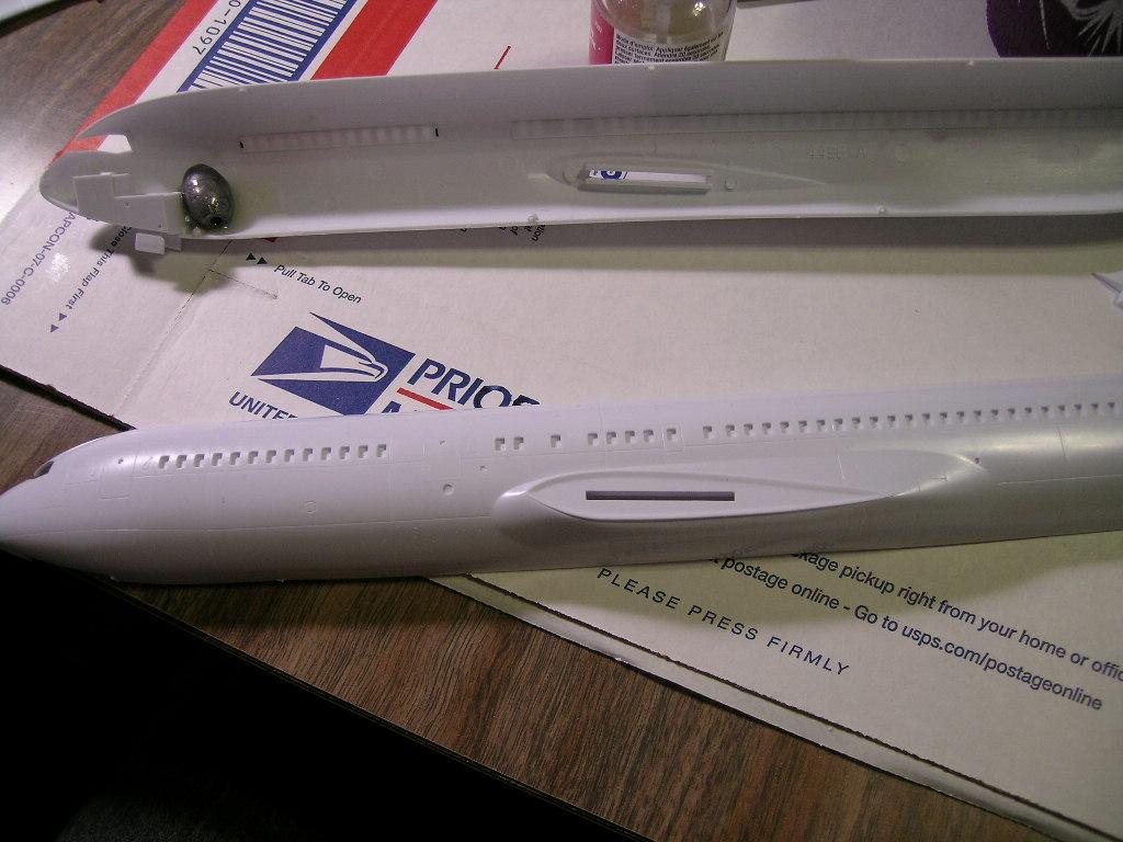

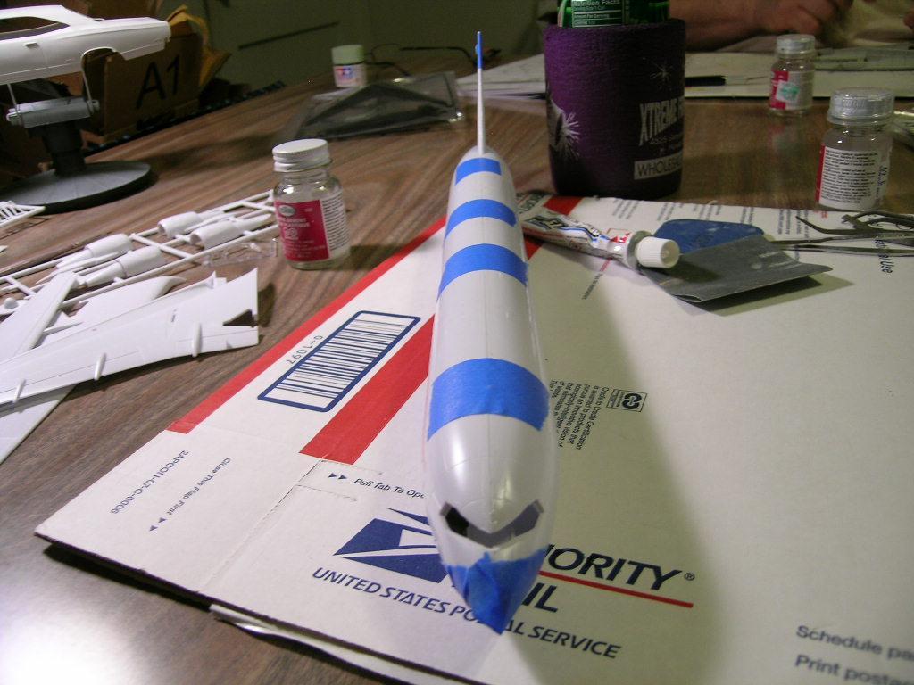

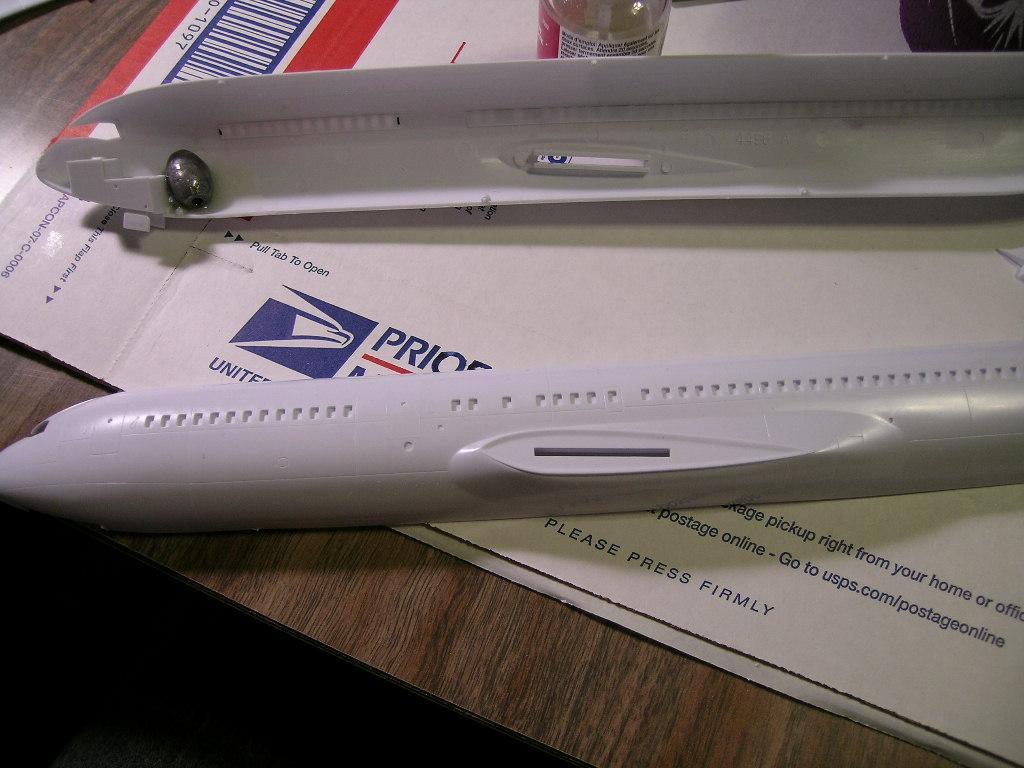

Some good progress made on this last night. I added .015 backing strips to window area for putty to follow, assembled nose gear well, and epoxied a fishing weight inside nose.

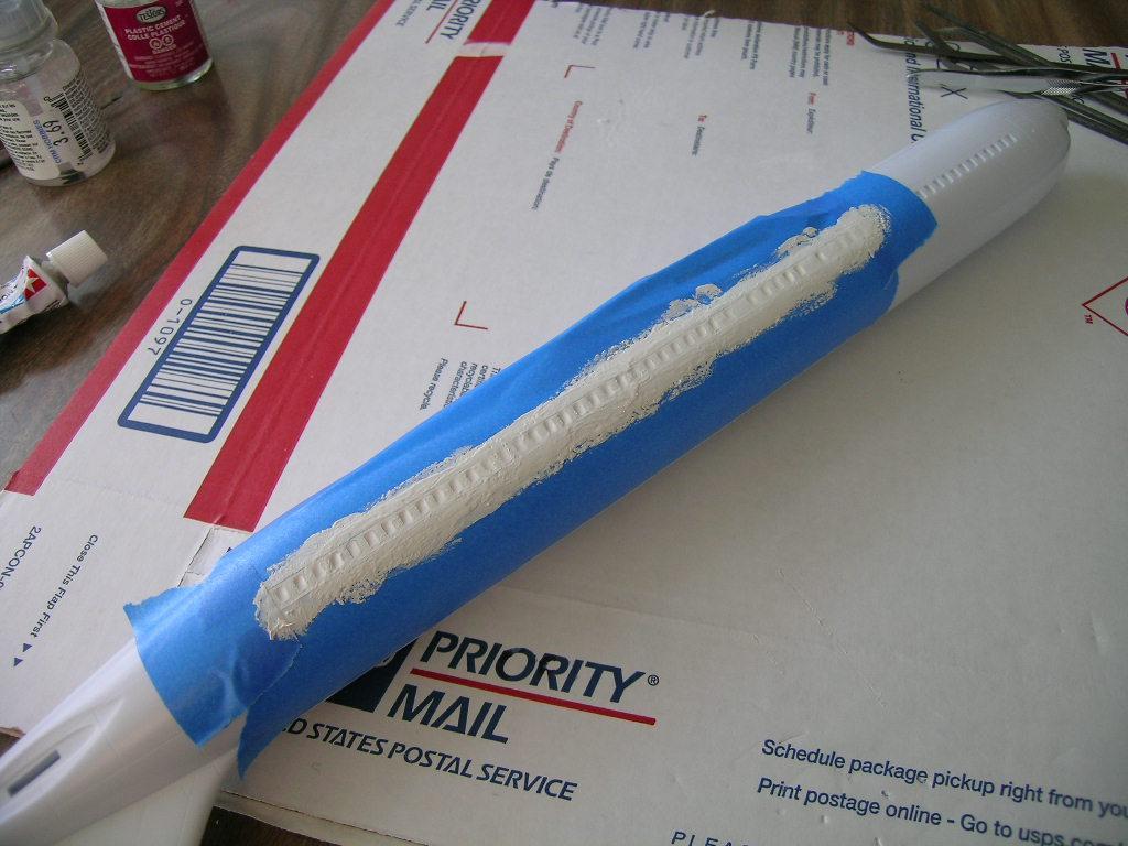

Fuselage got all taped up after gluing major seams. It looks like there's a groove in the seam, because there is. I usually bevel one surface to assist with gluing and provide a shallow V shaped trench to ensure a 100% complete putty filling job.
I like the window backing trick.  Guess I'll have to find window decal sets for all of mine so I can fill the center fuselage seam. I have a collection of commercial airliners to build myself. All of which I've flown on in the past.
I puttied one up without the backing once, and then putty started pushing through into the interior during all the  handling that's required during finishing, so I said "no more"; been using this method ever since.

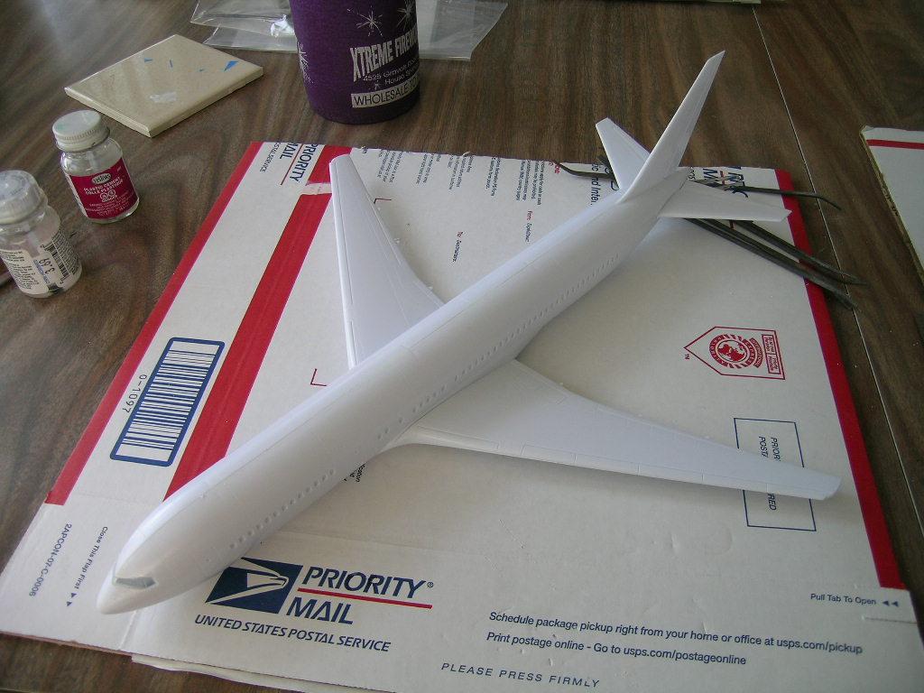

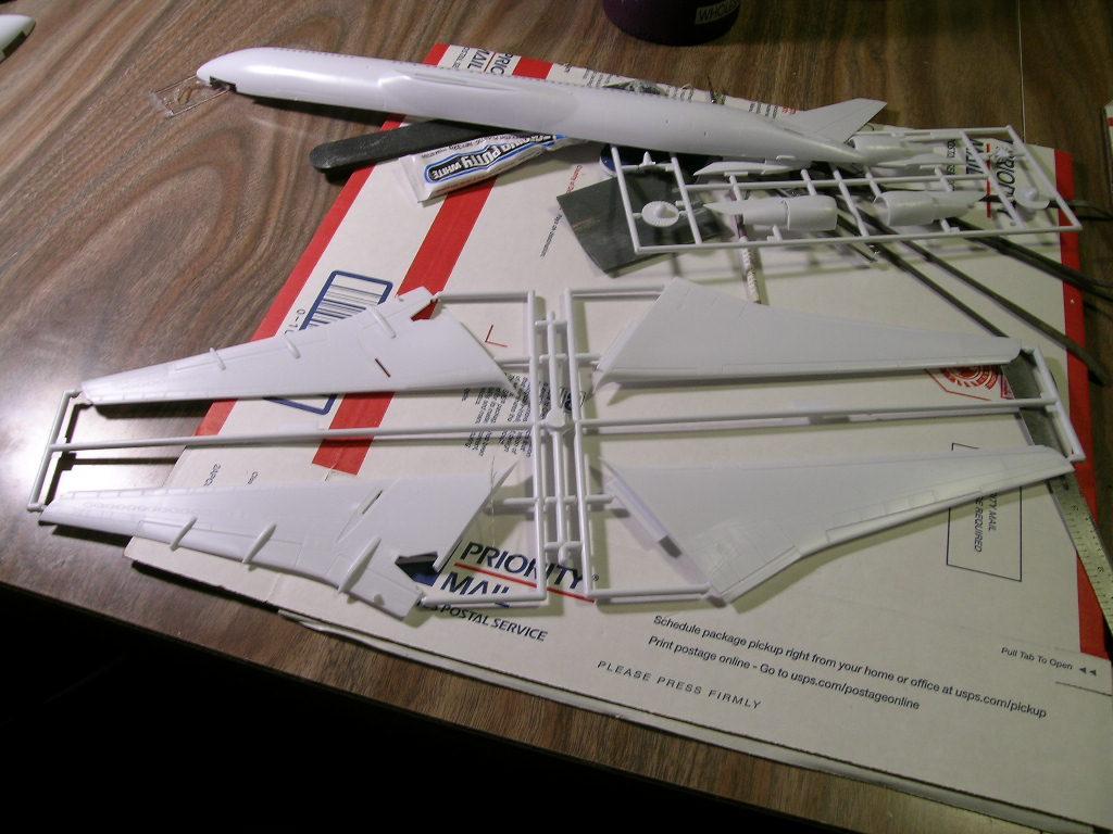

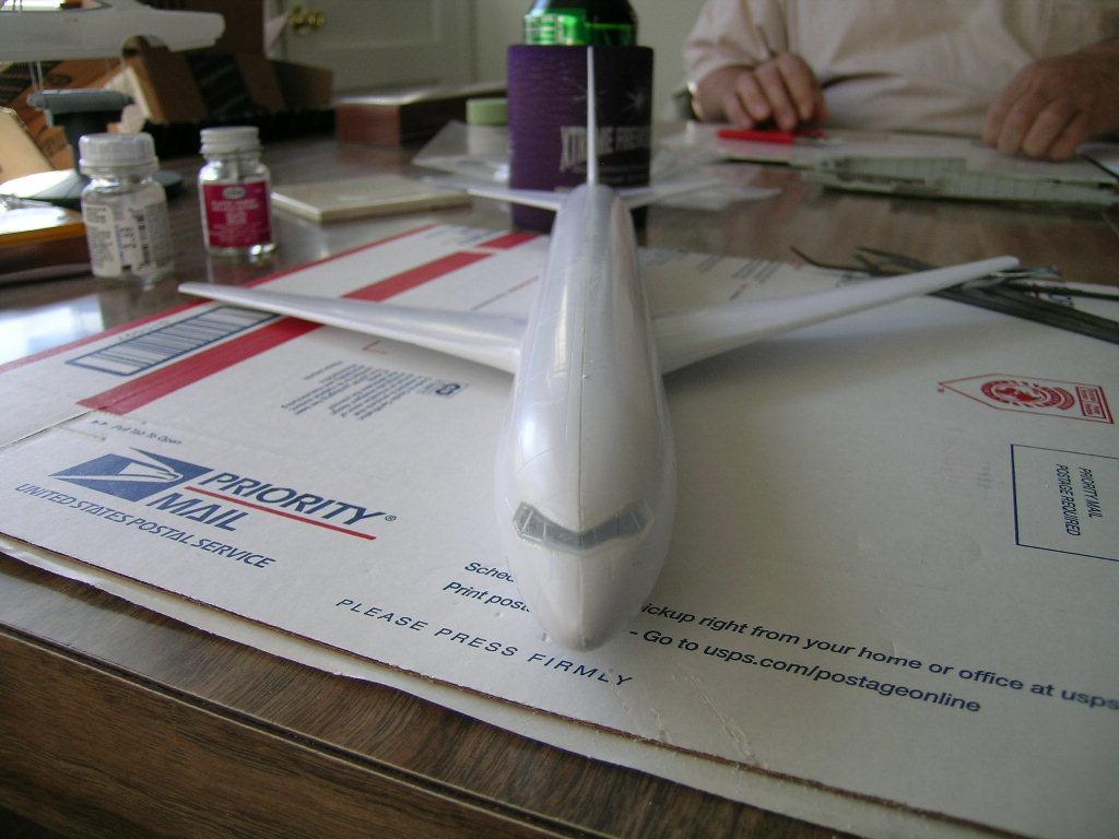

OK, with everything dry now, time for the test fit. I really don't know why I bother though, the Revell kit parts fit so well, that the wings can easily be attached later, after all the painting and decaling is finished.

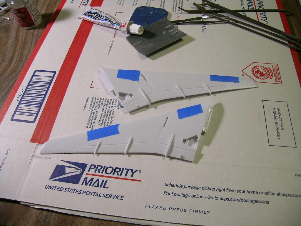

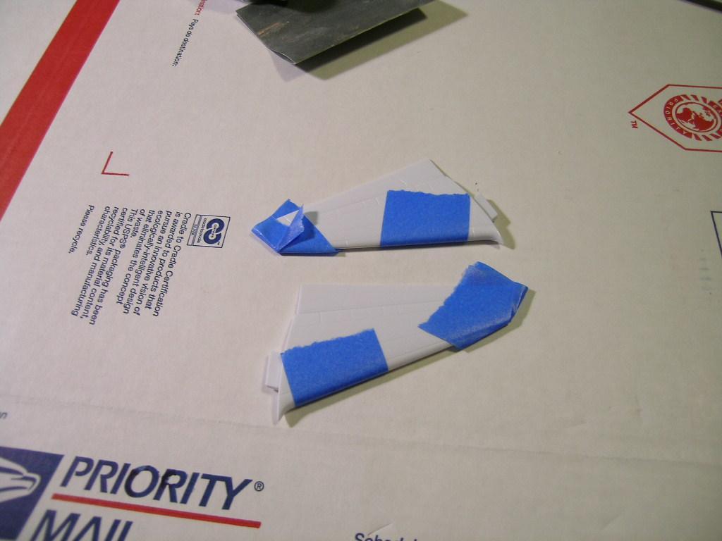

Straight as straight can be. Perhaps I just lucked out, Kev. The one problem that I've consistently had with these 767 kits, is the inboard trailing edge flaps are always bent, I think they have been on every Revell 767 kit that I've worked worked on.

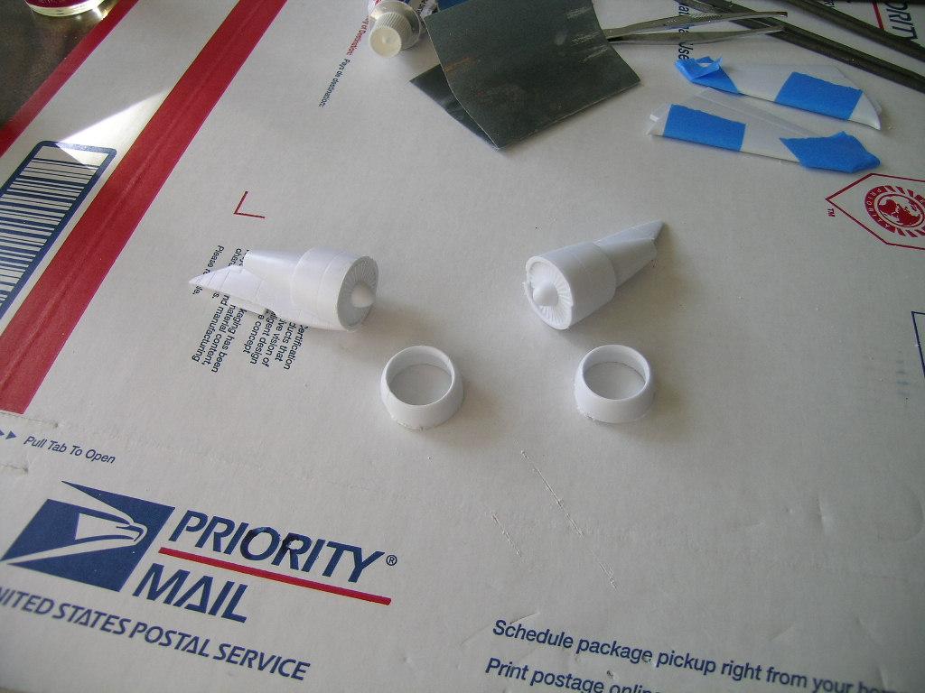

I've somewhat arbitrarily decided that these GE engines are not so bad, and that with a little effort, they can be made to look quite acceptable, even if not necessarily accurate. To that end, I've cut the forward portion of the cowls off, so that I can more easily eliminate the nasty seam on interior. While doing this, I cut one too short (the one on the right) and ruined it, so I'll have to scavenge one from one of my other kits.

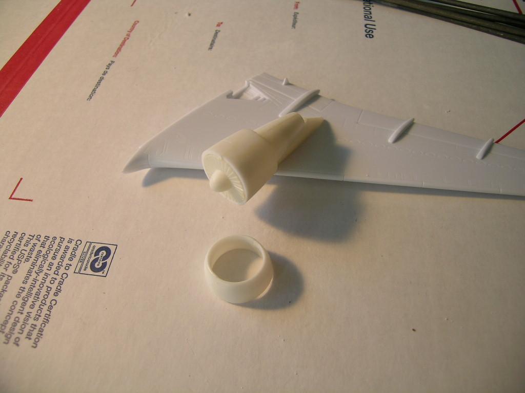

It's also come to my attention that the big GE engines are too short in length, so I'll be adding a ring of material at the rear of the detached cowl fronts to stretch them somewhat.

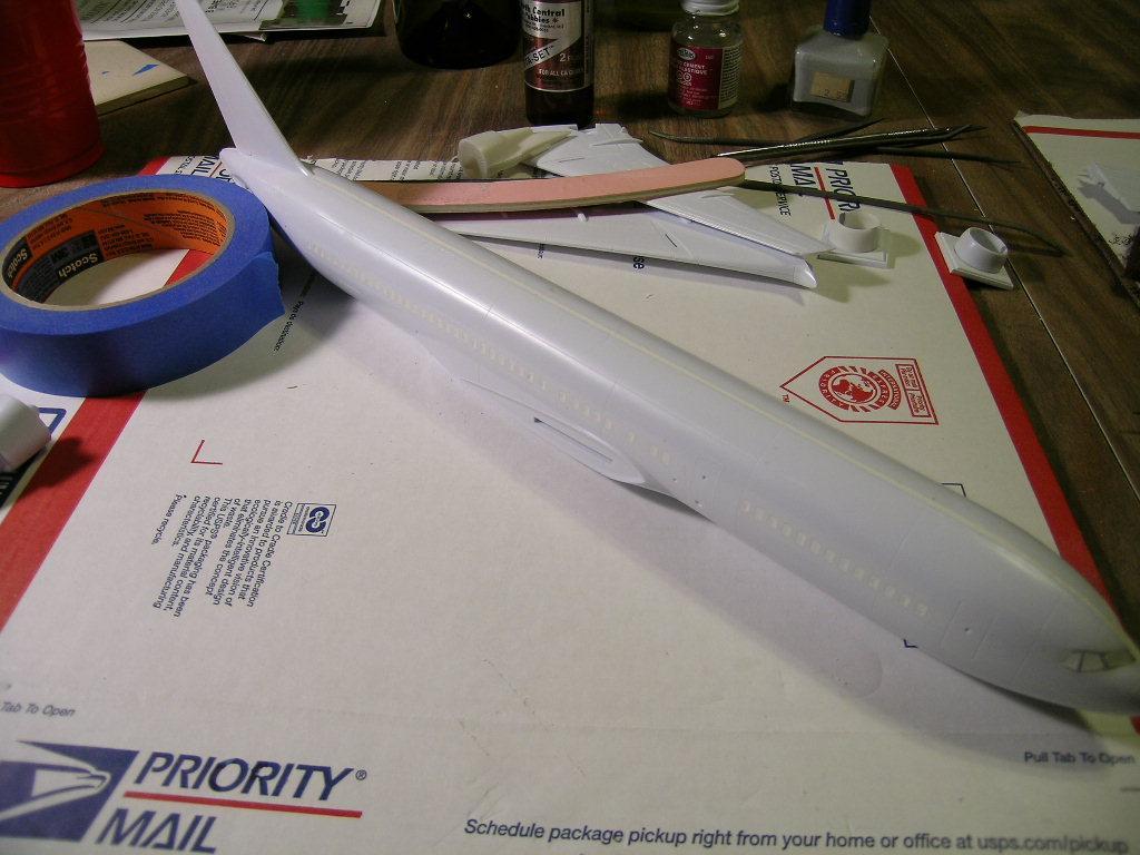

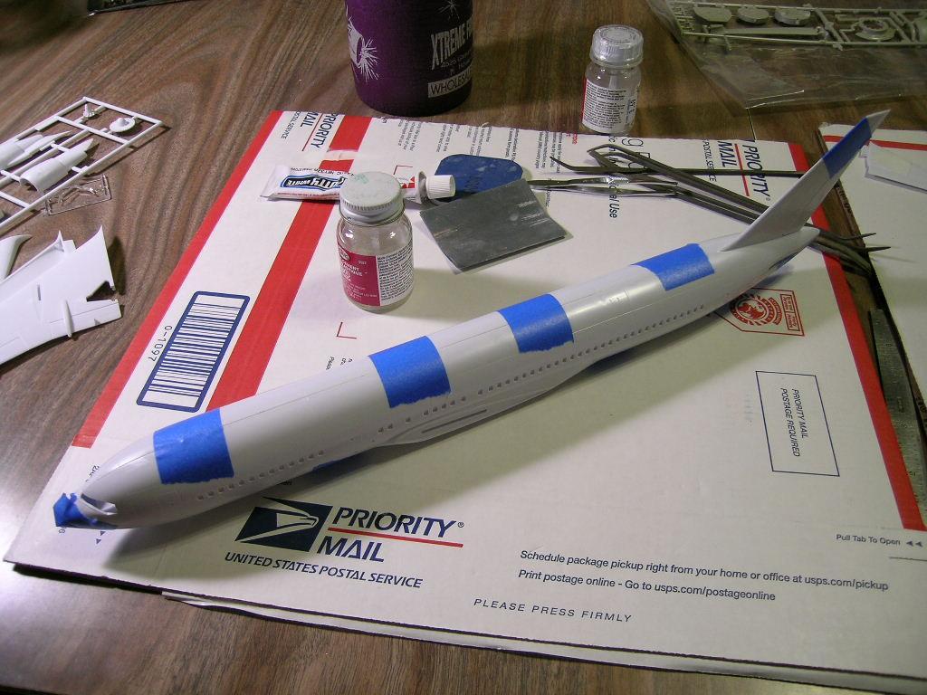

Not a lot done here, but at least a little. All windows and major seams have now been puttied up and sanding (lots of sanding) has commenced.
