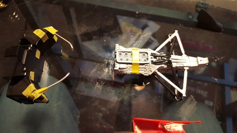

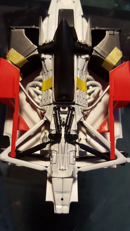

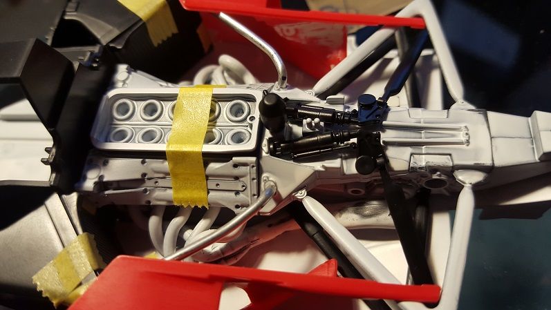

I added the coolant piping that for some reason, isn't included with the kit. Perhaps Tamiya keeps things like this out to give us something to scratch build but with the quality of their kits, you'd think details like this would be included. Anyway, i used aluminum rods. I still need to add two pipes close to the firewall.
I may assemble the model in this method, first placing the engine onto the floor, then placing the firewall/radiator assembly so that the piping goes onto the engine rather than the engine and piping going into the radiators. If that makes sense.

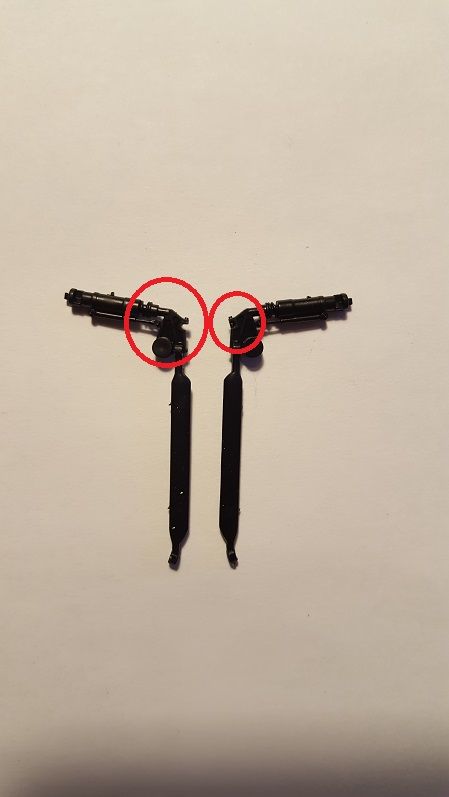

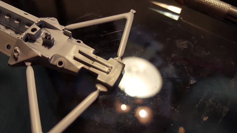

These crappy suspension bits molded onto the transmission casing need to go!
Then these suspension bits needed to be modified to receive the aluminum rod used to replace the molded bit.

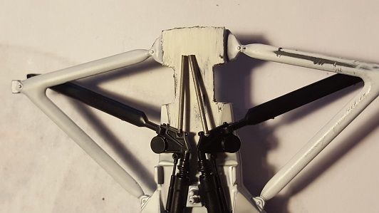

With a little Tamiya White Putty laid down (and not yet sanded) I placed the rods to give myself an idea of what we're looking at.
that's the progress so far...

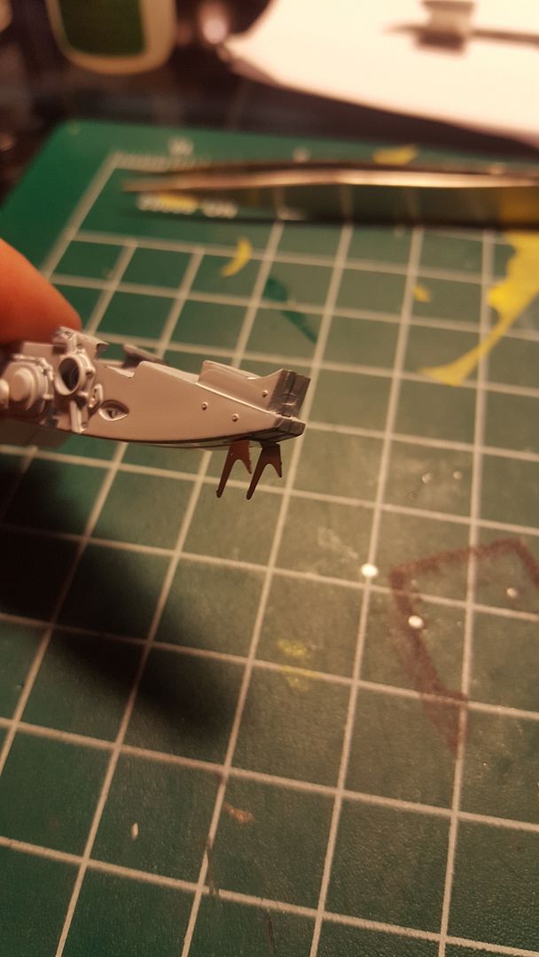

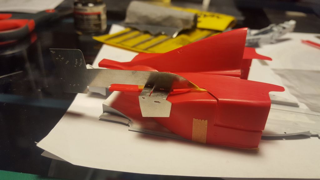

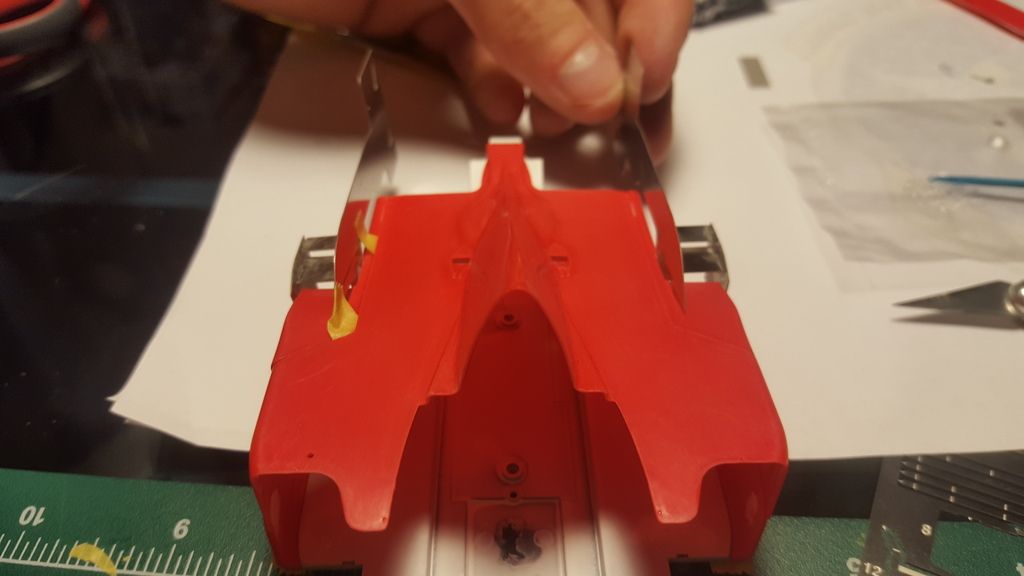

Made some small progress over the weekend. The P.E. set arrived so I set about constructing the wing ends. I'm currently wrapping up my Ferrari F60 and I realized how much of a chaotic mess constructing the rear wing is so I made a trip to Hobby Lobby and bought some balsa wood and made a jig. Theoretically, this should make construction of the rear wing a bit easier. I also added the PE lift point in the rear.
