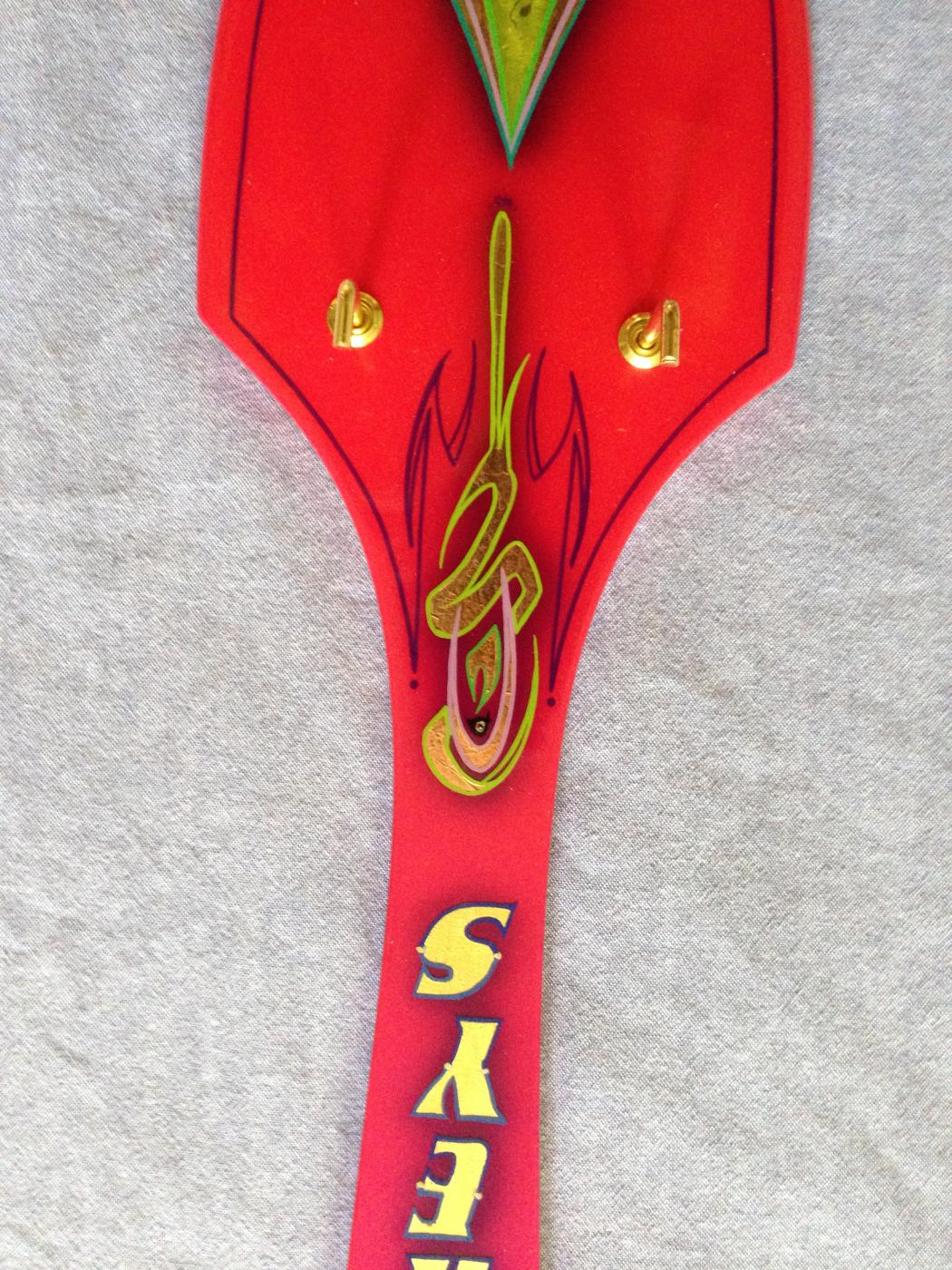

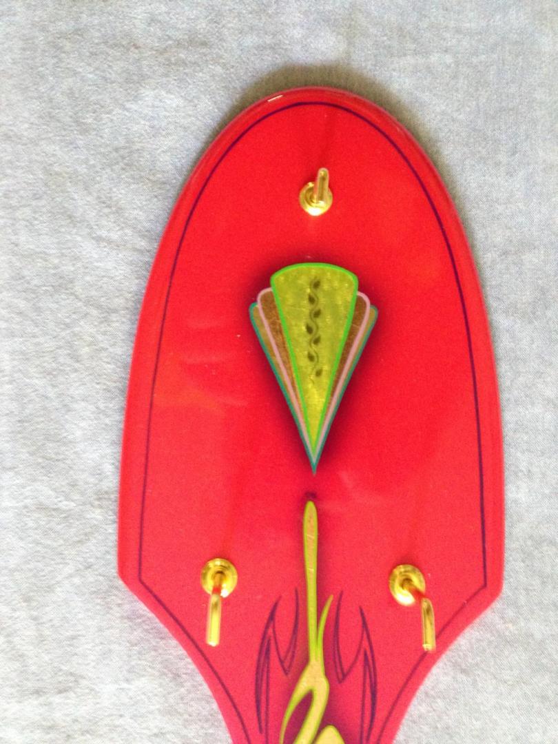

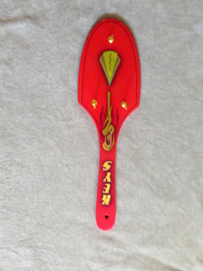

jwrass Posted August 14, 2016 Author Posted August 14, 2016 (edited) Thanks to all have replied to this post be it positive or not so much. I am working on a edit to the process to put to bed what I feel is a much superior effect to BMF Here a few reasons why I think it blows away BMF 1) You can manipulate the texture to pretty much what you desire 2) You don't have to take a knife to your substrate.... every time I see someone cutting on paint it makes me cringe. 3) You can patch in any area seamlessly. Skip makes some very great points (Thanks Skip) The leafing process is so much easier than you think and not very time consuming at all. I'll break in down. 1) Brushing the size: 5 minutes. 2) Lying the leaf: 10 minutes. 3) Burnishing the leaf :10 minutes. DONE I based these figures on doing both sides and front and rear windscreen trim. Emblems and door handles come out so clean as the leaf only sticks where the size was applied no cutting on the surface. That's a total time of 25 minutes..... I'd pay good money to see someone lay that amount of BMF in that amount of time. The most time consuming part of the process is waiting for the size to tack up for application I used to use BMF and one day after doing some leaf on a Race Car I hauled out a body and gave it a whack.... there was no turning back. I personally will never use BMF again as IMO it's inferior to the leafing process. In closing. I was offering a alternative to BMF which is really quite simple. I was surprised by some of the blow back..... lets see we hone our skills to do many types of processes yet some are not open to trying a new process, which is fine by me, I personally can't wrap my brain around that type of thinking.... different strokes I guess. It's just another tool in the tool box. Yes Skip and I have much experience in the process, However I agree with everything he wrote. He is right on A bit of eye candy...... Here are a couple of examples of various types of leaf. This is actually a wooden Pizza spatula that I made into a Key Holder for my Daughter, Kandies, Pearl, Flake, Leaf and Freehand Pinstiping. I wish the pictures were clearer.. They are very clear in my pictures folder, However when I attached them here they are fuzzy. The fan design consists of three types of imitation leaf, From the middle out is Silver leaf with a Kandie lime green misted over the leaf. Next is gold and the outer rim is Copper. The freeform design is various colors of variegated leaf. Keys is the real deal.... Genuine 23 Karat Gold. Roughly $20 dollars worth Enjoy.... Jimmy "RASS" Edited August 16, 2016 by jwrass addition
mod3l Lover Posted August 14, 2016 Posted August 14, 2016 That key holder is super awesome James!! David S.
