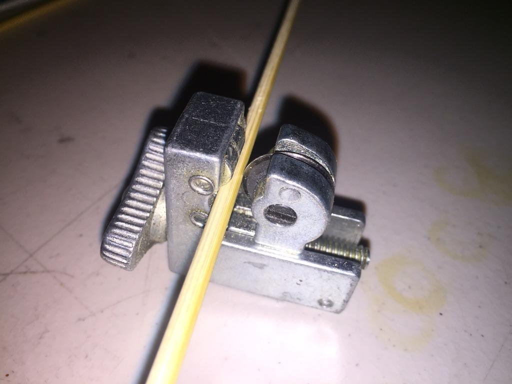

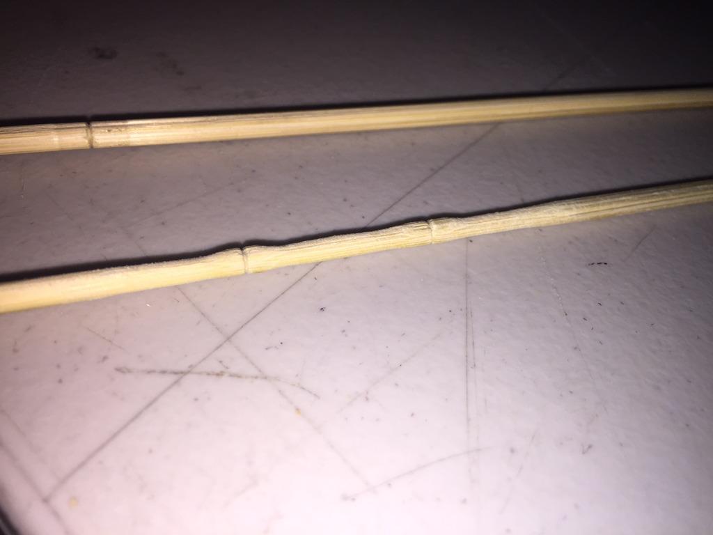

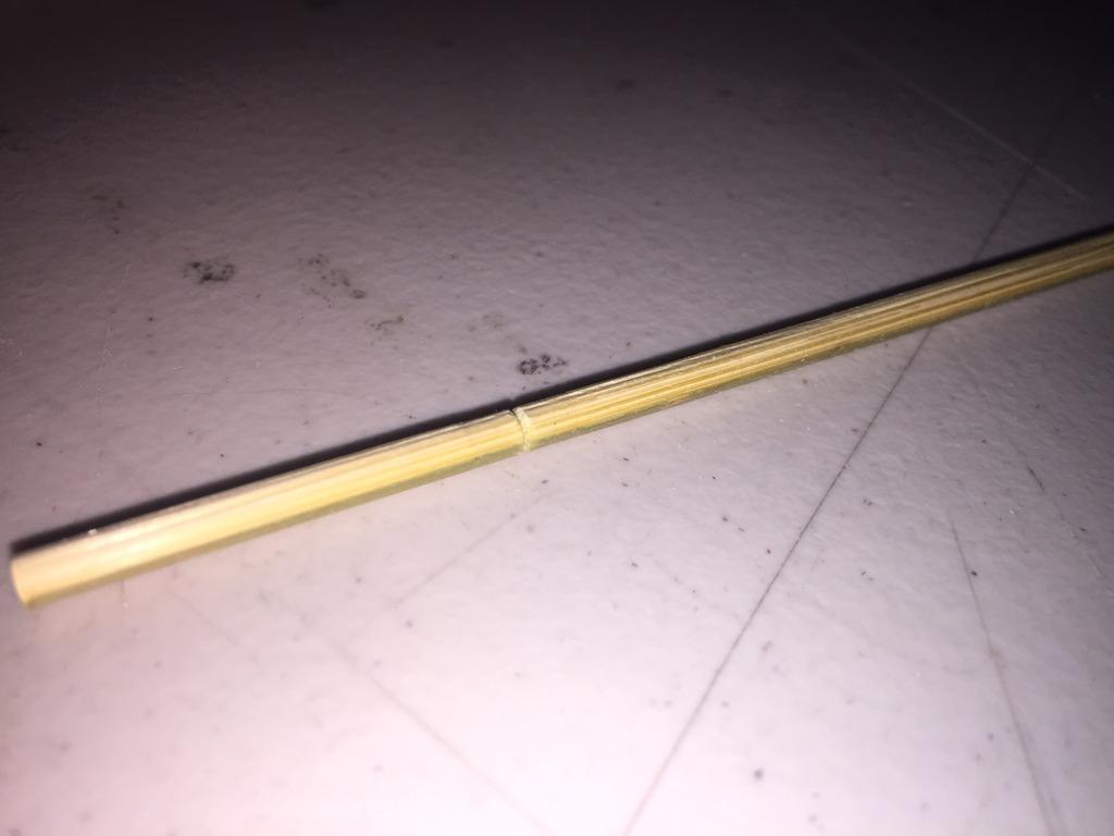

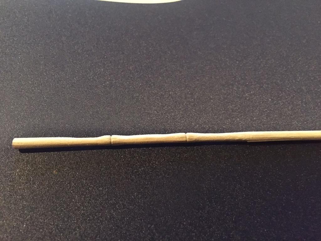

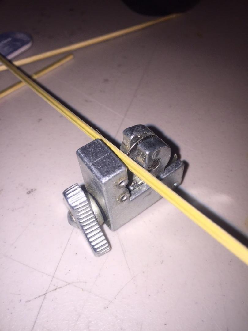

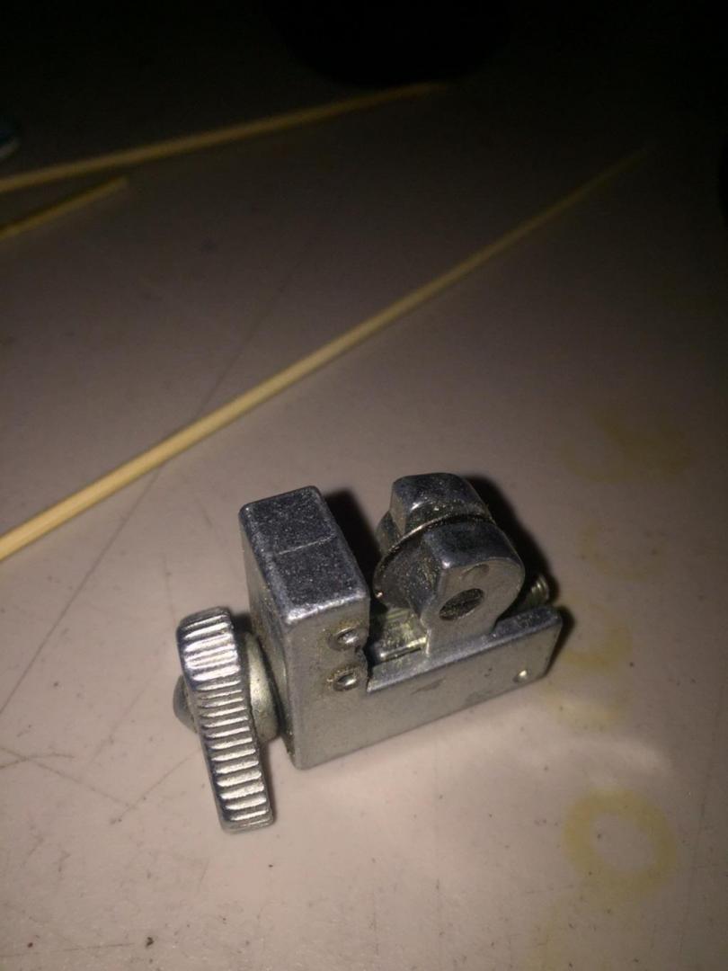

Darren B Posted February 10, 2016 Posted February 10, 2016 (edited) I thought I would share this with everyone, I am working on the freaky tiki build and wanted to model bamboo for the doors and bed but not sure how to go about it. I bought a tubing cutter and using files took the cutting edge off of it, and proceeded to use it to make the knuckle on a bamboo skewer then using a sanding stick reduce the size of the stick between the knuckles to look like bamboo, this first attempt is fine but needing to go about 50% smaller for the doors.,. Edited February 10, 2016 by Darren B
Darren B Posted February 12, 2016 Author Posted February 12, 2016 Thanks guys, im working on going smaller will update with any good results....

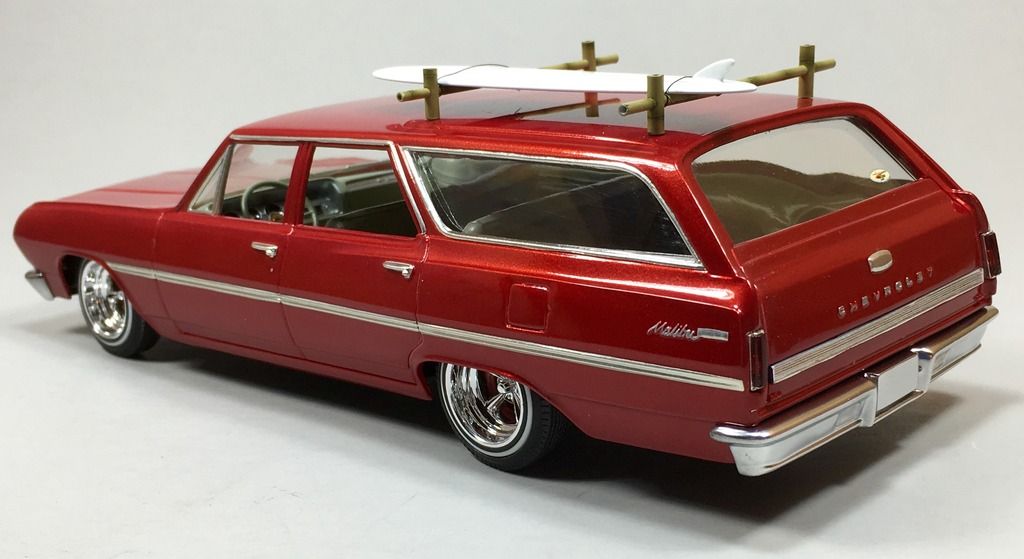

Erik Smith Posted February 14, 2016 Posted February 14, 2016 Cool idea so far. For the rack on this wagon: I just used round styrene. I rolled a blade on the rod at each node, then painted a base color, highlight color, then a wash on the node.
Darren B Posted February 15, 2016 Author Posted February 15, 2016 Cool idea so far. For the rack on this wagon: I just used round styrene. I rolled a blade on the rod at each node, then painted a base color, highlight color, then a wash on the node. Erik, i like the plastic better, even with the open tubes... What color/Brand of paint did you use for the color of the bamboo?
Erik Smith Posted February 18, 2016 Posted February 18, 2016 Erik, i like the plastic better, even with the open tubes... What color/Brand of paint did you use for the color of the bamboo?I think it was Tamiya TS3 Dark Yellow. I'll check the can to confirm when I get home.
Darren B Posted February 18, 2016 Author Posted February 18, 2016 I think it was Tamiya TS3 Dark Yellow. I'll check the can to confirm when I get home. That would be cool I actually like how yours came out it looks actually more realistic I am going to try to do it your way.
