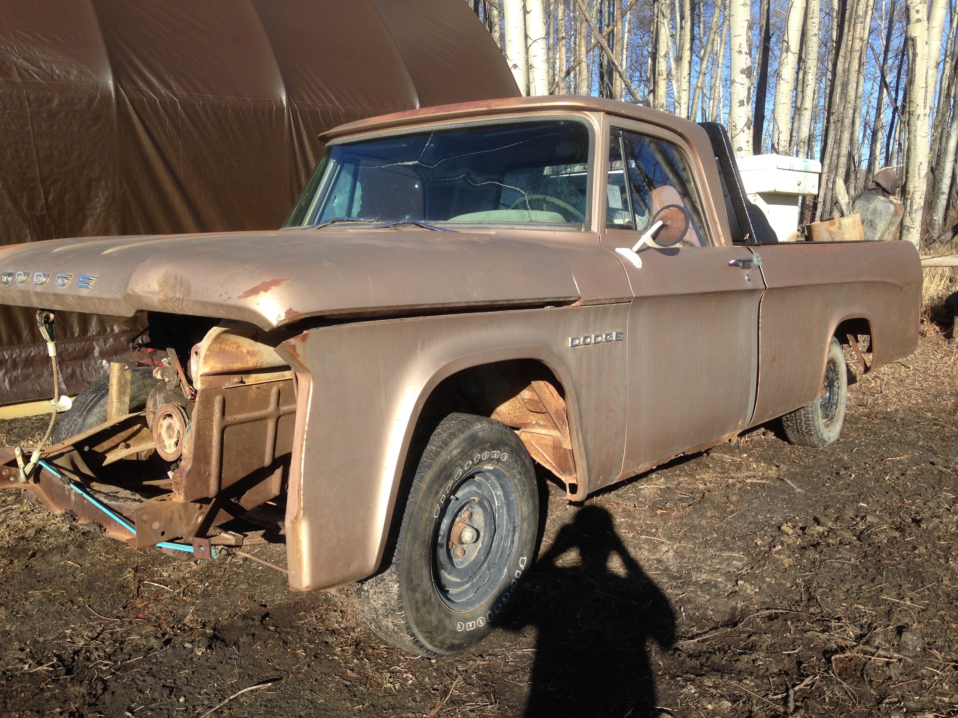

426 pack Posted March 29, 2018 Posted March 29, 2018 4 hours ago, Atmobil said: Cool, you got pictures? Here are some pics.
Atmobil Posted March 29, 2018 Author Posted March 29, 2018 Looks really nice and straight that one. What engine/trans was in it from the start? Slant six and treespeed? I'm guessing it was a manual gearbox as I see you got the clutchcylinder on the firewall. Here is some pictures of what I did to mine. The pcitures are sort of telling of my learingcurve with these. I have never worked on an old us vehicle before this one so I had to learn how things worked. Mopar is also different to GM and Ford and around here most are in to Fords or GM cars and Mopars are looked upon as something strange and alien so not as much help from people I know as I would have hoped. Right hand side rear brakes: Left hand side: And the left side drum, full of oil and bits of the brakes in it. And then I pulled out the axle on the right hand side: Front brakes, I replaced everything in the brakesystem. Notice that I had installed the shoes wrong. There is supposed to be a shorter liner on the front shoe. I discovered this when I was trying to install the new drum Notice the bearing on the driverside axle. I guess you can call it busted. And look what I found laying on the bottom of the rearaxle housing: The thrust buttons are supposed to be inside the diff between the two ends of the axles. Rear axle casing with springs, cleaned it all up with wirewheel on my anglegrinder and painted it with rustkiller primer and hammerpaint in gloss black. New fittings and the old coupling blocks cleaned up. Since the pipe sizes is one of those few things that still are delivered in old non-metric dimensions it was no problem to get a roll of about 30 feet of 3/16" copper pipe from the local autoparts store. I made up new pipes with the old ones as templates. The new and old pipes and the new ones fitted to the freshly painted rearaxle housing. I ordered new U-bolts and springbushings from Espo Springs and Things. Freshly painted springs, new dampers and new steeringparts. All the greasepoints have been filled with fresh grease. Same in the rear. Getting the diff back in on my own was not easy but I did manage to get it in. I also fabricated new upper mounts for the rear shocks, I have no photo of them but basiclly I made it from a M16 threaded bar with a 18mm pipe that I threaded the inside of and some M16 nuts in between to replicate the original parts that broke off when I removed the old shocks. I discovered that the driver side parking brake strut was broken. Some steel from an old floor jack was the same thickness as the original part. A couple of hours with an anglegrinder later I ended up with this:

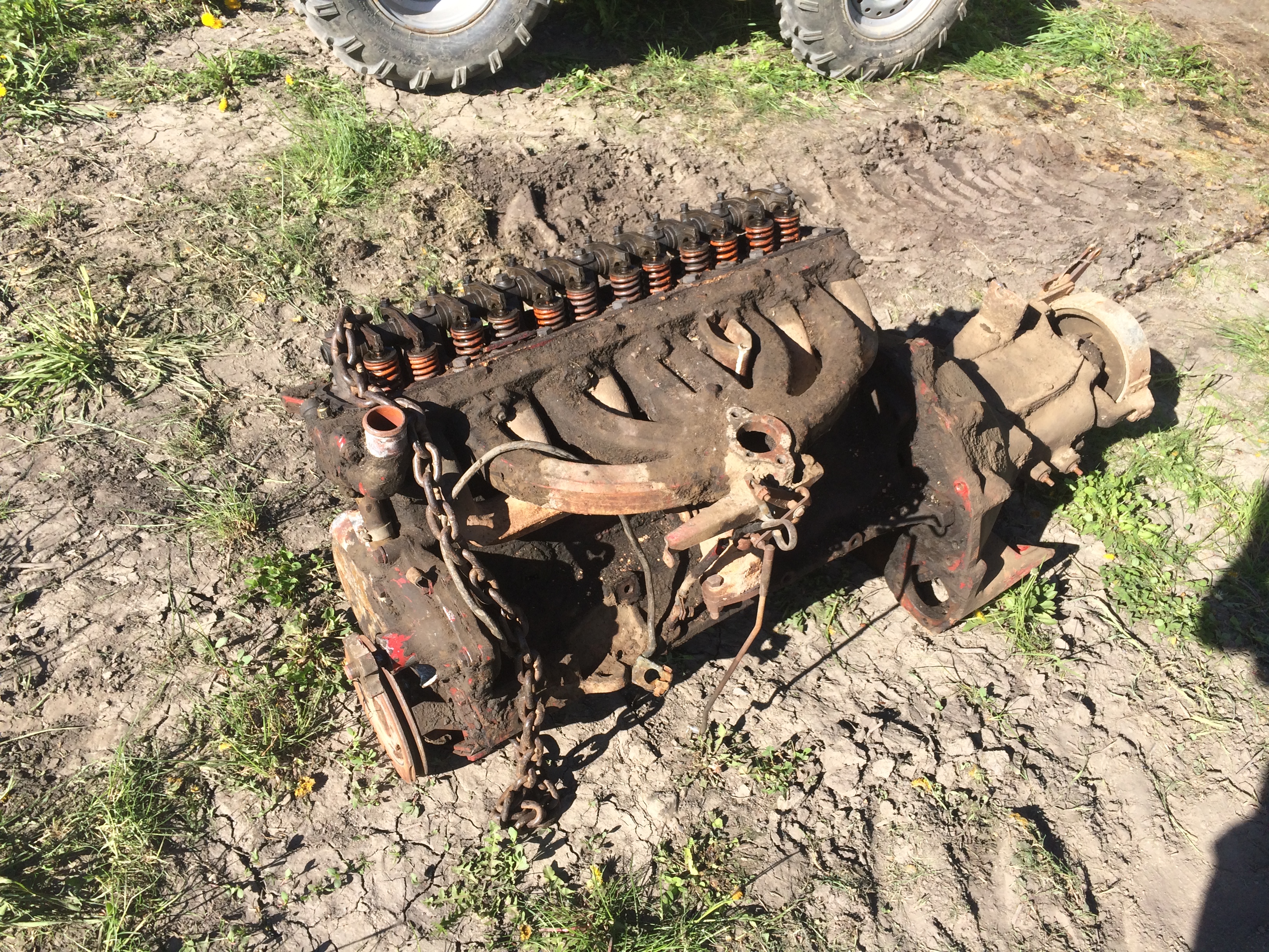

426 pack Posted March 29, 2018 Posted March 29, 2018 (edited) 36 minutes ago, Atmobil said: Looks really nice and straight that one. What engine/trans was in it from the start? Slant six and treespeed? I'm guessing it was a manual gearbox as I see you got the clutchcylinder on the firewall It was a 225 slant six wit a 3 on the tree. Here is a pic of the 440 that is going to go in it. Right now it is sitting my 78 New Yorker and I will be pulling it out this summer. Edited March 29, 2018 by 426 pack
