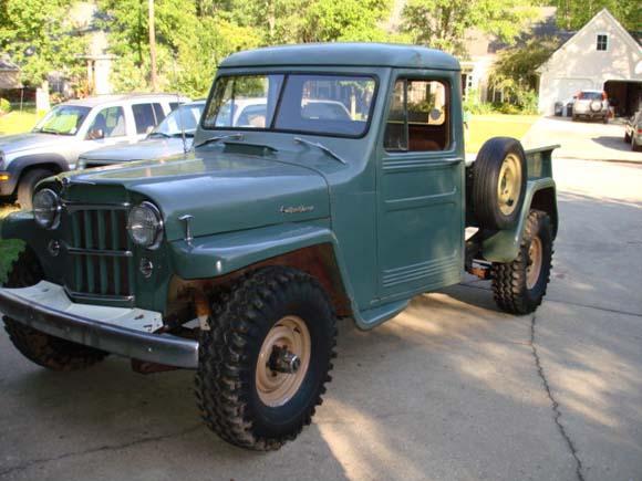

Thanks Cliff, I trust and appreciate your help. I want to do it to match this color, It's the color of my father-in-laws. I hope this goes smoothly. Curt hasn't said anything about the Detroit show. I'll have to ask him. Blessings my friend. take care and tell Larry hello for me. Geno.
