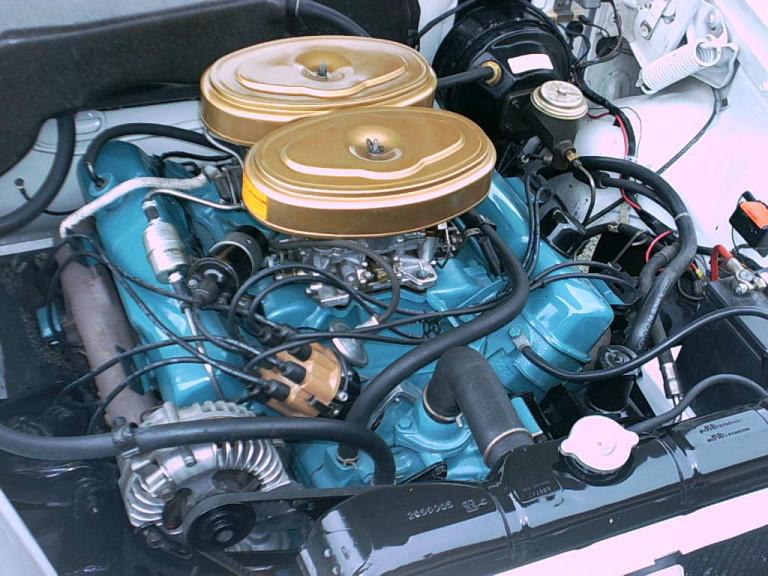

23 hours ago, Texas_3D_Customs said:
why is that?
My 2cents here
But a quick cursory view
Engines from the era used a 4 bolt valve cover thus have a slightly different shape than later 6 bolt models
In you file pic it has holleys - not avail in that period , should be carter AFBs
Air cleaners should have a defined flat back edge and nearly touch each other in the 1/1
Edited by gtx6970
  • Like 1
On 1/23/2025 at 11:00 AM, gtx6970 said:
My 2cents here
Okay fair enough on the flat edge on the filters AFB's are available as a separate item I have made my position on the carbs that come with my engines and it's just how I am going to do it. I am veering towards just dropping it anyway.
