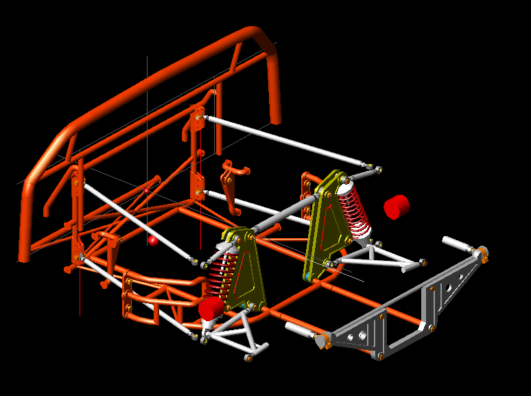

Hi misterNNL, I was amazed the 3D printing was reasonably priced. All of the orange colored tubes in the image just above, plus the main roll bar assembly in the pics way above cost about 50$ including shipping. And that's using their most expensive high resolution printer and best resin plastic. I figure I'll have about $200 total when it's all said and done.

Got my rear shock towers and the rear plate that carries the engine cowl and tow hooks done. Next is the tube frame between the two with mounts for the header collectors, exhaust pipes and engine/tranny oil coolers.
Got lots of parts coming from the 3D printers. Can't wait to see my fantasy turned into reality sitting in my hands!

Will theses Items be available from the 3-D printers when you finish?
