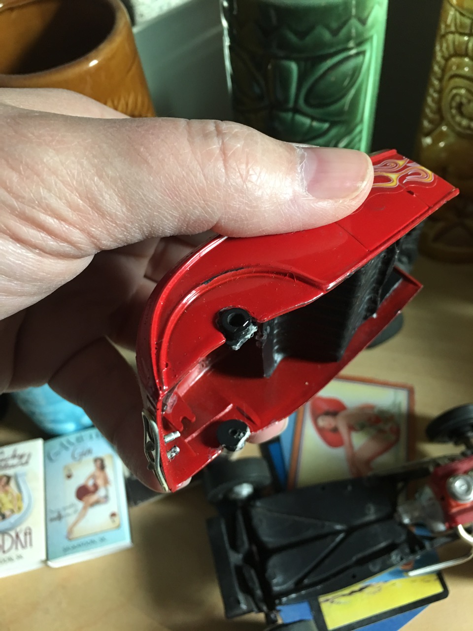

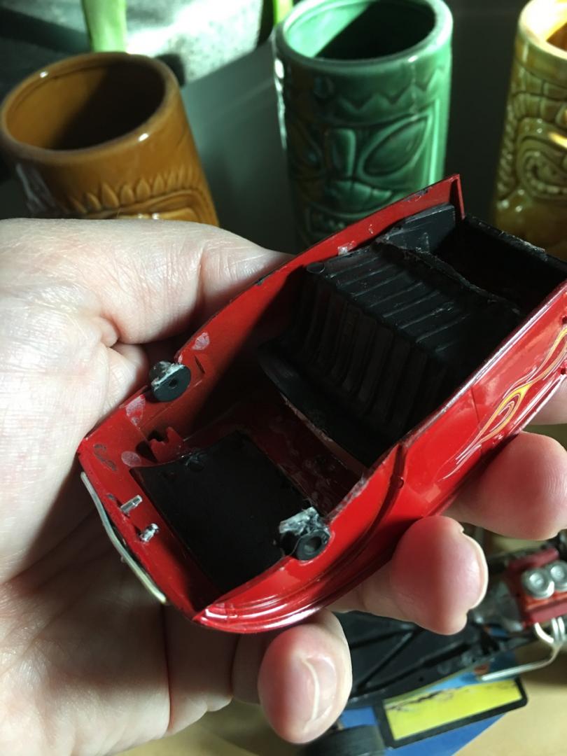

Great stuff, Glenn! I'll take a picture this evening of a pretty ingenious way someone raised the rear. Not sure if the parts he used came from an old kit or what.
Glenn,
This is what I found on an old AMT kit someone built; not sure where this exports came from but they work perfectly.
I've seen some 1:1 old dragsters use a model t rear spring on the front, they have a higher center arch to raise the car. Another trick to raise or lower the front or rear is blocks between spring mount and frame.  Have also seen on cars such as a '40 ford (The spring is behind or in front of the axles) much longer spring shackles used to lower the car.
