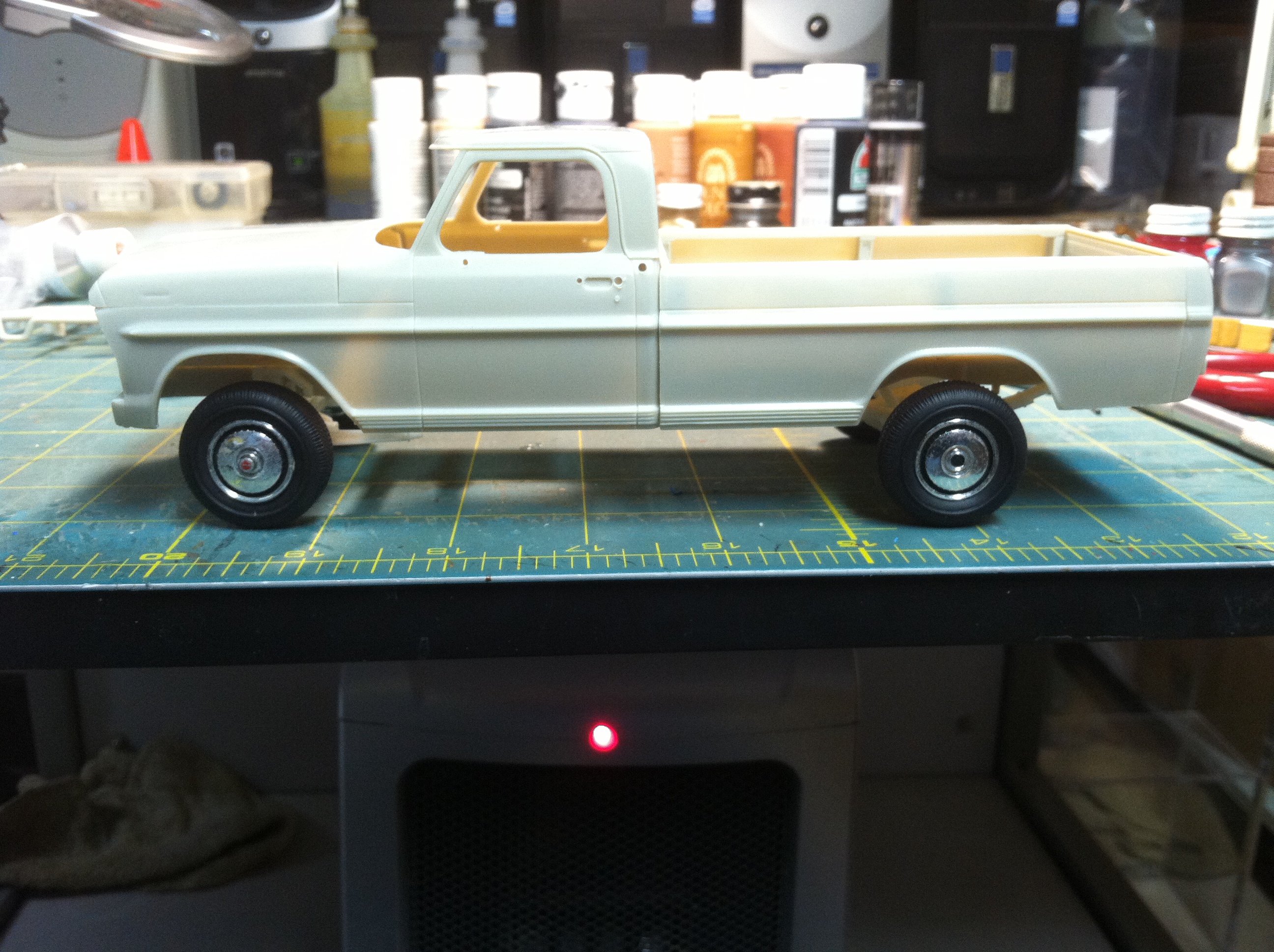

I started this conversion myself a while back and I found that using the 71 frame was pretty easy (maybe easier than cutting the 78 as the wheel base wont be correct anyway).  I used the 78 springs and axles and engine cradle, the crossmember for the transfer case will be located for the 71 interior tub mounting point as the pieces are almost identical between the kits. The 78 uses it for a cab mount and the 71 uses it for the tub as mentioned. They should be pretty close to the same location. I am using a custom made heavy duty 4 speed for mine so I haven't figured the lengths just yet but here is a mockup of mine so far. I know Moebius is coming out with a 70 4x4 but I am impatient and can't wait!
