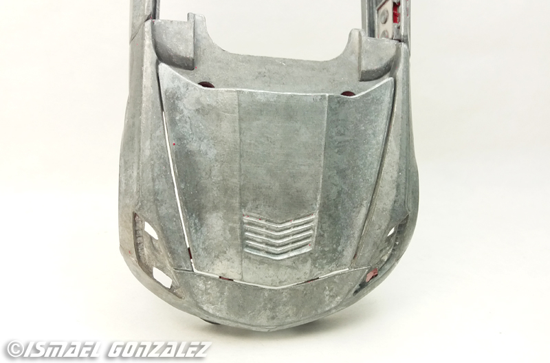

I started with this: After getting past the nausea inducing door gaps, I noticed the wheels have no brake details. Interior detail is very simple but not much worst that the snap kit I'm working on. Actually, the seats look good.

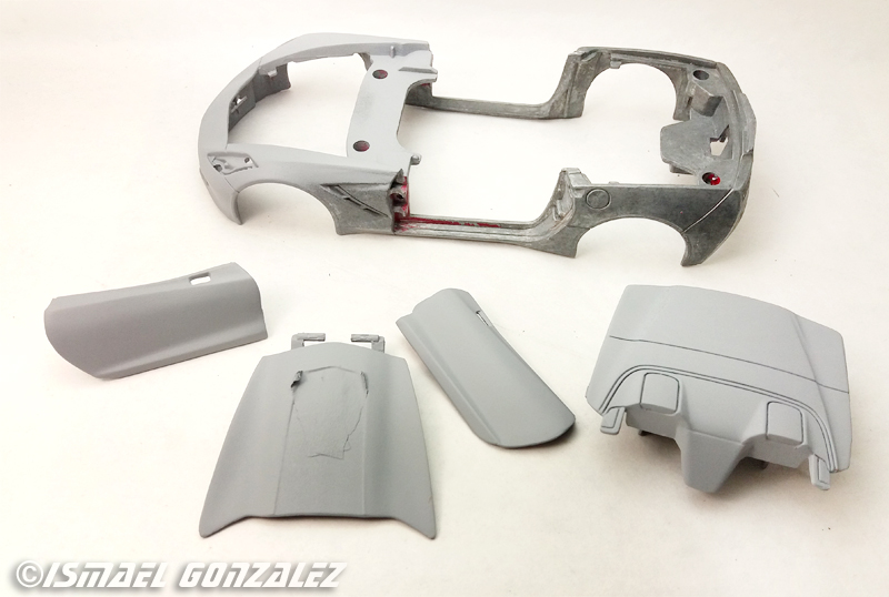

Took it apart and was ready to be stripped....
When I noticed the rear deck lid was PLASTIC!  If it had come in contact with the harsh paint stripper it would have been destroyed.
Brake fluid took care of the deck lid.  The plastic is not styrene. It is a bit softer but workable.

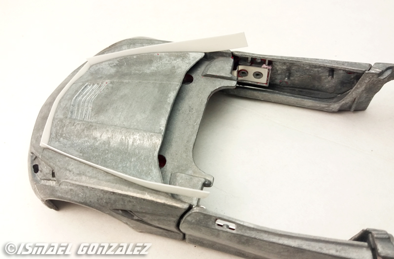

If the gaps were big to start with, after stripping the thick paint they are unacceptably HUGE!

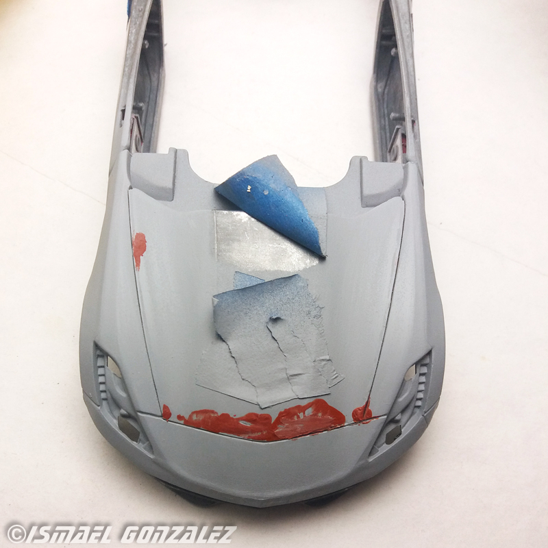

So I started adding material (styrene)  to all sides to keep proper alignment.

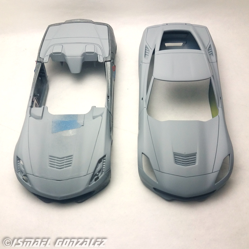

Progressing alongside the Revell snap 1/25 Stingray. The scale difference between 1/24 and 1/25 is noticeable.

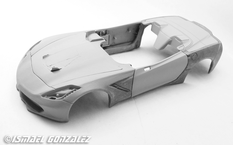

Same process for the doors.  I can't stand those huge gaps.
Slowly getting there...

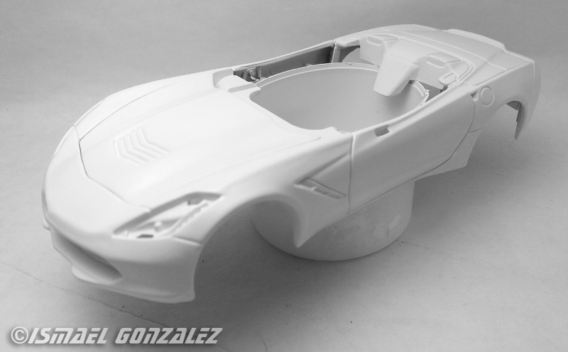

With the exception of the noticeable difference in weight, from this point forward it is just another model project.  When I was happy with the grey primer, I applied white primer and worked it.  Once perfect, correct Arctic white lacquer was applied followed by lacquer clear.

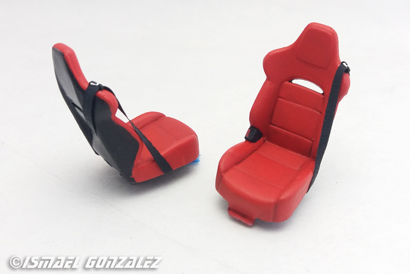

Focusing on the interior, I am replicating a 3LT adrenaline red color scheme.  Added belts and guides.
