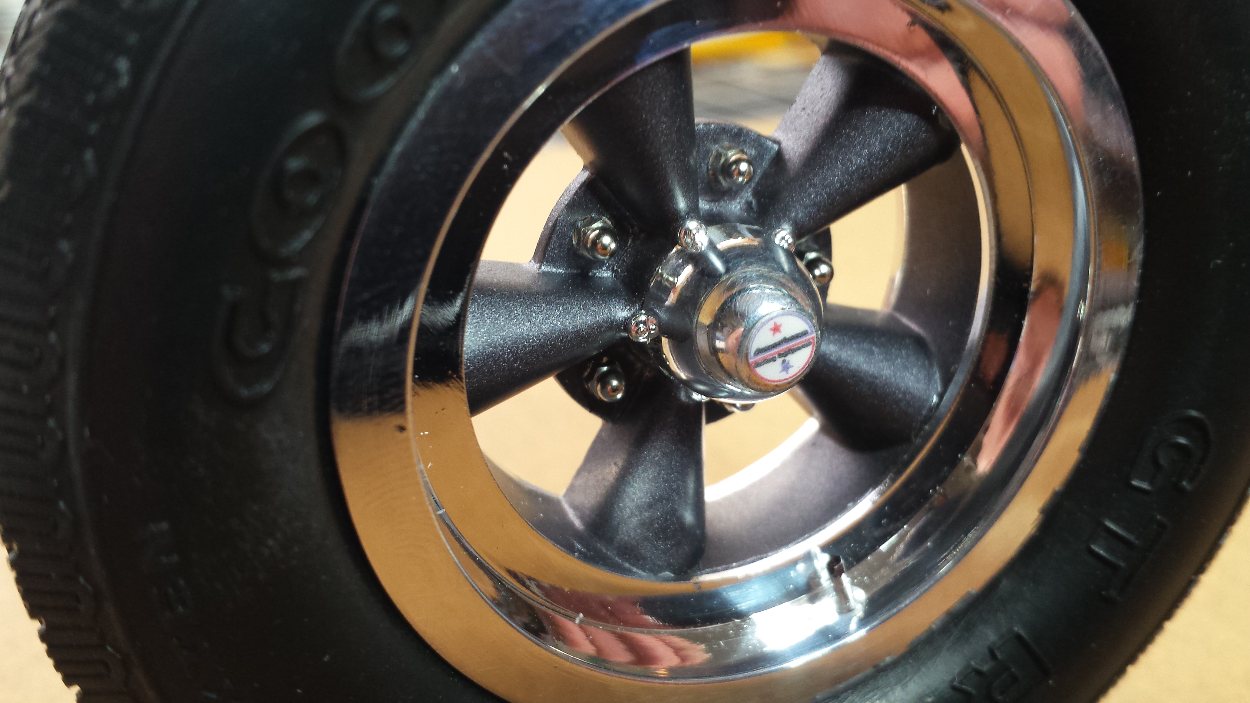

Steve Osbourne Posted February 28, 2018 Author Posted February 28, 2018 (edited) The wheels are American Racing Torq Thrust. They are very easy to make using the wheels from the Big Tub or Big T. I added valve stems and custome printed wheel cap logos. Edited February 28, 2018 by Steve Osbourne added "Racing"

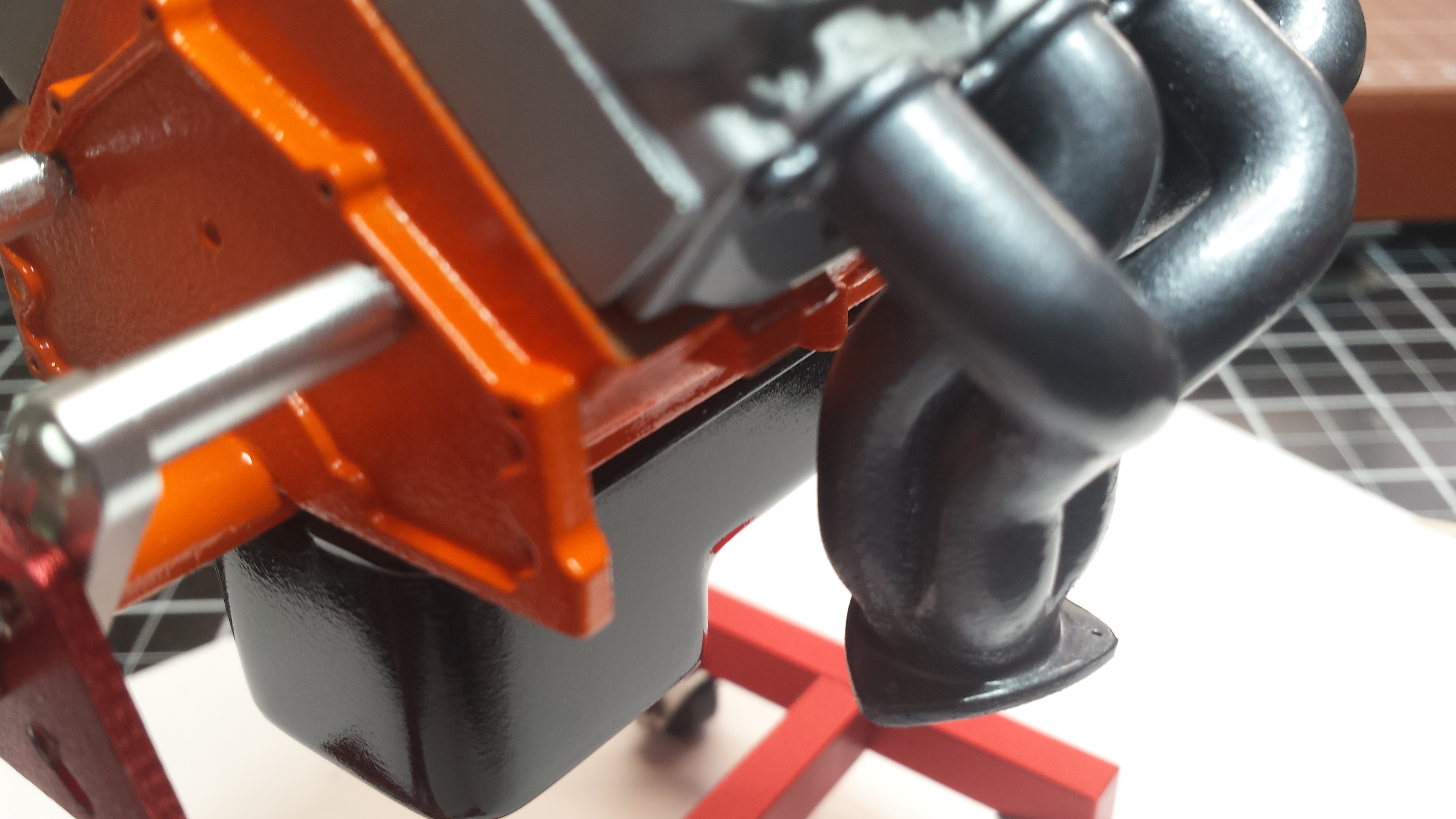

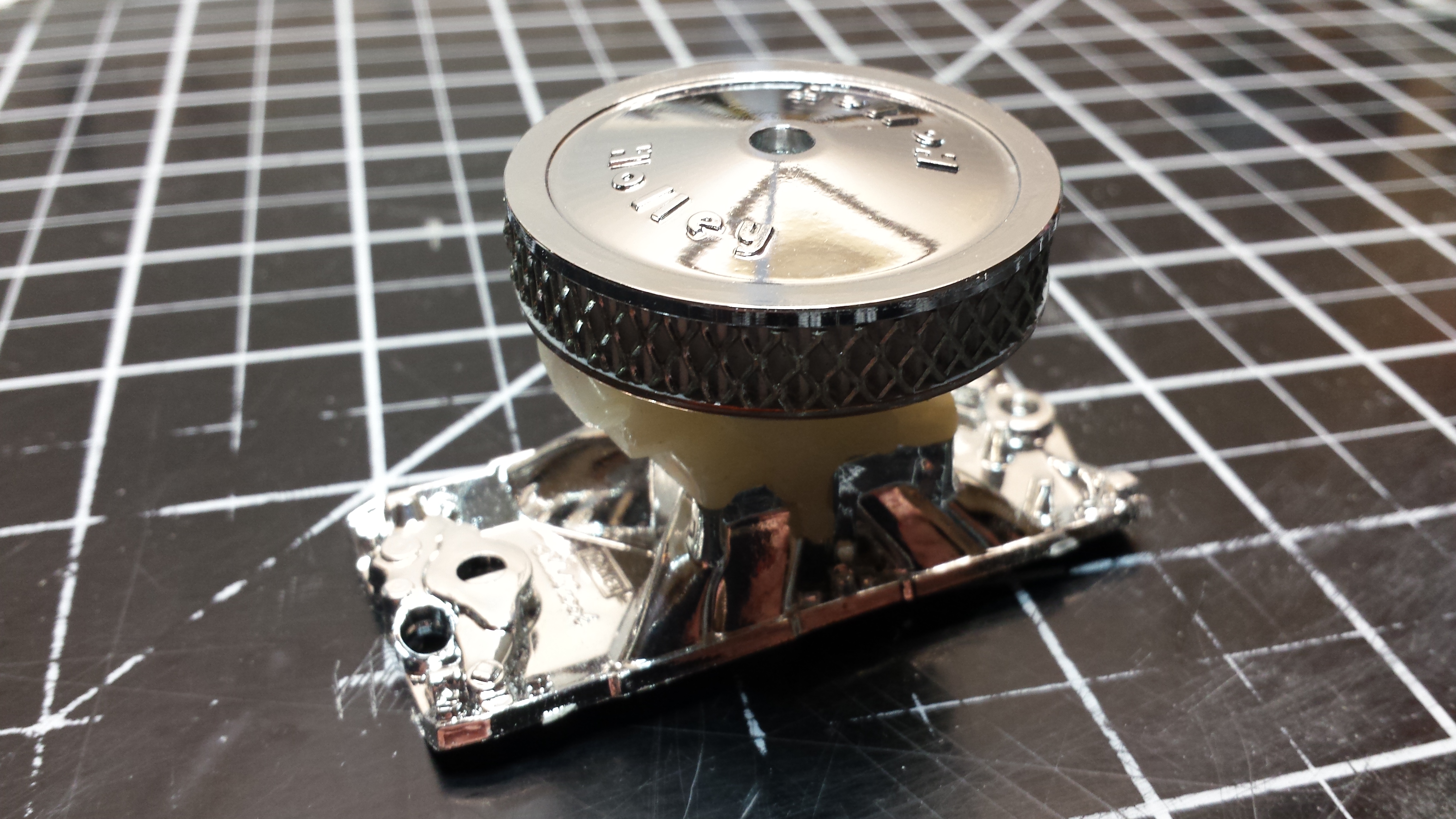

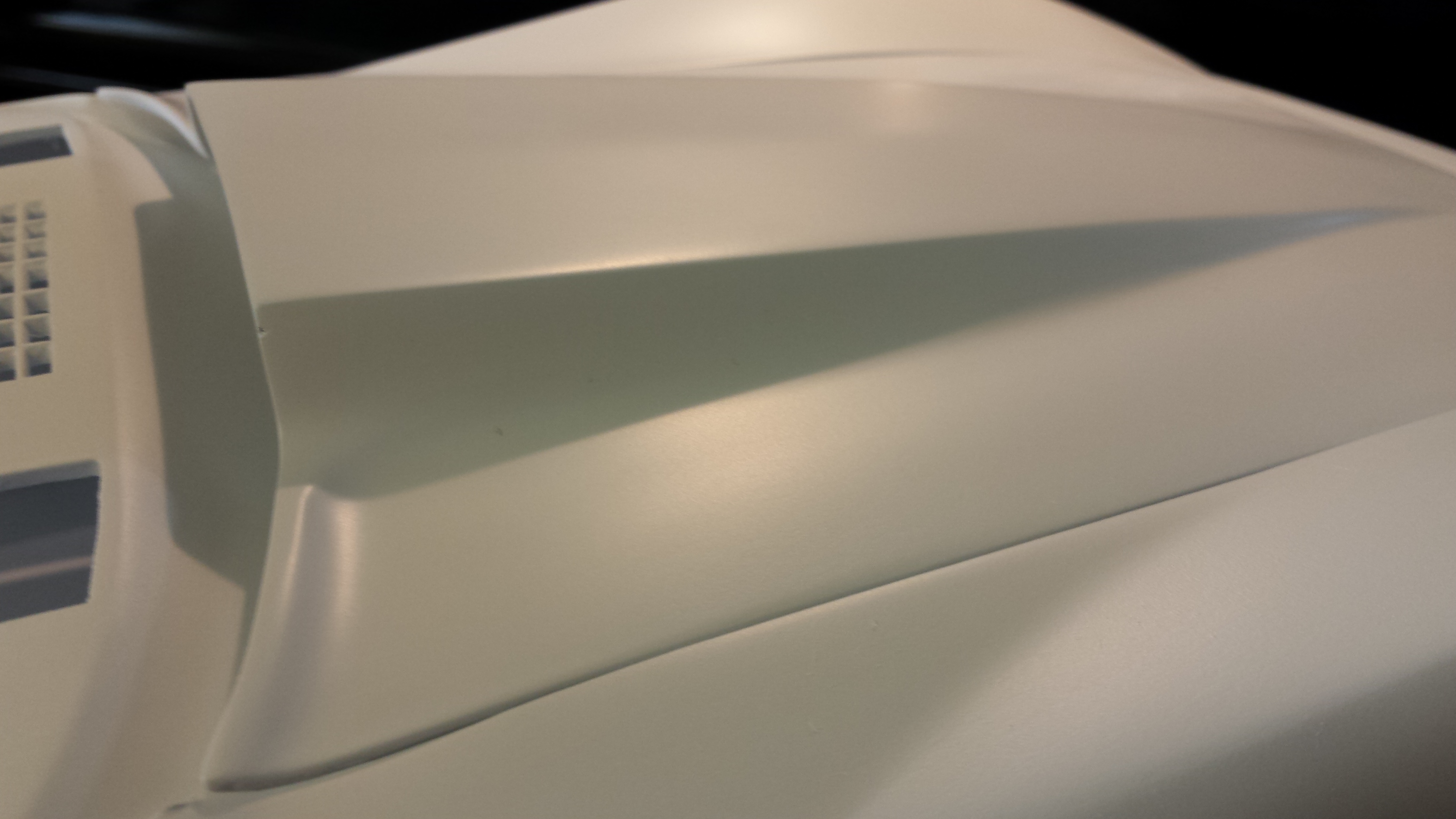

Steve Osbourne Posted February 28, 2018 Author Posted February 28, 2018 And this is why I had to modify the hood - to fit the high-rise manifold and Holley carb from one of the Monogram T Buckets (which use SBC's). The Holley air cleaner is from RC4WD.

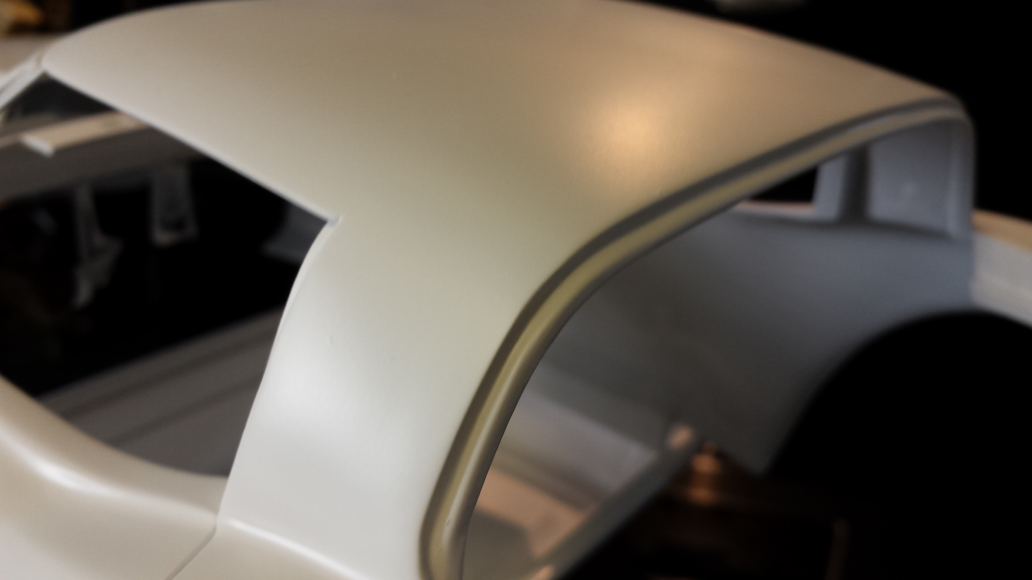

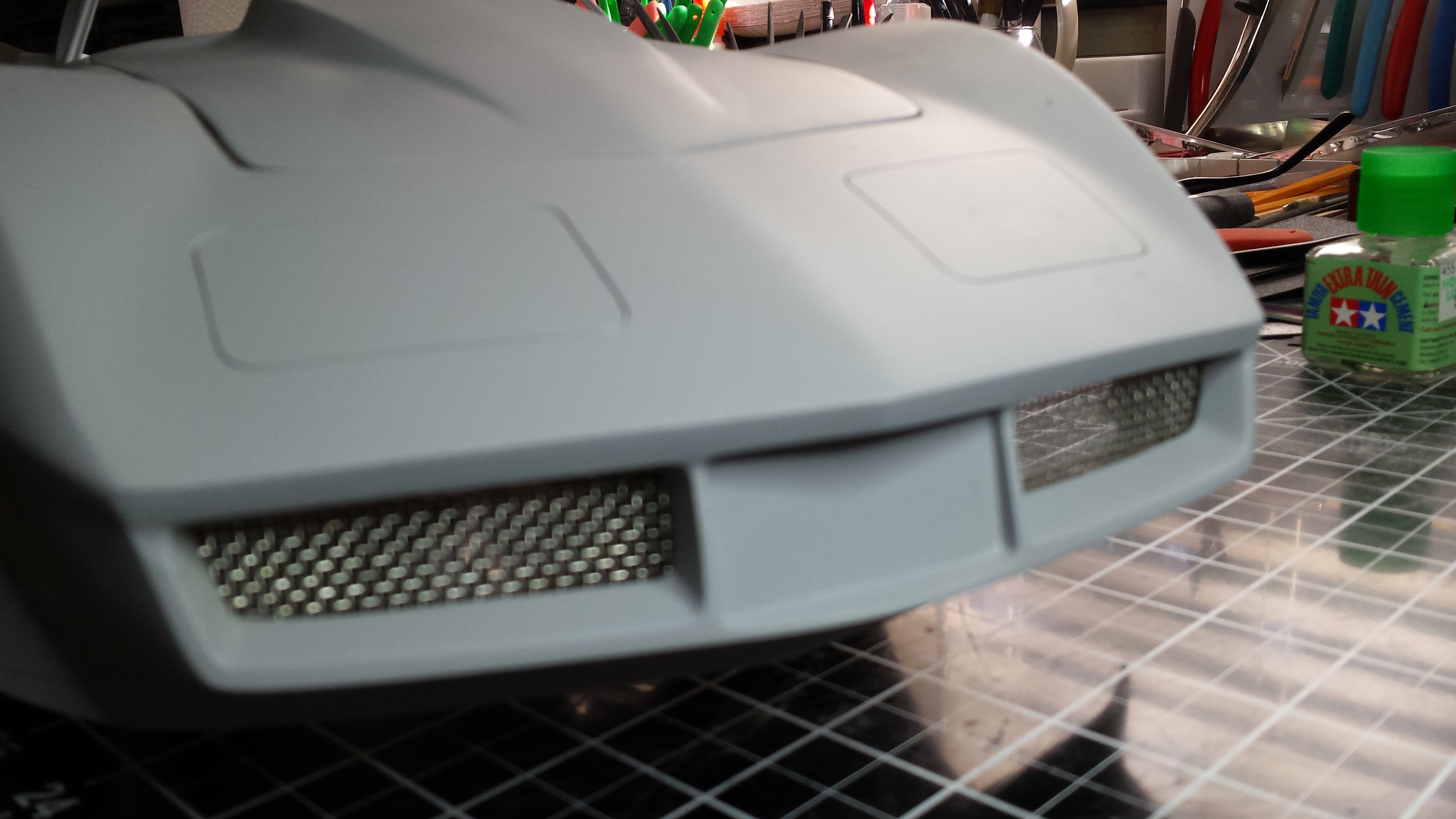

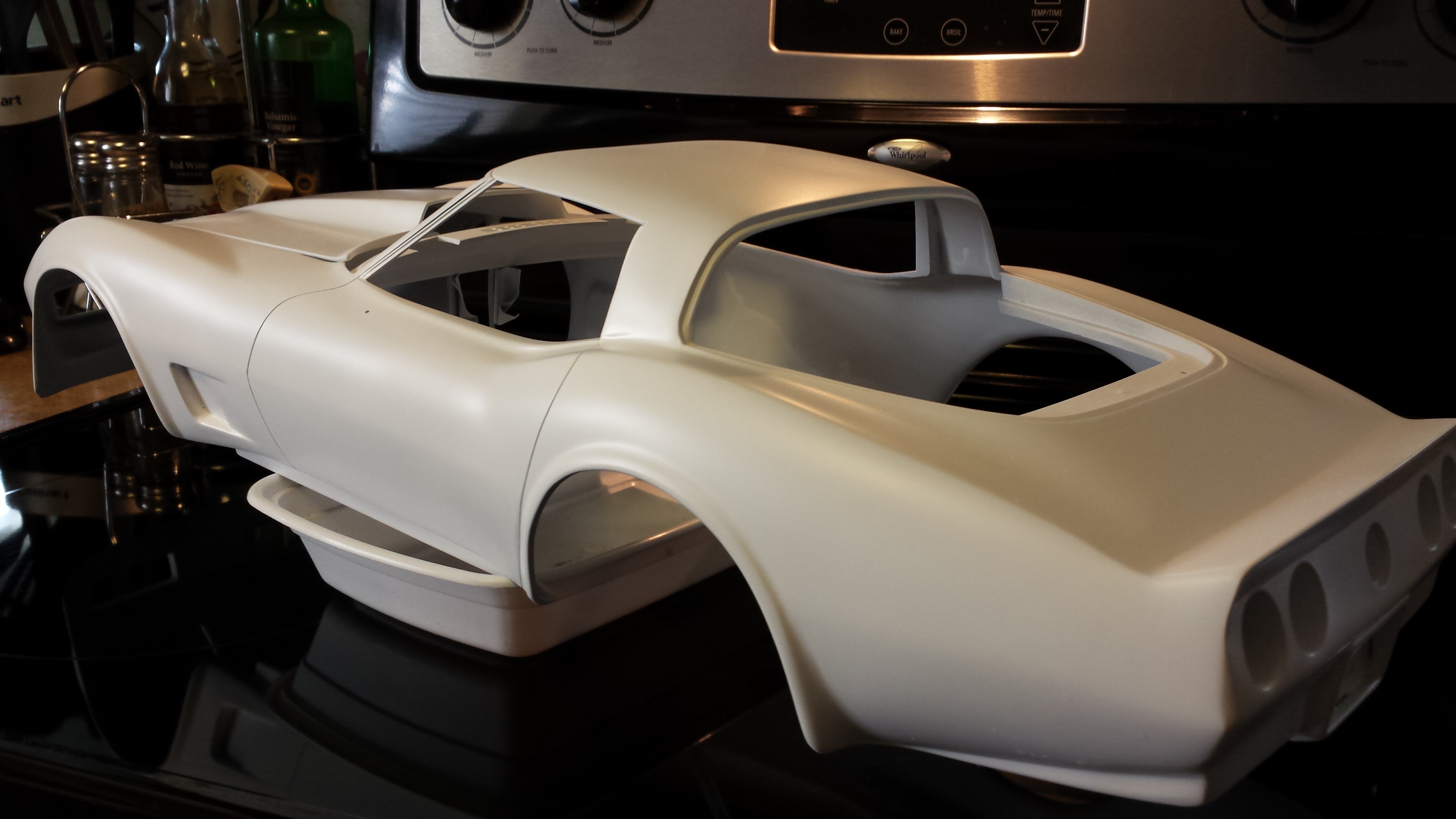

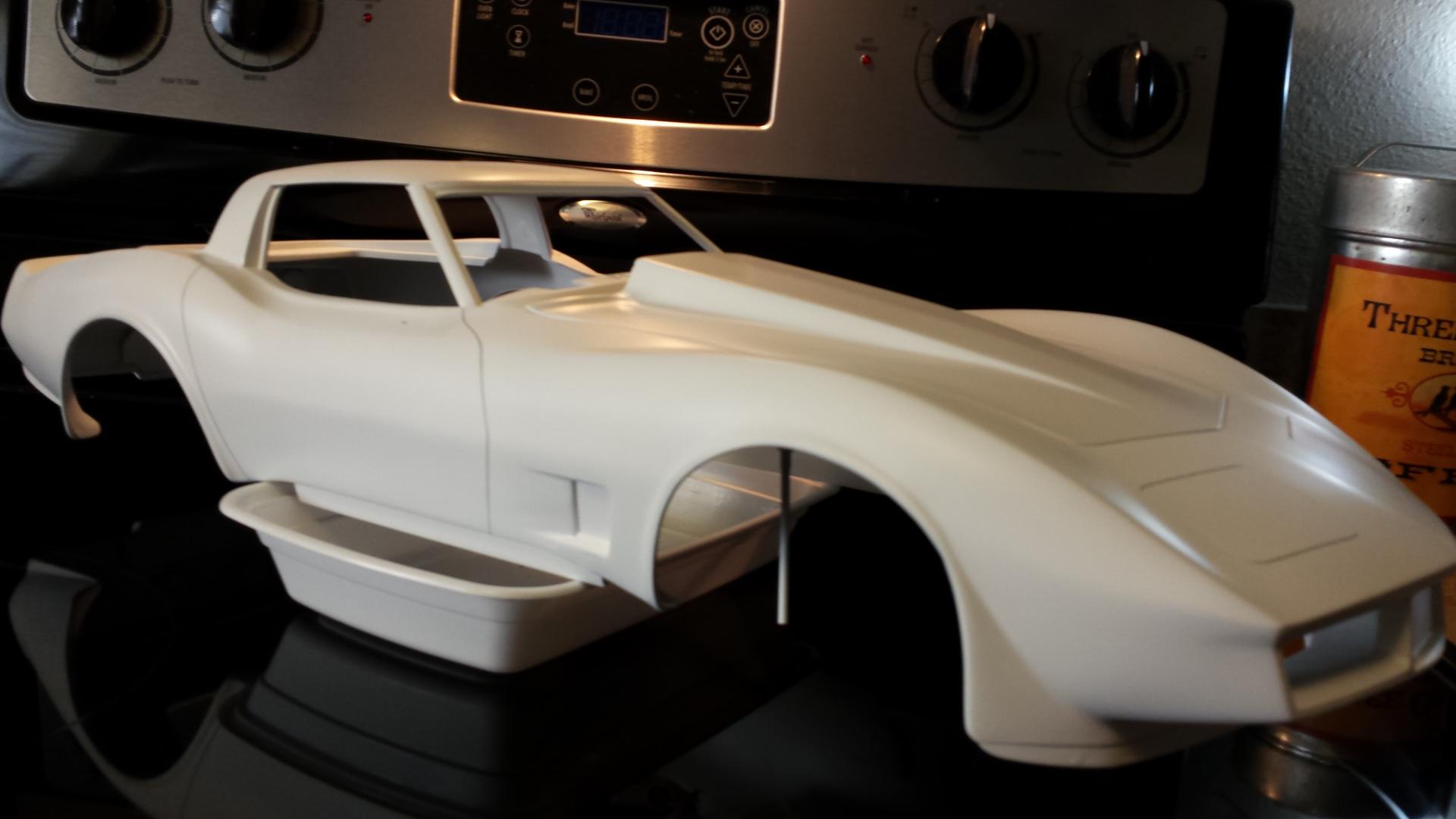

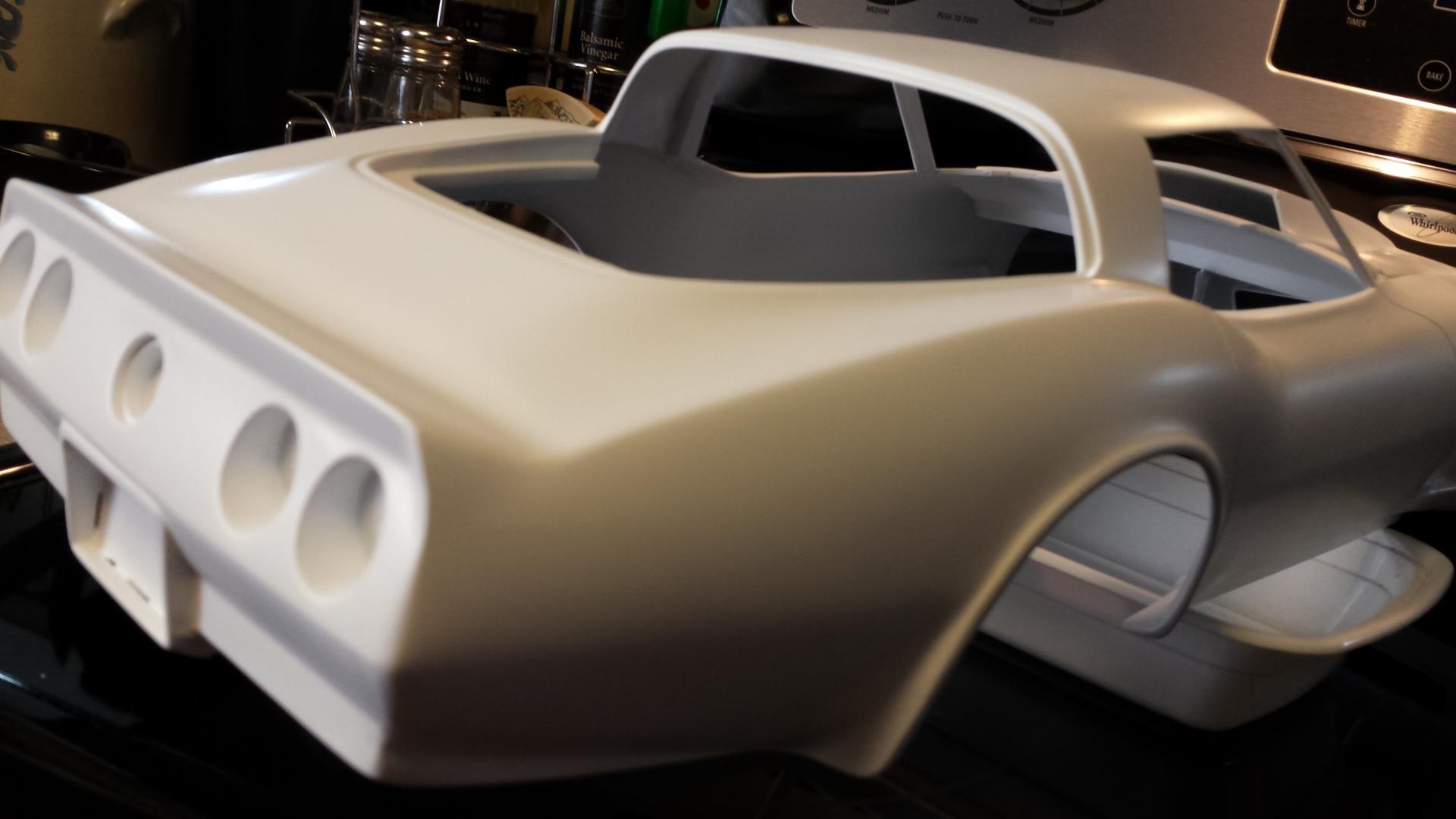

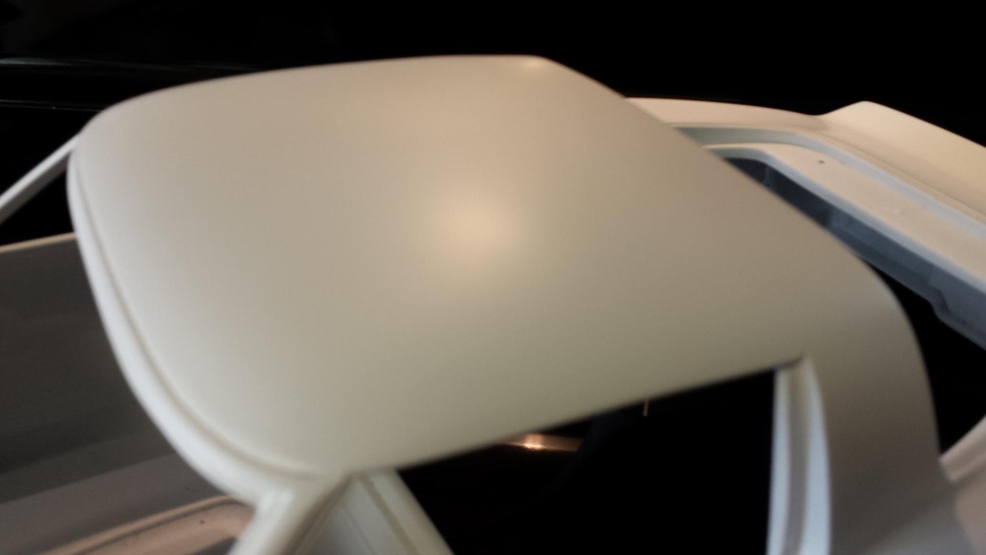

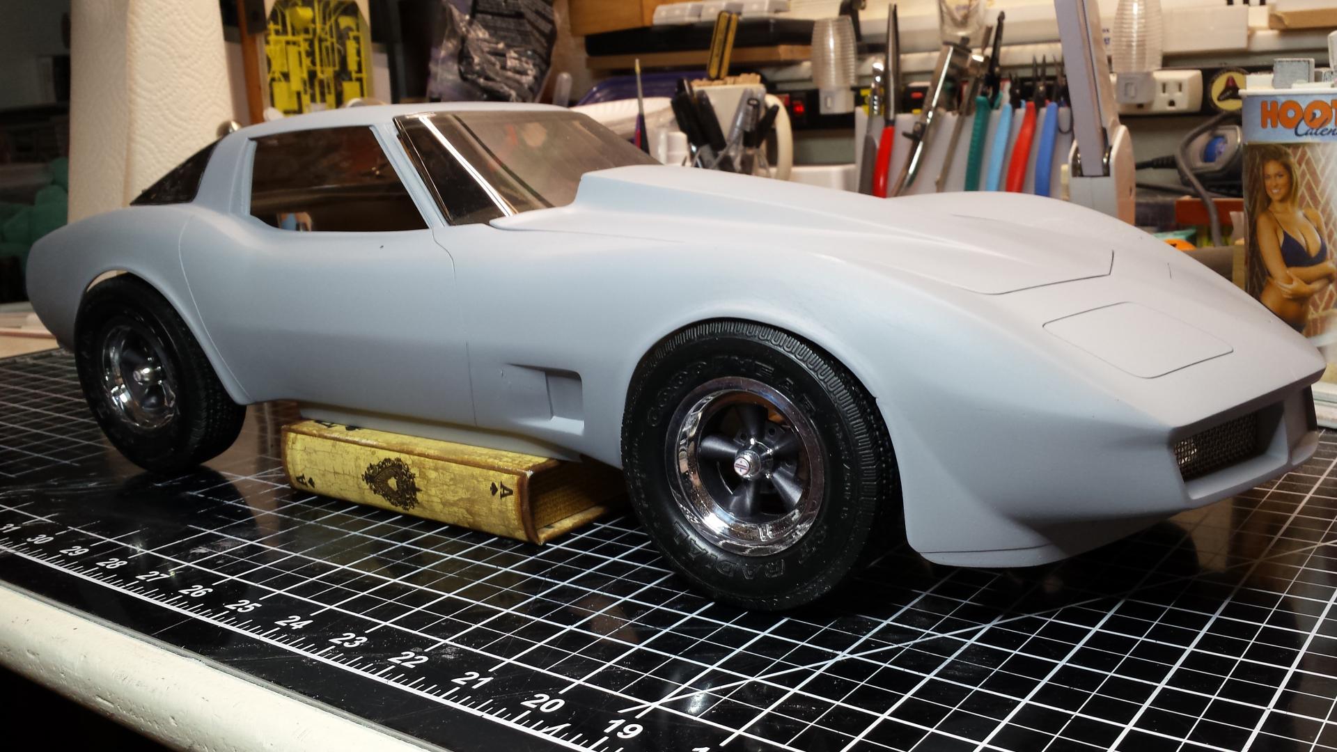

Steve Osbourne Posted February 28, 2018 Author Posted February 28, 2018 And here are the latest photos having just shot the primer this morning. Note the t-tops are filled and it is now a hardtop. Side signal lights also filled. Gas cap relocated to rear panel. I also added screen material for the front air inlets (older photo, grey primer)

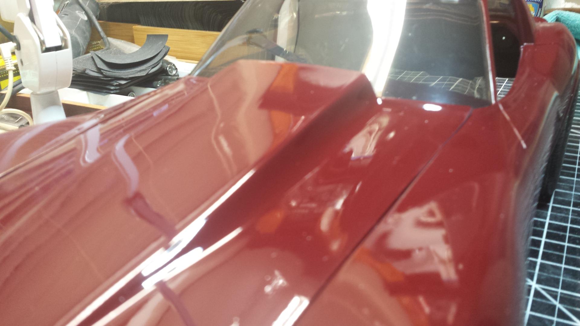

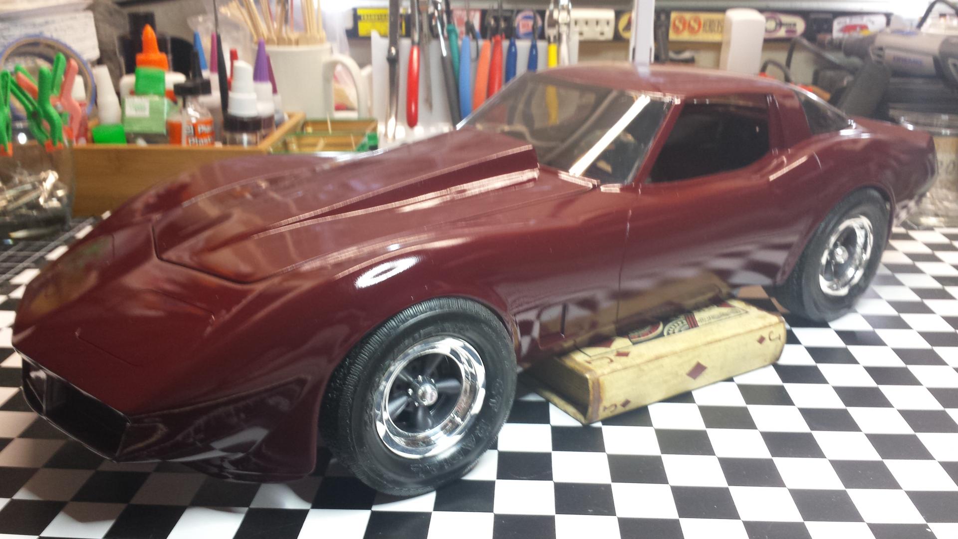

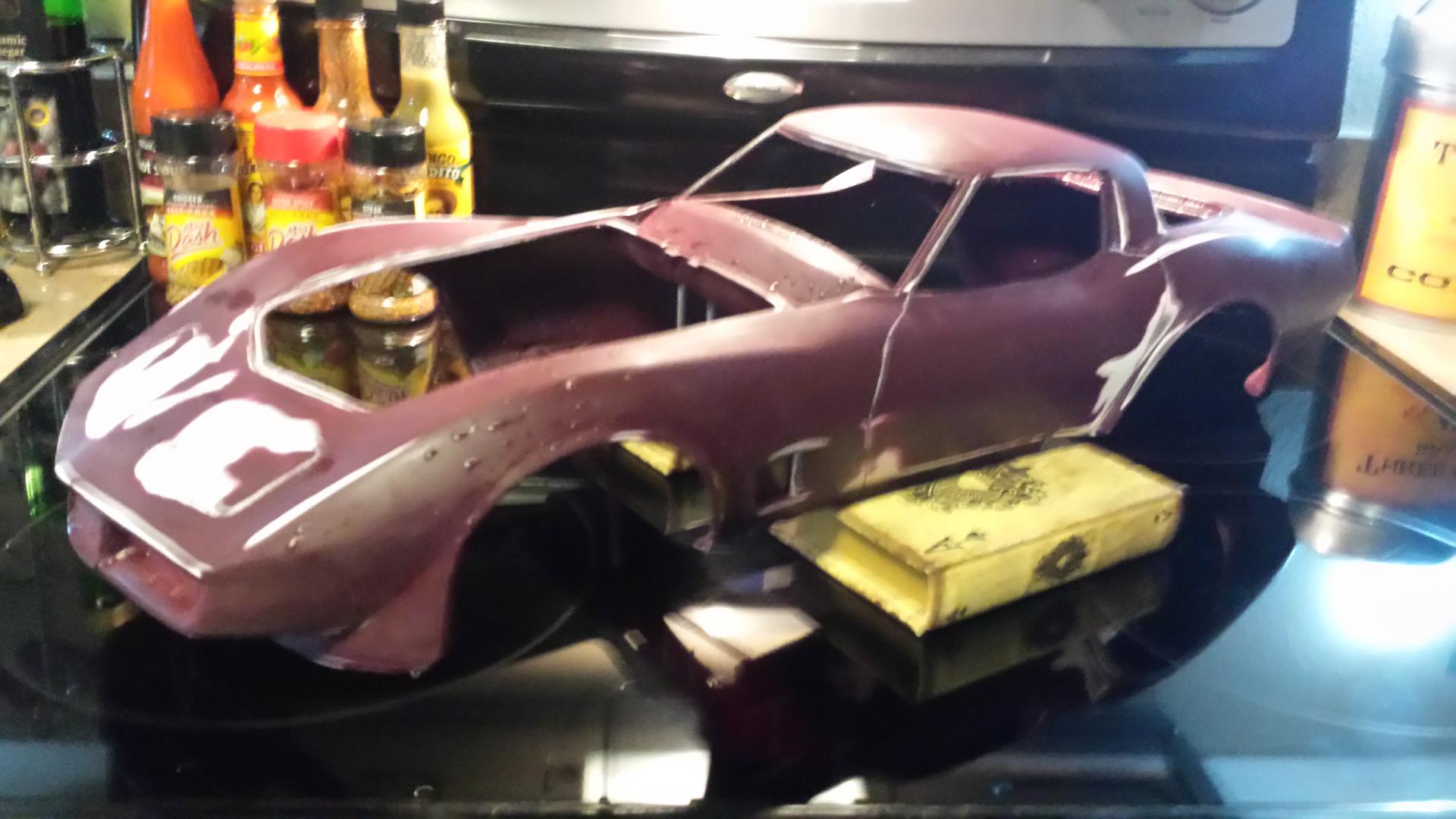

Steve Osbourne Posted March 12, 2018 Author Posted March 12, 2018 It has been too cold to paint but this weekend it warmed up so I was able to shoot the first few light coats of Tamiya TS-11 Maroon. I also heat the paint up by placing the can in hot water before using and shaking the can after every pass. Makes a huge difference. Afterwards, I couldn't resist posing with window glass and two Torq Thrusts. I'll let this sit for a week and then wet sand with 600 grit and repeat the light coats of maroon.
Steve Osbourne Posted March 15, 2018 Author Posted March 15, 2018 Thanks. I didn't have to wait as long as I thought I would for the next paint session. I sanded the entire body with 600 grit wet dry. I didn't re-score the panel lines. I'll do that before the next paint session. The paint is starting to look deeper.

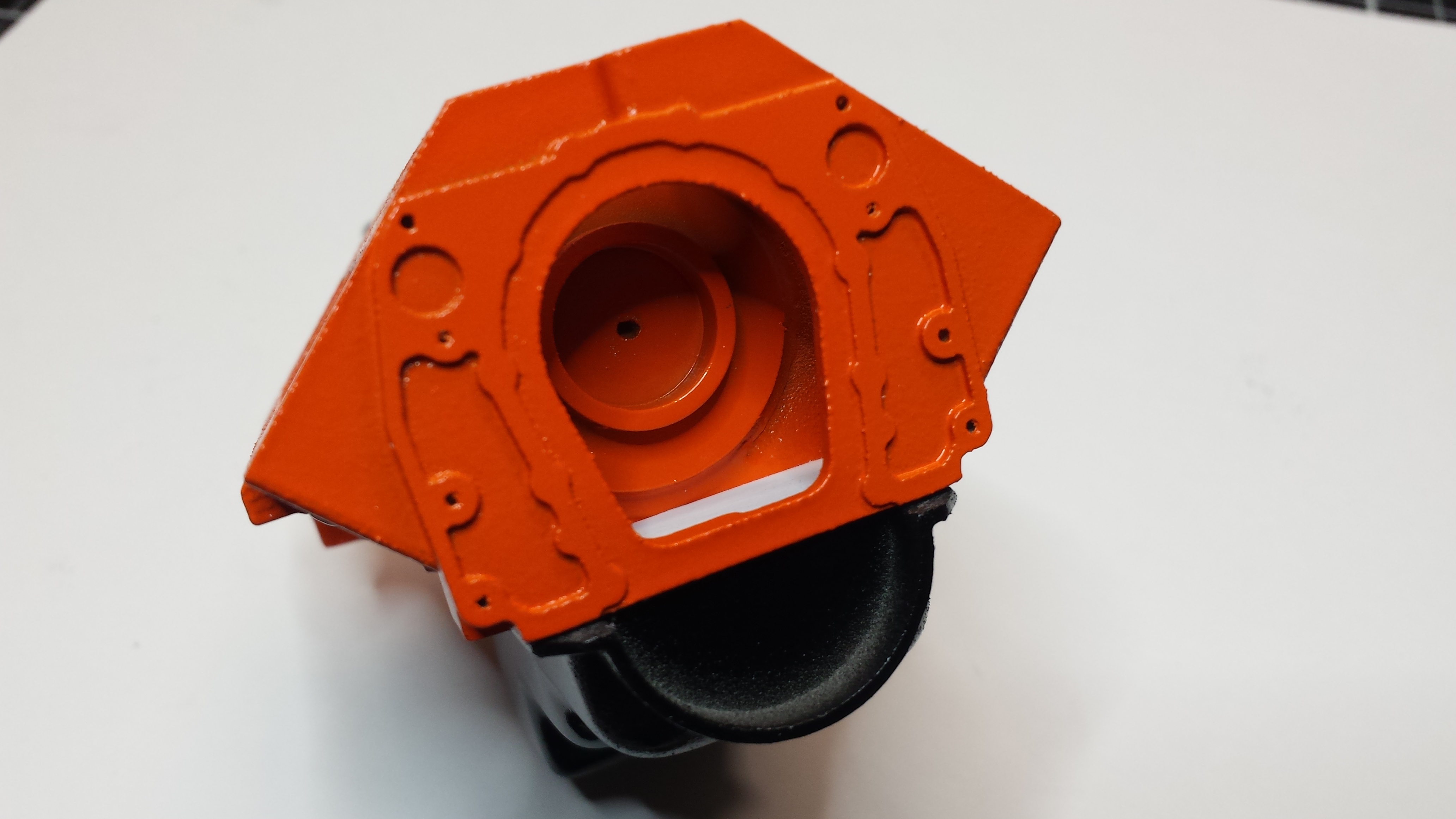

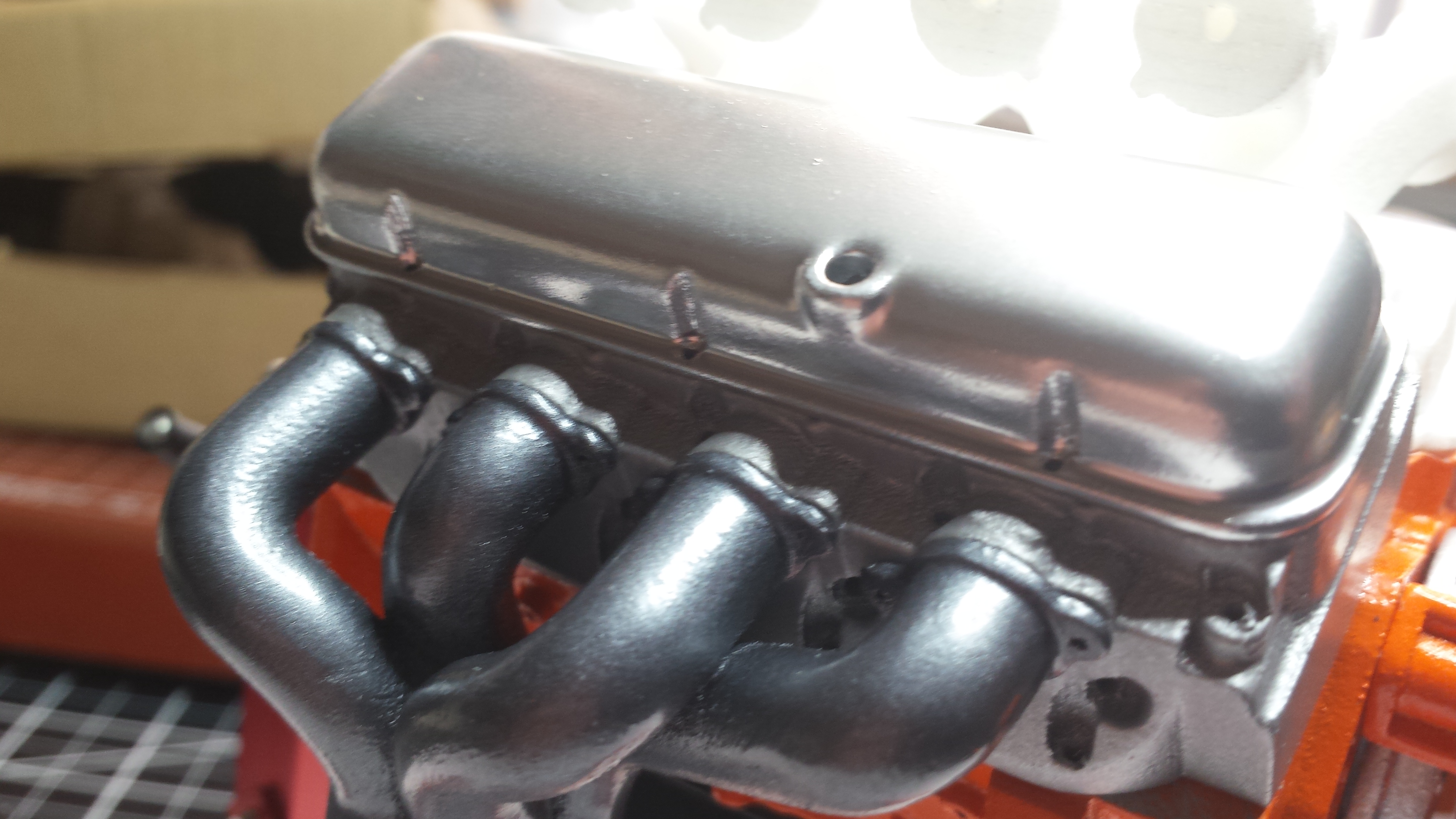

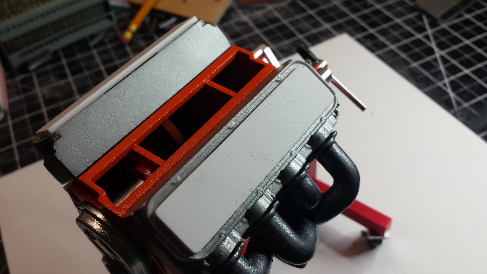

Steve Osbourne Posted March 22, 2018 Author Posted March 22, 2018 Having received the Chevy big block from Shapeways and after doing a few test fits I'm thinking seriously about using it here. I have both the cross ram fuel injection and the single quad Holley for induction choices. Both appear to fit under the modified hood. The TDR stuff is first quality all the way.

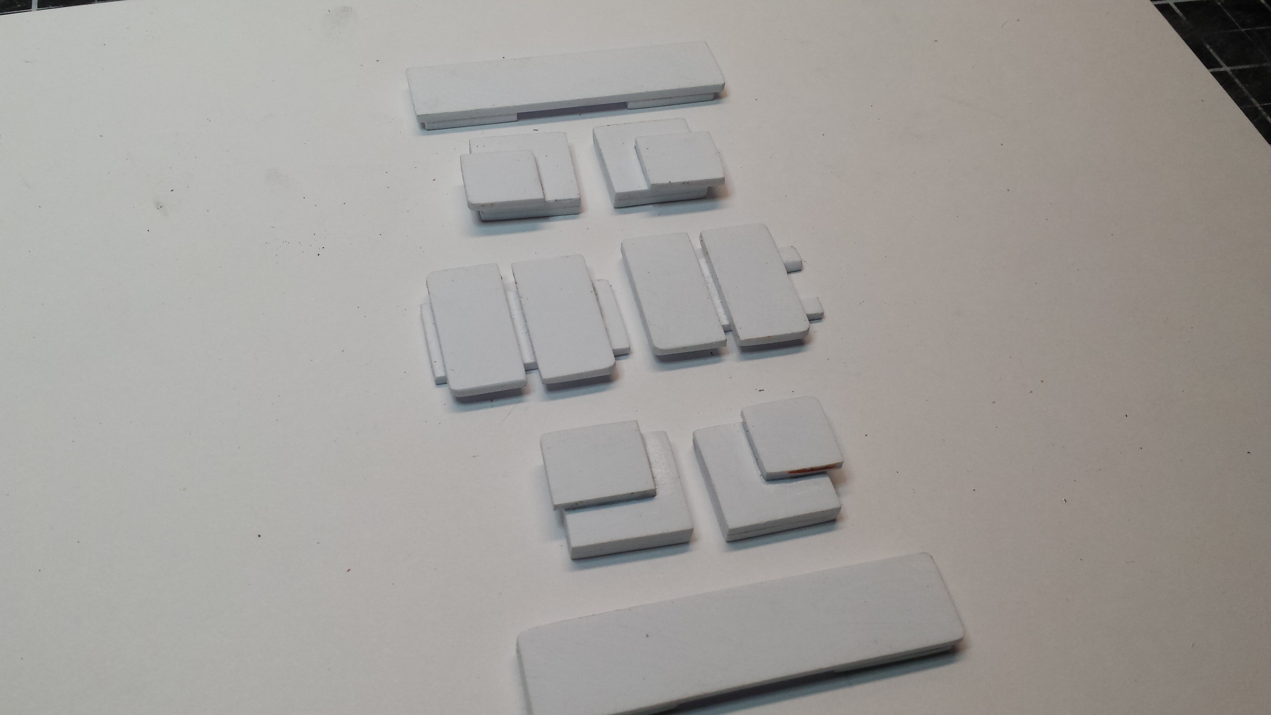

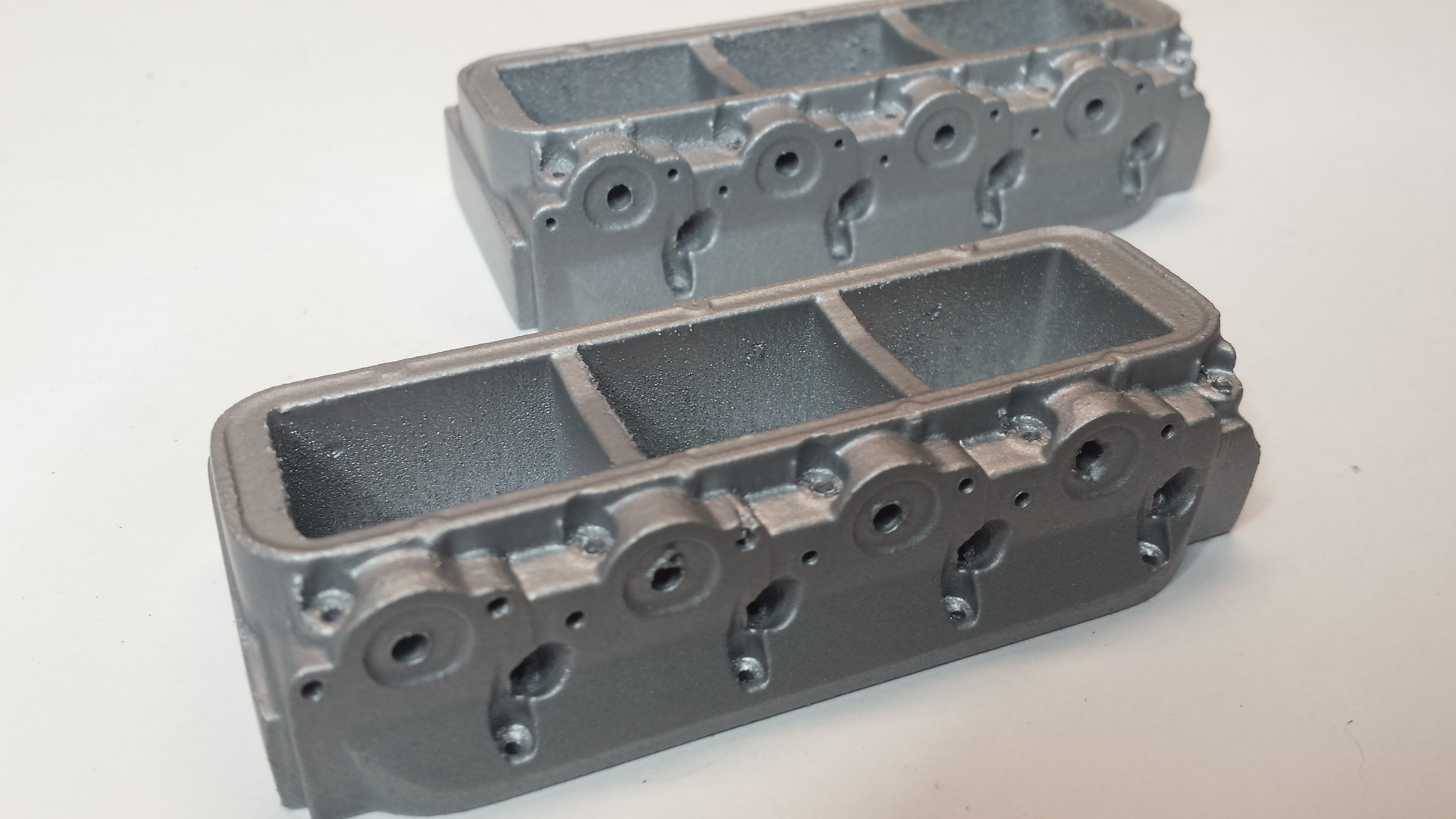

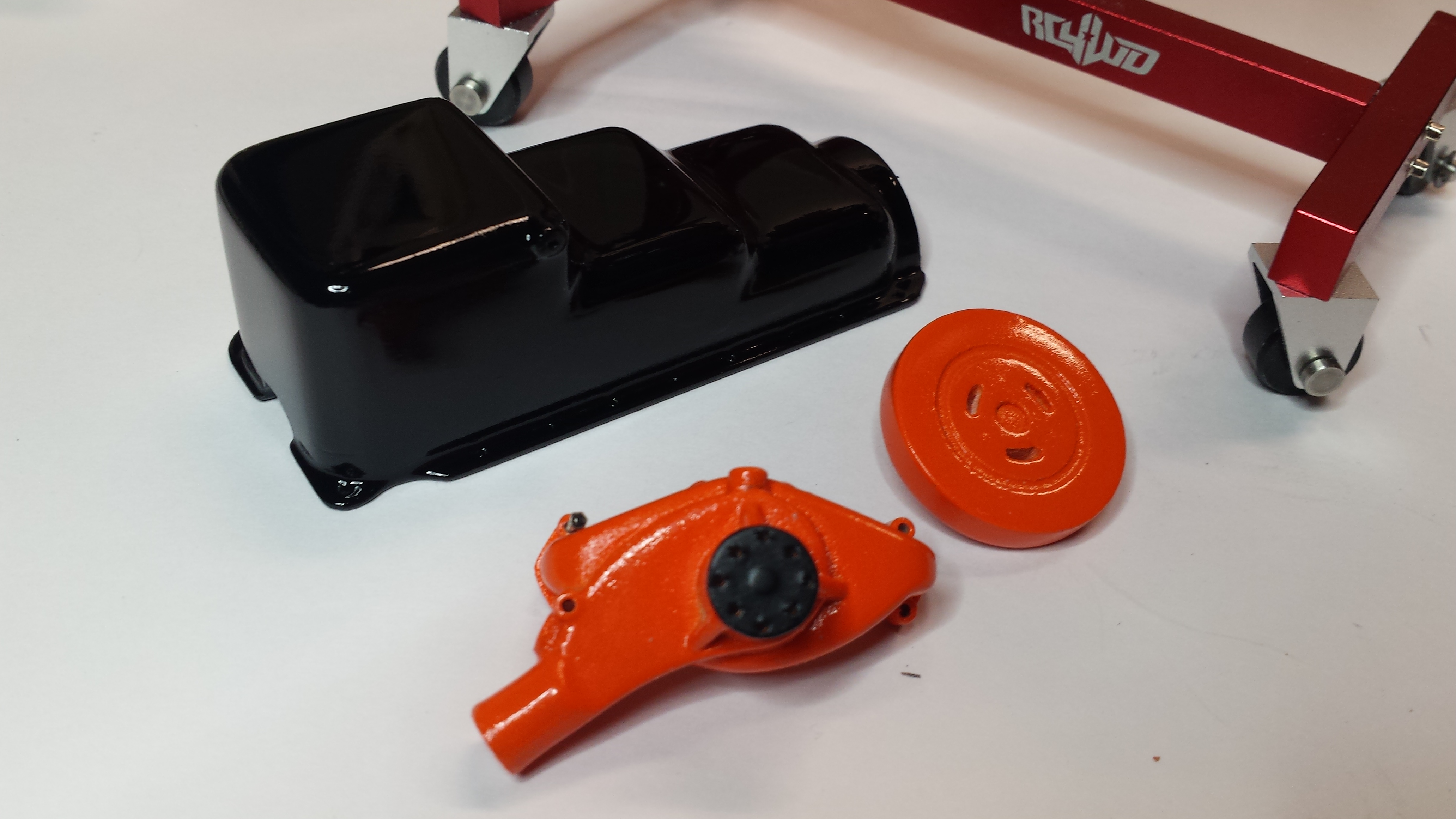

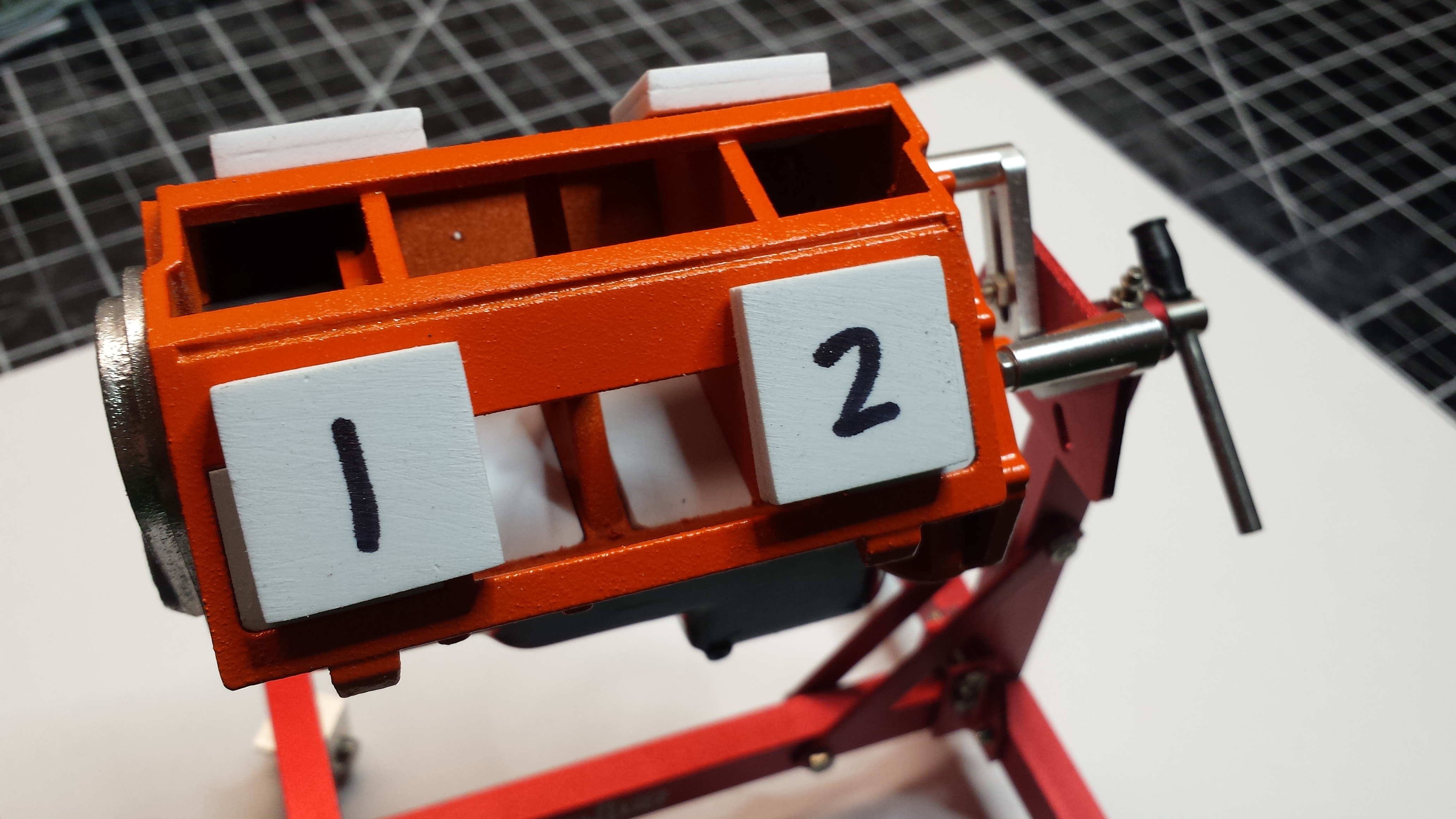

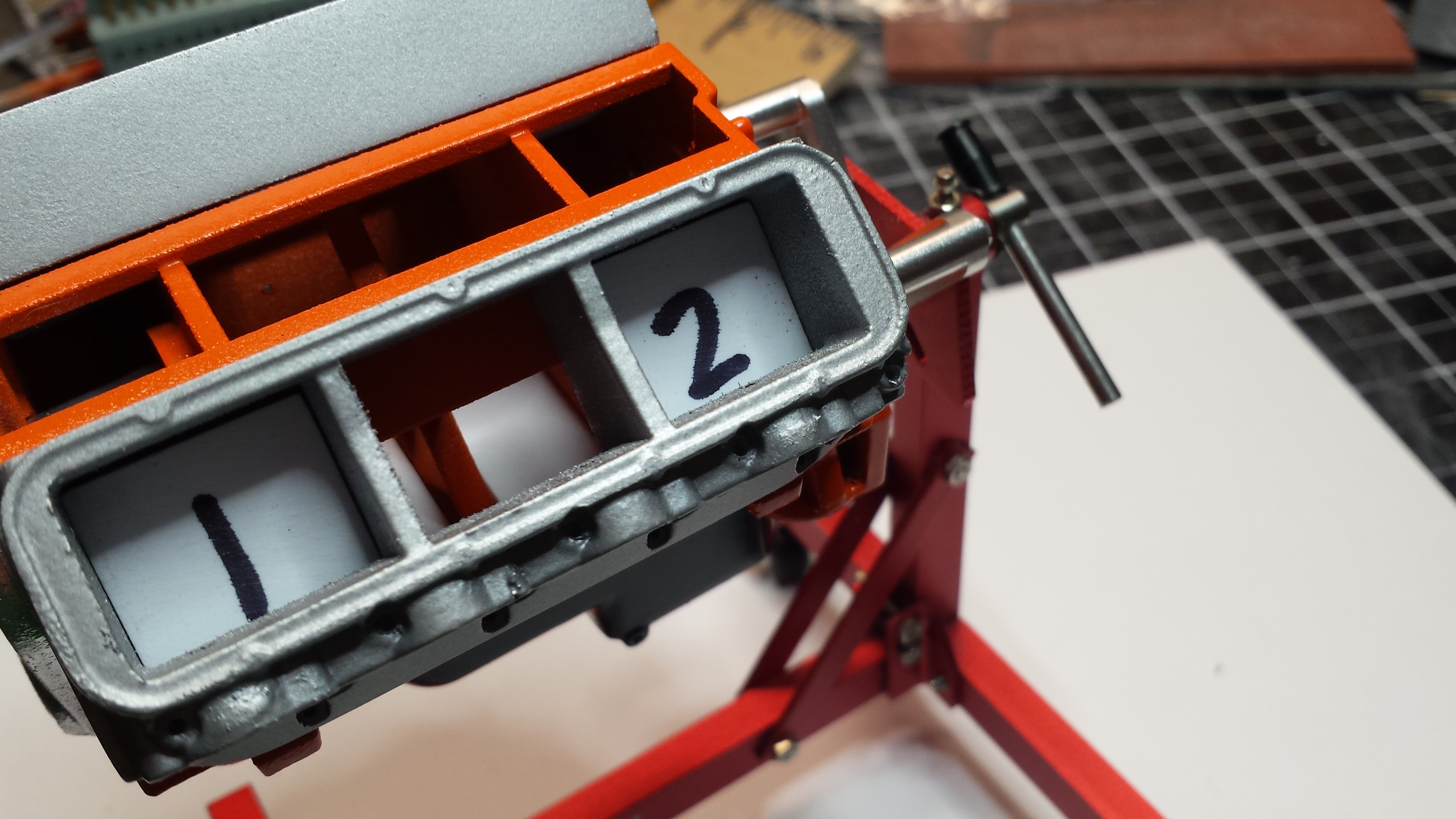

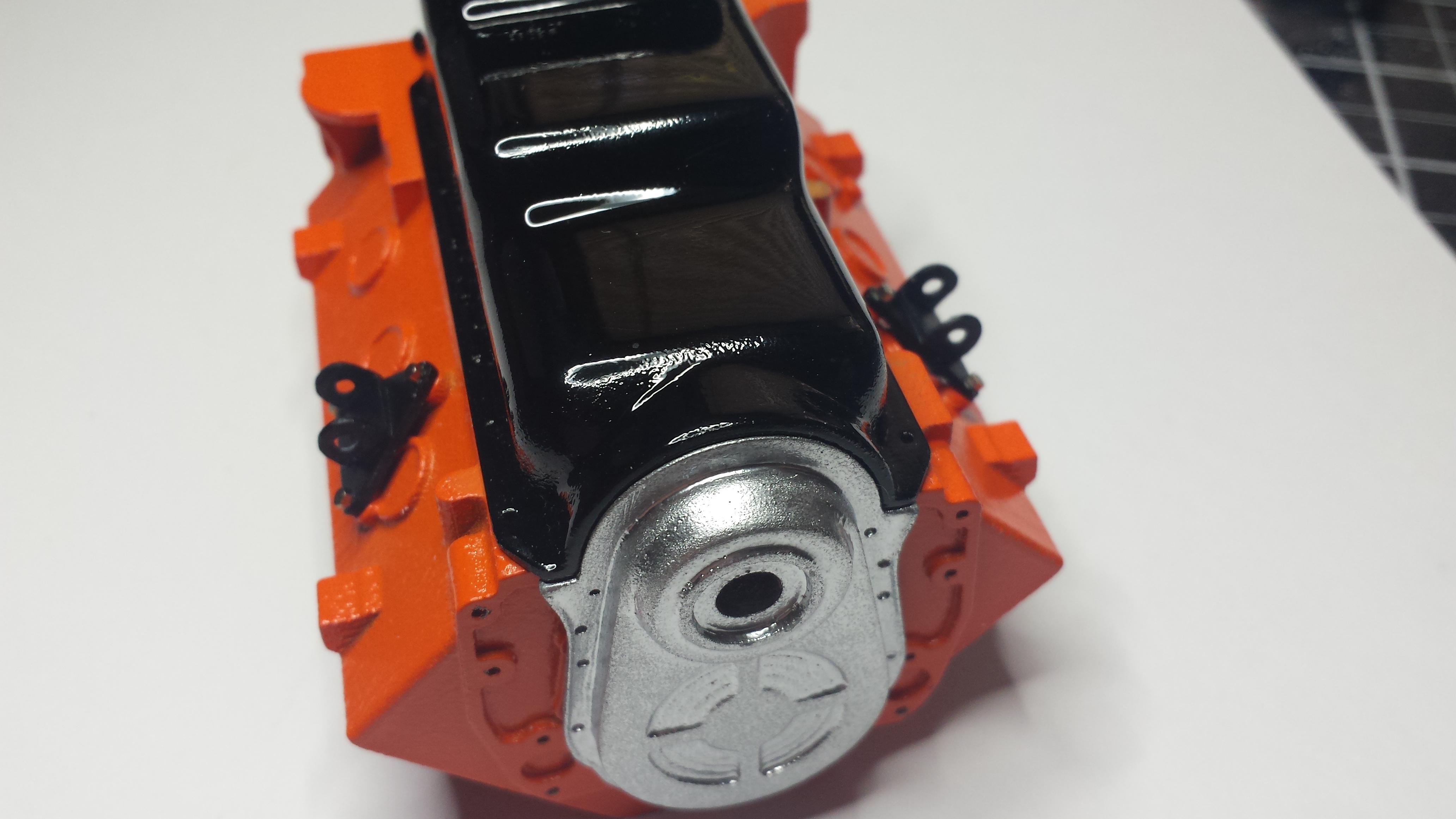

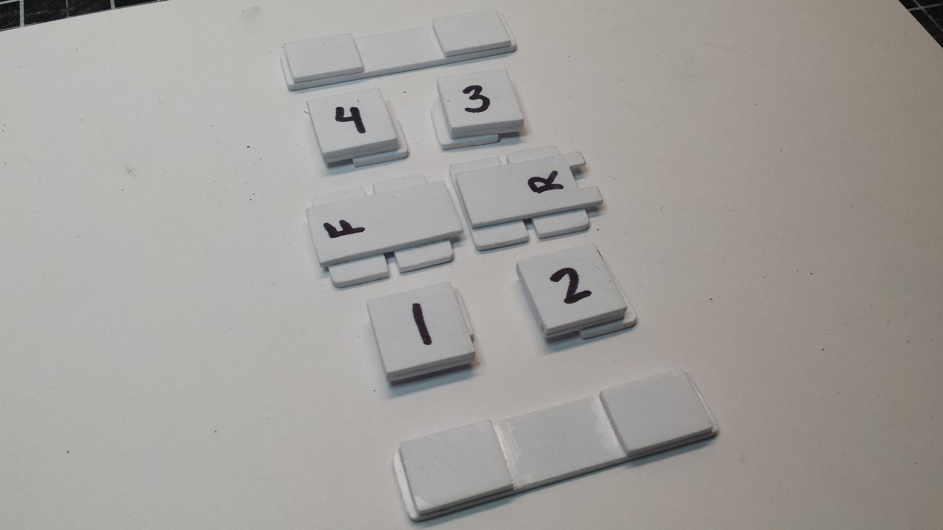

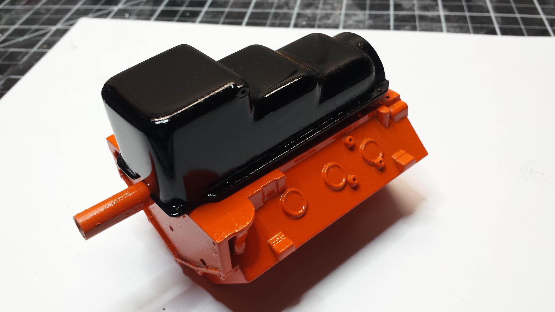

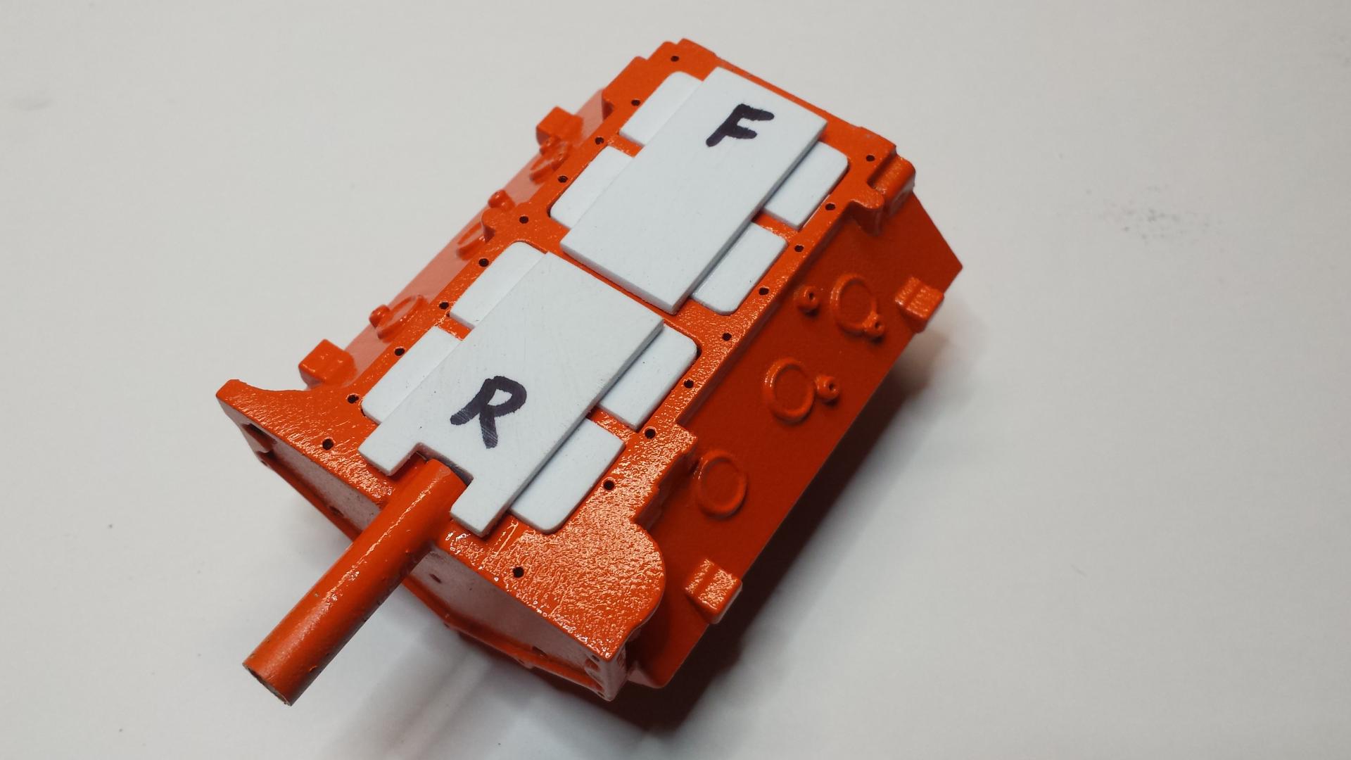

Steve Osbourne Posted March 22, 2018 Author Posted March 22, 2018 I thought I'd share my methods for assembling t he 3-D parts. I make little plastic locating pieces together - like the heads & valve covers, heads & engine block, oil pan & engine block, etc. Nothing shown here is permanently installed but rather held in by compression. First, the oil pan...

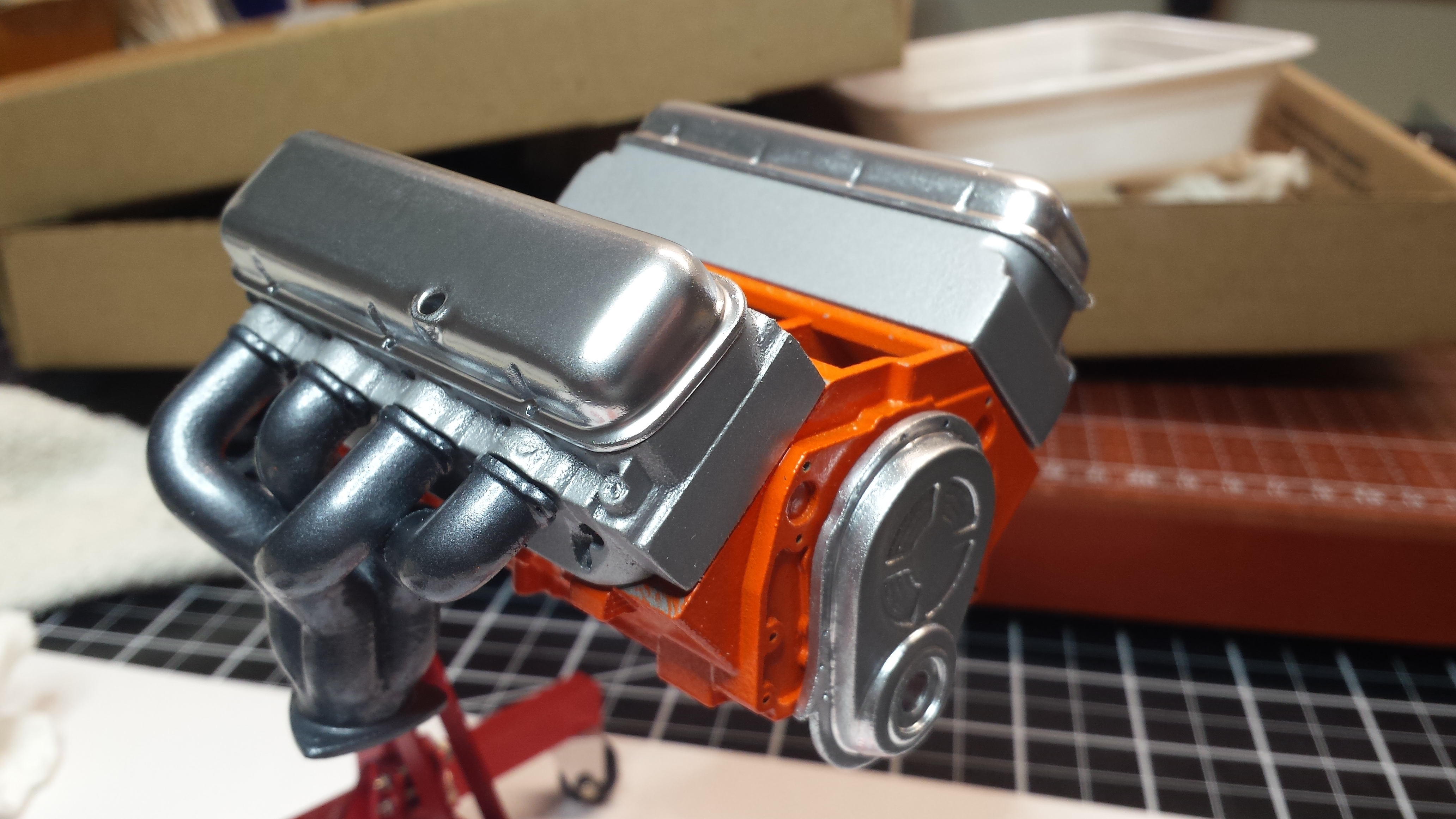

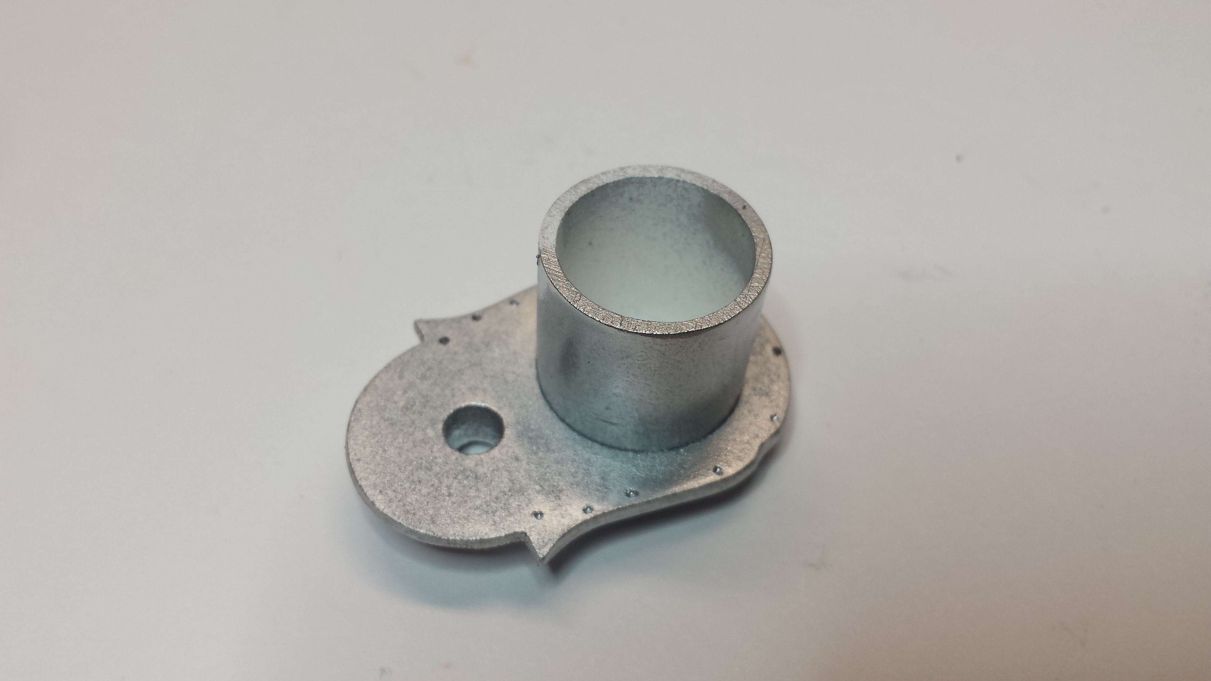

Steve Osbourne Posted March 22, 2018 Author Posted March 22, 2018 Timing cover, I attached a small piece of 5/8" PVC tubing to the back which attaches to a larger (3/4" I think) piece attached to the forward internal bulkhead inside the engine block.

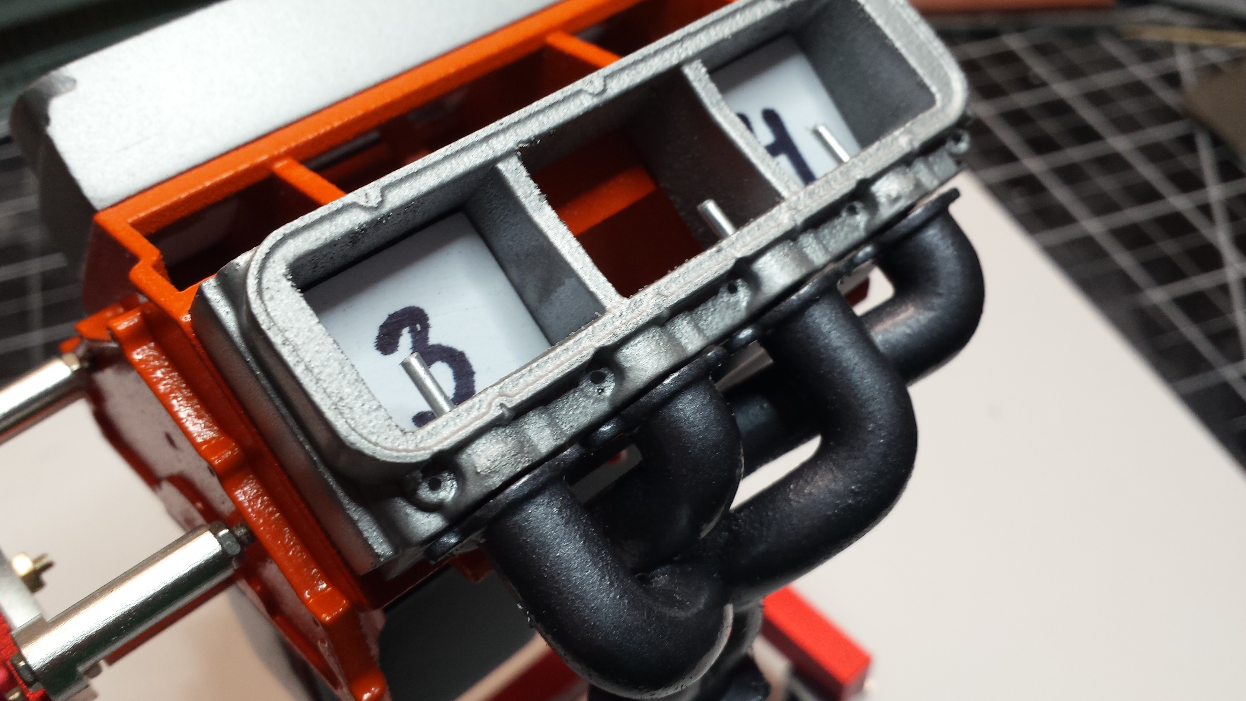

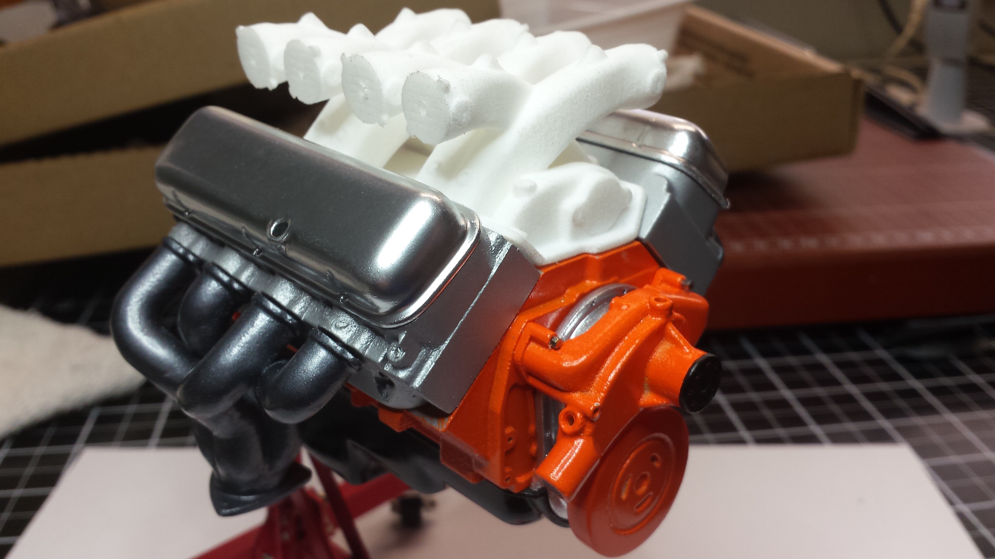

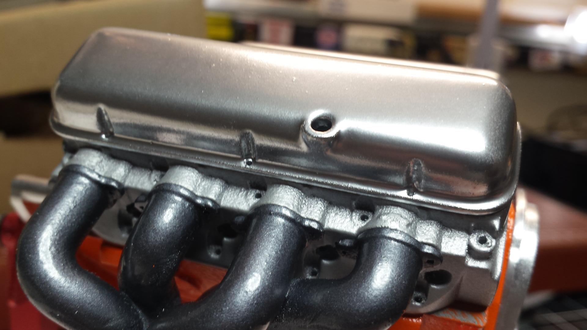

Steve Osbourne Posted March 22, 2018 Author Posted March 22, 2018 Valve covers attach to these pieces that fit onto the heads...

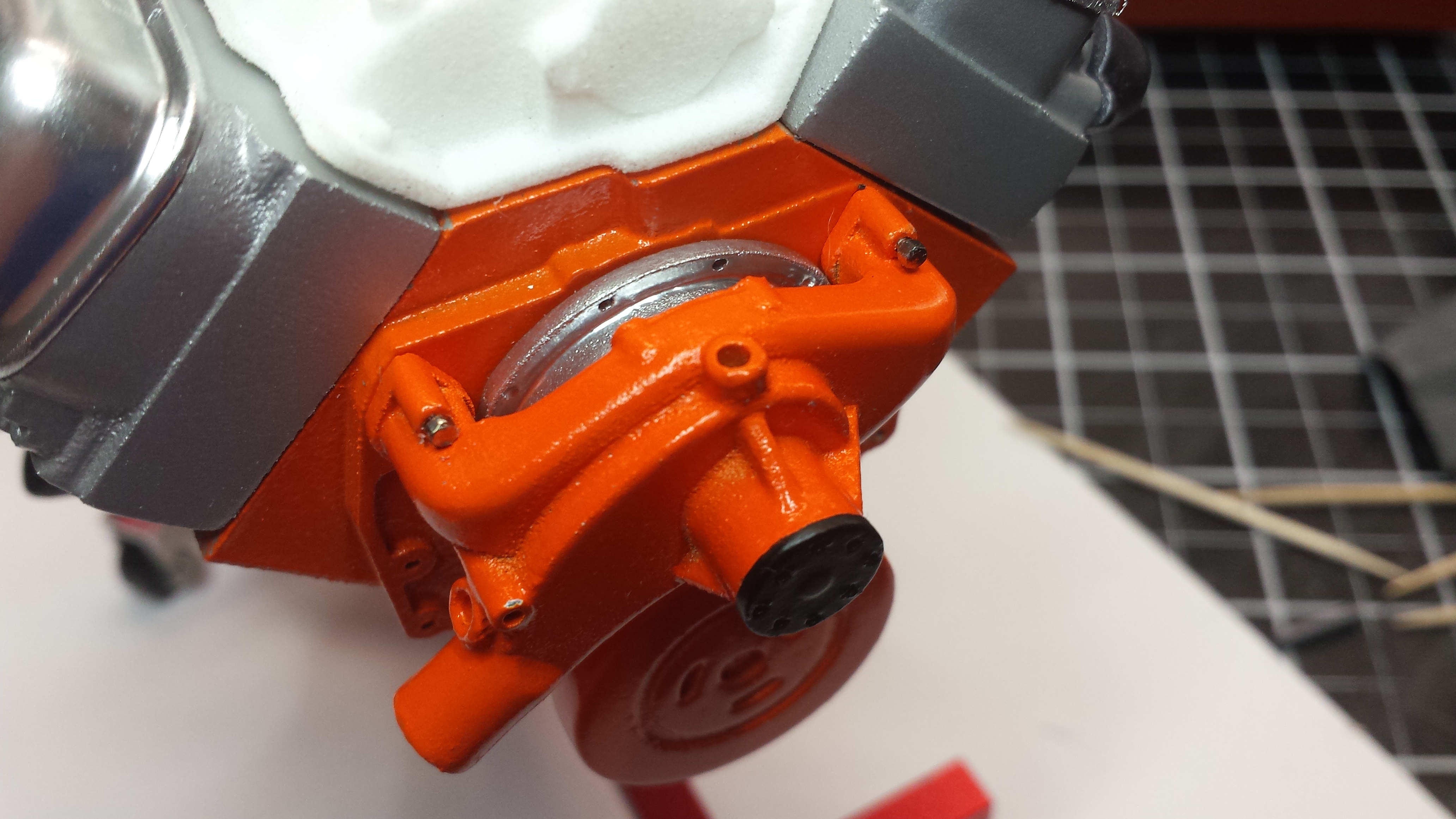

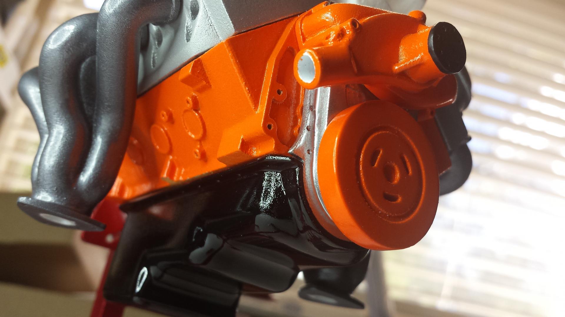

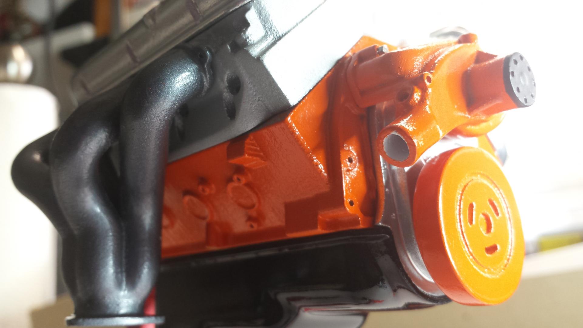

Steve Osbourne Posted March 22, 2018 Author Posted March 22, 2018 And here I've got the oil pan & water pump test fit as well as the cross ram fuel injection which has a piece of plastic glued to the bottom that fits into the opening on top of the block.

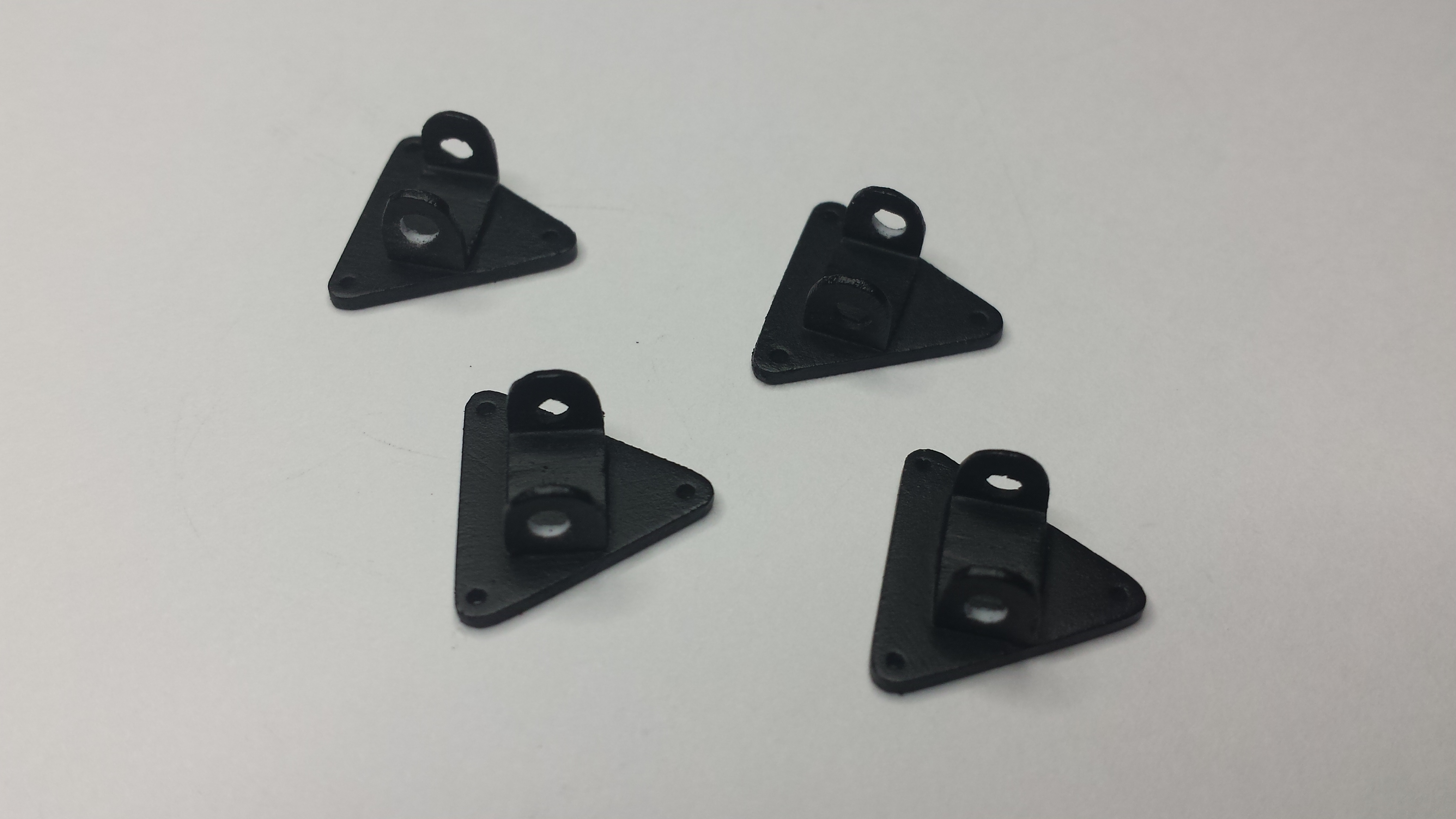

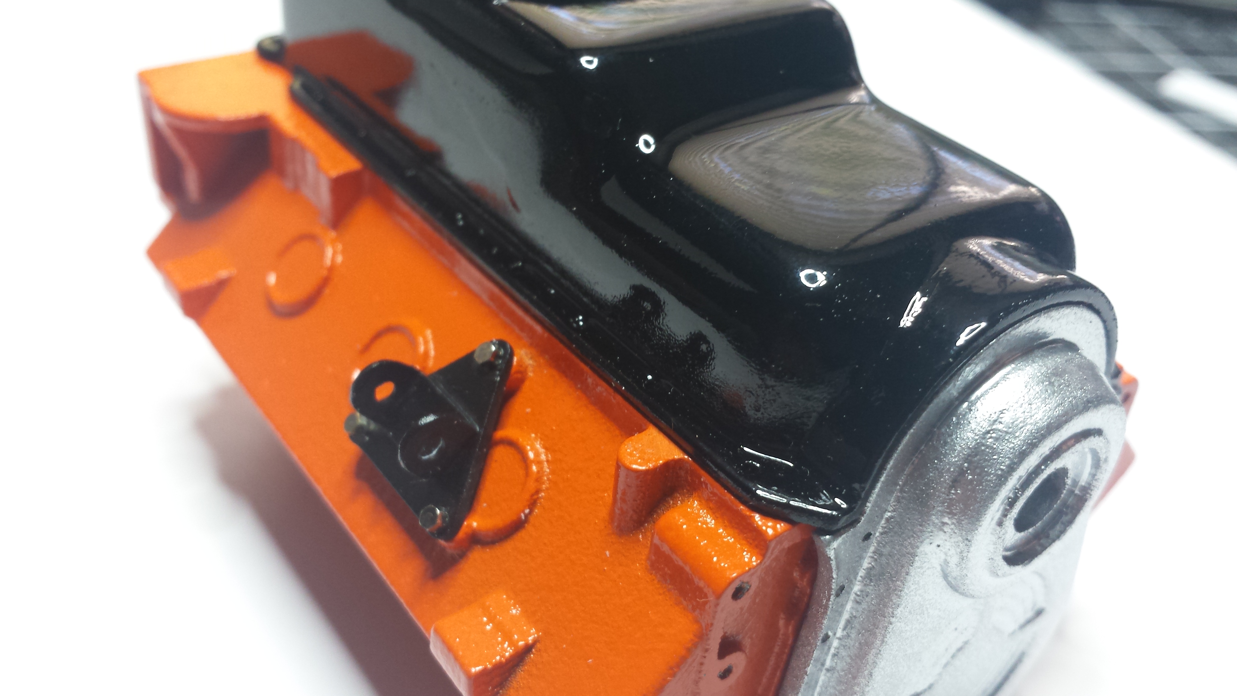

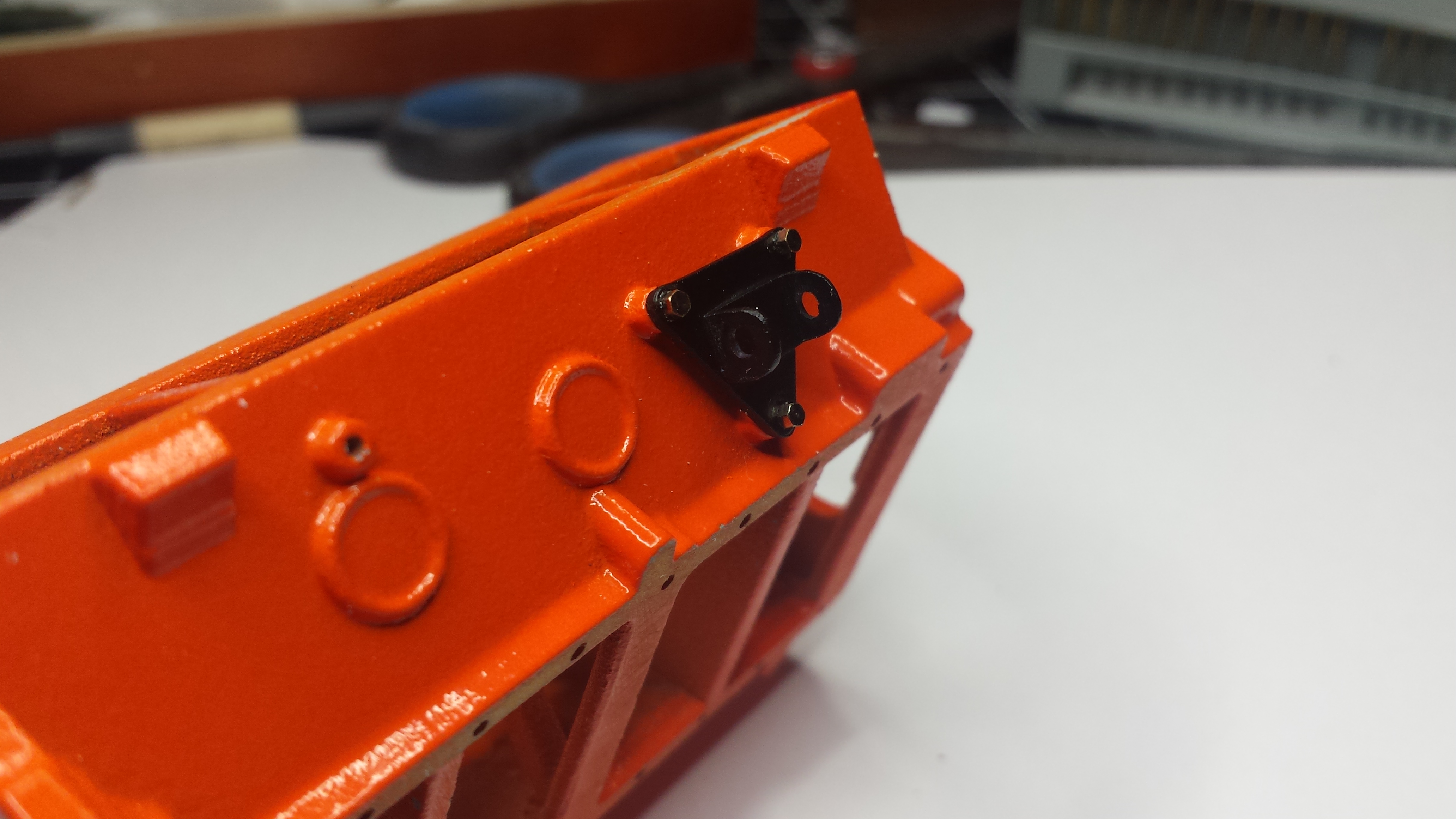

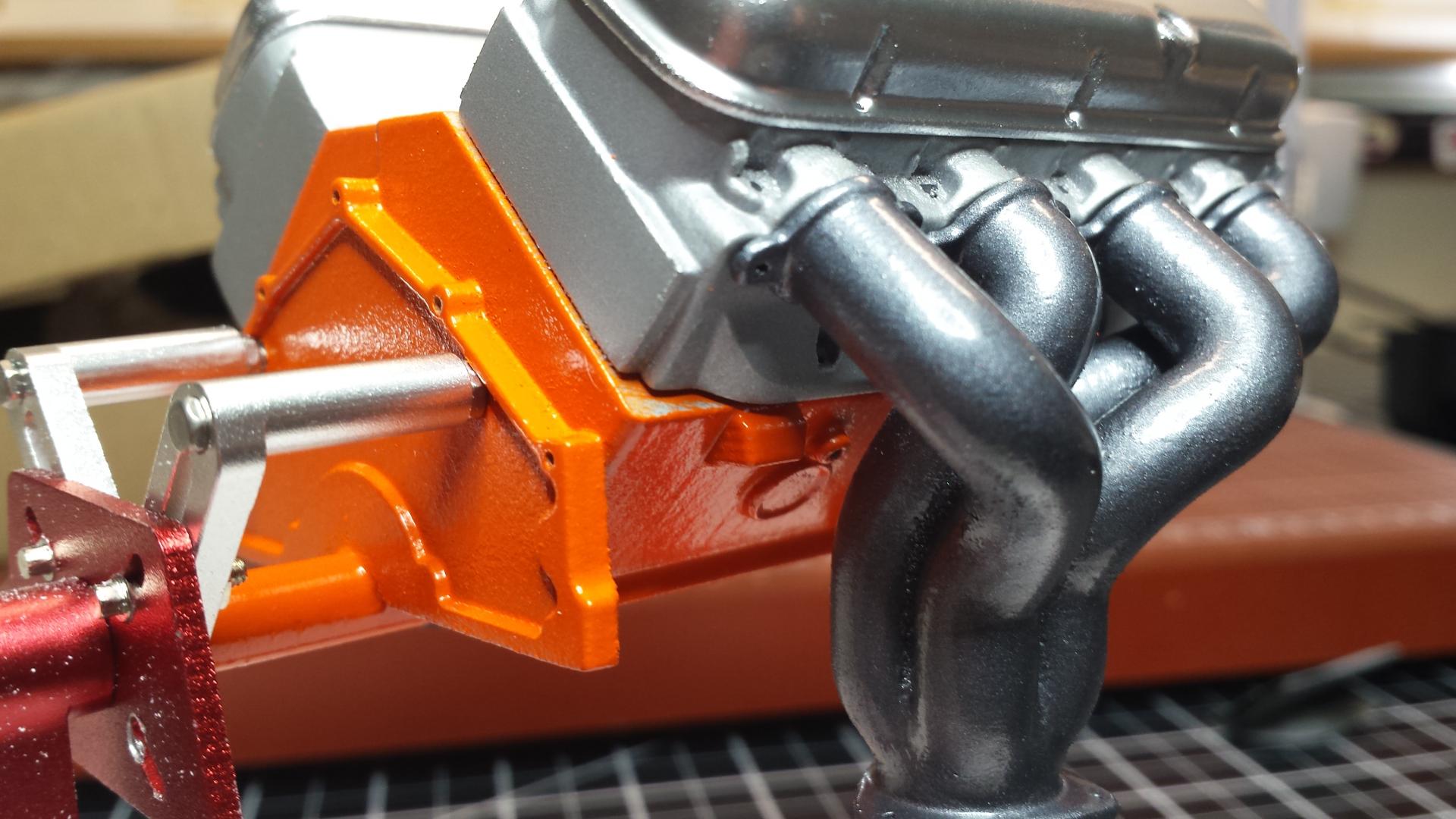

Steve Osbourne Posted March 29, 2018 Author Posted March 29, 2018 Thanks Todd. I made these motor mounts from Evergreen sheet and rectangular tube. They mount to the block with 1mm screws.

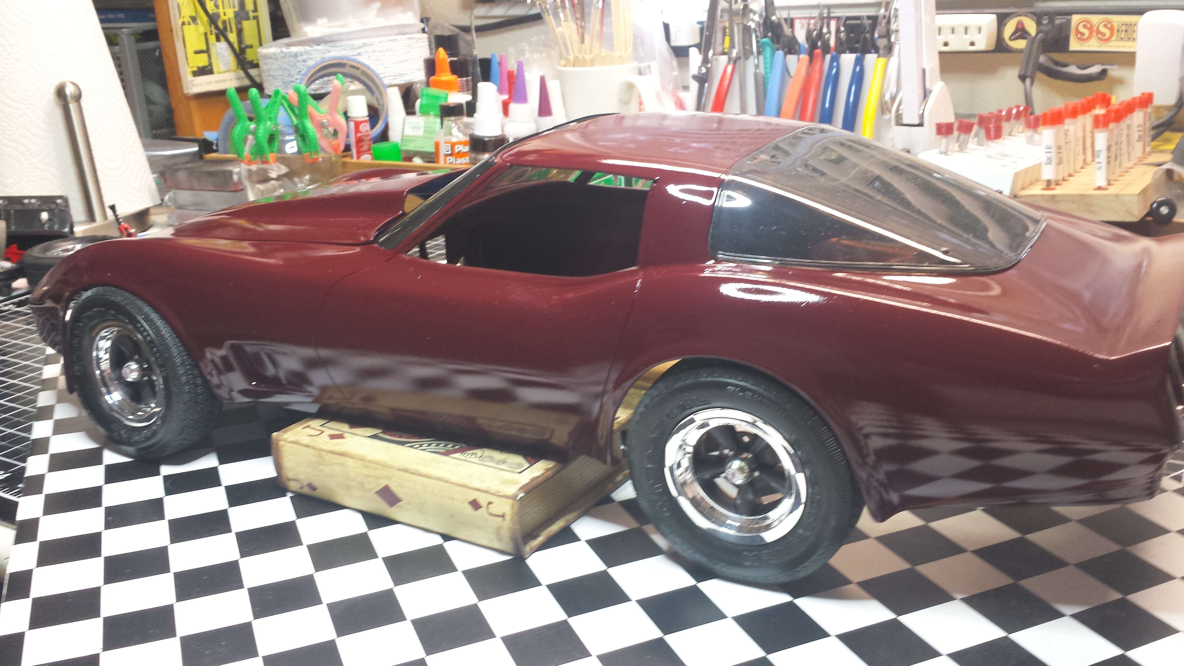

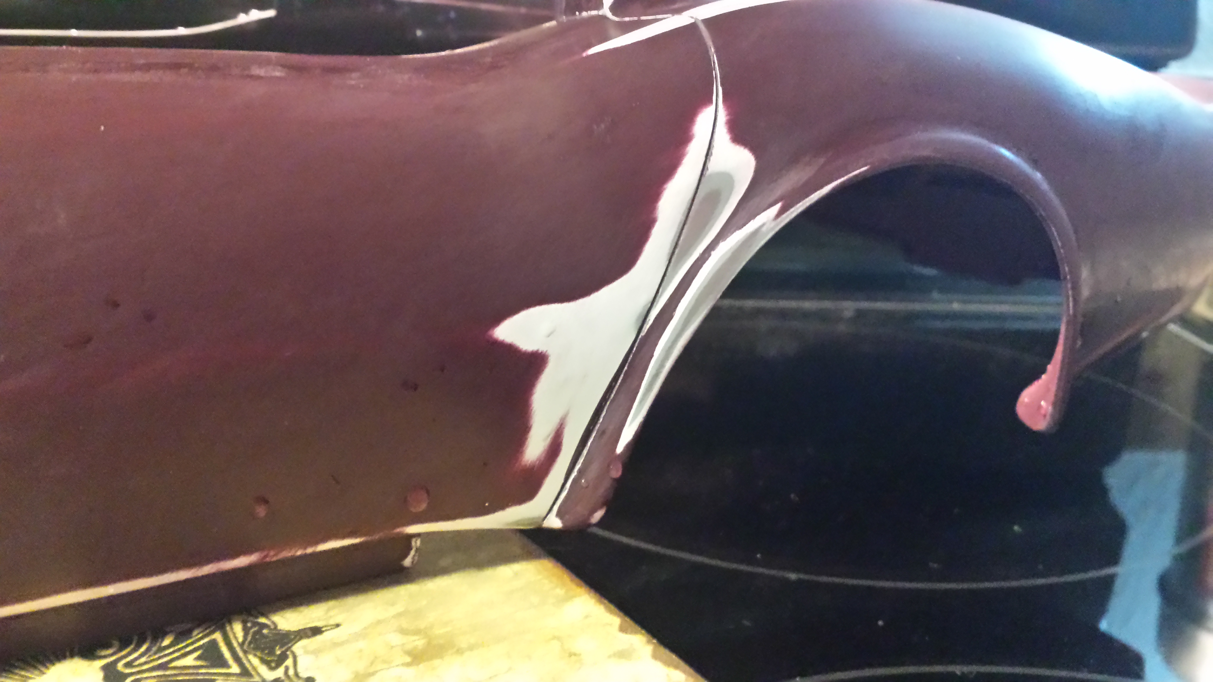

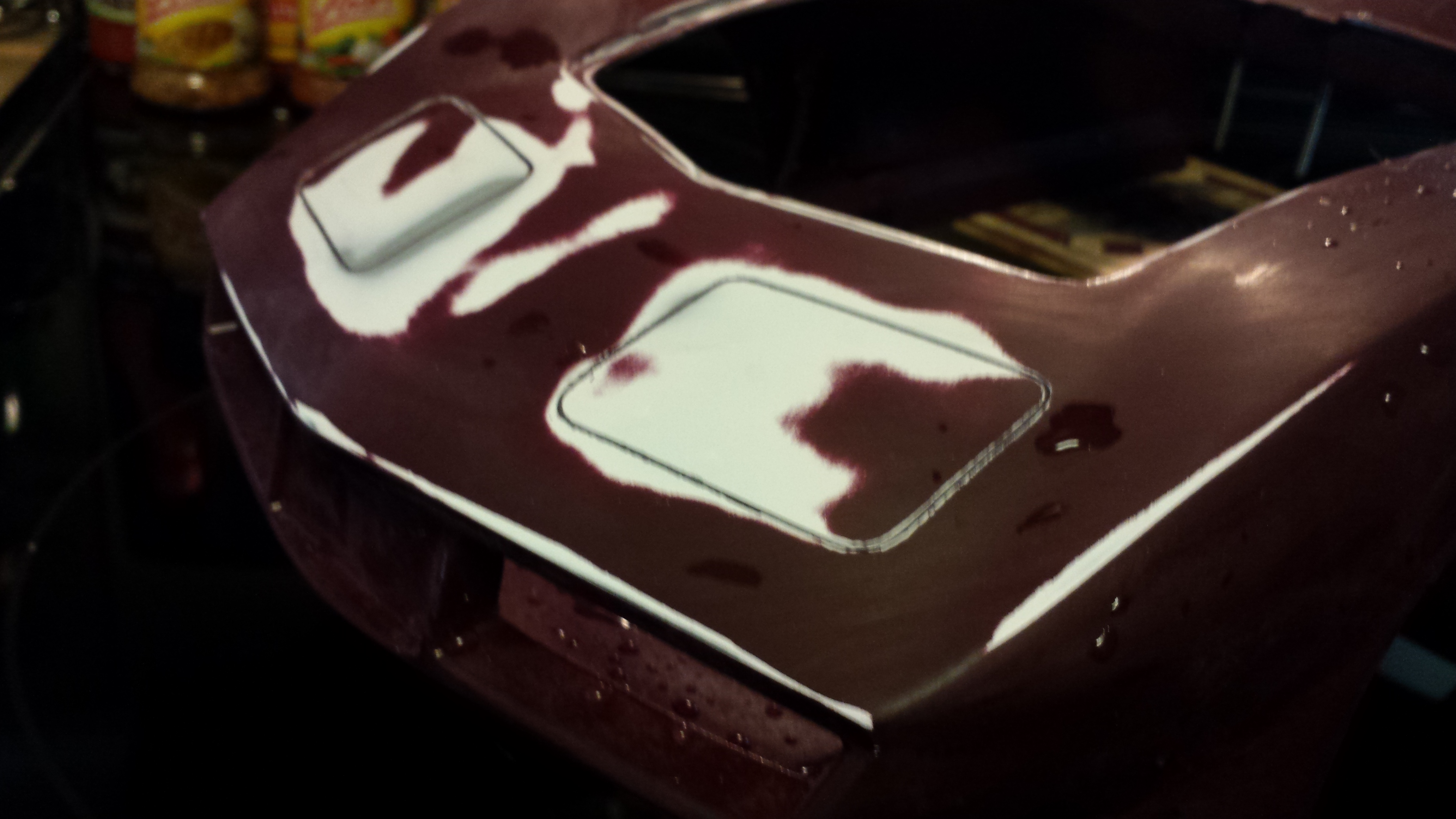

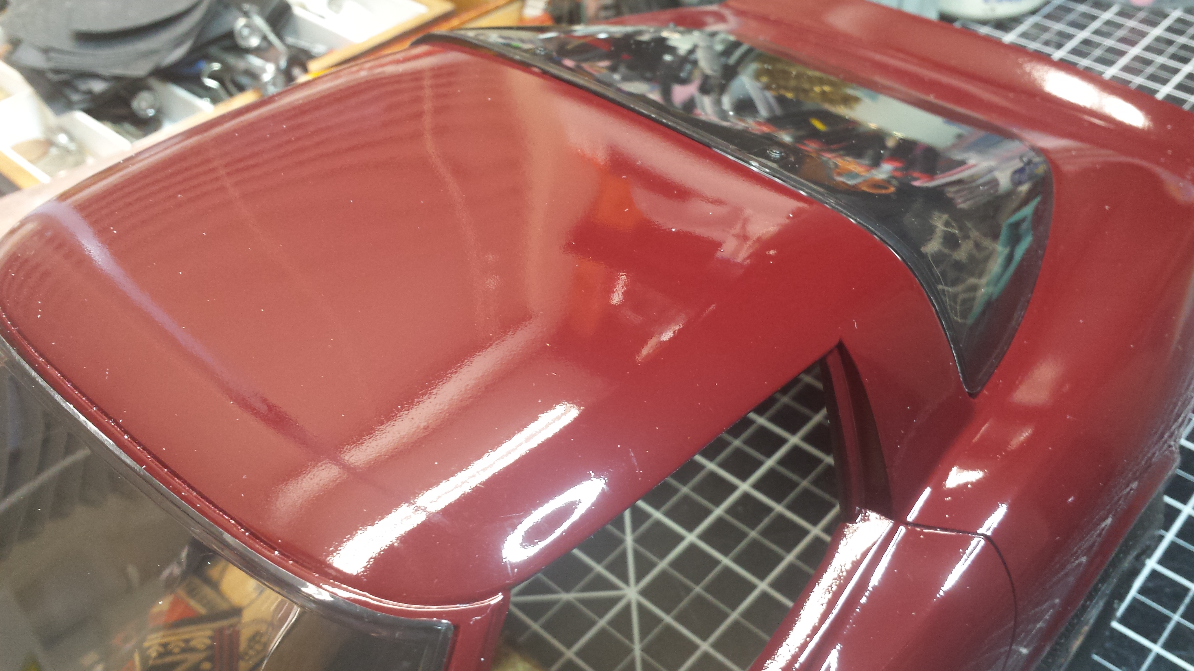

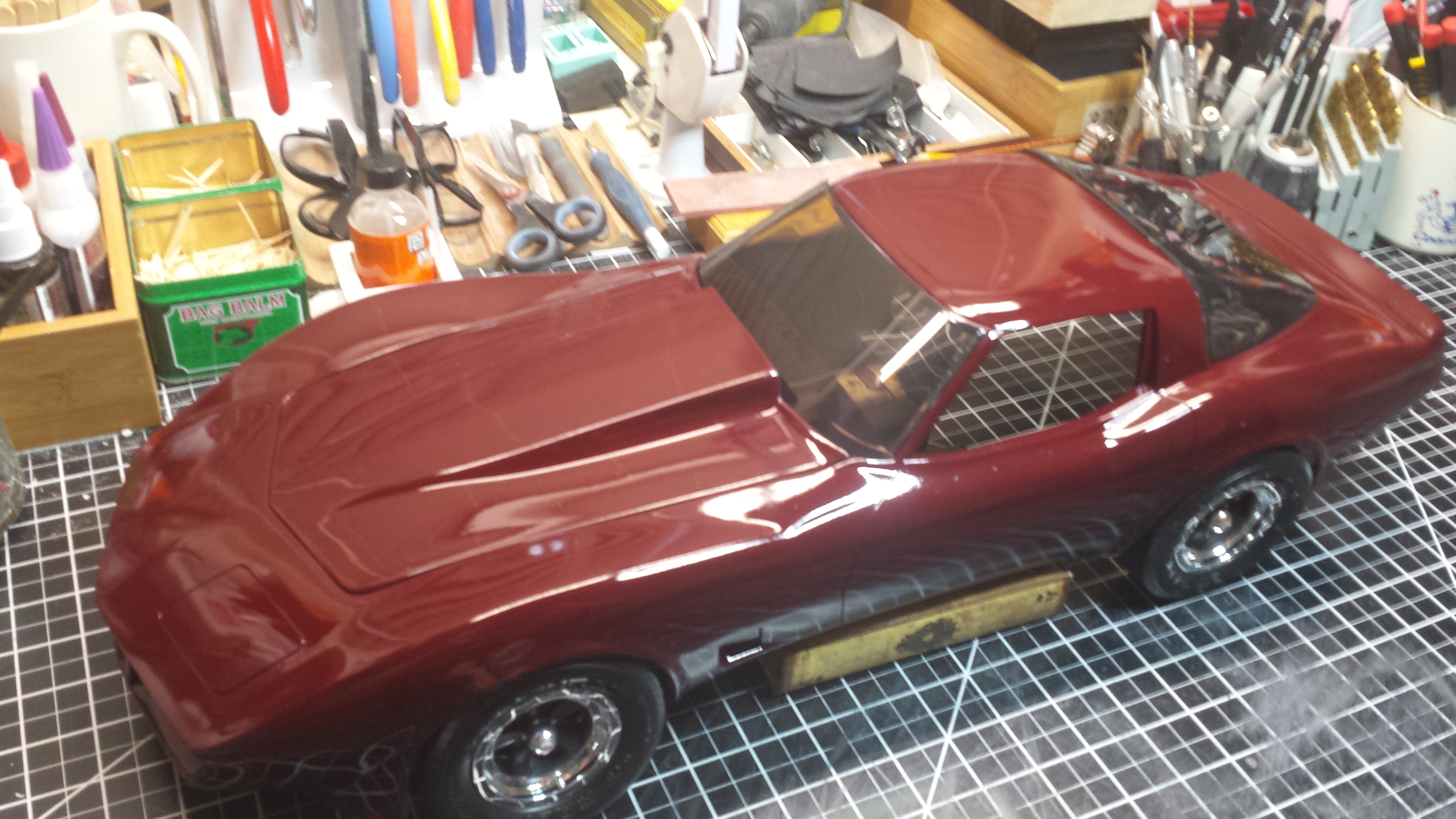

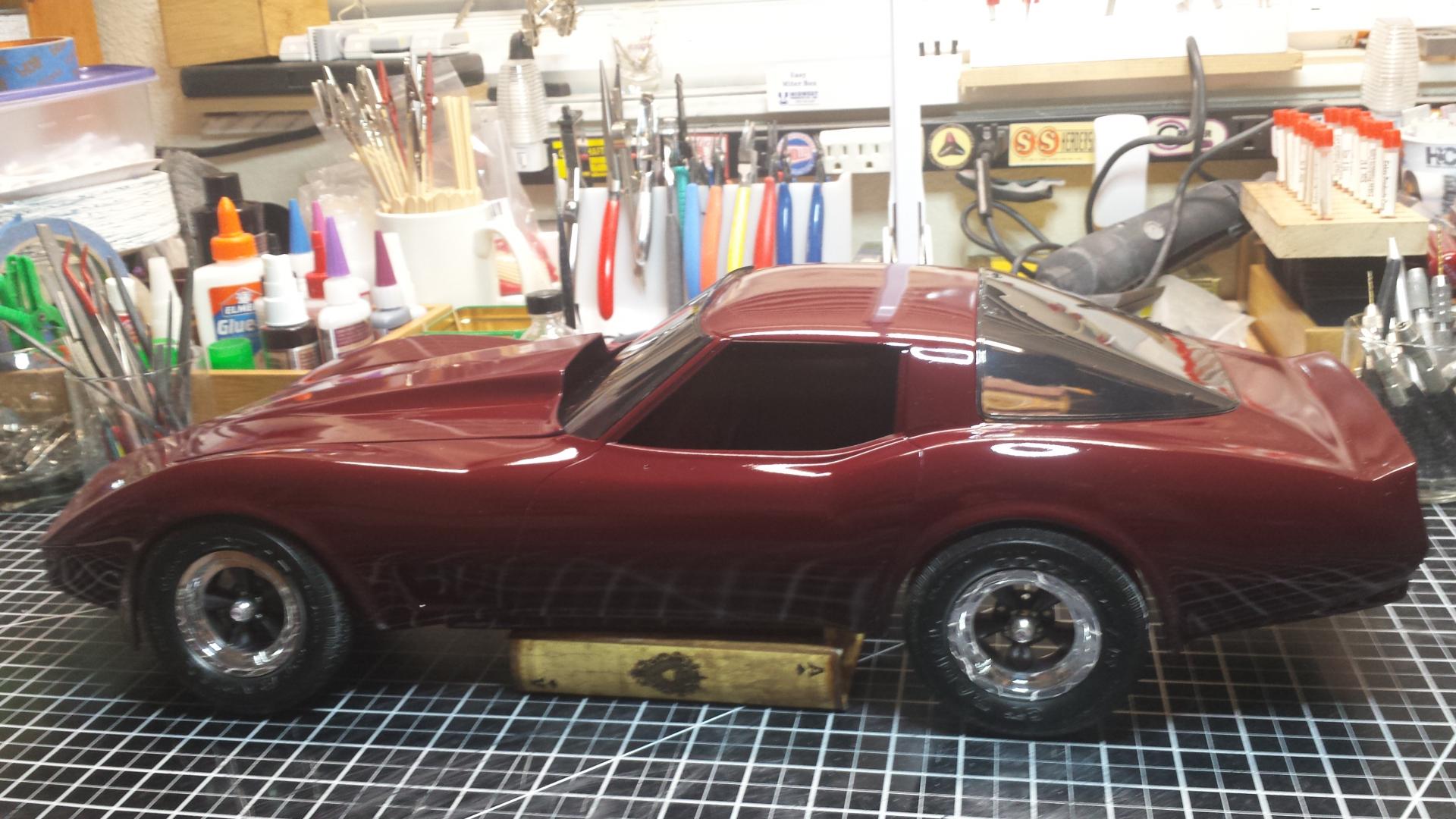

Steve Osbourne Posted April 3, 2018 Author Posted April 3, 2018 Paint update...I shouldn't have rushed things and done a better job wet sanding last time as there were numerous trouble spots that had to be addressed. On a model this large, imperfections in the paint become increasingly more apparent. I've tried to take this project a step further by removing all the body chrome so I could focus on highlighting the smooth and flowing lines of the C3 Corvette. Noticeable flaws would be bad. But the next paint session went real good as the weather was very good for painting able to lay down multiple light coats followed by several heavier wet coats. I'll post a couple of outdoor shots in my next post.
