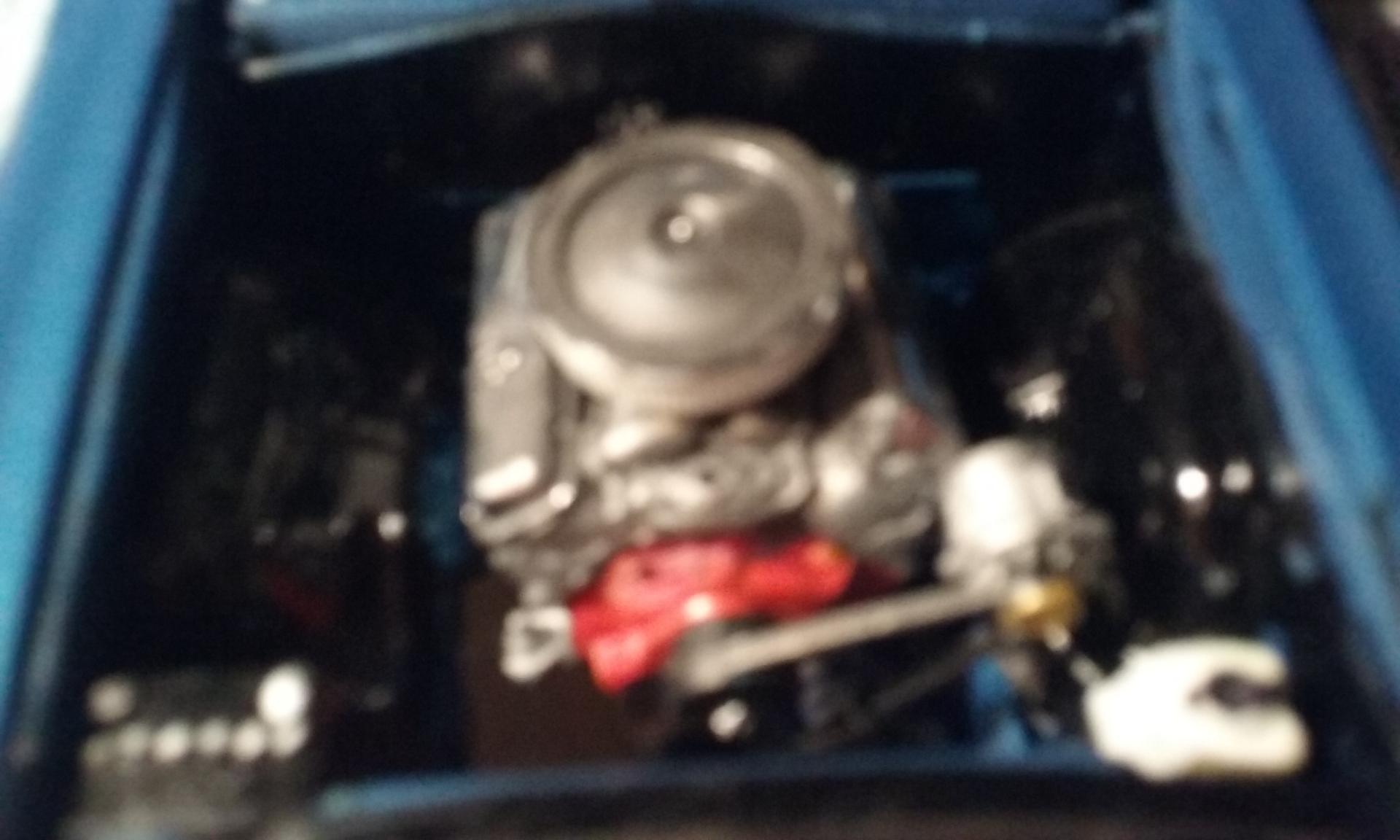

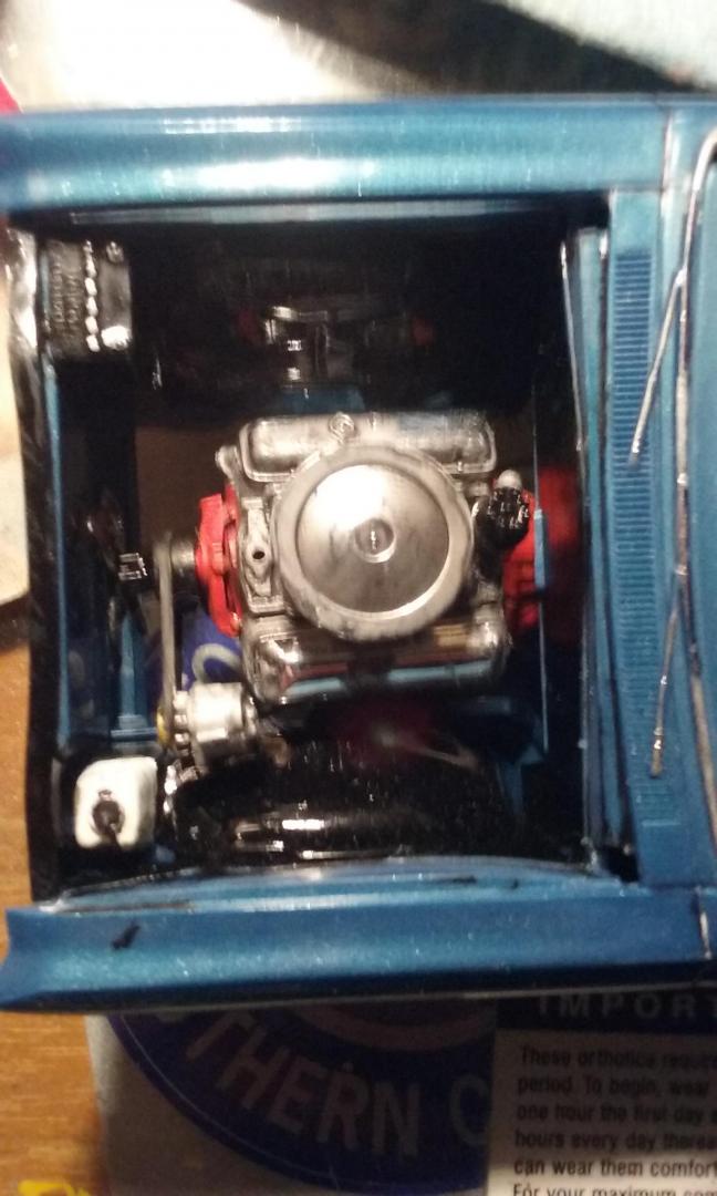

Had a brief minute to snap a couple of photos of the 396 resting (mock-up) in its bay . First image is blurry ; second image is much better . Same phone camera , same time --- I'm going , "What the --- ?"
