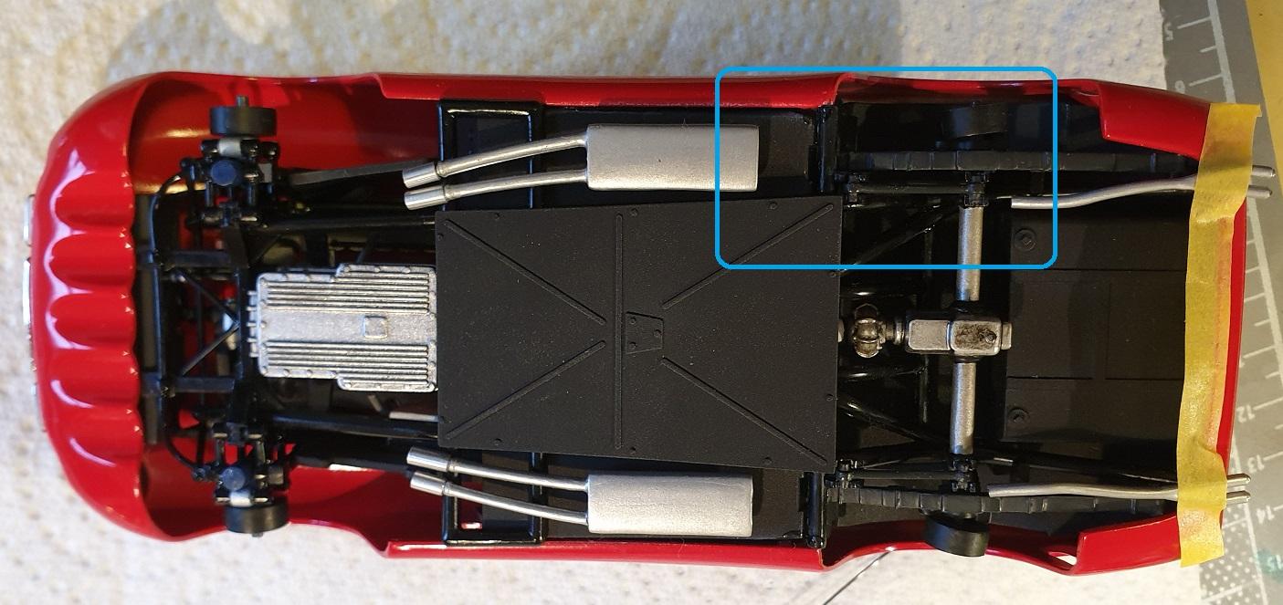

This kit has been fighting me all the way!
fitting the body was difficult, and resulted in the chassis and engine structure coming loose... which I've glued with superglue on the end of a toothpick...
finally, after 5 attempts, its in, and glued. A bit of a mess, but not a visible mess.
now exhausts...
there is a clash in the red circle between the axle / mounts and the exh pipe, this results in a twist of the pipe at both the blue circle area & the outlets
So after several attempts of twisting and rehaping using a naked flame to soften the plastic, i've ended up melting them.
i've cut the melted bits out and will need to fabricate a new section
I've never done this before & i've tried several methods, and think this is the best.

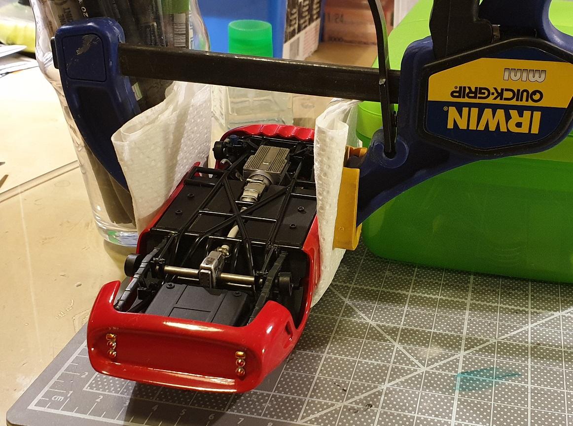

I hold in this fixture
& heat with a hair dryer, then when it is released, it's fixed in position
I am so glad you are toughing it out, Bud!....you are soooo close now!!!...thanks for that great pipe bending tip!!!

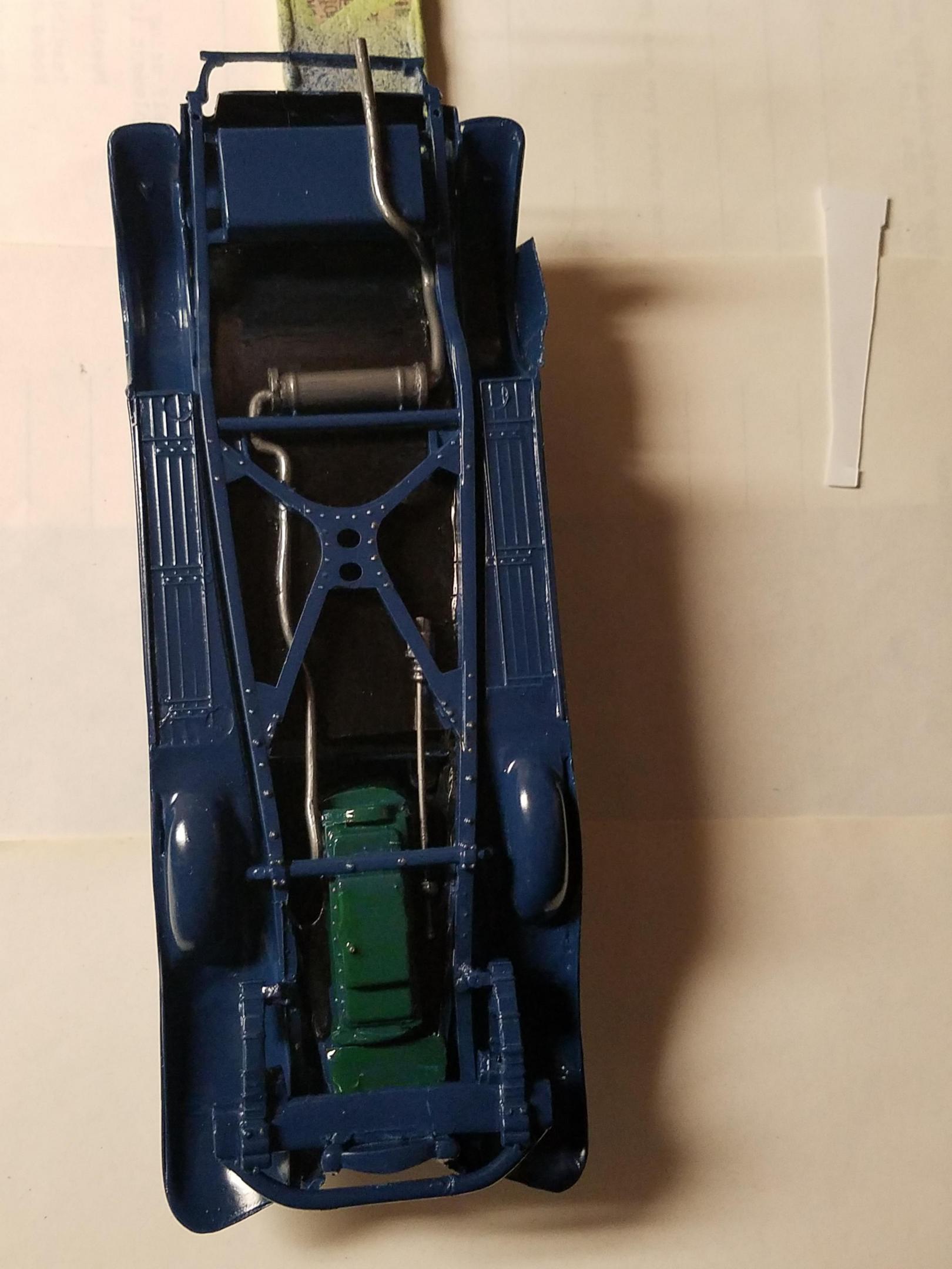

On 2/17/2020 at 6:59 PM, Eric Macleod said:
I had a very similar problem with the exhaust system of my Cord. The solution was to use some soldier which worked great, even with a ton of curves.
that's a good tip... I guess solder is malleable, but stiff enough to hold... i'll look into it!
I use solder alot now...it works GREAT!, but just be aware that it can mar pretty easily too...when it happens to me, i fill in the mark with super glue, then sand smooth -easy fix!
