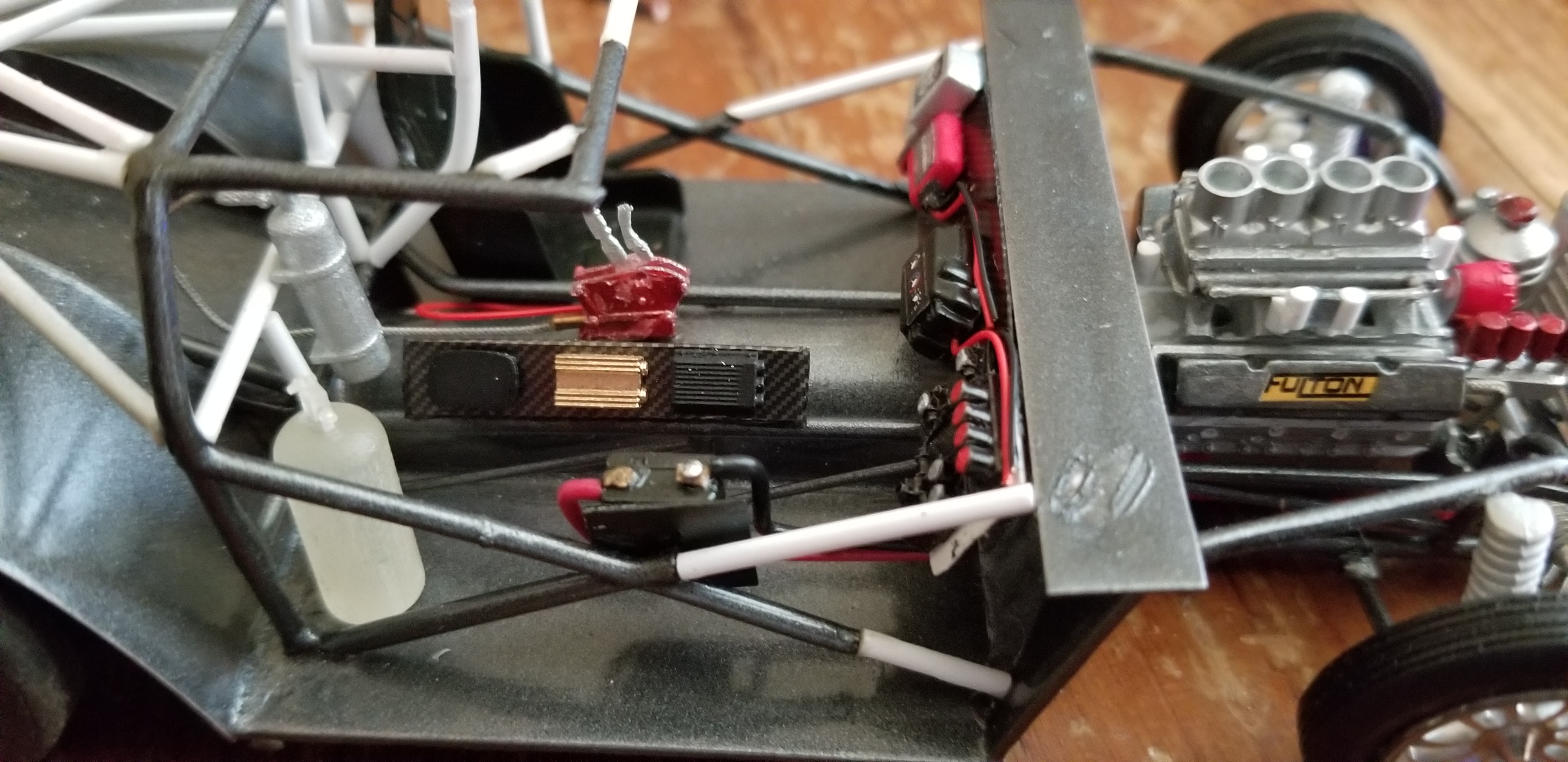

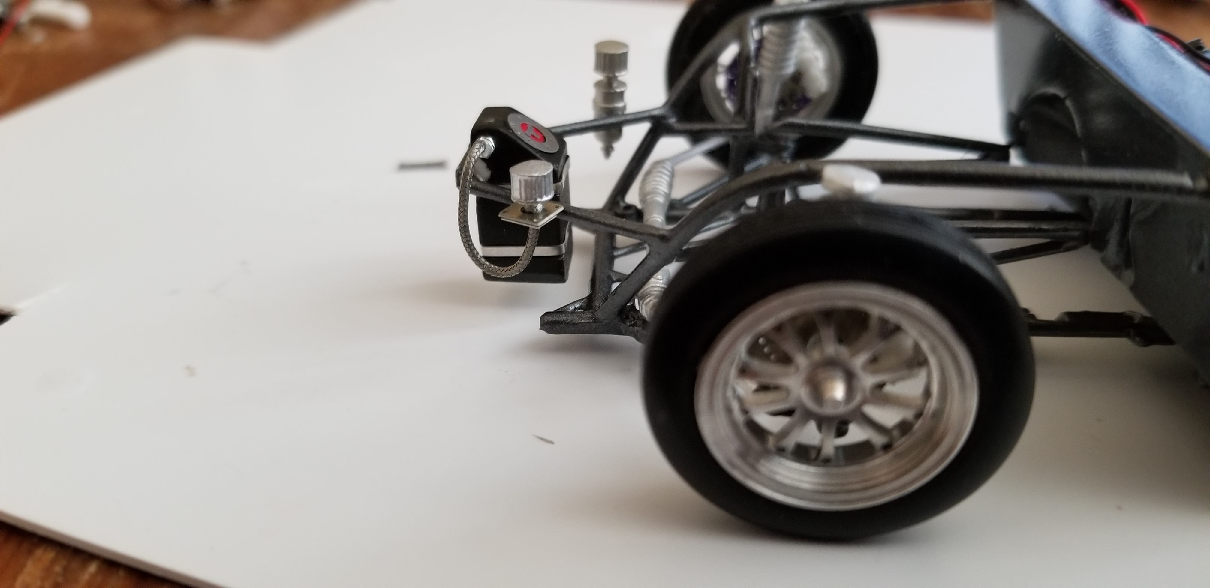

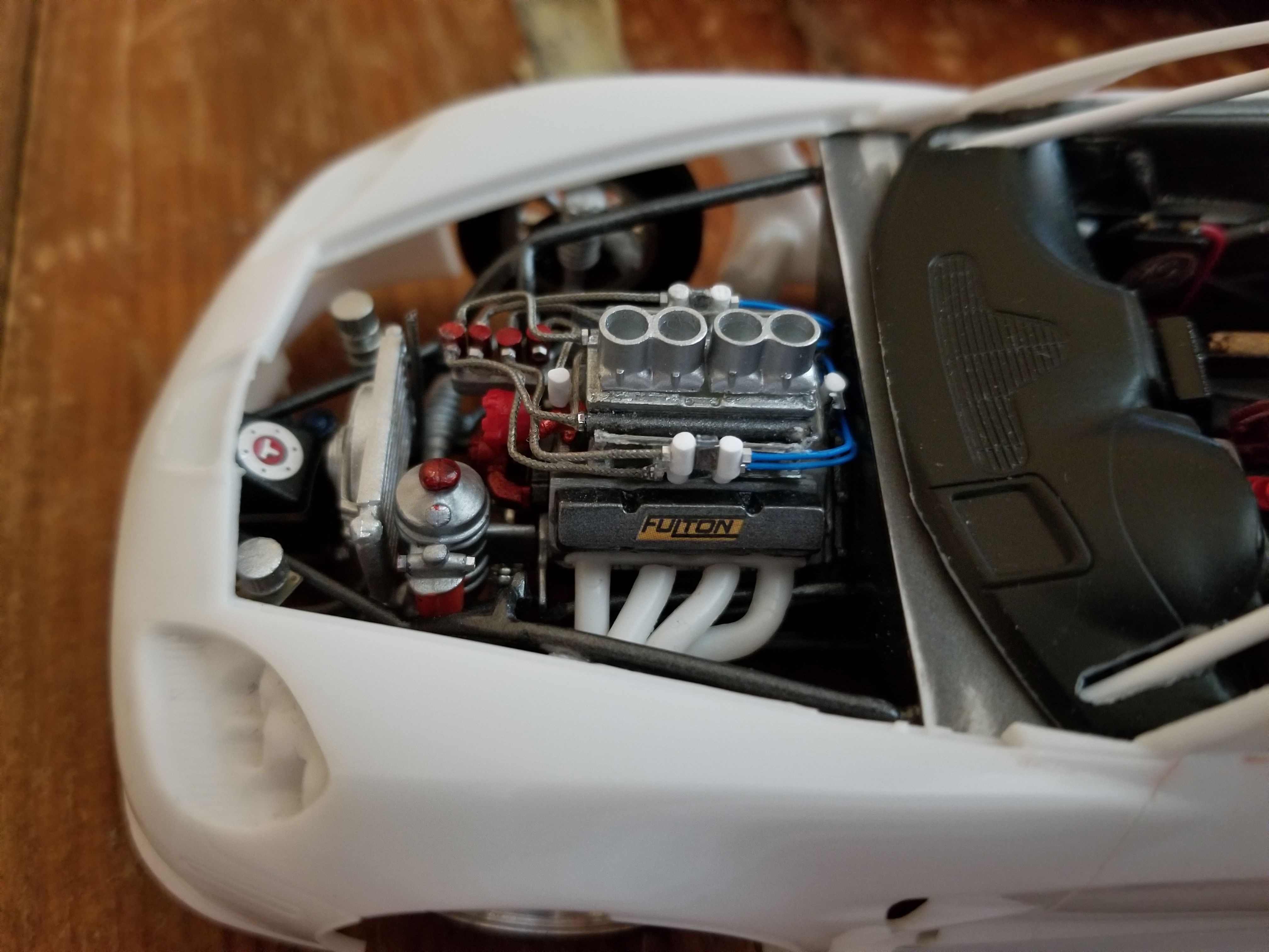

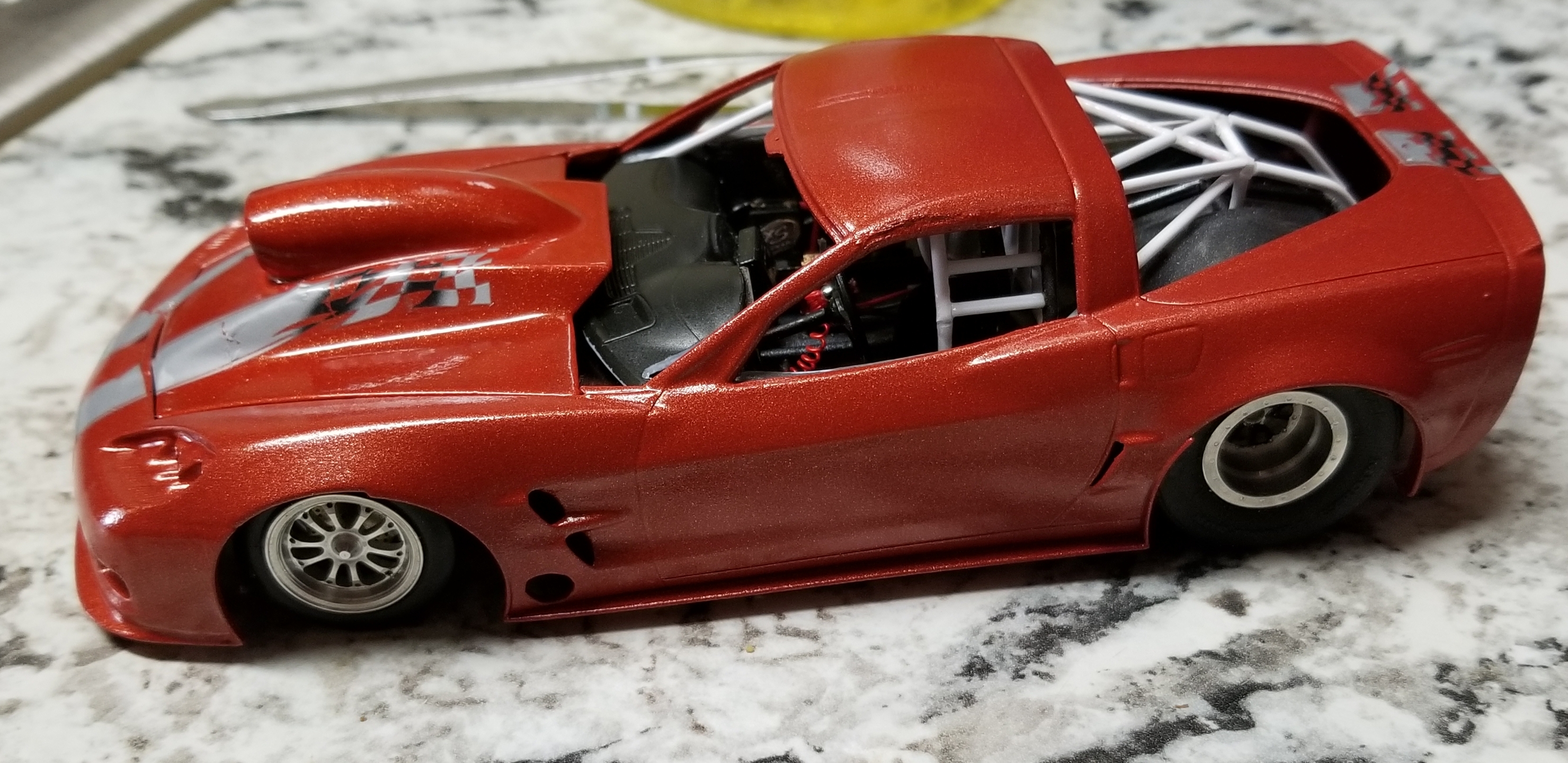

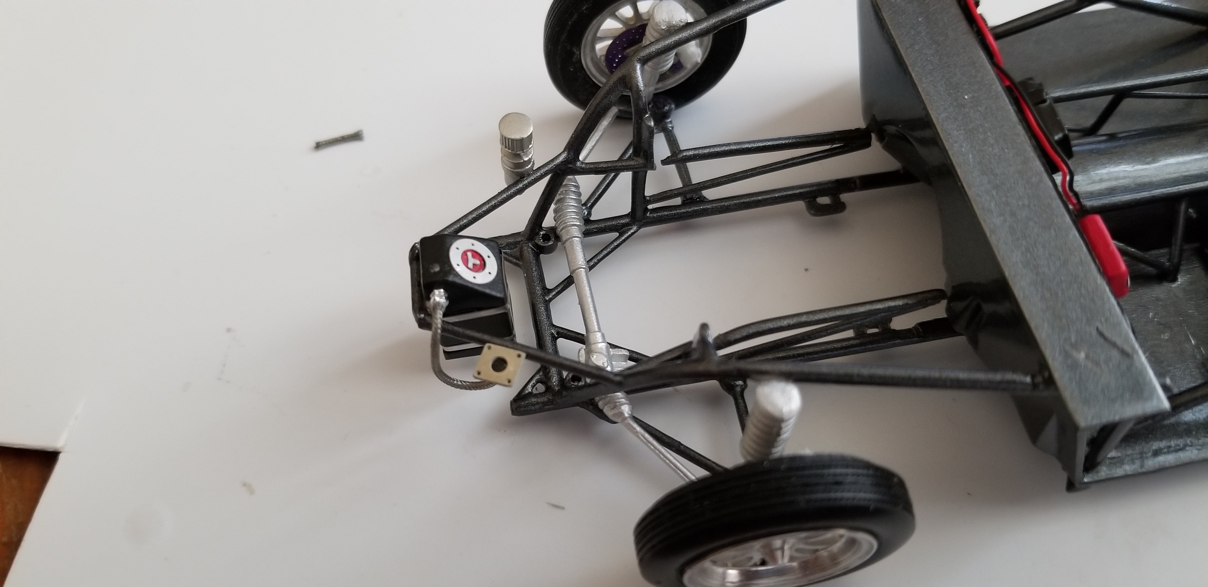

lil block 471 Posted July 3, 2018 Posted July 3, 2018 The chassis is from the 55 pro with modded firewall and tubs. The a arms are from the Olds pro and added the fab 9 rear.

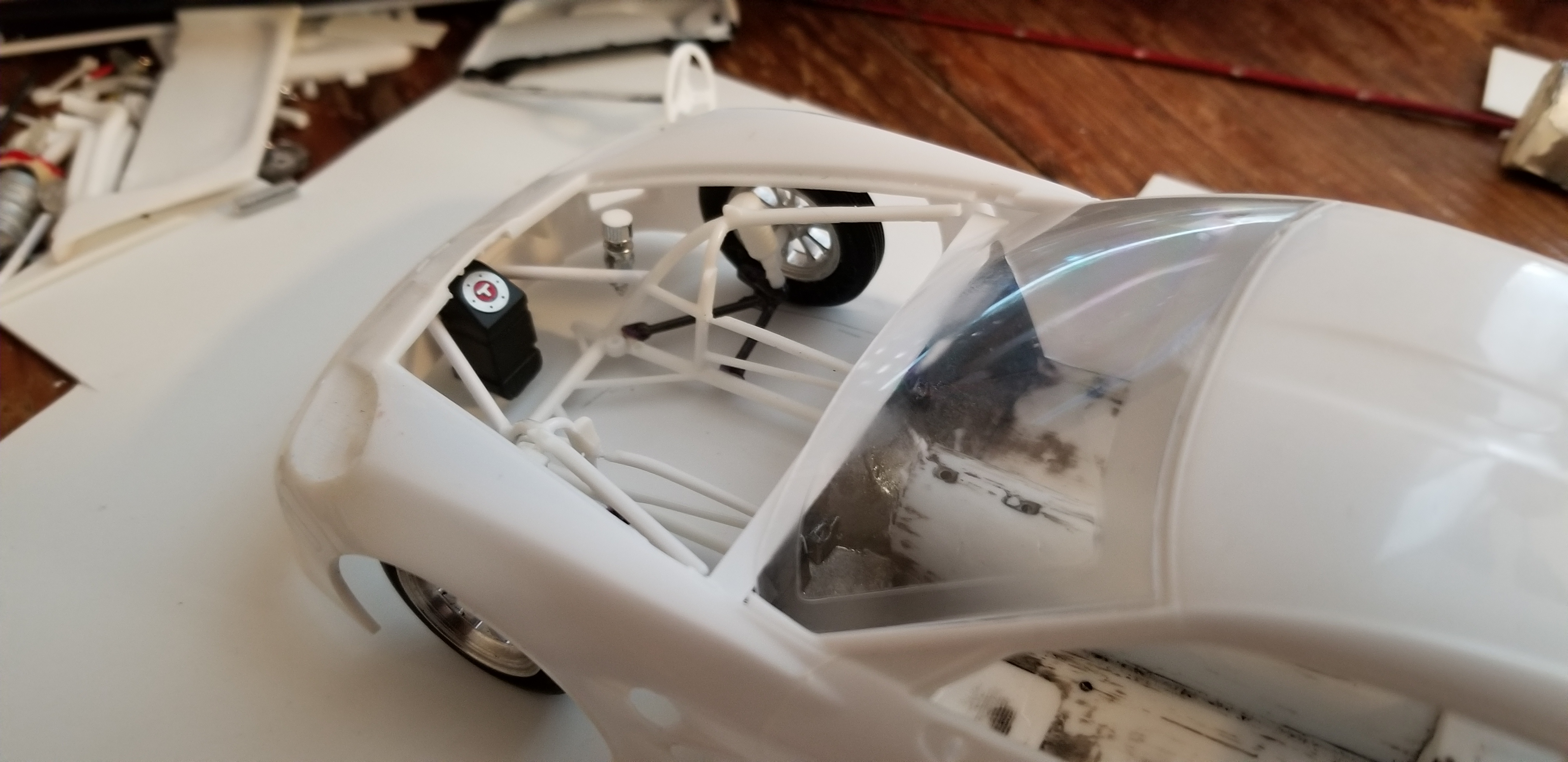

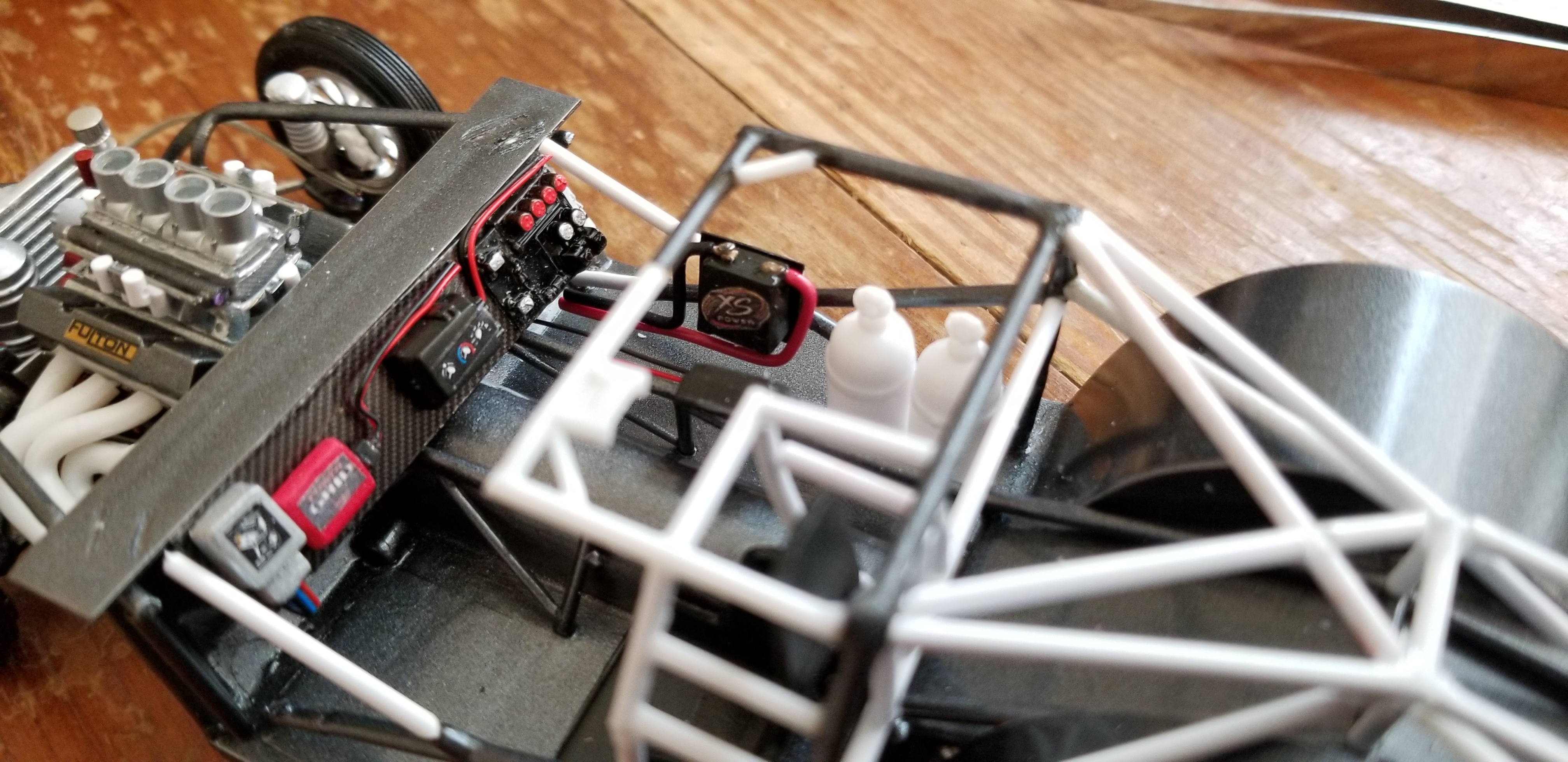

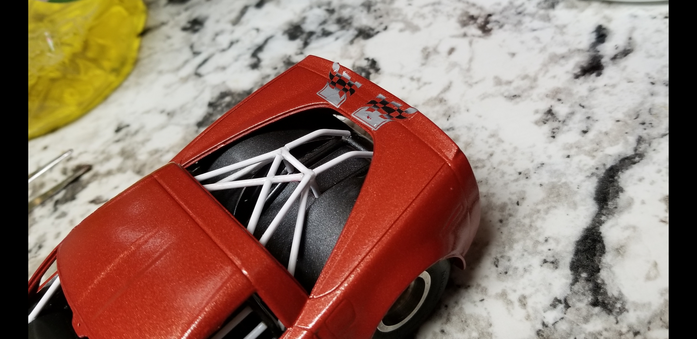

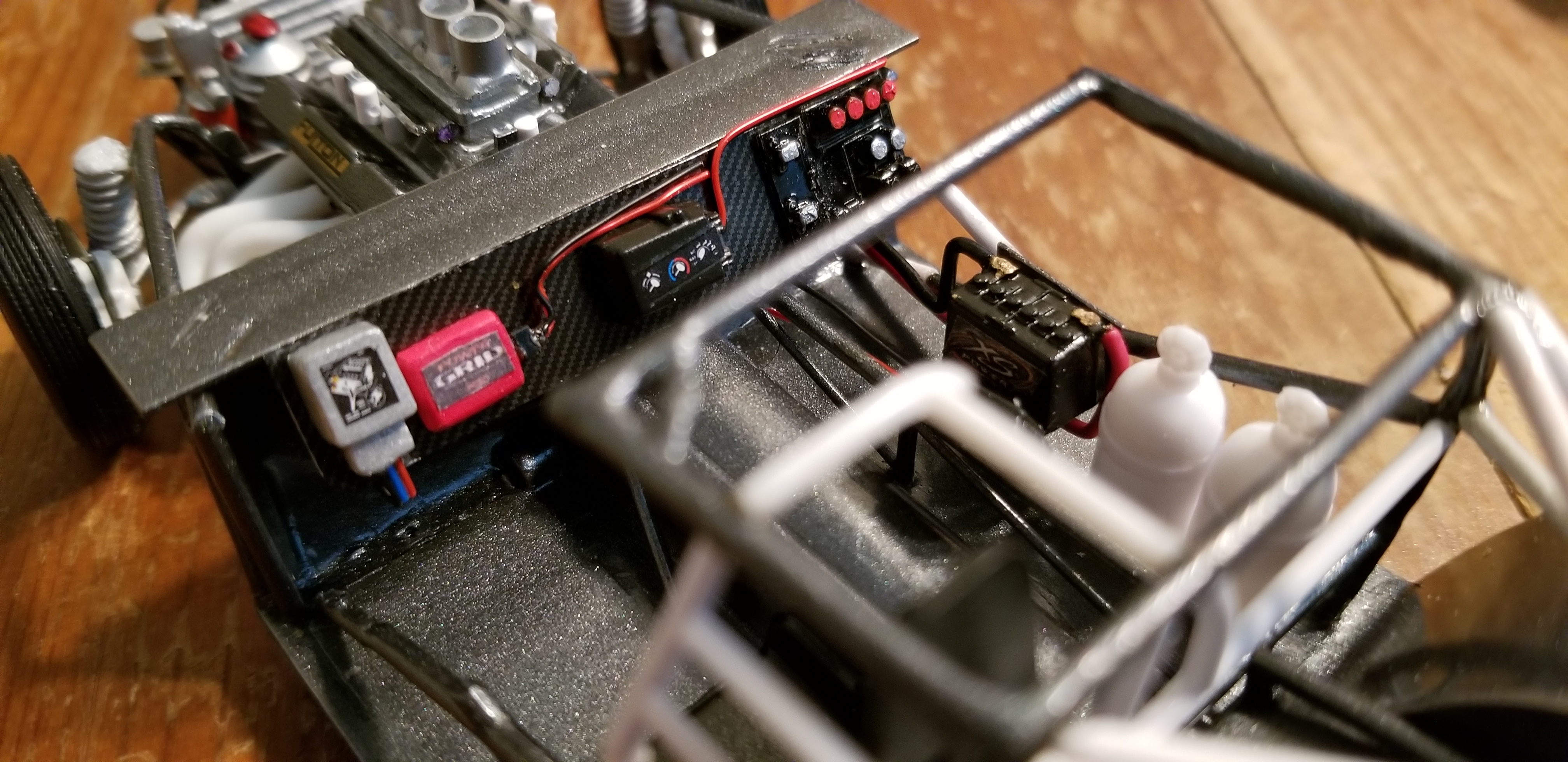

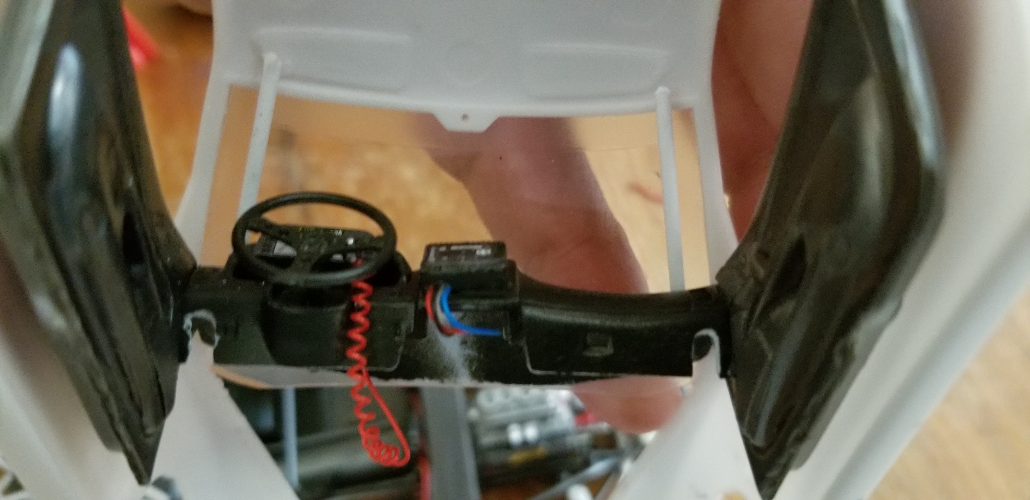

lil block 471 Posted July 3, 2018 Author Posted July 3, 2018 Still making changes to this build like the battery and cage bars and a few other things.

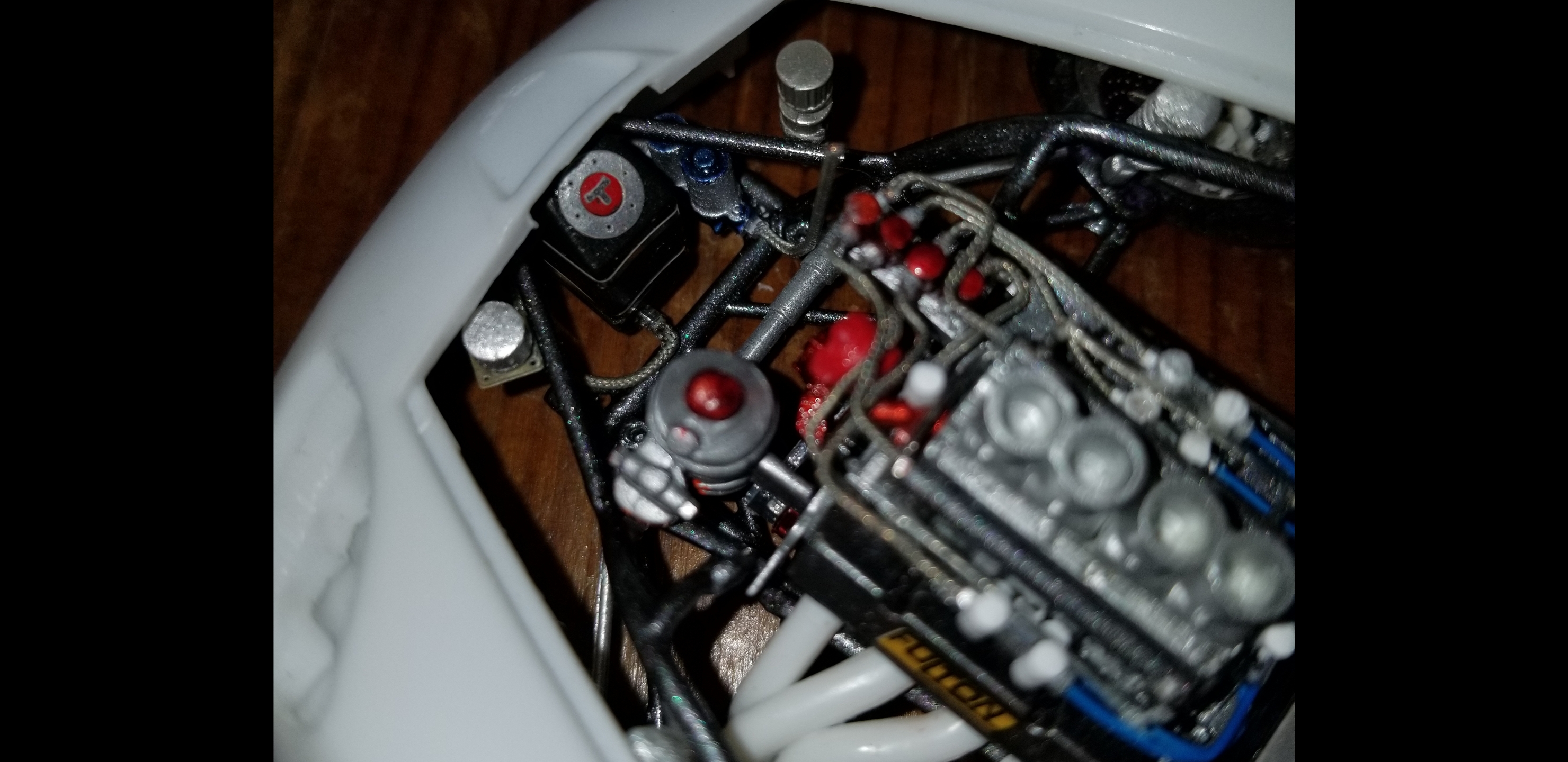

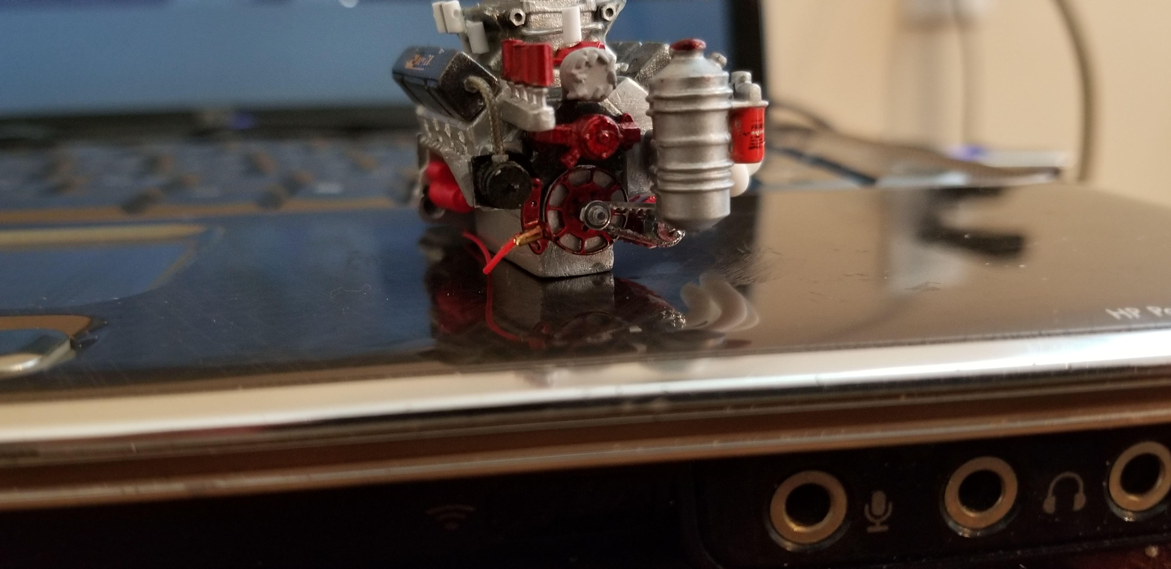

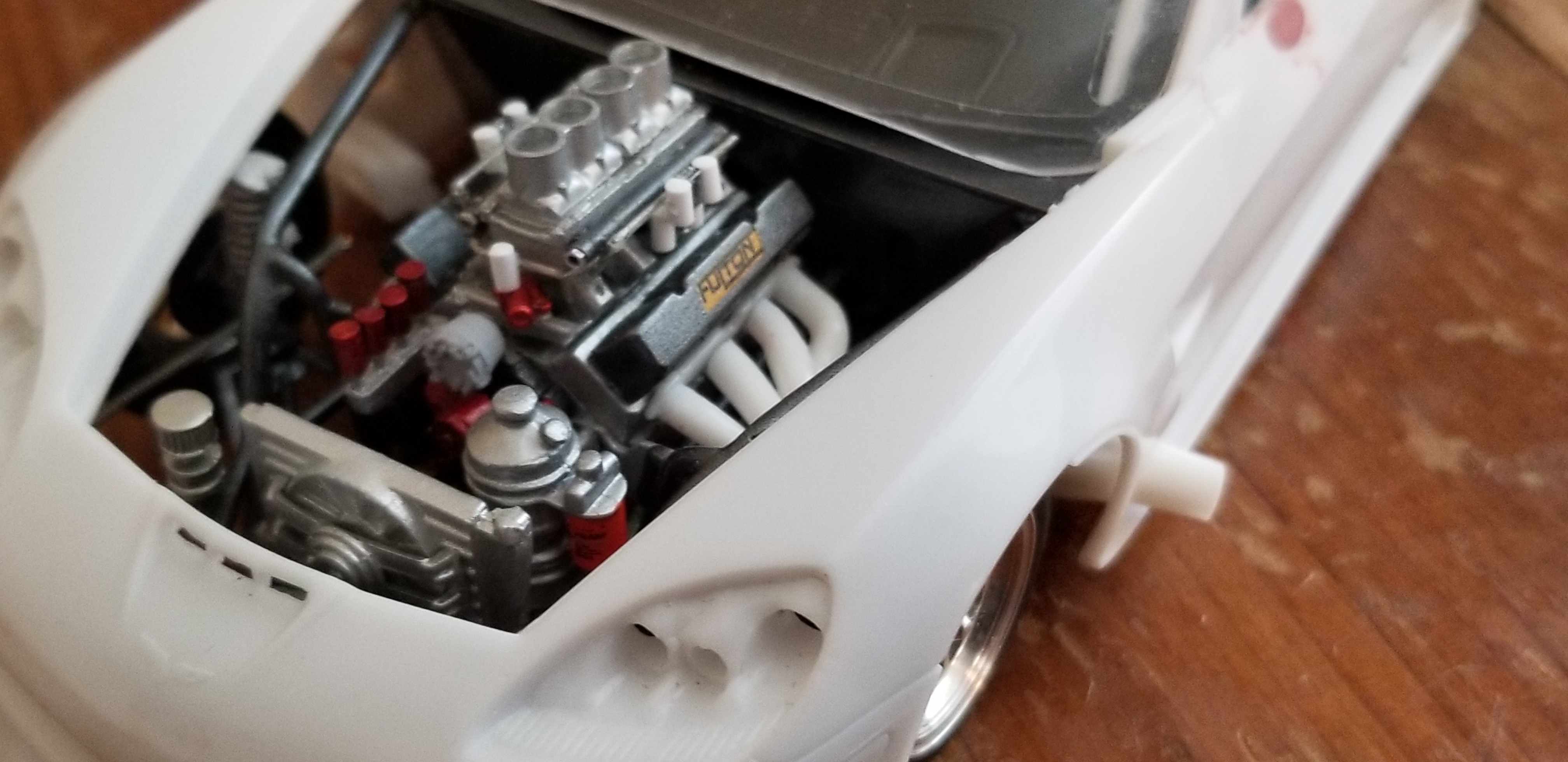

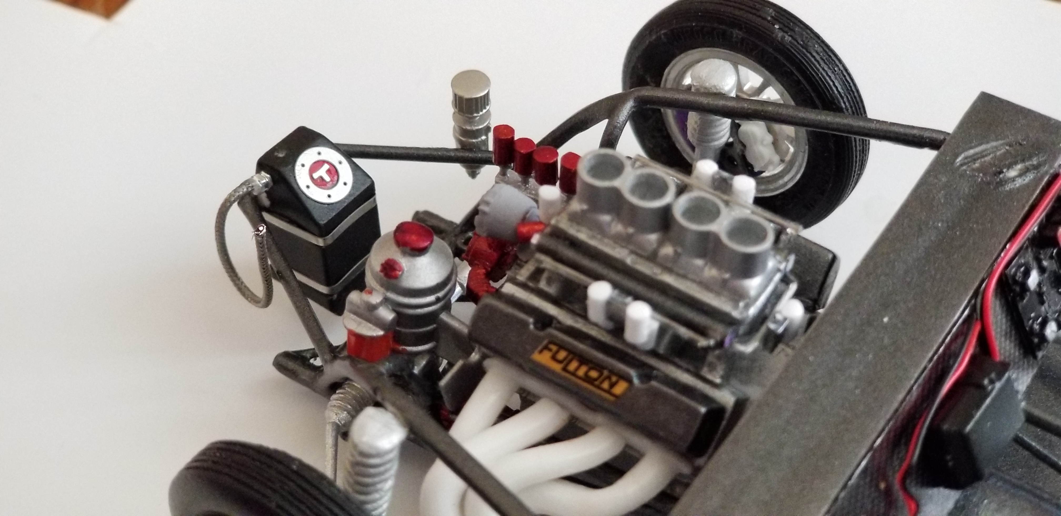

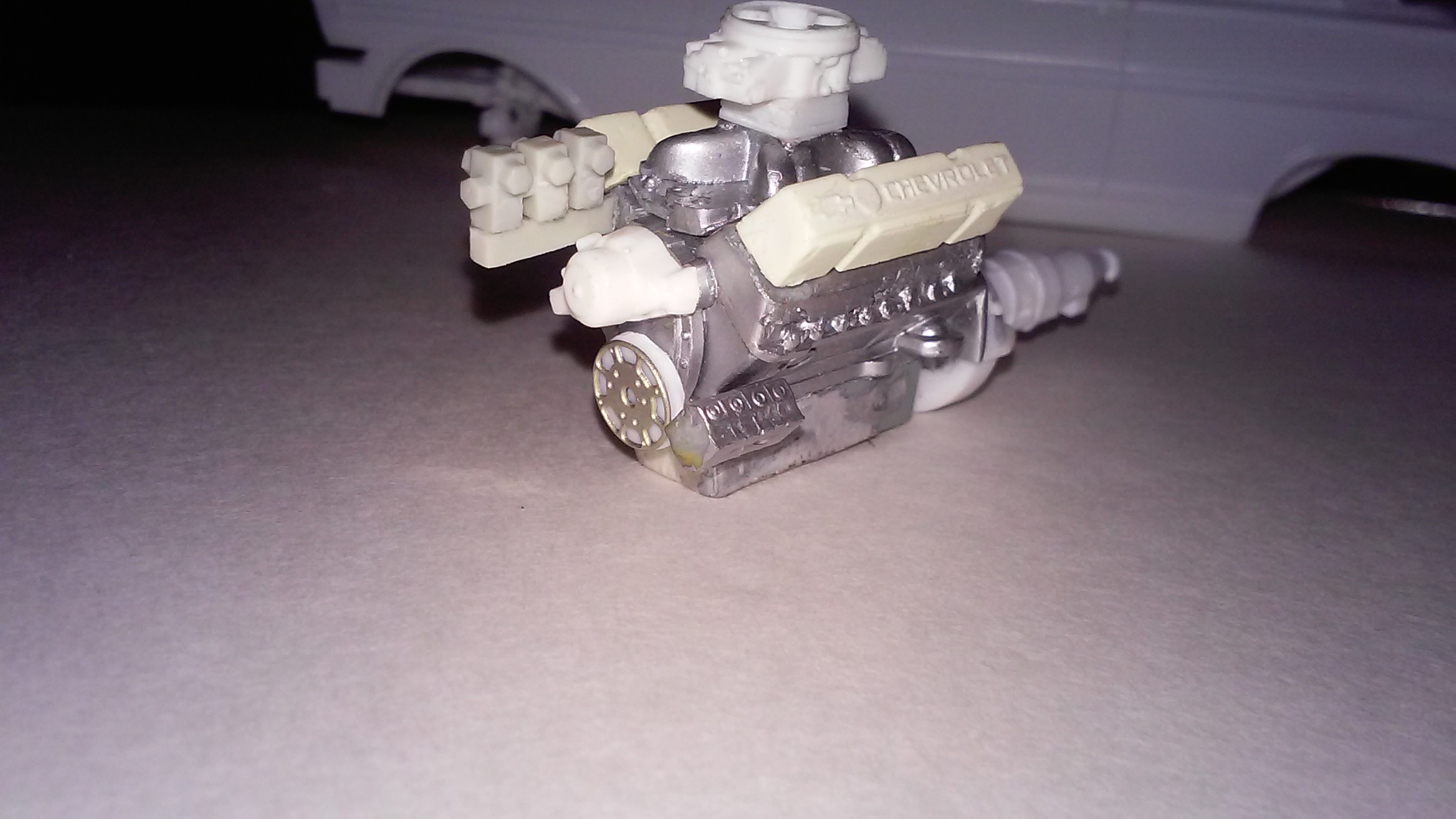

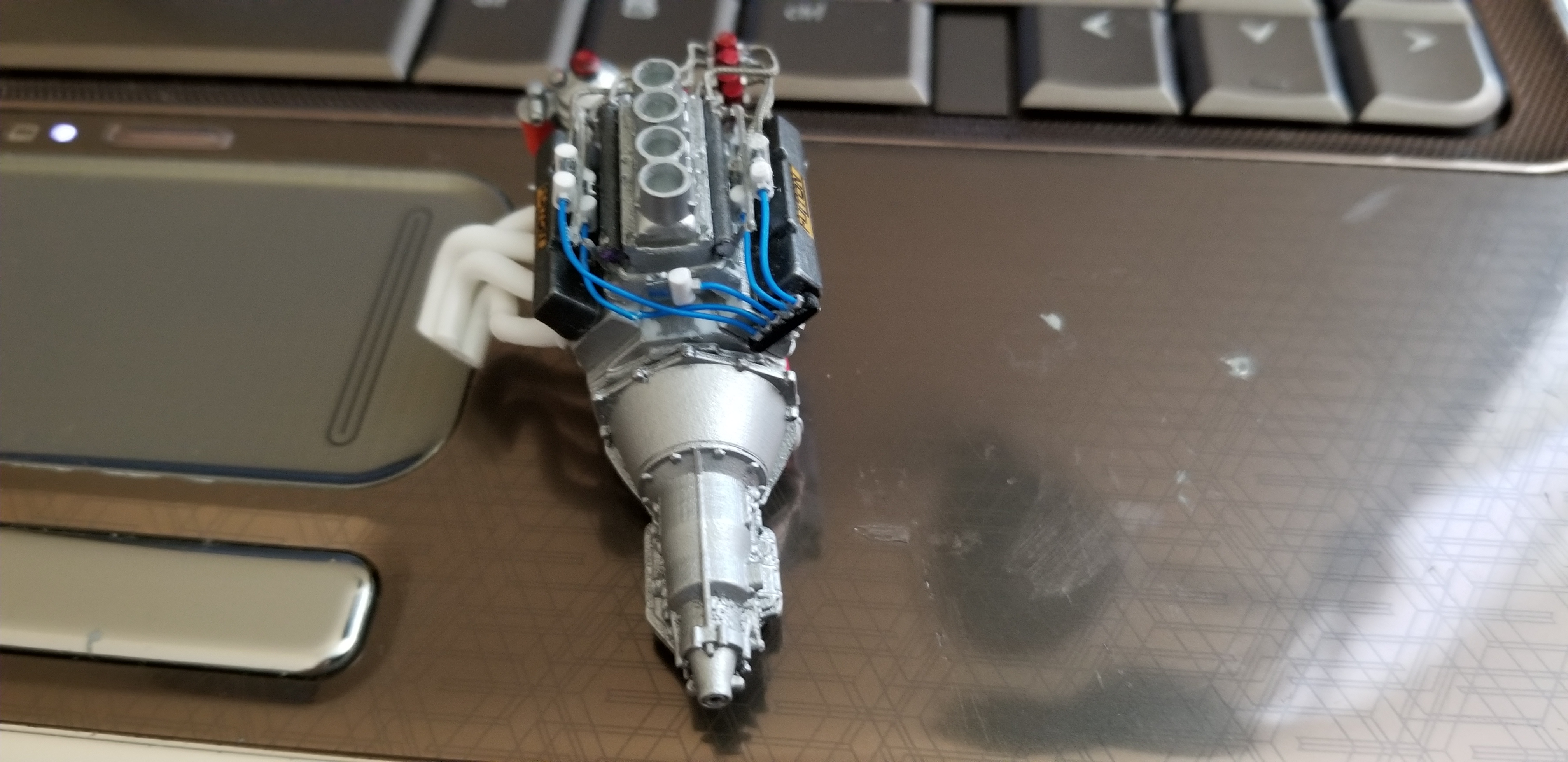

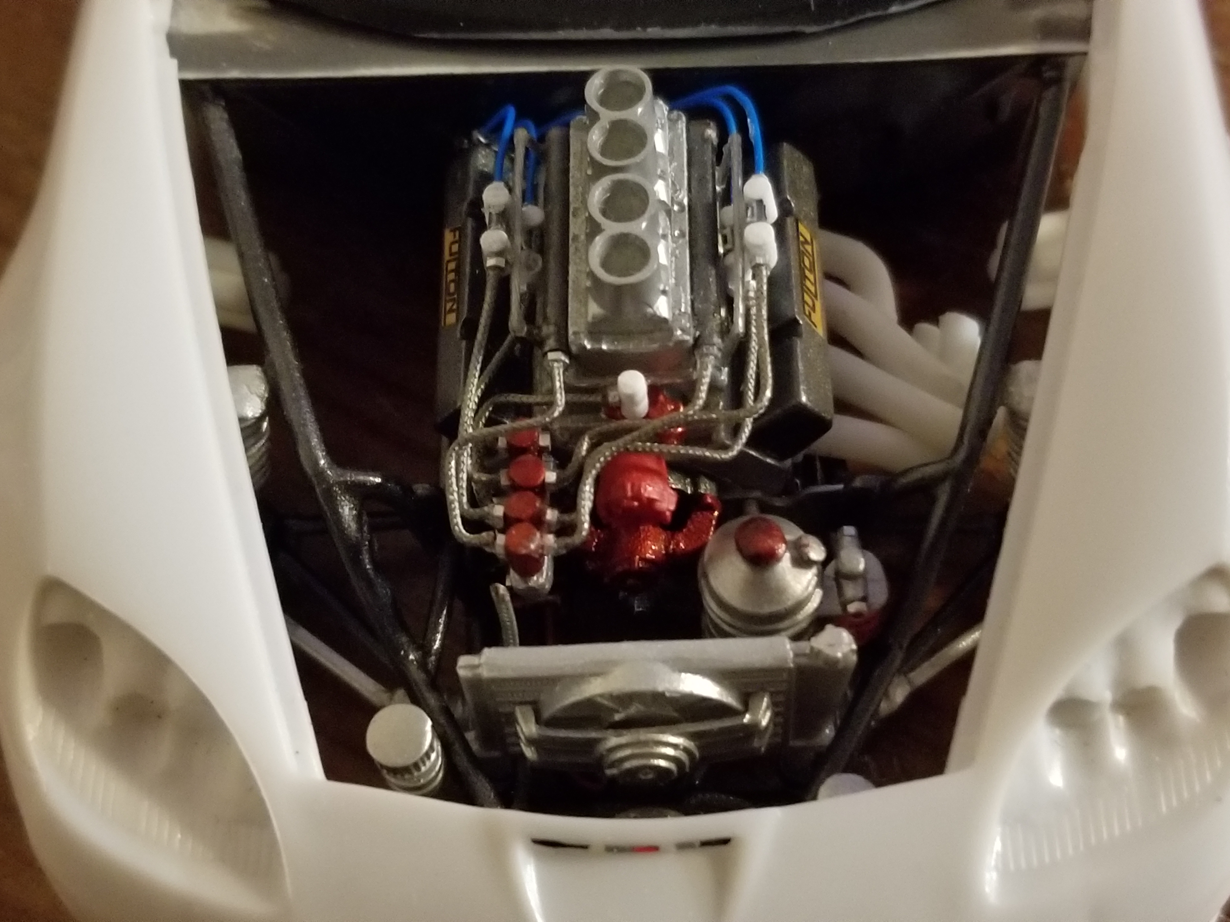

lil block 471 Posted July 3, 2018 Author Posted July 3, 2018 The engine came from a 89' nascar. I then angle milled (sanded) the top of the heads so the valve covers would lay over like 15 degree heads. I used the nascar motor because it comes with a external oil pump as shown in the second picture, Which is how the motor started out looking like when I first got it. Then I made the changes to it for the vette. The 400 trans is 3d printed from Shapeways website.

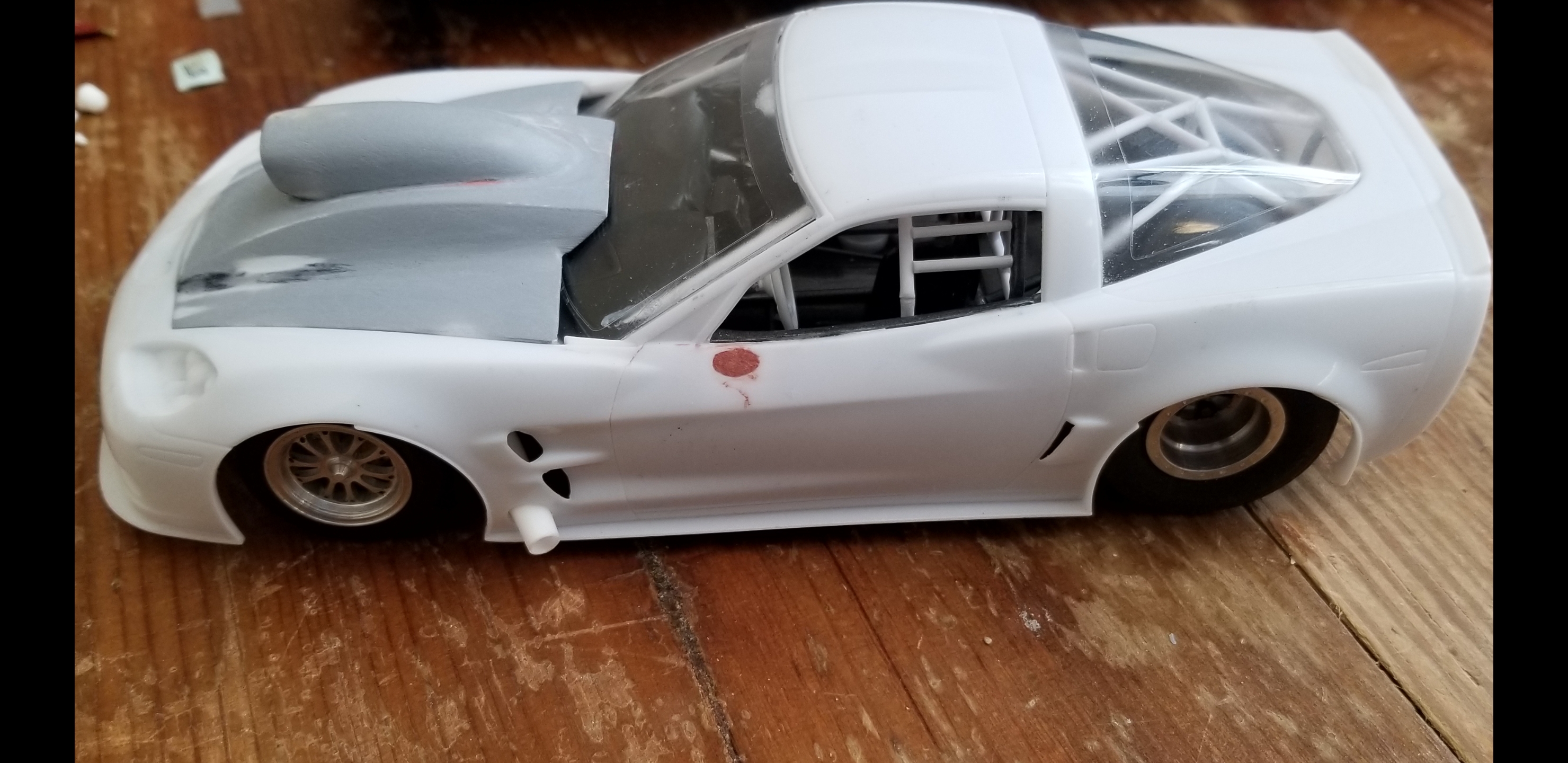

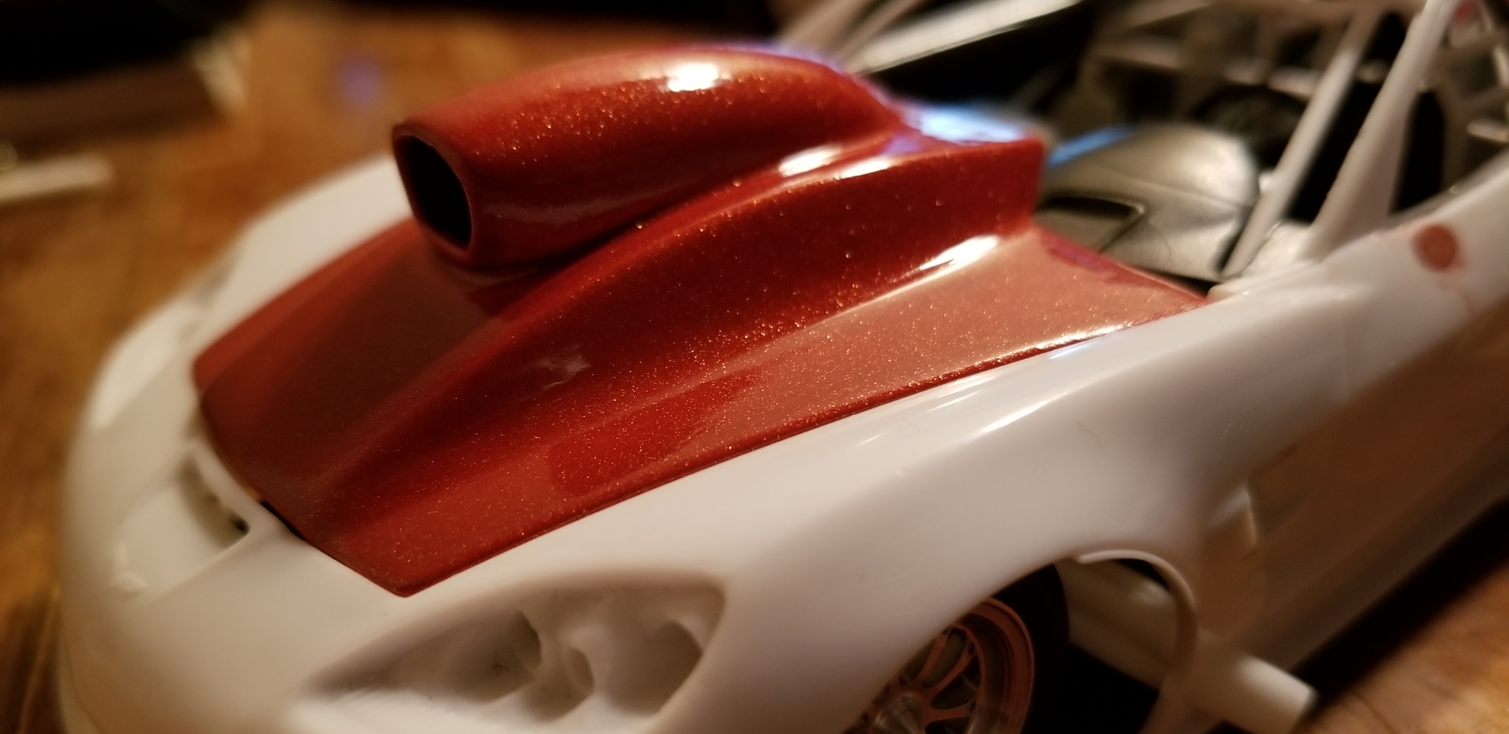

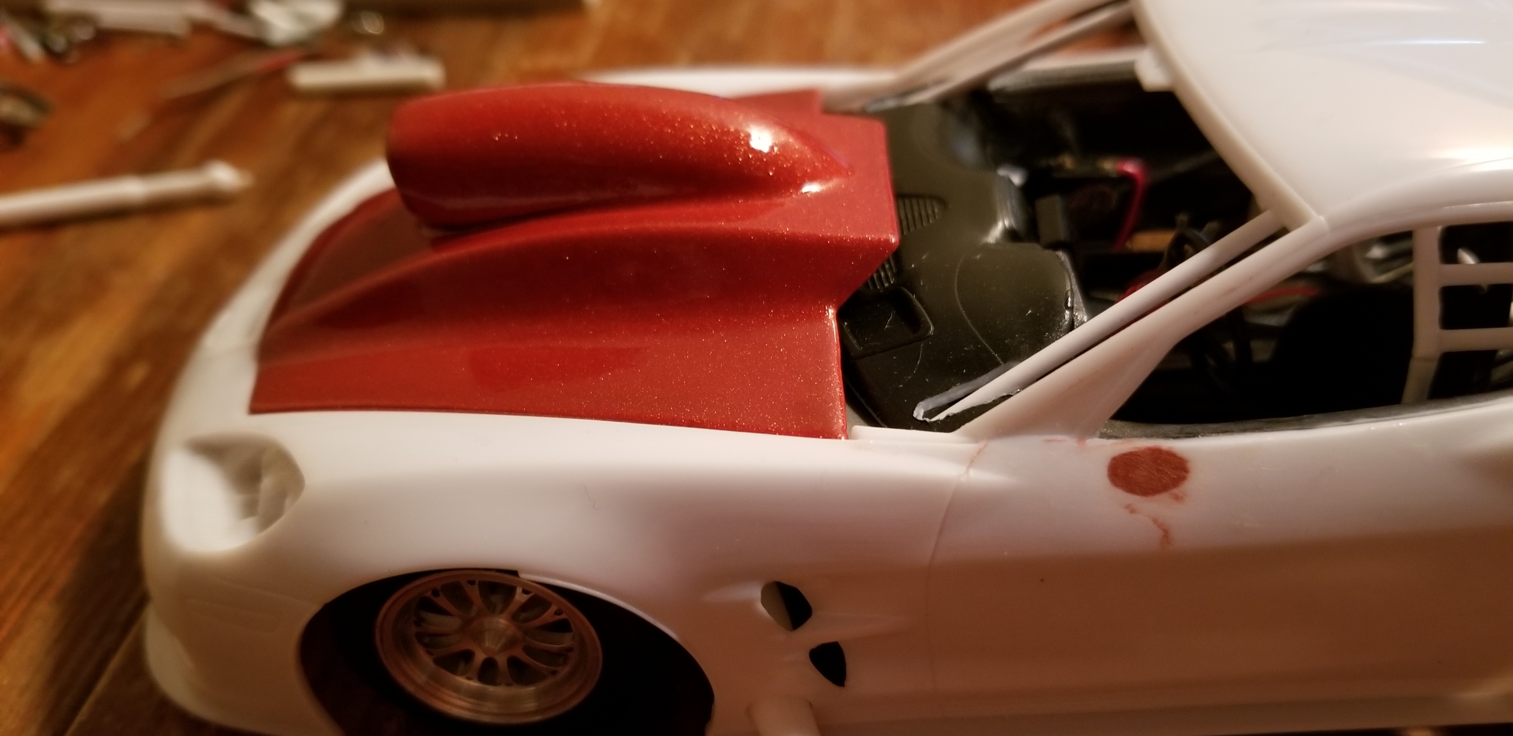

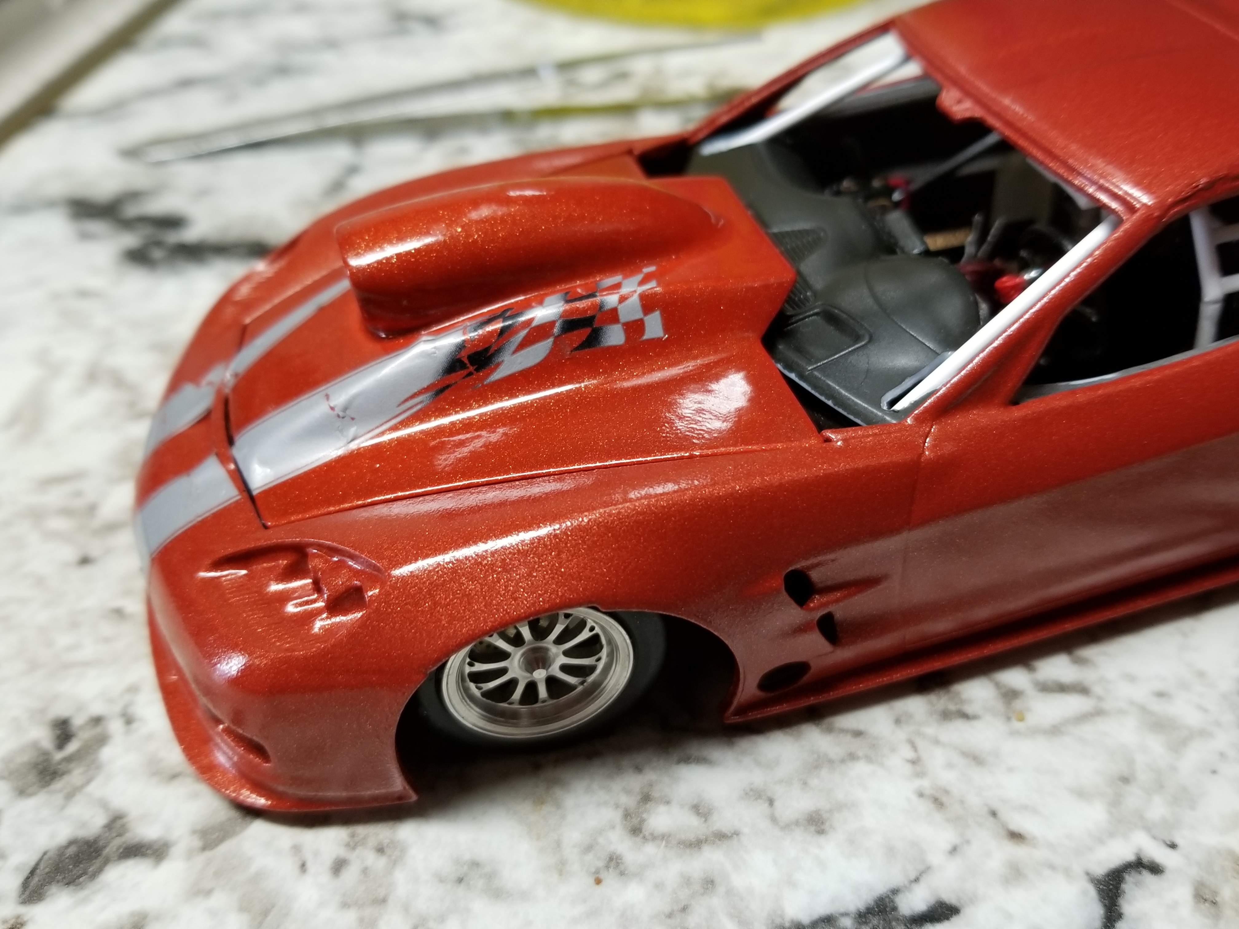

lil block 471 Posted July 3, 2018 Author Posted July 3, 2018 (edited) Got the hood with the cowl from another builder, but I put the 3d printed small pro mod scoop on it from Shapeways. Got around to painting, But decals and paint has to be redone. The hood came out ok paint wise. Still got the cage bars to do as well. More updates soon. Edited July 3, 2018 by lil block 471
