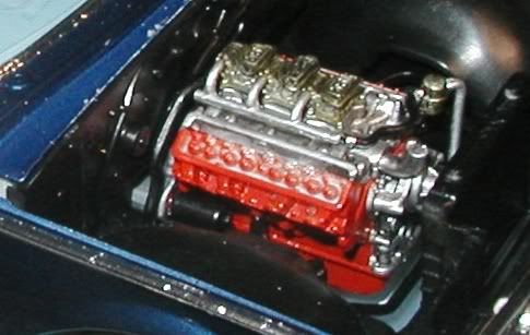

MikeMc Posted July 31, 2008 Posted July 31, 2008 I have washed with thinned flat black for years. That said I tried the detailer over chrome, and was not impressed. With a blue\purple cast over chrome...it just does not look correct.. I also found it "rubbery" when dry This '32 used the detailer on the carbs... This '34 used flat black on the grill...

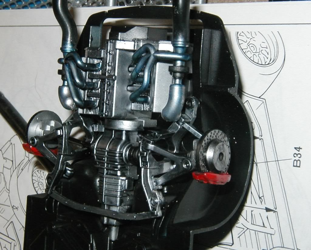

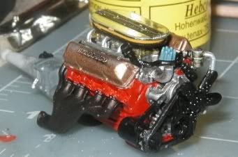

CAL Posted August 5, 2008 Posted August 5, 2008 (edited) Inks man, inks are where it's at. Carbs done with yellow and black inks over MM alu plate. all the aluminum inked. scripts on the valve convers inked. Exhuast blueing blue, violet and black inks. Edited August 5, 2008 by CAL
