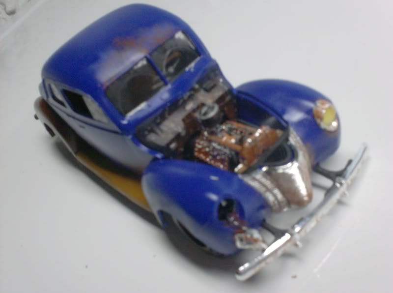

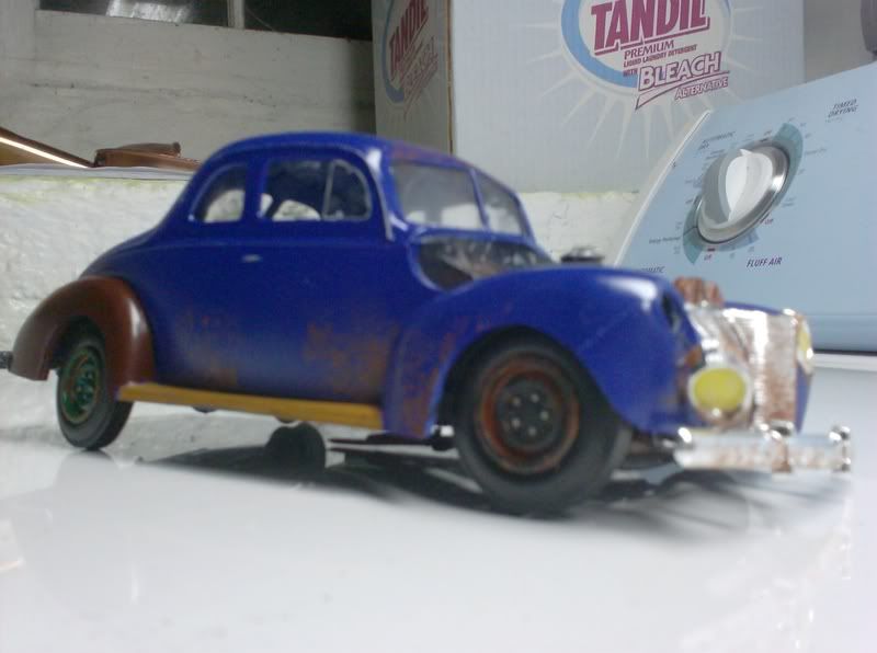

diymirage Posted August 15, 2008 Posted August 15, 2008 kjadud0667 said: what do u guys do to make ur cars look like they have rust spots on them ?? i like to put a little steel brush on the dremel and hit the kit with that a little bit to rough it up with a little practice you can use this tecnique to make it look like the part you hit is rusting out then when it comes down to painting it on i like to use a round tipped brush and testors rust colored paint. i basically drybrush it on in a pattern i think looks good this ford coupe is probably my best example, this is all just painted on.
kjadud0667 Posted August 15, 2008 Author Posted August 15, 2008 diymirage said: i like to put a little steel brush on the dremel and hit the kit with that a little bit to rough it up with a little practice you can use this tecnique to make it look like the part you hit is rusting out then when it comes down to painting it on i like to use a round tipped brush and testors rust colored paint. i basically drybrush it on in a pattern i think looks good this ford coupe is probably my best example, this is all just painted on. ok thanks that looks cool .

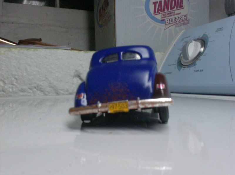

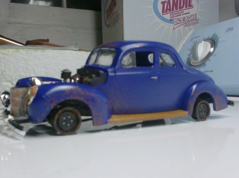

James W Posted August 28, 2008 Posted August 28, 2008 Hey that's looking goood! The rusty spots are right on. One thing I see looking at the whole picture is that the silver paint is too consistent. It would be weathered on a car like this. Try brushing on some flat clear and then working it over with some fine sandpaper. Silver is a hard color to work with sometimes, so do a small area and experiment with it. Every time I build I find different things I 'd like to try next time, makes the hobby a never ending adventure. You've really got a great start here. keep going.
