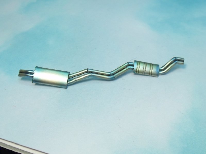

935k3 Posted January 2, 2019 Posted January 2, 2019 (edited) On 1/2/2019 at 12:18 AM, StevenGuthmiller said: Sand off all of the mold lines and shoot the pipes and mufflers with varying shades of Alclad paints. Steve Expand I agree. This exhaust for a racing BMW was done with a base of chrome then some Alclad Pale Burnt Metal. Clear blue and yellow highlights. Edited January 2, 2019 by 935k3
