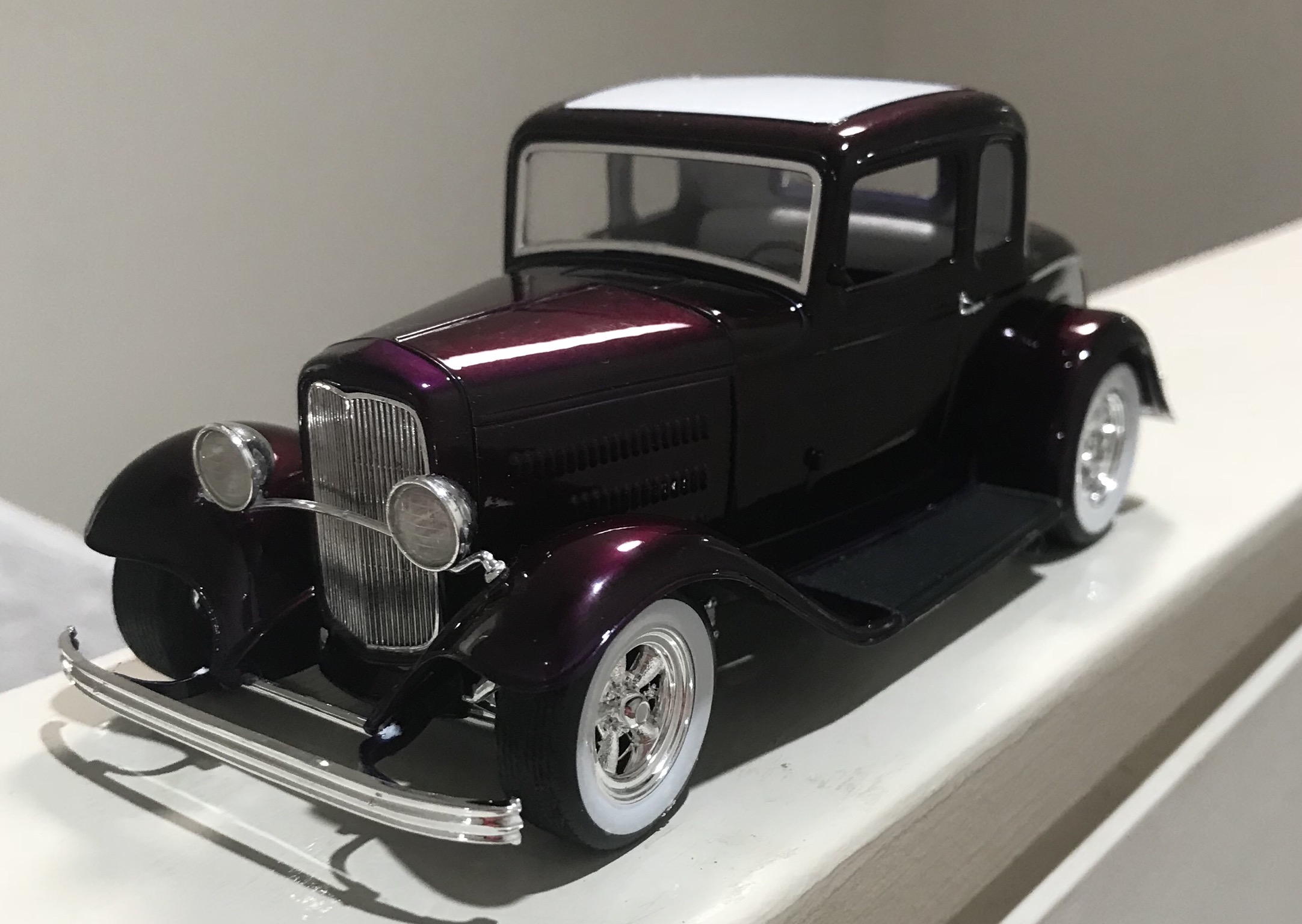

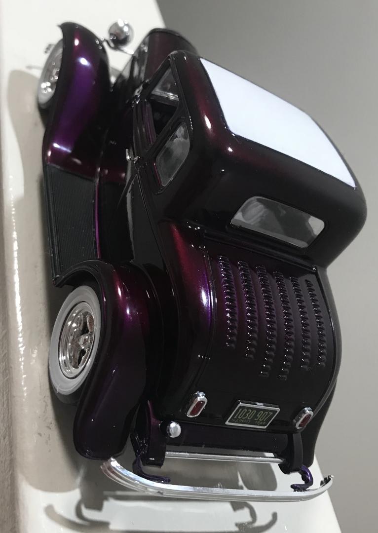

SnozzaP Posted February 2, 2019 Posted February 2, 2019 Hey mate. I used the bright silver candy base over tamiya fine grey primer.. Then I used Alclad Candy Violet. Then cleared with Alclad Klear Kote Lacquer. Here is my result. I had no issues with it at all
