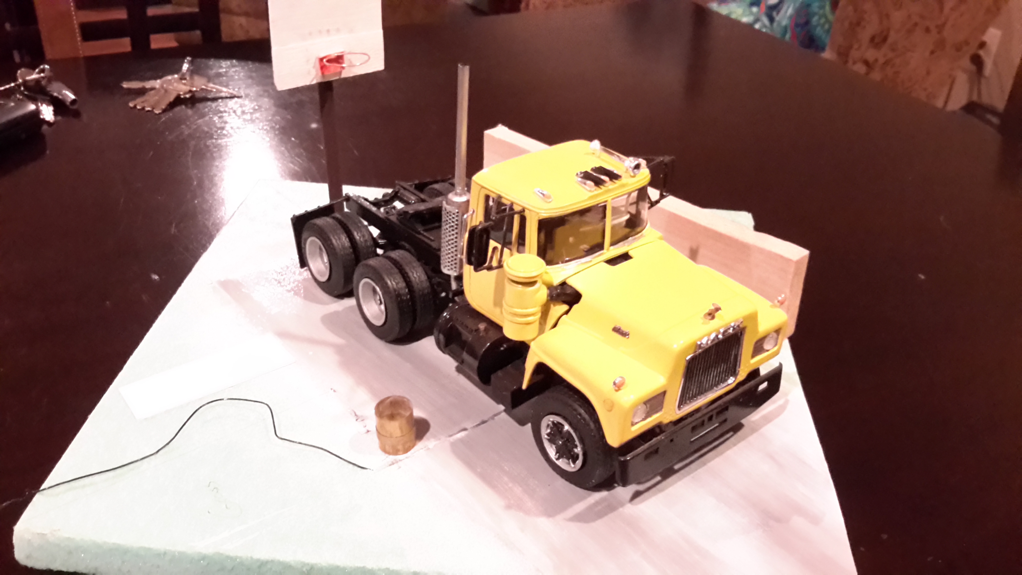

olsbooks Posted May 7, 2019 Author Posted May 7, 2019 (edited) A very early in the build photo. Objectives: Freshly washed truck, wet cement, hose, bucket, etc. Want fence covered in morning glories or similar. Visitor on top of hood ornament. Edited May 7, 2019 by olsbooks
