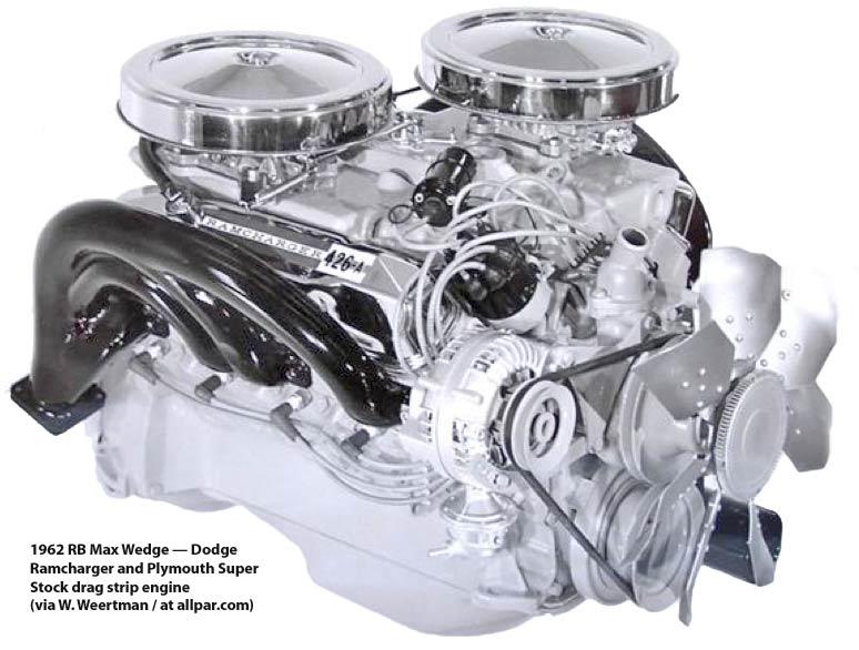

4 hours ago, 1972coronet said:
Ignition wire separators look great --- wires' gauge is a little thick , but they are on a Super Stock (et al.) engine , so...
My only concern is the routing of the wires to the heads : that routing is not going to work with either stock manifolds or headers . Chrysler's B/RB engines' plug wires' approach is from underneath the exhaust .
Keep on keepin' on !

Please , understand that I'm not bustin' your chops here .
Here's a photo of a 1962 Max Wedge --- notice how its plug wires are routed .
Keep the great work coming , Brian !max-wedge.jpg.449eafbf9ccff4b633ff5f41a1a719f4.jpg
It's all good, the info is just what I want. Having seen that I understand what you mean but the kit I'm doing the headers are more traditional and apparently not accurate. I don't have that much in parts to be able to correct it..
