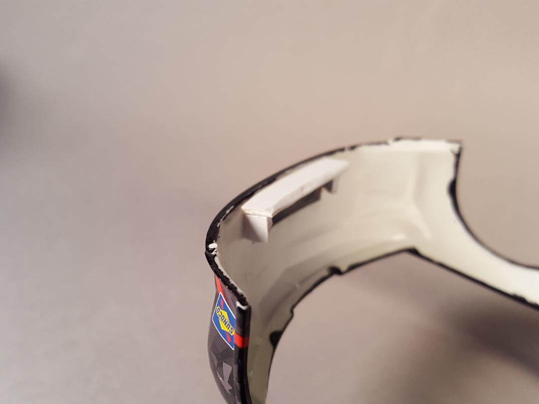

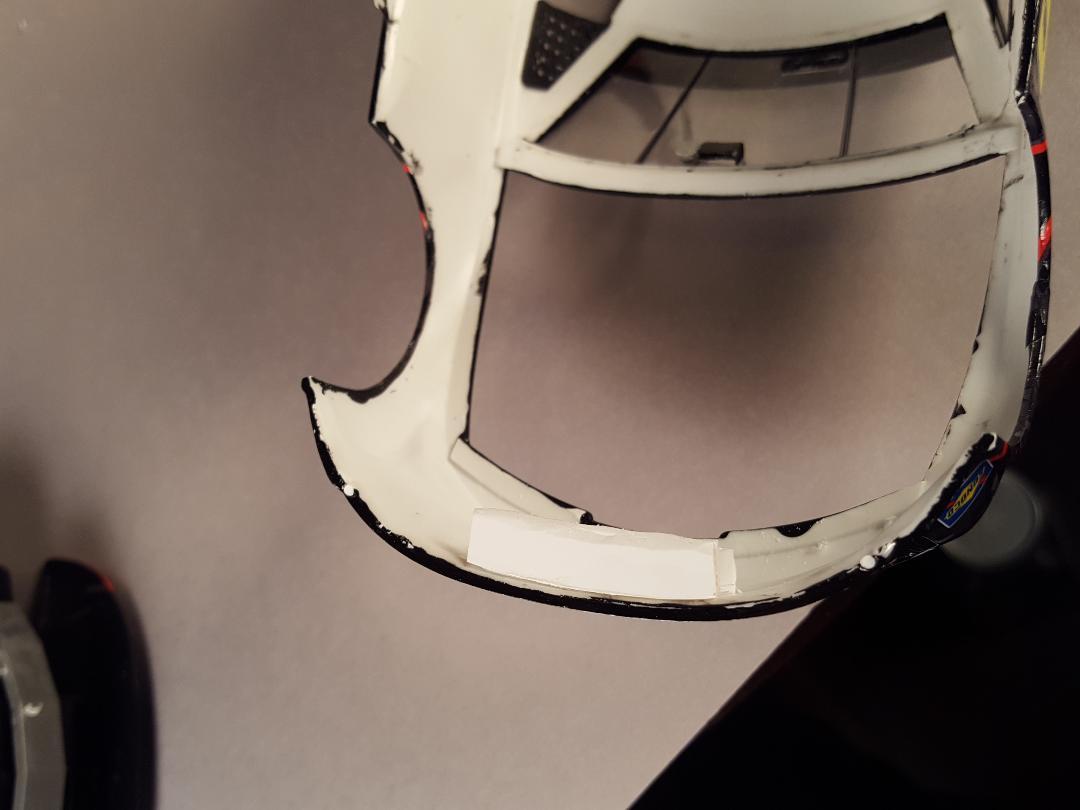

You just need to make the parts below from styrene sheet material. I had to use 2 pieces of .020 sheet because it has to be .040 thick to work. What you're doing is getting the part you make to slide under the radiator extension duct. You install the body a smidge in front to allow this to happen and then slide it backwards into the correct position. there is enough leeway between front fender tire opening and tires to do this.
